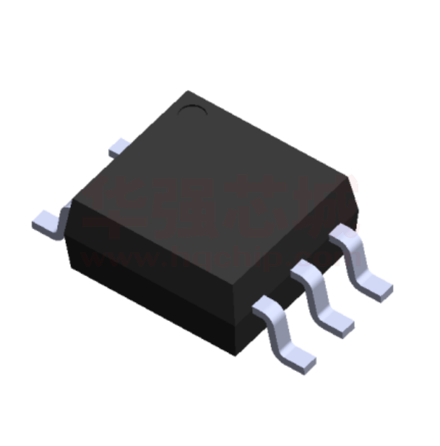

    SOP-5 单向光耦 Viso=3750Vrms VF(typ)=1.4V IF=25mA
VOM452 数据手册
VOM452, VOM453 www.vishay.com Vishay Semiconductors Analog High Speed Coupler, High Noise Immunity, 1 MBd, SOP-5 Package FEATURES • Surface mountable A 1 6 VCC • Industry standard SOP-5 footprint 5 C • Compatible with infrared vapor phase reflow and wave soldering processes 4 E C 3 • Isolation test voltage, 3750 VRMS • Very high common mode transient immunity: 15 000 V/μs at VCM = 1500 V guaranteed (VOM453) 20409-1 • High speed: 1 MBd DESCRIPTION • TTL compatible The VOM452 and VOM453, high speed optocouplers, each consists of a GaAlAs infrared emitting diode, optically coupled with an integrated photo detector and a high speed transistor. The photo detector is junction isolated from the transistor to reduce miller capacitance effects. The open collector output function allows circuit designers to adjust the load conditions when interfacing with different logic systems such as TTL, CMOS, etc. • Open collector output • Material categorization: for definitions of compliance please see www.vishay.com/doc?99912 APPLICATIONS • Fieldbus communication and control • Logic ground isolation Because the VOM452 and VOM453 have a Faraday shield on the detector chip, it can also reject and minimize high input to output common mode transient voltages. There is no base connection, further reducing the potential electrical noise entering the package. • Analog signal ground isolation • Replace pulse transformers • IPM (intelligent power module) drivers AGENCY APPROVALS The VOM452 and VOM453 are packaged in industry standard SOP-5 packages and are suitable for surface mounting. • UL1577 • cUL This an ideal solution for Industrial communication bus isolation, as well as isolated drive circuit applications such as IPM (intelligent power module) drivers. • DIN EN 60747-5-5 (VDE 0884-5) available with option 1 ORDERING INFORMATION SOP-5 V O M 4 5 # T 7.21 mm PART NUMBER AGENCY CERTIFIED/PACKAGE UL, cUL SOP-5 UL, cUL, VDE SOP-5 CMTI (kV/μs) ≥1 ≥ 15 VOM452T VOM453T ≥1 ≥ 15 VOM452-X001T VOM453-X001T Notes • For additional information on the available options refer to option information. • The product is available only on tape and reel. Rev. 1.6, 31-May-16 Document Number: 81587 1 For technical questions, contact: optocoupleranswers@vishay.com THIS DOCUMENT IS SUBJECT TO CHANGE WITHOUT NOTICE. THE PRODUCTS DESCRIBED HEREIN AND THIS DOCUMENT ARE SUBJECT TO SPECIFIC DISCLAIMERS, SET FORTH AT www.vishay.com/doc?91000 VOM452, VOM453 www.vishay.com Vishay Semiconductors ABSOLUTE MAXIMUM RATINGS (Tamb = 25 °C, unless otherwise specified) PARAMETER TEST CONDITION SYMBOL VALUE UNIT INPUT Reverse voltage VR 3 V DC forward current IF 25 mA tp ≤ 1 μs, 300 pulses/s IFSM 1 A Tamb ≤ 70 °C Pdiss 45 mW Supply voltage VS -0.5 to +30 V Output voltage VO -0.5 to +25 V Output current IO 8 mA Pdiss 100 mW Storage temperature range Tstg -55 to +125 °C Ambient temperature range Tamb -55 to +100 °C Tj 100 °C 260 °C Surge forward current Power dissipation OUTPUT Tamb ≤ 70 °C Power dissipation COUPLER Junction temperature Soldering temperature t < 10 s max. Note • Stresses in excess of the absolute maximum ratings can cause permanent damage to the device. Functional operation of the device is not implied at these or any other conditions in excess of those given in the operational sections of this document. Exposure to absolute maximum ratings for extended periods of the time can adversely affect reliability. ELECTRICAL CHARACTERISTICS (Tamb = -40 °C to +100 °C, unless otherwise specified) PARAMETER TEST CONDITION PART SYMBOL MIN. TYP. MAX. UNIT INPUT Input forward voltage IF = 16 mA VF - 1.4 1.8 V Input reverse current VR = 3 V IR - 0.5 10 μA f = 1 MHz, VF = 0 V, Tamb = 25 °C CIN - 75 - pF IF = 16 mA ΔVF/ΔTamb - -1.7 - mV/°C Logic low supply current IF = 16 mA, VO = open, VCC = 15 V ICCL - 200 - μA Logic high supply current IF = 0 mA, VO = open, VCC = 15 V, Tamb = 25 °C ICCH - 0.001 1 μA IF = 0 mA, VO = open, VCC = 15 V ICCH - - 2 μA Logic low output voltage IF = 16 mA, VCC = 4.5 V, IO = 3 mA, Tamb = 25 °C VOL - 0.15 0.4 V Input capacitance Temperature coefficient of forward voltage OUTPUT Logic high output current IF = 16 mA, VCC = 15 V, IO = 2.4 mA VOL - - 0.5 V IF = 0 mA, VO = VCC = 5.5 V, Tamb = 25 °C IOH - 0.003 0.5 μA IF = 0 mA, VO = VCC = 15 V, Tamb = 25 °C IOH - 0.01 1 μA IF = 0 mA, VO = VCC = 15 V IOH - - 50 μA f = 1 MHz, Tamb = 25 °C CIO - 0.4 - pF COUPLER Capacitance (input-output) (1) Notes • Minimum and maximum values are testing requirements. Typical values are characteristics of the device and are the result of engineering evaluation. Typical values are for information only and are not part of the testing requirements. All typical values are measured at Tamb = 25 °C. (1) A 0.1 μF bypass capacitor connected between pins 4 and 6 is recommended. CURRENT TRANSFER RATIO (Tamb = -40 °C to +100 °C, unless otherwise specified) PARAMETER Current transfer ratio (1)(2) TEST CONDITION VO = 0.5 V, IF = 16 mA, VCC = 4.5 V VO = 0.4 V, IF = 16 mA, Tamb = 25 °C SYMBOL CTR MIN. TYP. MAX. 15 30 - 20 - 50 UNIT % Notes Current transfer ratio in percent equals the ratio of output collector current (IO) to the forward LED input current (IF) times 100. A 0.1 μF bypass capacitor connected between pins 4 and 6 is recommended. All typical values are measured at Tamb = 25 °C. (1) (2) Rev. 1.6, 31-May-16 Document Number: 81587 2 For technical questions, contact: optocoupleranswers@vishay.com THIS DOCUMENT IS SUBJECT TO CHANGE WITHOUT NOTICE. THE PRODUCTS DESCRIBED HEREIN AND THIS DOCUMENT ARE SUBJECT TO SPECIFIC DISCLAIMERS, SET FORTH AT www.vishay.com/doc?91000 VOM452, VOM453 www.vishay.com Vishay Semiconductors SWITCHING CHARACTERISTICS (Tamb = -40 °C to +100 °C, unless otherwise specified) TEST CONDITION SYMBOL MIN. TYP. MAX. UNIT Propagation delay time to logic low at output (see fig. 1 and note 1) PARAMETER VCC = 5 V, IF = 16 mA, RL = 1.9 kΩ tPHL - 0.2 1 μs Propagation delay time to logic high at output (see fig. 1 and note 1) VCC = 5 V, IF = 16 mA, RL = 1.9 kΩ tPLH - 0.5 1 μs Note (1) The 1.9 kΩ load represents 1 TTL unit load of 1.6 mA and the 5.6 kΩ pull-up resistor. All typical values are measured at T amb = 25 °C. 10 % duty cycle 1/f < 100 µs Pulse generator ZO = 50 Ω tr = 5 ns IF IF 1 0 +5V 6 RL 5V VO 5 VO 0.1 µF 1.5 V 3 4 1.5 V C L = 15 pF VOL IF = monitor tPLH tPHL Rm 20410 Fig. 1 - Test Circuit for Switching Times COMMON MODE TRANSIENT IMMUNITY (Tamb = 25 °C, unless otherwise specified) PARAMETER Common mode transient immunity at logic high level output (see fig. 2 and notes 1, and 2) Common mode transient immunity at logic low level output (see fig. 2 and notes 1, and 2) TEST CONDITION PART SYMBOL MIN. TYP. MAX. UNIT RL = 1.9 kΩ, IF = 0 mA, VCM = 10 VP-P VOM452T |CMH| 1000 - - V/μs RL = 1.9 kΩ, IF = 0 mA, VCM = 1500 VP-P VOM453T |CMH| 15 000 - - V/μs RL = 1.9 kΩ, IF = 16 mA, VCM = 10 VP-P VOM452T |CML| 1000 - - V/μs RL = 1.9 kΩ, IF = 16 mA, VCM = 1500 VP-P VOM453T |CML| 15 000 - - V/μs Notes Common mode transient immunity in a logic high level is the maximum tolerable (positive) dVCM/dt on the leading edge of the common mode pulse (VCM) to assure that the output will remain in a logic high state (i.e., VO > 2 V). Common mode transient immunity in a logic low level the maximum tolerable (negative) dVCM/dt on the trailing edge of the common mode pulse signal (VCM to assure that the output will remain in logic low state, i.e., VO > 0.8 V). (2) The 1.9 kΩ load represents 1 TTL unit load of 1.6 mA and the 5.6 kΩ pull-up resistor. (1) IF 1 VCM +5V 6 5 10 % tr VO 3 4 VFF Switch at A: IF = 0 mA VO 2V VCM + 20411 90 % tf 0.1 µF A B 90 % 0 V 10 % RL – Pulse Generator 5V 0.8 V VO Switch at B: IF = 16 mA VOL Fig. 2 - Test Circuit for Transient Immunity and Typical Waveforms Rev. 1.6, 31-May-16 Document Number: 81587 3 For technical questions, contact: optocoupleranswers@vishay.com THIS DOCUMENT IS SUBJECT TO CHANGE WITHOUT NOTICE. THE PRODUCTS DESCRIBED HEREIN AND THIS DOCUMENT ARE SUBJECT TO SPECIFIC DISCLAIMERS, SET FORTH AT www.vishay.com/doc?91000 VOM452, VOM453 www.vishay.com Vishay Semiconductors SAFETY AND INSULATION RATINGS (Tamb = 25 °C, unless otherwise specified) PARAMETER TEST CONDITION SYMBOL Climatic classification According to IEC 68 part 1 Pollution degree According to DIN VDE 0109 Comparative tracking index VALUE UNIT 55 / 100 / 21 2 Insulation group IIIa CTI 175 Maximum rated withstanding isolation voltage According to UL1577, t = 1 min VISO 3750 Maximum transient isolation voltage According to DIN EN 60747-5-5 VIOTM 6000 Vpeak Maximum repetitive peak isolation voltage According to DIN EN 60747-5-5 VIORM 707 Vpeak Tamb = 25 °C, VIO = 500 V RIO ≥ 1012 Ω RIO ≥ Isolation resistance Tamb = 100 °C, VIO = 500 V Output safety power VRMS Ω 1011 PSO 350 mW Input safety current ISI 150 mA Input safety temperature TS 175 °C ≥5 mm Creepage distance ≥5 mm DTI ≥ 0.1 mm VPR 1669 Vpeak Clearance distance Insulation thickness VIORM x 1.875 = VPR, 100 % production test with tM = 1 s, partial discharge < 5 pC Input to output test voltage, method B Note • As per IEC 60747-5-5, § 7.4.3.8.2, this optocoupler is suitable for “safe electrical insulation” only within the safety ratings. Compliance with the safety ratings shall be ensured by means of protective circuits. 30 80 VCC = 4.5 V VO = 0.4 V IF - LED Current (mA) CTR - Current Transfer Ratio (%) TYPICAL CHARACTERISTICS (Tamb = 25 °C, unless otherwise specified) 60 40 20 25 20 50 °C 25 °C 15 75 °C 0 °C 10 100 °C - 40 °C 5 0 0 0 22101 5 10 15 20 IF - Forward Current (mA) Fig. 3 - Current Transfer Ratio vs. Forward Current Rev. 1.6, 31-May-16 0.8 1.0 1.2 1.4 1.6 1.8 VF - LED Forward Voltage (V) Fig. 4 - LED Current vs. LED Forward Voltage Document Number: 81587 4 For technical questions, contact: optocoupleranswers@vishay.com THIS DOCUMENT IS SUBJECT TO CHANGE WITHOUT NOTICE. THE PRODUCTS DESCRIBED HEREIN AND THIS DOCUMENT ARE SUBJECT TO SPECIFIC DISCLAIMERS, SET FORTH AT www.vishay.com/doc?91000 VOM452, VOM453 www.vishay.com Vishay Semiconductors 500 7 IO - Output Current (mA) VCC = 4.5 V VO = 0.4 V IF = 20 mA 6 IF = 16 mA 5 4 IF = 10 mA 3 IF = 5 mA 2 IF = 1 mA IF = 2 mA 1 0 - 40 - 20 0 21875 20 40 60 80 ICCL - Supply Current (µA) 8 300 200 100 0 - 40 100 Temperature (°C) 0 20 40 60 80 100 TA - Temperature (°C) Fig. 8 - Supply Current vs. Temperature 1000 400 IF = 16 mA, VCC = 5 V, Rg = 1.9 kΩ, Cg = 15 pF Duty cycle = 10 %, f = 10 kHz VOL - Output Voltage (mV) Tp - Propagation Delay (ns) - 20 21878 Fig. 5 - Output Current vs. Temperature 800 IF = 16 mA VCC = 15 V VO = open 400 600 tPLH 400 tPHL 200 0 - 40 - 20 0 20 40 60 80 100 TA - Temperature (°C) 21876 350 300 IO = 3 mA 250 200 IO = 2.4 mA 150 100 - 40 21879 Fig. 6 - Propagation Delay vs. Temperature IF = 16 mA VCC = 4.5 V - 20 0 20 40 60 80 100 TA- Temperature (°C) Fig. 9 - Logic Low Output Voltage vs. Temperature IOH - Output Current (nA) 1000 IF = 0 mA 100 10 VCC = VO = 15 V 1 VCC = VO = 5.5 V 0.1 - 40 21877 - 20 0 20 40 60 80 100 TA - Temperature (°C) Fig. 7 - Logic High Output Current vs. Temperature Rev. 1.6, 31-May-16 Document Number: 81587 5 For technical questions, contact: optocoupleranswers@vishay.com THIS DOCUMENT IS SUBJECT TO CHANGE WITHOUT NOTICE. THE PRODUCTS DESCRIBED HEREIN AND THIS DOCUMENT ARE SUBJECT TO SPECIFIC DISCLAIMERS, SET FORTH AT www.vishay.com/doc?91000 VOM452, VOM453 www.vishay.com Vishay Semiconductors PACKAGE DIMENSIONS (in millimeters) 7.00 ± 0.30 4.90 max. 5.35 typ. 4.40 ± 0.25 1.27 nom. 2.54 nom. 4 0.50 ± 0.10 3 R0.25 0.90 1.27 2.54 5 0.1 0.1 ± 0.1 0.40 ± 0.10 0.20 ± 0.10 2.0 ± 0.1 4.60 ± 0.25 5.10 1.15 7.40 Pin 1 I.D. 1 2 Technical drawing according to DIN specifications PACKAGE MARKING M452 VYWW U68 Fig. 10 - Example of VOM452T M452 VYWW U68X1 Fig. 11 - Example of VOM452-X001T Notes • VDE logo is not part of the package marking. • Tape and reel suffix (T) is not part of the package marking. Rev. 1.6, 31-May-16 Document Number: 81587 6 For technical questions, contact: optocoupleranswers@vishay.com THIS DOCUMENT IS SUBJECT TO CHANGE WITHOUT NOTICE. THE PRODUCTS DESCRIBED HEREIN AND THIS DOCUMENT ARE SUBJECT TO SPECIFIC DISCLAIMERS, SET FORTH AT www.vishay.com/doc?91000 VOM452, VOM453 www.vishay.com Vishay Semiconductors PACKING INFORMATION (tape and reel) Tape slot in code 330 (13") Fig. 12 - Tape and Reel Shipping Medium 2.0 ± 0.1 4.0 ± 0.1 1.75 ± 0.10 1.5 ± 0.1 2.66 ± 0.10 2.36 ± 0.10 7.33 ± 0.10 5.5 ± 0.1 Pin 1 ID 12.0 ± 0.3 Y 0.30 ± 0.05 Y 8.0 ± 0.1 CL Section Y - Y 1.60 ± 0.15 4.72 ± 0.10 Technical drawing according to DIN specifications Fig. 13 - Tape and Reel Packing (2000 pieces on reel) Rev. 1.6, 31-May-16 Document Number: 81587 7 For technical questions, contact: optocoupleranswers@vishay.com THIS DOCUMENT IS SUBJECT TO CHANGE WITHOUT NOTICE. THE PRODUCTS DESCRIBED HEREIN AND THIS DOCUMENT ARE SUBJECT TO SPECIFIC DISCLAIMERS, SET FORTH AT www.vishay.com/doc?91000 VOM452, VOM453 www.vishay.com Vishay Semiconductors SOLDER PROFILE HANDLING AND STORAGE CONDITIONS ESD level: HBM class 2 300 255 °C 240 °C 217 °C 250 Temperature (°C) max. 260 °C 245 °C Floor life: unlimited Conditions: Tamb < 30 °C, RH < 85 % Moisture sensitivity level 1, according to J-STD-020 200 max. 30 s 150 max. 100 s max. 120 s 100 max. ramp down 6 °C/s 50 max. ramp up 3 °C/s 0 0 19841 50 100 150 200 250 300 Time (s) Fig. 14 - Lead (Pb)-free Reflow Solder Profile According to J-STD-020 Rev. 1.6, 31-May-16 Document Number: 81587 8 For technical questions, contact: optocoupleranswers@vishay.com THIS DOCUMENT IS SUBJECT TO CHANGE WITHOUT NOTICE. THE PRODUCTS DESCRIBED HEREIN AND THIS DOCUMENT ARE SUBJECT TO SPECIFIC DISCLAIMERS, SET FORTH AT www.vishay.com/doc?91000 Legal Disclaimer Notice www.vishay.com Vishay Disclaimer  ALL PRODUCT, PRODUCT SPECIFICATIONS AND DATA ARE SUBJECT TO CHANGE WITHOUT NOTICE TO IMPROVE RELIABILITY, FUNCTION OR DESIGN OR OTHERWISE. Vishay Intertechnology, Inc., its affiliates, agents, and employees, and all persons acting on its or their behalf (collectively, “Vishay”), disclaim any and all liability for any errors, inaccuracies or incompleteness contained in any datasheet or in any other disclosure relating to any product. Vishay makes no warranty, representation or guarantee regarding the suitability of the products for any particular purpose or the continuing production of any product. To the maximum extent permitted by applicable law, Vishay disclaims (i) any and all liability arising out of the application or use of any product, (ii) any and all liability, including without limitation special, consequential or incidental damages, and (iii) any and all implied warranties, including warranties of fitness for particular purpose, non-infringement and merchantability. Statements regarding the suitability of products for certain types of applications are based on Vishay’s knowledge of typical requirements that are often placed on Vishay products in generic applications. Such statements are not binding statements about the suitability of products for a particular application. It is the customer’s responsibility to validate that a particular product with the properties described in the product specification is suitable for use in a particular application. Parameters provided in datasheets and / or specifications may vary in different applications and performance may vary over time. All operating parameters, including typical parameters, must be validated for each customer application by the customer’s technical experts. Product specifications do not expand or otherwise modify Vishay’s terms and conditions of purchase, including but not limited to the warranty expressed therein. Except as expressly indicated in writing, Vishay products are not designed for use in medical, life-saving, or life-sustaining applications or for any other application in which the failure of the Vishay product could result in personal injury or death. Customers using or selling Vishay products not expressly indicated for use in such applications do so at their own risk. Please contact authorized Vishay personnel to obtain written terms and conditions regarding products designed for such applications. No license, express or implied, by estoppel or otherwise, to any intellectual property rights is granted by this document or by any conduct of Vishay. Product names and markings noted herein may be trademarks of their respective owners. © 2017 VISHAY INTERTECHNOLOGY, INC. ALL RIGHTS RESERVED Revision: 08-Feb-17 1 Document Number: 91000 Mouser Electronics Authorized Distributor Click to View Pricing, Inventory, Delivery & Lifecycle Information: Vishay: VOM452T VOM453T
