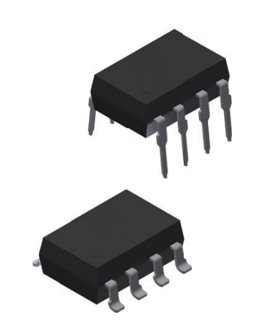

VOR2142A8, VOR2142B8 www.vishay.com Vishay Semiconductors Dual 1 Form A Solid-State Relay FEATURES • Isolation test voltage 5300 VRMS • Typical RON 22 Ω 1 8 S1 2 7 S1' 3 6 S2 4 5 S2' • Load voltage 400 V • Load current 140 mA • Clean bounce free switching • Current limit protection • Low power consumption • Wide temperature range • Material categorization: for definitions of compliance please see www.vishay.com/doc?99912 APPLICATIONS DESCRIPTION • General telecom switching The VOR2142 is a 400 V dual channel normally open optically isolated solid-state relay (SPST - 1 form A). Based on hybrid architecture which allows fast switching times with a wide operating ambient temperature range. A high efficient GaAlAs IRED enables low forward current on the input side. On the output side high performance MOSFET switches provide a low RON and can switch both DC and AC signals. • Metering • Security equipment • Instrumentation • Industrial controls • Battery management systems • Automatic test equipment AGENCY APPROVALS • UL1577, file no. E52744 • DIN EN 60747-5-5 (VDE 0884-5) ORDERING INFORMATION V O R 2 PART NUMBER PACKAGE 1 4 2 # 8 # DIP-8 PACKAGE CONFIGURATION UL, VDE SMD-8, tape and reel VOR2142B8T SMD-8, tube VOR2142B8 DIP-8, tube VOR2142A8 Rev. 1.0, 14-Jun-16 SMD-8 Document Number: 84303 1 For technical questions, contact: optocoupleranswers@vishay.com THIS DOCUMENT IS SUBJECT TO CHANGE WITHOUT NOTICE. THE PRODUCTS DESCRIBED HEREIN AND THIS DOCUMENT ARE SUBJECT TO SPECIFIC DISCLAIMERS, SET FORTH AT www.vishay.com/doc?91000 VOR2142A8, VOR2142B8 www.vishay.com Vishay Semiconductors ABSOLUTE MAXIMUM RATINGS (Tamb = 25 °C, unless otherwise specified) PARAMETER CONDITIONS SYMBOL VALUE UNIT IRED continuous forward current IF 50 mA IRED reverse voltage VR 5 V Pdiss 80 mW INPUT Input power dissipation OUTPUT DC or peak AC load voltage VL 400 V Continuous DC load current at 25 °C, one channel IL 140 mA Continuous DC load current at 25 °C, two channels IL 100 mA Pdiss 550 mW Ambient temperature range Tamb -40 to +100 °C Storage temperature range Tstg -40 to +150 °C Tsld 260 °C SSR output power dissipation SSR Soldering temperature t = 10 s max. Note • Stresses in excess of the absolute maximum ratings can cause permanent damage to the device. Functional operation of the device is not implied at these or any other conditions in excess of those given in the operational sections of this document. Exposure to absolute maximum ratings for extended periods of the time can adversely affect reliability. ELECTRICAL CHARACTERISTICS (Tamb = 25 °C, unless otherwise specified) PARAMETER TEST CONDITION SYMBOL MIN. TYP. MAX. UNIT INPUT IRED forward current, switch turn-on IL = 100 mA, t = 10 ms IFon - 0.25 2 mA IRED forward current, switch turn-off VL = ± 350 V IFoff 0.05 0.15 - mA IRED forward voltage IF = 10 mA VF - 1.36 1.5 V IRED reverse current VR = 5 V IR - - 10 μA OUTPUT On-resistance IF = 5 mA, IL = 50 mA RON - 22 27 Ω Off-resistance IF = 0 mA, VL = ± 100 V ROFF 1 5000 - GΩ Off-state leakage current Output capacitance Current limit AC/DC IF = 0 mA, VL = ± 100 V IO - 5 mA 0 -40 -20 0 20 40 60 80 0 100 0 0.5 Tamb - Ambient Temperature (°C) 1.0 1.5 2.0 VF - Forward Voltage (V) Fig. 4 - Maximum Load Current vs. Ambient Temperature Fig. 6 - Forward Current vs. Forward Voltage 2.5 Normalized Forward Current for Switch Turn-On VF - Forward Voltage (V) 1.7 1.6 1.5 IF = 10 mA 1.4 1.3 IF = 2 mA 1.2 IF = 5 mA 1.1 IL = 100 mA 2.0 1.5 1.0 0.5 Normalized to Tamb = 25 °C 0 1.0 -40 -40 -20 0 20 40 60 80 100 Tamb - Ambient Temperature (°C) Fig. 5 - Forward Voltage vs. Ambient Temperature Rev. 1.0, 14-Jun-16 -20 0 20 40 60 80 100 Tamb - Ambient Temperature (°C) Fig. 7 - Normalized Forward Current for Switch Turn-On vs. Ambient Temperature Document Number: 84303 4 For technical questions, contact: optocoupleranswers@vishay.com THIS DOCUMENT IS SUBJECT TO CHANGE WITHOUT NOTICE. THE PRODUCTS DESCRIBED HEREIN AND THIS DOCUMENT ARE SUBJECT TO SPECIFIC DISCLAIMERS, SET FORTH AT www.vishay.com/doc?91000 VOR2142A8, VOR2142B8 www.vishay.com Vishay Semiconductors 2.0 IL = 50 mA IF = 5.0 mA IL = 50 mA 1.5 Turn-On Time (ms) Normalized On-Resistance 2.0 1.0 0.5 1.5 T = 100 °C 1.0 T = 25 °C 0.5 T = -40 °C Normalized to Tamb = 25 °C 0 0 -40 -20 0 20 40 60 80 0 100 Tamb - Ambient Temperature (°C) Fig. 8 - Normalized On-Resistance vs. Ambient Temperature 30 40 50 2.0 IF = 0 mA f = 1 MHz 50 Normalized Turn-On Time Switch Capacitance (pF) 20 Fig. 11 - Turn-On Time vs. Forward Current 60 40 30 20 10 1.8 IF = 5 mA 1.6 1.4 1.2 1.0 0.8 0.6 0.4 0.2 Normalized to Tamb = 25 °C 0 0 0 10 20 30 40 50 -40 60 Fig. 9 - Output Capacitance vs. Load Voltage -20 0 20 40 60 80 100 Tamb - Ambient Temperature (°C) VL - Load Voltage (V) Fig. 12 - Normalized Turn-On Time vs. Ambient Temperature 100 0.20 IF = 0 mA IL = 50 mA T = 100 °C T = 100 °C 0.16 10 Turn-Off Time (ms) Off-State Leakage Current (nA) 10 IF - Forward Current (mA) T = 25 °C 1 T = -40 °C 0.1 0.01 0.12 T = 25 °C 0.08 T = -40 °C 0.04 0 0 100 200 300 VL - Load Voltage (V) Fig. 10 - Off-State Leakage Current vs. Load Voltage Rev. 1.0, 14-Jun-16 0 10 20 30 40 50 IF - Forward Current (mA) Fig. 13 - Turn-Off Time vs. Forward Current Document Number: 84303 5 For technical questions, contact: optocoupleranswers@vishay.com THIS DOCUMENT IS SUBJECT TO CHANGE WITHOUT NOTICE. THE PRODUCTS DESCRIBED HEREIN AND THIS DOCUMENT ARE SUBJECT TO SPECIFIC DISCLAIMERS, SET FORTH AT www.vishay.com/doc?91000 VOR2142A8, VOR2142B8 www.vishay.com Vishay Semiconductors Normalized Turn-Off Time 2.0 1.8 IF = 5.0 mA 1.6 1.4 1.2 1.0 0.8 0.6 0.4 0.2 Normalized to Tamb = 25 °C 0 -40 -20 0 20 40 60 80 100 Tamb - Ambient Temperature (°C) Fig. 14 - Normalized Turn-Off Time vs. Ambient Temperature PACKAGE DIMENSIONS (in millimeters) SMD-8 9.80 ± 0.25 10.16 max. 7.62 typ. 9.77 ± 0.13 6.65 ± 0.15 0.25 ± 0.20 0.25 ± 0.10 3.55 ± 0.25 0.79 typ. 1.00 ± 0.10 2.54 nom. 3 x 2.54 = 7.62 7 6 5 1 2 3 4 8.00 min. Leads coplanarity 0.1 max. Recommended footprint 2.54 1.50 7.62 8 0.60 min. Pin 1 I.D. 8.0 min. 1.50 11.00 Rev. 1.0, 14-Jun-16 Document Number: 84303 6 For technical questions, contact: optocoupleranswers@vishay.com THIS DOCUMENT IS SUBJECT TO CHANGE WITHOUT NOTICE. THE PRODUCTS DESCRIBED HEREIN AND THIS DOCUMENT ARE SUBJECT TO SPECIFIC DISCLAIMERS, SET FORTH AT www.vishay.com/doc?91000 VOR2142A8, VOR2142B8 www.vishay.com Vishay Semiconductors DIP-8 10.16 max. 9.77 ± 0.13 6.09 ± 0.25 1.00 ± 0.10 3.04 ± 0.25 0.70 ± 0.20 3.55 ± 0.25 0.79 typ. 7.62 typ. 6.65 ± 0.15 0.50 ± 0.10 3° to 9 ° 2.54 nom. 10 0.25 ± 0. 3 x 2.54 = 7.62 8 7 6 5 1 2 3 4 Pin 1 I.D. PACKAGE MARKING (example) 2142 V YWW 68 Fig. 15 - VOR2142 Note • Package configurations (T, A, B) are not part of the package marking. Rev. 1.0, 14-Jun-16 Document Number: 84303 7 For technical questions, contact: optocoupleranswers@vishay.com THIS DOCUMENT IS SUBJECT TO CHANGE WITHOUT NOTICE. THE PRODUCTS DESCRIBED HEREIN AND THIS DOCUMENT ARE SUBJECT TO SPECIFIC DISCLAIMERS, SET FORTH AT www.vishay.com/doc?91000 VOR2142A8, VOR2142B8 www.vishay.com Vishay Semiconductors PACKING INFORMATION (in millimeters) 2 ± 0.1 Pin 1 0.35 ± 0.05 1.5 min. 4 ± 0.1 1.75 ± 0.1 7.5 ± 0.1 CL 16 10.31 ± 0.1 12 ± 0.1 3.81 ± 0.1 + 0.3 - 0.1 10.2 ± 0.1 4.17 ± 0.1 1.5 min. Fig. 16 - Tape and Reel Packing TAPE AND REEL PACKING TYPE UNITS/REEL SMD-8 1000 TUBE PACKING TYPE UNITS/TUBE TUBES/BOX UNITS/BOX SMD-8 50 40 2000 DIP-8 50 40 2000 SOLDER PROFILES 300 300 5s Lead temperature ca. 2 K/s 2 K/s 50 full line: typical dotted line: process limits second wave Temperature (°C) Temperature (°C) 235 °C to 260 °C first wave 200 wave ca. 200 K/s 150 100 °C to 130 °C 100 200 max. 30 s 150 max. ramp down 6 °C/s 50 0 50 94 8626 100 max. 100 s max. 120 s 100 ca. 5 K/s forced cooling 0 max. 260 °C 245 °C 255 °C 240 °C 217 °C 250 250 max. ramp up 3 °C/s 0 150 200 250 Time (s) Fig. 17 - Wave Soldering Double Wave Profile According to J-STD-020 for DIP Devices 0 19841 50 100 150 200 250 300 Time (s) Fig. 18 - Lead (Pb)-free Reflow Solder Profile According to J-STD-020 for SMD Devices HANDLING AND STORAGE CONDITIONS ESD level: HBM class 2 Floor life: unlimited Conditions: Tamb < 30 °C, RH < 85 % Moisture sensitivity level 1, according to J-STD-020 Rev. 1.0, 14-Jun-16 Document Number: 84303 8 For technical questions, contact: optocoupleranswers@vishay.com THIS DOCUMENT IS SUBJECT TO CHANGE WITHOUT NOTICE. THE PRODUCTS DESCRIBED HEREIN AND THIS DOCUMENT ARE SUBJECT TO SPECIFIC DISCLAIMERS, SET FORTH AT www.vishay.com/doc?91000 Footprint and Schematic Information www.vishay.com Vishay Semiconductors Footprint and Schematic Information for VOR2142 The footprint and schematic symbols for the following parts can be accessed using the associated links. They are available in Eagle, Altium, KiCad, OrCAD / Allegro, Pulsonix, and PADS. Note that the 3D models for these parts can be found on the Vishay product page. PART NUMBER FOOTPRINT / SCHEMATIC VOR2142A8 www.snapeda.com/parts/VOR2142A8/Vishay/view-part VOR2142B8 www.snapeda.com/parts/VOR2142B8/Vishay/view-part VOR2142B8T www.snapeda.com/parts/VOR2142B8T/Vishay/view-part For technical issues and product support, please contact optocoupleranswers@vishay.com. Rev. 1.0, 15-May-17 Document Number: 84553 1 For technical questions, contact: optocoupleranswers@vishay.com THIS DOCUMENT IS SUBJECT TO CHANGE WITHOUT NOTICE. THE PRODUCTS DESCRIBED HEREIN AND THIS DOCUMENT ARE SUBJECT TO SPECIFIC DISCLAIMERS, SET FORTH AT www.vishay.com/doc?91000 Legal Disclaimer Notice www.vishay.com Vishay Disclaimer ALL PRODUCT, PRODUCT SPECIFICATIONS AND DATA ARE SUBJECT TO CHANGE WITHOUT NOTICE TO IMPROVE RELIABILITY, FUNCTION OR DESIGN OR OTHERWISE. Vishay Intertechnology, Inc., its affiliates, agents, and employees, and all persons acting on its or their behalf (collectively, “Vishay”), disclaim any and all liability for any errors, inaccuracies or incompleteness contained in any datasheet or in any other disclosure relating to any product. Vishay makes no warranty, representation or guarantee regarding the suitability of the products for any particular purpose or the continuing production of any product. To the maximum extent permitted by applicable law, Vishay disclaims (i) any and all liability arising out of the application or use of any product, (ii) any and all liability, including without limitation special, consequential or incidental damages, and (iii) any and all implied warranties, including warranties of fitness for particular purpose, non-infringement and merchantability. Statements regarding the suitability of products for certain types of applications are based on Vishay’s knowledge of typical requirements that are often placed on Vishay products in generic applications. Such statements are not binding statements about the suitability of products for a particular application. It is the customer’s responsibility to validate that a particular product with the properties described in the product specification is suitable for use in a particular application. Parameters provided in datasheets and / or specifications may vary in different applications and performance may vary over time. All operating parameters, including typical parameters, must be validated for each customer application by the customer’s technical experts. Product specifications do not expand or otherwise modify Vishay’s terms and conditions of purchase, including but not limited to the warranty expressed therein. Except as expressly indicated in writing, Vishay products are not designed for use in medical, life-saving, or life-sustaining applications or for any other application in which the failure of the Vishay product could result in personal injury or death. Customers using or selling Vishay products not expressly indicated for use in such applications do so at their own risk. Please contact authorized Vishay personnel to obtain written terms and conditions regarding products designed for such applications. No license, express or implied, by estoppel or otherwise, to any intellectual property rights is granted by this document or by any conduct of Vishay. Product names and markings noted herein may be trademarks of their respective owners. © 2019 VISHAY INTERTECHNOLOGY, INC. ALL RIGHTS RESERVED Revision: 01-Jan-2019 1 Document Number: 91000
