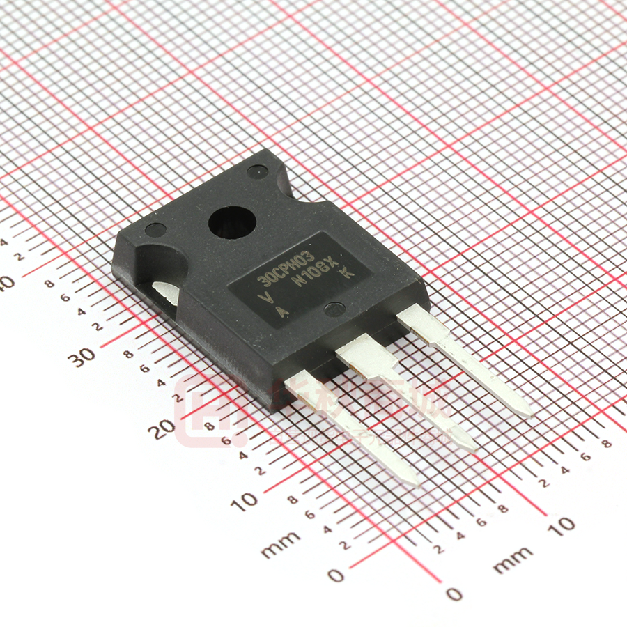

VS-30CPH03-N3 www.vishay.com Vishay Semiconductors Ultrafast Rectifier, 2 x 15 A FRED Pt® FEATURES Common cathode 2, Base • Ultrafast recovery time • Low forward voltage drop • 175 °C operating junction temperature • Low leakage current 1 • Designed and qualified according to JEDEC®-JESD 47 2 3 TO-247AC 3L 1 Anode 1 3 Anode 2 • Material categorization: for definitions of compliance please see www.vishay.com/doc?99912 DESCRIPTION / APPLICATIONS 300 V series are the state of the art ultrafast recovery rectifiers designed with optimized performance of forward voltage drop and ultrafast recovery time. The planar structure and the platinum doped life time control guarantee the best overall performance, ruggedness and reliability characteristics. These devices are intended for use in the output rectification stage of SMPS, UPS, DC/DC converters as well as freewheeling diodes in low voltage inverters and chopper motor drives. Their extremely optimized stored charge and low recovery current minimize the switching losses and reduce over dissipation in the switching element and snubbers. PRIMARY CHARACTERISTICS IF(AV) 2 x 15 A VR 300 V VF at IF 0.85 V trr typ. See Recovery table TJ max. 175 °C Package TO-247AC 3L Circuit configuration Common cathode ABSOLUTE MAXIMUM RATINGS PARAMETER SYMBOL Repetitive peak reverse voltage Average rectified forward current TEST CONDITIONS VALUES UNITS 300 V VRRM per leg total device Non-repetitive peak surge current per leg Operating junction and storage temperatures IF(AV) TC = 142 °C IFSM TJ = 25 °C, tp = 10 ms 15 30 A 140 TJ, TStg -65 to +175 °C ELECTRICAL SPECIFICATIONS (TJ = 25 °C unless otherwise specified) PARAMETER Breakdown voltage, blocking voltage SYMBOL VBR, VR TEST CONDITIONS MIN. TYP. MAX. 300 - - IF = 15 A - 1.05 1.25 IF = 15 A, TJ = 125 °C - 0.85 1.00 VR = VR rated - 0.05 40 TJ = 125 °C, VR = VR rated - 12 400 IR = 100 μA UNITS V Forward voltage VF Reverse leakage current IR Junction capacitance CT VR = 300 V - 45 - pF Series inductance LS Measured lead to lead 5 mm from package body - 8 - nH μA Revision: 15-Oct-2018 Document Number: 94012 1 For technical questions within your region: DiodesAmericas@vishay.com, DiodesAsia@vishay.com, DiodesEurope@vishay.com THIS DOCUMENT IS SUBJECT TO CHANGE WITHOUT NOTICE. THE PRODUCTS DESCRIBED HEREIN AND THIS DOCUMENT ARE SUBJECT TO SPECIFIC DISCLAIMERS, SET FORTH AT www.vishay.com/doc?91000 VS-30CPH03-N3 www.vishay.com Vishay Semiconductors DYNAMIC RECOVERY CHARACTERISTICS (TJ = 25 °C unless otherwise specified) PARAMETER TYP. MAX. - - 40 - 32 - - 45 - - 2.4 - - 6.1 - TJ = 25 °C - 38 - TJ = 125 °C - 137 - MIN. TYP. MAX. UNITS TJ, TStg -65 - 175 °C Thermal resistance, junction to case per leg RthJC - 0.9 2.0 Thermal resistance, junction to ambient per leg RthJA Typical socket mount - - 40 Thermal resistance,  case to heatsink RthCS Mounting surface, flat, smooth, and greased - 0.4 - - 6.0 - - 0.21 - oz. - 12 (10) kgf · cm (lbf ·in) Reverse recovery time SYMBOL trr TEST CONDITIONS MIN. IF = 1.0 A, dIF/dt = 50 A/μs, VR = 30 V TJ = 25 °C TJ = 125 °C Peak recovery current Reverse recovery charge IRRM Qrr TJ = 25 °C TJ = 125 °C IF = 15 A dIF/dt = - 200 A/μs VR = 200 V UNITS ns A nC THERMAL - MECHANICAL SPECIFICATIONS PARAMETER Maximum junction and storage temperature range SYMBOL TEST CONDITIONS Weight 6.0 (5.0) Mounting torque Marking device Case style TO-247AC 3L °C/W g 30CPH03 Revision: 15-Oct-2018 Document Number: 94012 2 For technical questions within your region: DiodesAmericas@vishay.com, DiodesAsia@vishay.com, DiodesEurope@vishay.com THIS DOCUMENT IS SUBJECT TO CHANGE WITHOUT NOTICE. THE PRODUCTS DESCRIBED HEREIN AND THIS DOCUMENT ARE SUBJECT TO SPECIFIC DISCLAIMERS, SET FORTH AT www.vishay.com/doc?91000 VS-30CPH03-N3 www.vishay.com Vishay Semiconductors 1000 TJ = 175 °C TJ = 125 °C TJ = 25 °C 10 1 0.4 TJ = 175 °C 100 IR - Reverse Current (µA) IF - Instantaneous Forward Current (A) 100 TJ = 150 °C TJ = 125 °C 10 1 TJ = 100 °C 0.1 0.01 TJ = 25 °C 0.001 0.6 0.8 1.0 1.2 1.4 0 1.6 50 100 150 200 250 300 VF - Forward Voltage Drop (V) VR - Reverse Voltage (V) Fig. 1 - Typical Forward Voltage Drop Characteristics Fig. 2 - Typical Values of Reverse Current vs. Reverse Voltage CT - Junction Capacitance (pF) 1000 TJ = 25 °C 100 10 0 50 100 150 200 250 300 VR - Reverse Voltage (V) Fig. 3 - Typical Junction Capacitance vs. Reverse Voltage ZthJC - Thermal Impedance (°C/W) 10 1 PDM 0.1 Single pulse (thermal resistance) 0.01 0.00001 0.0001 t1 D = 0.50 D = 0.20 D = 0.10 D = 0.05 D = 0.02 D = 0.01 0.001 t2 Notes: 1. Duty factor D = t1/t2 . 2. Peak TJ = PDM x ZthJC + TC 0.01 0.1 1 t1 - Rectangular Pulse Duration (s) Fig. 4 - Maximum Thermal Impedance ZthJC Characteristics Revision: 15-Oct-2018 Document Number: 94012 3 For technical questions within your region: DiodesAmericas@vishay.com, DiodesAsia@vishay.com, DiodesEurope@vishay.com THIS DOCUMENT IS SUBJECT TO CHANGE WITHOUT NOTICE. THE PRODUCTS DESCRIBED HEREIN AND THIS DOCUMENT ARE SUBJECT TO SPECIFIC DISCLAIMERS, SET FORTH AT www.vishay.com/doc?91000 VS-30CPH03-N3 www.vishay.com Vishay Semiconductors 100 IF = 30 A , TJ = 25 °C IF = 30 A , TJ = 125 °C 170 160 trr (ns) Allowable Case Temperature (°C) 180 DC 150 Square wave (D = 0.50) Rated VR applied 140 130 See note (1) 120 0 5 10 15 20 10 100 25 1000 IF(AV) - Average Forward Current (A) dIF/dt (A/µs) Fig. 5 - Maximum Allowable Case Temperature vs. Average Forward Current Fig. 7 - Typical Reverse Recovery Time vs. dIF/dt 22 1000 18 RMS limit 16 IF = 30 A , TJ = 125 °C 14 D = 0.01 D = 0.02 D = 0.05 D = 0.10 D = 0.20 D = 0.50 12 10 8 6 4 Qrr (nC) Average Power Loss (W) 20 DC 100 IF = 30 A , TJ = 25 °C 2 0 0 5 10 15 20 25 10 100 1000 IF(AV) - Average Forward Current (A) dIF/dt (A/µs) Fig. 6 - Forward Power Loss Characteristics Fig. 8 - Typical Stored Charge vs. dIF/dt Note Formula used: TC = TJ - (Pd + PdREV) x RthJC; Pd = forward power loss = IF(AV) x VFM at (IF(AV)/D) (see fig. 6); PdREV = inverse power loss = VR1 x IR (1 - D); IR at VR1 = rated VR    (1) Revision: 15-Oct-2018 Document Number: 94012 4 For technical questions within your region: DiodesAmericas@vishay.com, DiodesAsia@vishay.com, DiodesEurope@vishay.com THIS DOCUMENT IS SUBJECT TO CHANGE WITHOUT NOTICE. THE PRODUCTS DESCRIBED HEREIN AND THIS DOCUMENT ARE SUBJECT TO SPECIFIC DISCLAIMERS, SET FORTH AT www.vishay.com/doc?91000 VS-30CPH03-N3 www.vishay.com Vishay Semiconductors (3) trr IF ta tb 0 Qrr (2) IRRM (4) 0.5 IRRM di(rec)M/dt (5) 0.75 IRRM (1) diF/dt (4) Qrr - area under curve defined by trr and IRRM (1) diF/dt - rate of change of current through zero crossing (2) IRRM - peak reverse recovery current Qrr = (3) trr - reverse recovery time measured from zero crossing point of negative going IF to point where a line passing through 0.75 IRRM and 0.50 IRRM extrapolated to zero current. trr x IRRM 2 (5) di(rec)M/dt - peak rate of change of current during tb portion of trr Fig. 9 - Reverse Recovery Waveform and Definitions ORDERING INFORMATION TABLE Device code VS- 30 C P H 03 -N3 1 2 3 4 5 6 7 1 - Vishay Semiconductors product 2 - Current rating (30 = 30 A) 3 - Circuit configuration: C = common cathode 4 4 - Package: P = TO-247 5 - H = hyperfast recovery 6 - Voltage rating (03 = 300 V) 7 - Environmental digit: -N3 = halogen-free, RoHS-compliant, and totally lead (Pb)-free ORDERING INFORMATION (Example) PREFERRED P/N QUANTITY PER T/R MINIMUM ORDER QUANTITY PACKAGING DESCRIPTION VS-30CPH03-N3 25 500 Antistatic plastic tube LINKS TO RELATED DOCUMENTS Dimensions www.vishay.com/doc?96138 Part marking information www.vishay.com/doc?95007 SPICE models www.vishay.com/doc?96568 Revision: 15-Oct-2018 Document Number: 94012 5 For technical questions within your region: DiodesAmericas@vishay.com, DiodesAsia@vishay.com, DiodesEurope@vishay.com THIS DOCUMENT IS SUBJECT TO CHANGE WITHOUT NOTICE. THE PRODUCTS DESCRIBED HEREIN AND THIS DOCUMENT ARE SUBJECT TO SPECIFIC DISCLAIMERS, SET FORTH AT www.vishay.com/doc?91000 Outline Dimensions www.vishay.com Vishay Semiconductors TO-247AC 3L DIMENSIONS in millimeters and inches A A E (3) B A2 S R/2 (2) (Datum B) Ø P (6) Ø P1 Ø K M DBM A Q D2 2 x R (2) D1 (4) D Thermal pad 2 1 4 D 3 L1 (5) C L A See view B 2 x b2 3xb 0.10 M C A M C 2x e A1 b4 E1 (4) 0.01 M D B M (b1, b3, b5) Plating View A - A Base metal D DE (c) c1 (b, b2, b4) C A A1 A2 b b1 b2 b3 b4 b5 c c1 D D1 MILLIMETERS MIN. MAX. 4.65 5.31 2.21 2.59 1.17 1.37 0.99 1.40 0.99 1.35 1.65 2.39 1.65 2.34 2.59 3.43 2.59 3.38 0.38 0.89 0.38 0.84 19.71 20.70 13.08 - C (4) View B Section C - C, D - D, E - E SYMBOL E INCHES MIN. MAX. 0.183 0.209 0.087 0.102 0.046 0.054 0.039 0.055 0.039 0.053 0.065 0.094 0.065 0.092 0.102 0.135 0.102 0.133 0.015 0.035 0.015 0.033 0.776 0.815 0.515 - NOTES 3 4 SYMBOL D2 E E1 e ØK L L1 ØP Ø P1 Q R S MILLIMETERS MIN. MAX. 0.51 1.35 15.29 15.87 13.46 5.46 BSC 0.254 14.20 16.10 3.71 4.29 3.56 3.66 7.39 5.31 5.69 4.52 5.49 5.51 BSC INCHES MIN. MAX. 0.020 0.053 0.602 0.625 0.53 0.215 BSC 0.010 0.559 0.634 0.146 0.169 0.14 0.144 0.291 0.209 0.224 0.178 0.216 0.217 BSC NOTES 3 Notes (1) Dimensioning and tolerancing per ASME Y14.5M-1994 (2) Contour of slot optional (3) Dimension D and E do not include mold flash. Mold flash shall not exceed 0.127 mm (0.005") per side. These dimensions are measured at the outermost extremes of the plastic body (4) Thermal pad contour optional with dimensions D1 and E1 (5) Lead finish uncontrolled in L1 (6) Ø P to have a maximum draft angle of 1.5 to the top of the part with a maximum hole diameter of 3.91 mm (0.154") (7) Outline conforms to JEDEC® outline TO-247 with exception of dimension Q Revision: 20-Jun-17 Document Number: 96138 1 For technical questions within your region: DiodesAmericas@vishay.com, DiodesAsia@vishay.com, DiodesEurope@vishay.com THIS DOCUMENT IS SUBJECT TO CHANGE WITHOUT NOTICE. THE PRODUCTS DESCRIBED HEREIN AND THIS DOCUMENT ARE SUBJECT TO SPECIFIC DISCLAIMERS, SET FORTH AT www.vishay.com/doc?91000 Legal Disclaimer Notice www.vishay.com Vishay Disclaimer ALL PRODUCT, PRODUCT SPECIFICATIONS AND DATA ARE SUBJECT TO CHANGE WITHOUT NOTICE TO IMPROVE RELIABILITY, FUNCTION OR DESIGN OR OTHERWISE. Vishay Intertechnology, Inc., its affiliates, agents, and employees, and all persons acting on its or their behalf (collectively, “Vishay”), disclaim any and all liability for any errors, inaccuracies or incompleteness contained in any datasheet or in any other disclosure relating to any product. Vishay makes no warranty, representation or guarantee regarding the suitability of the products for any particular purpose or the continuing production of any product. To the maximum extent permitted by applicable law, Vishay disclaims (i) any and all liability arising out of the application or use of any product, (ii) any and all liability, including without limitation special, consequential or incidental damages, and (iii) any and all implied warranties, including warranties of fitness for particular purpose, non-infringement and merchantability. Statements regarding the suitability of products for certain types of applications are based on Vishay's knowledge of typical requirements that are often placed on Vishay products in generic applications. Such statements are not binding statements about the suitability of products for a particular application. It is the customer's responsibility to validate that a particular product with the properties described in the product specification is suitable for use in a particular application. Parameters provided in datasheets and / or specifications may vary in different applications and performance may vary over time. All operating parameters, including typical parameters, must be validated for each customer application by the customer's technical experts. Product specifications do not expand or otherwise modify Vishay's terms and conditions of purchase, including but not limited to the warranty expressed therein. Hyperlinks included in this datasheet may direct users to third-party websites. These links are provided as a convenience and for informational purposes only. Inclusion of these hyperlinks does not constitute an endorsement or an approval by Vishay of any of the products, services or opinions of the corporation, organization or individual associated with the third-party website. Vishay disclaims any and all liability and bears no responsibility for the accuracy, legality or content of the third-party website or for that of subsequent links. Except as expressly indicated in writing, Vishay products are not designed for use in medical, life-saving, or life-sustaining applications or for any other application in which the failure of the Vishay product could result in personal injury or death. Customers using or selling Vishay products not expressly indicated for use in such applications do so at their own risk. Please contact authorized Vishay personnel to obtain written terms and conditions regarding products designed for such applications. No license, express or implied, by estoppel or otherwise, to any intellectual property rights is granted by this document or by any conduct of Vishay. Product names and markings noted herein may be trademarks of their respective owners. © 2022 VISHAY INTERTECHNOLOGY, INC. ALL RIGHTS RESERVED Revision: 01-Jan-2022 1 Document Number: 91000
