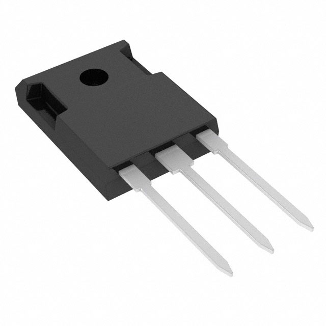

VS-35EPF06LHM3, VS-35APF06LHM3 www.vishay.com Vishay Semiconductors Fast Soft Recovery Rectifier Diode, 35 A FEATURES 2 1 1 2 3 3 TO-247AD 2L TO-247AD 3L Base cathode 2 Base cathode 2 • Very low forward voltage drop • Glass passivated pellet chip junction • AEC-Q101 qualified meets JESD 201 class 1A whisker test • Flexible solution for reliable AC power rectification • High surge, low VF rugged blocking diode for DC charging stations • Material categorization: for definitions of compliance please see www.vishay.com/doc?99912 APPLICATIONS 1 Cathode 3 Anode VS-35EPF06LHM3 3 Anode 1 Anode • On-board and off-board EV / HEV battery chargers • Renewable energy inverters VS-35APF06LHM3 DESCRIPTION PRIMARY CHARACTERISTICS IF(AV) 35 A VR 600 V VF at IF 1.27 V IFSM 320 A trr 60 ns TJ max. 150 °C Package TO-247AD 2L, TO-247AD 3L Circuit configuration Single Snap factor 0.6 High voltage rectifiers optimized for very low forward voltage drop with moderate leakage, and short reverse recovery time. These devices are intended for use in main rectification (single or three phase bridge)       MAJOR RATINGS AND CHARACTERISTICS SYMBOL IF(AV) CHARACTERISTICS Sinusoidal waveform VALUES UNITS 35 A VRRM 600 V IFSM 320 A VF 15 A, TJ = 25 °C trr 1 A, 100 A /μs TJ 1.27 V 60 ns -40 to +150 °C VOLTAGE RATINGS PART NUMBER VRSM, MAXIMUM VRRM, MAXIMUM NON-REPETITIVE PEAK REVERSE PEAK REVERSE VOLTAGE VOLTAGE V V VS-35EPF06LHM3 600 700 VS-35APF06LHM3 600 700 IRRM AT 150 °C mA 6 Revision: 22-Feb-18 Document Number: 96494 1 For technical questions within your region: DiodesAmericas@vishay.com, DiodesAsia@vishay.com, DiodesEurope@vishay.com THIS DOCUMENT IS SUBJECT TO CHANGE WITHOUT NOTICE. THE PRODUCTS DESCRIBED HEREIN AND THIS DOCUMENT ARE SUBJECT TO SPECIFIC DISCLAIMERS, SET FORTH AT www.vishay.com/doc?91000 VS-35EPF06LHM3, VS-35APF06LHM3 www.vishay.com Vishay Semiconductors ABSOLUTE MAXIMUM RATINGS PARAMETER SYMBOL TEST CONDITIONS VALUES Maximum average forward current IF(AV) TC = 103 °C, 180° conduction half sine wave 35 Maximum peak one cycle  non-repetitive surge current IFSM Maximum I2t for fusing I2t Maximum I2t for fusing I2t 10 ms sine pulse, rated VRRM applied 270 10 ms sine pulse, no voltage reapplied 320 UNITS A 10 ms sine pulse, rated VRRM applied 365 10 ms sine pulse, no voltage reapplied 515 t = 0.1 ms to 10 ms, no voltage reapplied 5150 A2s VALUES UNITS A2s ELECTRICAL SPECIFICATIONS PARAMETER SYMBOL Maximum forward voltage drop VFM Forward slope resistance rt Threshold voltage VF(TO) Maximum reverse leakage current IRM TEST CONDITIONS 35 A, TJ = 25 °C TJ = 150 °C TJ = 25 °C TJ = 150 °C 1.46 V 12.5 m 0.90 V 0.1 VR = rated VRRM mA 6 RECOVERY CHARACTERISTICS PARAMETER SYMBOL Reverse recovery time trr Reverse recovery current Irr Reverse recovery charge Qrr Snap factor S TEST CONDITIONS IF at 20 Apk 100 A/μs 25 °C Typical VALUES UNITS 160 ns 10 A 1.25 IFM trr ta tb dir dt μC t Qrr IRM(REC) 0.6 THERMAL - MECHANICAL SPECIFICATIONS PARAMETER SYMBOL Maximum junction and storage  temperature range TEST CONDITIONS TJ, TStg Maximum thermal resistance,  unction to case RthJC Maximum thermal resistance,  junction to ambient RthJA Typical thermal resistance,  case to heatsink RthCS DC operation Marking device UNITS -40 to +150 °C 0.6 °C/W 40 Mounting surface, smooth, and greased 0.25 6 g 0.21 oz. minimum 6 (5) maximum 12 (10) kgf · cm (lbf · in) Approximate weight Mounting torque VALUES Case style TO-247AD 2L 35EPF06LH Case style TO-247AD 3L 35APF06LH Revision: 22-Feb-18 Document Number: 96494 2 For technical questions within your region: DiodesAmericas@vishay.com, DiodesAsia@vishay.com, DiodesEurope@vishay.com THIS DOCUMENT IS SUBJECT TO CHANGE WITHOUT NOTICE. THE PRODUCTS DESCRIBED HEREIN AND THIS DOCUMENT ARE SUBJECT TO SPECIFIC DISCLAIMERS, SET FORTH AT www.vishay.com/doc?91000 VS-35EPF06LHM3, VS-35APF06LHM3 150 RthJC (DC) = 0.60 °C/W 140 130 Conduction angle 120 110 100 60° 90 120° 30° 90° 180° 80 0 5 10 15 20 25 30 35 40 90 180° 120° 90° 60° 30° 80 70 60 50 RMS limit 40 30 Conduction angle 20 10 TJ = 150 °C 0 0 10 20 30 40 50 60 Average On-state Current (A) Fig. 1 - Current Rating Characteristics Fig. 4 - Forward Power Loss Characteristics RthJC (DC) = 0.60 °C/W 140 Ø 130 Conduction Period 120 110 100 30° DC 120° 60° 90 90° 180° 80 10 20 30 40 50 60 350 At any rated load condition and with rated VRRM applied following surge. 300 Initial TJ = 150 °C at 60 Hz 0.0083 s at 50 Hz 0.0100 s 250 200 150 100 50 1 Fig. 2 - Current Rating Characteristics 10 100 Number of Equal Amplitude Half Cycle Current Pulses (N) Average On-State Current (A) Fig. 5 - Maximum Non-Repetitive Surge Current 350 70 180° 120° 90° 60° 30° 60 50 300 Peak Half Sine Wave Forward Current (A) Max. Average On-State Power Loss (W) DC Average On-State Current (A) 150 0 Max. Average On-state Power Loss (W) Vishay Semiconductors Peak Half Sine Wave Forward Current (A) Max. Allowable Case Temperature ( °C) Max. Allowable Case Temperature (°C) www.vishay.com 40 RMS limit 30 20 Conduction angle 10 0 10 20 200 150 100 50 TJ = 150 °C 0 250 Maximum non-repetitive surge current vs. pulse train duration. Initial TJ = 150 °C No voltage reapplied Rated VRRM reapplied 30 40 0 0.01 0.1 1 10 Average On-State Current (A) Pulse Train Duration (s) Fig. 3 - Forward Power Loss Characteristics Fig. 6 - Maximum Non-Repetitive Surge Current Revision: 22-Feb-18 Document Number: 96494 3 For technical questions within your region: DiodesAmericas@vishay.com, DiodesAsia@vishay.com, DiodesEurope@vishay.com THIS DOCUMENT IS SUBJECT TO CHANGE WITHOUT NOTICE. THE PRODUCTS DESCRIBED HEREIN AND THIS DOCUMENT ARE SUBJECT TO SPECIFIC DISCLAIMERS, SET FORTH AT www.vishay.com/doc?91000 VS-35EPF06LHM3, VS-35APF06LHM3 1000 4.0 IFM = 30 A TJ = 25 °C Qrr - Typical Reverse Recovery Charge (µC) 3.5 100 TJ = 25 °C TJ = 150 °C 10 1 IFM = 20 A 3.0 2.5 2.0 IFM = 10 A 1.5 1.0 IFM = 5 A 0.5 IFM = 1 A 0 0 1 2 3 4 0 5 200 400 1000 dI/dt - Rate of Fall of Forward Current (A/µs) Fig. 7 - Forward Voltage Drop Characteristics Fig. 10 - Recovery Charge Characteristics, TJ = 25 °C 10 IFM = 30 A IFM = 20 A IFM = 10 A TJ = 25 °C 0.15 TJ = 150 °C 9 IFM = 5 A IFM = 1 A 0.10 0.05 IFM = 30 A 8 7 IFM = 20 A 6 5 IFM = 10 A 4 3 IFM = 5 A 2 1 IFM = 1 A 0 0 0 200 400 600 800 0 1000 200 400 600 800 1000 dI/dt - Rate of Fall of Forward Current (A/µs) dI/dt - Rate of Fall of Forward Current (A/µs) Fig. 8 - Thermal Impedance ZthJC Characteristics Fig. 11 - Recovery Charge Characteristics, TJ = 150 °C 0.5 70 TJ = 150 °C TJ = 25 °C 60 0.4 Irr - Typical Reverse Recovery Current (A) trr - Typical Reverse Recovery Time (µs) 800 600 Instantaneous Forward Voltage (V) 0.20 trr - Typical Reverse Recovery Time (µs) Vishay Semiconductors Qrr - Typical Reverse Recovery Charge (µC) Instantaneous Forward Current (A) www.vishay.com IFM = 30 A IFM = 20 A IFM = 10 A IFM = 5 A IFM = 1 A 0.3 0.2 0.1 IFM = 30 A IFM = 20 A 50 40 IFM = 10 A 30 IFM = 5 A 20 IFM = 1 A 10 0 0 0 200 400 600 800 1000 0 200 400 600 800 1000 dI/dt - Rate of Fall of Forward Current (A/µs) dI/dt - Rate of Fall of Forward Current (A/µs) Fig. 9 - Recovery Time Characteristics, TJ = 150 °C Fig. 12 - Recovery Current Characteristics, TJ = 25 °C Revision: 22-Feb-18 Document Number: 96494 4 For technical questions within your region: DiodesAmericas@vishay.com, DiodesAsia@vishay.com, DiodesEurope@vishay.com THIS DOCUMENT IS SUBJECT TO CHANGE WITHOUT NOTICE. THE PRODUCTS DESCRIBED HEREIN AND THIS DOCUMENT ARE SUBJECT TO SPECIFIC DISCLAIMERS, SET FORTH AT www.vishay.com/doc?91000 VS-35EPF06LHM3, VS-35APF06LHM3 www.vishay.com Vishay Semiconductors 100 Irr - Typical Reverse Recovery Current (A) TJ = 150 °C IFM = 30 A 80 IFM = 20 A 60 IFM = 10 A 40 IFM = 5 A 20 IFM = 1 A 0 0 200 400 600 800 1000 dI/dt - Rate of Fall of Forward Current (A/µs) ZthJC - Transient Thermal Impedance (°C/W) Fig. 13 - Recovery Current Characteristics, TJ = 150 °C 1 0.5 Steady state value (DC operation) 0.33 0.25 0.17 0.1 0.08 Single Pulse 0.01 0.0001 0.001 0.01 0.1 1 Square Wave Pulse Duration (s) Fig. 14 - Thermal Impedance ZthJC Characteristics Revision: 22-Feb-18 Document Number: 96494 5 For technical questions within your region: DiodesAmericas@vishay.com, DiodesAsia@vishay.com, DiodesEurope@vishay.com THIS DOCUMENT IS SUBJECT TO CHANGE WITHOUT NOTICE. THE PRODUCTS DESCRIBED HEREIN AND THIS DOCUMENT ARE SUBJECT TO SPECIFIC DISCLAIMERS, SET FORTH AT www.vishay.com/doc?91000 VS-35EPF06LHM3, VS-35APF06LHM3 www.vishay.com Vishay Semiconductors ORDERING INFORMATION TABLE Device code VS- 35 E P F 06 L H M3 1 2 3 4 5 6 7 8 9 1 - Vishay Semiconductors product 2 - Current rating (35 = 35 A) 3 - Circuit configuration: E = single, 2 pins A = single, 3 pins 4 - 5 - Package: P = TO-247AD Type of silicon: F = fast recovery rectifier 6 - Voltage code x 100 = VRRM 7 - L = long leads 8 - H = AEC-Q101 qualified 9 - Environmental digit: 06 = 600 V M3 = halogen-free, RoHS-compliant, and terminations lead (Pb)-free ORDERING INFORMATION (Example) PREFERRED P/N QUANTITY PER T/R MINIMUM ORDER QUANTITY PACKAGING DESCRIPTION VS-35EPF06LHM3 25 500 Antistatic plastic tubes VS-35APF06LHM3 25 500 Antistatic plastic tubes LINKS TO RELATED DOCUMENTS Dimensions Part marking information TO-247AD 2L www.vishay.com/doc?95536 TO-247AD 3L www.vishay.com/doc?95626 TO-247AD 2L www.vishay.com/doc?95648 TO-247AD 3L www.vishay.com/doc?95007 Revision: 22-Feb-18 Document Number: 96494 6 For technical questions within your region: DiodesAmericas@vishay.com, DiodesAsia@vishay.com, DiodesEurope@vishay.com THIS DOCUMENT IS SUBJECT TO CHANGE WITHOUT NOTICE. THE PRODUCTS DESCRIBED HEREIN AND THIS DOCUMENT ARE SUBJECT TO SPECIFIC DISCLAIMERS, SET FORTH AT www.vishay.com/doc?91000 Outline Dimensions www.vishay.com Vishay Semiconductors TO-247AD 2L DIMENSIONS in millimeters and inches A A (3) (6) F P E B (2) R/2 A2 S (Datum B) Ø K M D BM F P1 A D2 Q 2xR (2) D1 (4) D 1, 2 4 D 3 Thermal pad (5) L1 C L See view B (4) E1 A 0.01 M D B M View A - A C 2 x b2 2xb 2x e A1 0.10 M C A M (b1, b3) Plating Base metal D D (c) c1 C C (b, b2) (4) Section C - C, D - D SYMBOL MILLIMETERS View B INCHES MIN. MAX. MIN. MAX. A 4.65 5.31 0.183 0.209 A1 2.21 2.59 0.087 0.102 NOTES SYMBOL MILLIMETERS INCHES MIN. MAX. MIN. MAX. E 15.29 15.87 0.602 0.625 E1 13.46 - 0.53 - A2 1.50 2.49 0.059 0.098 e 5.46 BSC b 0.99 1.40 0.039 0.055 ØK 0.254 b1 0.99 1.35 0.039 0.053 L 19.81 20.32 0.780 0.800 b2 1.65 2.39 0.065 0.094 L1 3.71 4.29 0.146 0.169 b3 1.65 2.34 0.065 0.092 ØP 3.56 3.66 0.14 0.144 c 0.38 0.89 0.015 0.035 Ø P1 - 6.98 - 0.275 NOTES 3 0.215 BSC 0.010 c1 0.38 0.84 0.015 0.033 Q 5.31 5.69 0.209 0.224 D 19.71 20.70 0.776 0.815 3 R 4.52 5.49 0.178 0.216 D1 13.08 - 0.515 - 4 S D2 0.51 1.35 0.020 0.053 5.51 BSC 0.217 BSC Notes (1) Dimensioning and tolerancing per ASME Y14.5M-1994 (2) Contour of slot optional (3) Dimension D and E do not include mold flash. These dimensions are measured at the outermost extremes of the plastic body (4) Thermal pad contour optional with dimensions D1 and E1 (5) Lead finish uncontrolled in L1 (6) Ø P to have a maximum draft angle of 1.5 to the top of the part with a maximum hole diameter of 3.91 mm (0.154") (7) Outline conforms to JEDEC® outline TO-247 with exception of dimension A min., D, E min., Q min., S, and note 4 Revision: 28-May-2018 Document Number: 95536 1 For technical questions within your region: DiodesAmericas@vishay.com, DiodesAsia@vishay.com, DiodesEurope@vishay.com THIS DOCUMENT IS SUBJECT TO CHANGE WITHOUT NOTICE. THE PRODUCTS DESCRIBED HEREIN AND THIS DOCUMENT ARE SUBJECT TO SPECIFIC DISCLAIMERS, SET FORTH AT www.vishay.com/doc?91000 Outline Dimensions www.vishay.com Vishay Semiconductors TO-247AD 3L DIMENSIONS in millimeters and inches A A (3) (6) Φ P E B (2) R/2 A2 S (Datum B) Ø K M DBM Φ P1 A D2 Q 2xR (2) D1 (4) D 1 4 D 3 2 Thermal pad (5) L1 C L (4) E1 A 0.01 M D B M View A - A See view B 2 x b2 3xb C 2x e b4 A1 0.10 M C A M (b1, b3, b5) Plating Base metal D DE (c) c1 E C C (b, b2, b4) (4) Section C - C, D - D, E - E SYMBOL A A1 A2 b b1 b2 b3 b4 b5 c c1 D D1 MILLIMETERS MIN. MAX. 4.65 5.31 2.21 2.59 1.50 2.49 0.99 1.40 0.99 1.35 1.65 2.39 1.65 2.34 2.59 3.43 2.59 3.38 0.38 0.89 0.38 0.84 19.71 20.70 13.08 - INCHES MIN. MAX. 0.183 0.209 0.087 0.102 0.059 0.098 0.039 0.055 0.039 0.053 0.065 0.094 0.065 0.092 0.102 0.135 0.102 0.133 0.015 0.035 0.015 0.033 0.776 0.815 0.515 - View B NOTES 3 4 SYMBOL D2 E E1 e ØK L L1 ØP Ø P1 Q R S MILLIMETERS MIN. MAX. 0.51 1.30 15.29 15.87 13.46 5.46 BSC 0.254 19.81 20.32 3.71 4.29 3.56 3.66 6.98 5.31 5.69 4.52 5.49 5.51 BSC INCHES MIN. MAX. 0.020 0.051 0.602 0.625 0.53 0.215 BSC 0.010 0.780 0.800 0.146 0.169 0.14 0.144 0.275 0.209 0.224 0.178 0.216 0.217 BSC NOTES 3 Notes (1) Dimensioning and tolerancing per ASME Y14.5M-1994 (2) Contour of slot optional (3) Dimension D and E do not include mold flash. These dimensions are measured at the outermost extremes of the plastic body (4) Thermal pad contour optional with dimensions D1 and E1 (5) Lead finish uncontrolled in L1 (6) Ø P to have a maximum draft angle of 1.5 to the top of the part with a maximum hole diameter of 3.91 mm (0.154") (7) Outline conforms to JEDEC® outline TO-247 with exception of dimension A min., D, E min., Q min., S, and note 4 Revision: 06-Mar-2020 Document Number: 95626 1 For technical questions within your region: DiodesAmericas@vishay.com, DiodesAsia@vishay.com, DiodesEurope@vishay.com THIS DOCUMENT IS SUBJECT TO CHANGE WITHOUT NOTICE. THE PRODUCTS DESCRIBED HEREIN AND THIS DOCUMENT ARE SUBJECT TO SPECIFIC DISCLAIMERS, SET FORTH AT www.vishay.com/doc?91000 Legal Disclaimer Notice www.vishay.com Vishay Disclaimer ALL PRODUCT, PRODUCT SPECIFICATIONS AND DATA ARE SUBJECT TO CHANGE WITHOUT NOTICE TO IMPROVE RELIABILITY, FUNCTION OR DESIGN OR OTHERWISE. Vishay Intertechnology, Inc., its affiliates, agents, and employees, and all persons acting on its or their behalf (collectively, “Vishay”), disclaim any and all liability for any errors, inaccuracies or incompleteness contained in any datasheet or in any other disclosure relating to any product. Vishay makes no warranty, representation or guarantee regarding the suitability of the products for any particular purpose or the continuing production of any product. To the maximum extent permitted by applicable law, Vishay disclaims (i) any and all liability arising out of the application or use of any product, (ii) any and all liability, including without limitation special, consequential or incidental damages, and (iii) any and all implied warranties, including warranties of fitness for particular purpose, non-infringement and merchantability. Statements regarding the suitability of products for certain types of applications are based on Vishay's knowledge of typical requirements that are often placed on Vishay products in generic applications. Such statements are not binding statements about the suitability of products for a particular application. It is the customer's responsibility to validate that a particular product with the properties described in the product specification is suitable for use in a particular application. Parameters provided in datasheets and / or specifications may vary in different applications and performance may vary over time. All operating parameters, including typical parameters, must be validated for each customer application by the customer's technical experts. Product specifications do not expand or otherwise modify Vishay's terms and conditions of purchase, including but not limited to the warranty expressed therein. Hyperlinks included in this datasheet may direct users to third-party websites. These links are provided as a convenience and for informational purposes only. Inclusion of these hyperlinks does not constitute an endorsement or an approval by Vishay of any of the products, services or opinions of the corporation, organization or individual associated with the third-party website. Vishay disclaims any and all liability and bears no responsibility for the accuracy, legality or content of the third-party website or for that of subsequent links. Except as expressly indicated in writing, Vishay products are not designed for use in medical, life-saving, or life-sustaining applications or for any other application in which the failure of the Vishay product could result in personal injury or death. Customers using or selling Vishay products not expressly indicated for use in such applications do so at their own risk. Please contact authorized Vishay personnel to obtain written terms and conditions regarding products designed for such applications. No license, express or implied, by estoppel or otherwise, to any intellectual property rights is granted by this document or by any conduct of Vishay. Product names and markings noted herein may be trademarks of their respective owners. © 2021 VISHAY INTERTECHNOLOGY, INC. ALL RIGHTS RESERVED Revision: 09-Jul-2021 1 Document Number: 91000
