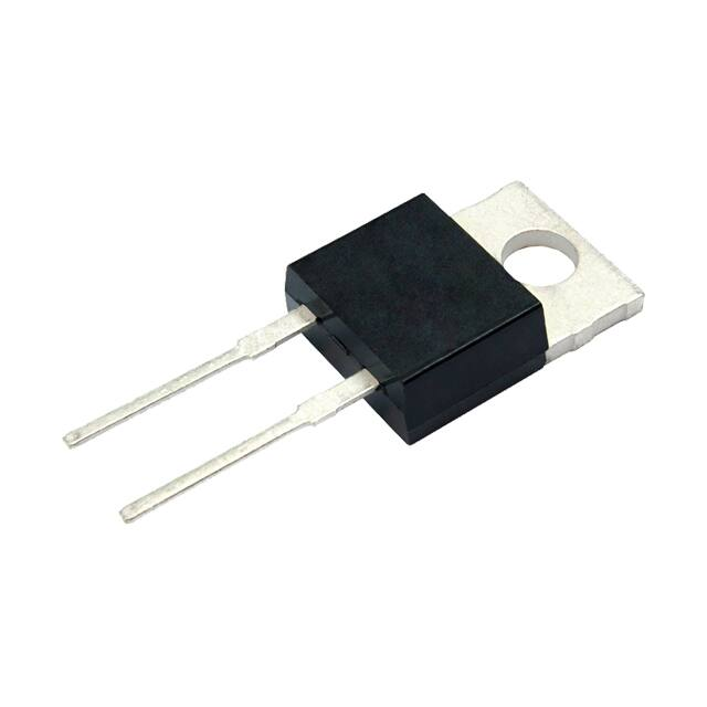

VS-C08ET07T-M3 www.vishay.com Vishay Semiconductors 650 V Power SiC Merged PIN Schottky Diode, 8 A FEATURES Base cathode 2 • Majority carrier diode using Schottky technology on SiC wide band gap material • Positive VF temperature coefficient for easy paralleling 2 1 3 2L TO-220AC • • • • Virtually no recovery tail and no switching losses Temperature invariant switching behavior 175 °C maximum operating junction temperature MPS structure for high ruggedness to forward current surge events • Meets JESD 201 class 1A whisker test • Solder Bath temperature 275 °C maximum, 10 s per JESD 22-B106 • Material categorization: for definitions of compliance please see www.vishay.com/doc?99912 3 Anode 1 Cathode LINKS TO ADDITIONAL RESOURCES 3D 3D 3D Models Models Application Notes PRIMARY CHARACTERISTICS DESCRIPTION / APPLICATIONS IF(AV) 8A VR 650 V VF at IF at 150 °C 1.7 V TJ max. 175 °C IR at VR at 175 °C 5 μA QC (VR = 400 V) 23 nC Package 2L TO-220AC Circuit configuration Single Wide band gap SiC based 650 V Schottky diode, designed for high performance and ruggedness. Optimum choice for high speed hard switching and efficient operation over a wide temperature range, it is also recommended for all applications suffering from Silicon ultrafast recovery behavior. Typical applications include AC/DC PFC and DC/DC ultra high frequency output rectification in FBPS and LLC converters. MECHANICAL DATA Case: 2L TO-220AC Molding compound meets UL 94 V-0 flammability rating Base P/N-M3 - halogen-free, RoHS-compliant Terminals: matte tin plated leads, solderable per J-STD-002 and JESD 22-B102 Mounting torque: 10 in-lbs maximum ABSOLUTE MAXIMUM RATINGS (TA = 25 °C unless otherwise specified) PARAMETER SYMBOL Peak repetitive reverse voltage VRRM Average rectified forward current IF(AV) DC blocking voltage VDC Repetitive peak surge current IFRM Non-repetitive peak forward surge current IFSM Power dissipation Ptot (1) I2t value i Operating junction and storage temperatures 2 dt TEST CONDITIONS TC = 126 °C (DC) TC = 25 °C, f = 50 Hz, square wave, DC = 25 % VALUES V 8 A 650 V 29.5 TC = 25 °C, tp = 10 ms, half sine wave 57 TC = 110 °C, tp = 10 ms, half sine wave 49 TC = 25 °C 54 TC = 110 °C 23 TC = 25 °C 16 TC = 110 °C 12 TJ (2), TStg UNITS 650 -55 to +175 A W A2s °C Notes (1) Based on maximum R th (2) The heat generated must be less than the thermal conductivity from junction-to-ambient: dP /dT < 1/R D J θJA Revision: 16-Apr-2021 Document Number: 96718 1 For technical questions within your region: DiodesAmericas@vishay.com, DiodesAsia@vishay.com, DiodesEurope@vishay.com THIS DOCUMENT IS SUBJECT TO CHANGE WITHOUT NOTICE. THE PRODUCTS DESCRIBED HEREIN AND THIS DOCUMENT ARE SUBJECT TO SPECIFIC DISCLAIMERS, SET FORTH AT www.vishay.com/doc?91000 VS-C08ET07T-M3 www.vishay.com Vishay Semiconductors ELECTRICAL SPECIFICATIONS (TJ = 25 °C unless otherwise specified) PARAMETER SYMBOL Forward voltage TEST CONDITIONS VF Reverse leakage current IR Total capacitance C Total capacitive charge QC MIN. TYP. MAX. IF = 8 A - 1.50 1.80 IF = 8 A, TJ = 150 °C - 1.7 2.1 IF = 8 A, TJ = 175 °C - 1.8 - UNITS V VR = VR rated - - 45 VR = VR rated, TJ = 150 °C - - 100 VR = VR rated, TJ = 175 °C - 5 - VR = 1 V, f = 1 MHz - 355 - VR = 400 V, f = 1 MHz - 37 - VR = 400 V, f = 1 MHz - 23 - nC MIN. TYP. MAX. UNITS - 2 2.8 °C/W μA pF THERMAL - MECHANICAL SPECIFICATIONS (TA = 25 °C unless otherwise specified) PARAMETER SYMBOL Thermal resistance, junction-to-case TEST CONDITIONS RthJC Marking device C08ET07T Axis Title Axis Title 10000 TJ = 25 °C 12 10 1000 TJ = -55 °C TJ = 125 °C TJ = 150 °C TJ = 175 °C 8 6 100 4 2 10 0 0 0.5 1.0 1.5 2.0 2.5 10000 1000 1st line 2nd line 14 2nd line CT - Junction Capacitance (pF) 1000 1st line 2nd line 100 100 TJ = 25 °C f = 1.0 MHz 10 0.1 3.0 10 100 10 1000 VF - Forward Voltage Drop (V) VR - Reverse Voltage (V) Fig. 1 - Typical Forward Voltage Drop Characteristics Fig. 3 - Typical Junction Capacitance vs. Reverse Voltage Axis Title Axis Title 10 1000 10000 10000 1 1000 TJ = 175 °C 0.1 TJ = 150 °C 2nd line IFSM (A) 1000 1st line 2nd line 2nd line IR - Reverse Current (µA) 1 TJ = 25 °C 1st line 2nd line 2nd line IF - Instantaneous Forward Current (A) 16 100 TJ = 110 °C 100 100 TJ = 125 °C TJ = 25 °C TJ = -55 °C 0.01 10 0.001 0 100 200 300 400 500 600 700 10 0.0001 0.001 10 0.01 VR - Reverse Voltage (V) tp (s) Fig. 2 - Typical Values of Reverse Current vs. Reverse Voltage Fig. 4 - Non-Repetitive Peak Forward Surge Current vs. Pulse Duration (Square Wave) Revision: 16-Apr-2021 Document Number: 96718 2 For technical questions within your region: DiodesAmericas@vishay.com, DiodesAsia@vishay.com, DiodesEurope@vishay.com THIS DOCUMENT IS SUBJECT TO CHANGE WITHOUT NOTICE. THE PRODUCTS DESCRIBED HEREIN AND THIS DOCUMENT ARE SUBJECT TO SPECIFIC DISCLAIMERS, SET FORTH AT www.vishay.com/doc?91000 VS-C08ET07T-M3 www.vishay.com Vishay Semiconductors 10000 1 1000 1st line 2nd line ZthJC - Thermal Impedance Junction to Case (°C/W) Axis Title 10 D = 0.5 D = 0.2 D = 0.1 D = 0.05 D = 0.02 D = 0.01 DC 0.1 0.01 0.00001 0.0001 100 10 0.001 0.01 0.1 1 10 t1 - Rectangular Pulse Duration (s) Fig. 5 - Typical Thermal Impedance ZthJC Characteristics Axis Title Axis Title 10000 10000 9 8 100 100 75 7 1000 6 1st line 2nd line 1000 125 2nd line Capacitive Energy (µJ) 150 1st line 2nd line 2nd line Allowable Case Temperature (°C) 175 5 4 100 3 TJ = 25 °C f = 1.0 MHz 2 50 1 10 25 0 2 4 6 8 10 0 10 0 100 200 400 500 600 700 IF(AV) - Average Forward Output Current (A) Reverse Voltage (V) Fig. 6 - Maximum Allowable Case Temperature vs. Average Forward Current Fig. 8 - Typical Capacitive Energy vs. Reverse Voltage Axis Title Axis Title 10000 80 10000 35 70 RthJC typ. 40 30 RthJC max. 100 20 25 1000 1st line 2nd line 1000 50 2nd line Capacitive Charge (nC) 30 60 1st line 2nd line 2nd line Allowable Input Power (W) 300 20 15 100 TJ = 25 °C f = 1.0 MHz 10 5 10 10 0 25 50 75 100 125 150 175 10 0 0 100 200 300 400 500 600 700 Case Temperature (°C) Reverse Voltage (V) Fig. 7 - Forward Power Loss Characteristics Fig. 9 - Typical Capacitive Charge vs. Reverse Voltage Revision: 16-Apr-2021 Document Number: 96718 3 For technical questions within your region: DiodesAmericas@vishay.com, DiodesAsia@vishay.com, DiodesEurope@vishay.com THIS DOCUMENT IS SUBJECT TO CHANGE WITHOUT NOTICE. THE PRODUCTS DESCRIBED HEREIN AND THIS DOCUMENT ARE SUBJECT TO SPECIFIC DISCLAIMERS, SET FORTH AT www.vishay.com/doc?91000 VS-C08ET07T-M3 www.vishay.com Vishay Semiconductors ORDERING INFORMATION TABLE Device code VS- C 08 E T 07 T -M3 1 2 3 4 5 6 7 8 1 - 2 - C = SiC diode 3 - Current rating (08 = 8 A) 4 - E = single diode 5 - Package TO-220 6 - Voltage rating: (07 = 650 V) 7 - T = true 2 pin 8 - Environmental digit: Vishay Semiconductors product -M3 = halogen-free, RoHS-compliant, and termination lead (Pb)-free ORDERING INFORMATION PREFERRED P/N BASE QUANTITY MINIMUM ORDER QUANTITY PACKAGING DESCRIPTION VS-C08ET07T-M3 50/tube 1000 Antistatic plastic tubes LINKS TO RELATED DOCUMENTS Dimensions www.vishay.com/doc?96069 Part marking information www.vishay.com/doc?95391 SPICE model www.vishay.com/doc?96831 Revision: 16-Apr-2021 Document Number: 96718 4 For technical questions within your region: DiodesAmericas@vishay.com, DiodesAsia@vishay.com, DiodesEurope@vishay.com THIS DOCUMENT IS SUBJECT TO CHANGE WITHOUT NOTICE. THE PRODUCTS DESCRIBED HEREIN AND THIS DOCUMENT ARE SUBJECT TO SPECIFIC DISCLAIMERS, SET FORTH AT www.vishay.com/doc?91000 Legal Disclaimer Notice www.vishay.com Vishay Disclaimer ALL PRODUCT, PRODUCT SPECIFICATIONS AND DATA ARE SUBJECT TO CHANGE WITHOUT NOTICE TO IMPROVE RELIABILITY, FUNCTION OR DESIGN OR OTHERWISE. Vishay Intertechnology, Inc., its affiliates, agents, and employees, and all persons acting on its or their behalf (collectively, “Vishay”), disclaim any and all liability for any errors, inaccuracies or incompleteness contained in any datasheet or in any other disclosure relating to any product. Vishay makes no warranty, representation or guarantee regarding the suitability of the products for any particular purpose or the continuing production of any product. To the maximum extent permitted by applicable law, Vishay disclaims (i) any and all liability arising out of the application or use of any product, (ii) any and all liability, including without limitation special, consequential or incidental damages, and (iii) any and all implied warranties, including warranties of fitness for particular purpose, non-infringement and merchantability. Statements regarding the suitability of products for certain types of applications are based on Vishay's knowledge of typical requirements that are often placed on Vishay products in generic applications. Such statements are not binding statements about the suitability of products for a particular application. It is the customer's responsibility to validate that a particular product with the properties described in the product specification is suitable for use in a particular application. Parameters provided in datasheets and / or specifications may vary in different applications and performance may vary over time. All operating parameters, including typical parameters, must be validated for each customer application by the customer's technical experts. Product specifications do not expand or otherwise modify Vishay's terms and conditions of purchase, including but not limited to the warranty expressed therein. Hyperlinks included in this datasheet may direct users to third-party websites. These links are provided as a convenience and for informational purposes only. Inclusion of these hyperlinks does not constitute an endorsement or an approval by Vishay of any of the products, services or opinions of the corporation, organization or individual associated with the third-party website. Vishay disclaims any and all liability and bears no responsibility for the accuracy, legality or content of the third-party website or for that of subsequent links. Except as expressly indicated in writing, Vishay products are not designed for use in medical, life-saving, or life-sustaining applications or for any other application in which the failure of the Vishay product could result in personal injury or death. Customers using or selling Vishay products not expressly indicated for use in such applications do so at their own risk. Please contact authorized Vishay personnel to obtain written terms and conditions regarding products designed for such applications. No license, express or implied, by estoppel or otherwise, to any intellectual property rights is granted by this document or by any conduct of Vishay. Product names and markings noted herein may be trademarks of their respective owners. © 2021 VISHAY INTERTECHNOLOGY, INC. ALL RIGHTS RESERVED Revision: 09-Jul-2021 1 Document Number: 91000
