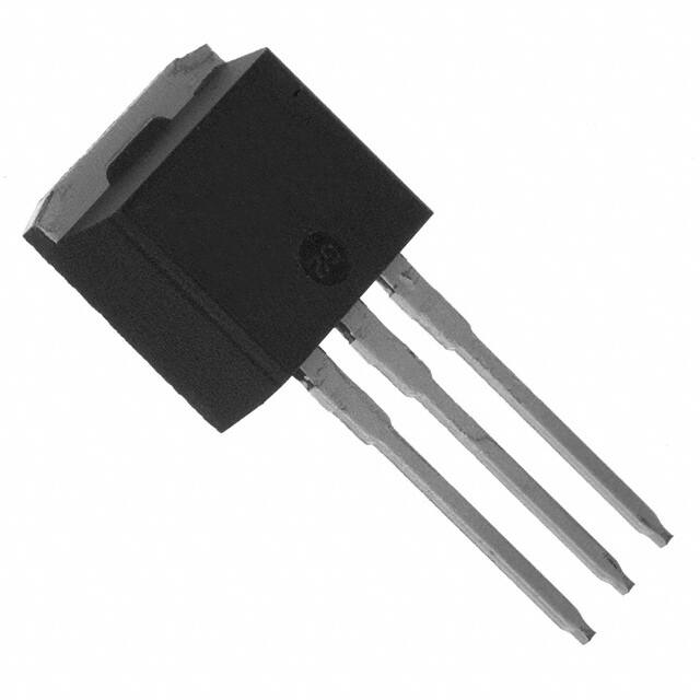

VS-MURB820-M3, VS-MURB820-1-M3 www.vishay.com Vishay Semiconductors Ultrafast Rectifier, 8 A FRED Pt® FEATURES • Ultrafast recovery time • Low forward voltage drop • Low leakage current 2 • 175 °C operating junction temperature 1 1 3 D2PAK (TO-263AB) • Meets MSL level 1, per J-STD-020, LF maximum peak of 245 °C 2 TO-262AA 3 Base cathode 2 • Material categorization: for definitions of compliance please see www.vishay.com/doc?99912 2 DESCRIPTION / APPLICATIONS 3 1 3 Anode 1 N/C N/C Anode VS-MURB820-1-M3 VS-MURB820-M3 PRIMARY CHARACTERISTICS IF(AV) 8A VR 200 V VF at IF 0.895 V trr 35 ns TJ max. 175 °C Package D2PAK (TO-263AB), TO-262AA Circuit configuration Single MUR.. series are the state of the art ultrafast recovery rectifiers specifically designed with optimized performance of forward voltage drop and ultrafast recovery time. The planar structure and the platinum doped life time control, guarantee the best overall performance, ruggedness and reliability characteristics. These devices are intended for use in the output rectification stage of SMPS, UPS, DC/DC converters as well as freewheeling diode in low voltage inverters and chopper motor drives. Their extremely optimized stored charge and low recovery current minimize the switching losses and reduce over dissipation in the switching element and snubbers.   ABSOLUTE MAXIMUM RATINGS PARAMETER SYMBOL Peak repetitive reverse voltage VRRM Average rectified forward current IF(AV) Non-repetitive peak surge current IFSM Peak repetitive forward current IFM Operating junction and storage temperatures TEST CONDITIONS MAX. UNITS 200 V Total device, rated VR, TC = 150 °C 8 A 100 Rated VR, square wave, 20 kHz, TC = 150 °C TJ, TStg 16 -65 to +175 °C ELECTRICAL SPECIFICATIONS (TJ = 25 °C unless otherwise specified) PARAMETER Breakdown voltage, blocking voltage SYMBOL VBR, VR TEST CONDITIONS MIN. TYP. MAX. 200 - - IF = 8 A - - 0.975 IF = 8 A, TJ = 150 °C - - 0.895 IR = 100 μA Forward voltage VF Reverse leakage current IR Junction capacitance CT VR = 200 V Series inductance LS Measured lead to lead 5 mm from package body UNITS V VR = VR rated - - 5 TJ = 150 °C, VR = VR rated - - 250 - 25 - pF - 8.0 - nH μA Revision: 25-Oct-17 Document Number: 96392 1 For technical questions within your region: DiodesAmericas@vishay.com, DiodesAsia@vishay.com, DiodesEurope@vishay.com THIS DOCUMENT IS SUBJECT TO CHANGE WITHOUT NOTICE. THE PRODUCTS DESCRIBED HEREIN AND THIS DOCUMENT ARE SUBJECT TO SPECIFIC DISCLAIMERS, SET FORTH AT www.vishay.com/doc?91000 VS-MURB820-M3, VS-MURB820-1-M3 www.vishay.com Vishay Semiconductors DYNAMIC RECOVERY CHARACTERISTICS (TJ = 25 °C unless otherwise specified) PARAMETER SYMBOL Reverse recovery time trr TEST CONDITIONS MIN. TYP. MAX. IF = 1.0 A, dIF/dt = 50 A/μs, VR = 30 V - - 35 IF = 0.5 A, IR = 1.0 A, IREC = 0.25 A - - 25 TJ = 25 °C - 20 - - 34 - - 1.7 - - 4.2 - TJ = 125 °C Peak recovery current TJ = 25 °C IRRM TJ = 125 °C ns A - 23 - - 75 - MIN. TYP. MAX. UNITS TJ, TStg -65 - 175 °C Thermal resistance, junction-to-case RthJC - - 3.0 Thermal resistance,  junction-to-ambient RthJA - - 50 Thermal resistance,  case-to-heatsink RthCS - 0.5 - Reverse recovery charge TJ = 25 °C IF = 8 A dIF/dt = 200 A/μs VR = 160 V UNITS Qrr TJ = 125 °C nC THERMAL - MECHANICAL SPECIFICATIONS PARAMETER SYMBOL Maximum junction and storage temperature range TEST CONDITIONS Mounting surface, flat, smooth and greased Weight Mounting torque 2.0 - g - 0.07 - oz. 6.0 (5.0) - 12 (10) kgf · cm (lbf · in) MURB820 Case style TO-262AA MURB820-1 100 100 IR - Reverse Current (µA) IF - Instantaneous Forward Current (A) - Case style D2PAK (TO-263AB) Marking device °C/W 10 TJ = 175 °C TJ = 150 °C TJ = 25 °C 1 TJ = 175 °C 10 TJ = 150 °C TJ = 125 °C 1 TJ = 100 °C 0.1 0.01 TJ = 25 °C 0.001 0.1 0 0.2 0.4 0.6 0.8 1.0 1.2 1.4 1.6 1.8 0 50 100 150 200 250 VF - Forward Voltage Drop (V) VR - Reverse Voltage (V) Fig. 1 - Typical Forward Voltage Drop Characteristics Fig. 2 - Typical Values of Reverse Current vs. Reverse Voltage Revision: 25-Oct-17 Document Number: 96392 2 For technical questions within your region: DiodesAmericas@vishay.com, DiodesAsia@vishay.com, DiodesEurope@vishay.com THIS DOCUMENT IS SUBJECT TO CHANGE WITHOUT NOTICE. THE PRODUCTS DESCRIBED HEREIN AND THIS DOCUMENT ARE SUBJECT TO SPECIFIC DISCLAIMERS, SET FORTH AT www.vishay.com/doc?91000 VS-MURB820-M3, VS-MURB820-1-M3 www.vishay.com Vishay Semiconductors CT - Junction Capacitance (pF) 1000 100 TJ = 25 °C 10 1 10 100 1000 VR - Reverse Voltage (V) ZthJC - Thermal Impedance (°C/W) Fig. 3 - Typical Junction Capacitance vs. Reverse Voltage 10 1 PDM D = 0.50 D = 0.20 D = 0.10 D = 0.05 D = 0.02 D = 0.01 0.1 Single pulse (thermal resistance) 0.01 0.00001 0.0001 t1 t2 Notes: 1. Duty factor D = t1/t2 . 2. Peak TJ = PDM x ZthJC + TC 0.001 0.01 . 0.1 1 t1 - Rectangular Pulse Duration (s) Fig. 4 - Maximum Thermal Impedance ZthJC Characteristics 10 Average Power Loss (W) Allowable Case Temperature (°C) 180 170 160 DC Square wave (D = 0.50) Rated VR applied 150 140 8 RMS limit 6 4 2 DC See note (1) 130 D = 0.01 D = 0.02 D = 0.05 D = 0.10 D = 0.20 D = 0.50 0 0 3 6 9 12 0 3 6 9 12 IF(AV) - Average Forward Current (A) IF(AV) - Average Forward Current (A) Fig. 5 - Maximum Allowable Case Temperature vs. Average Forward Current Fig. 6 - Forward Power Loss Characteristics Revision: 25-Oct-17 Document Number: 96392 3 For technical questions within your region: DiodesAmericas@vishay.com, DiodesAsia@vishay.com, DiodesEurope@vishay.com THIS DOCUMENT IS SUBJECT TO CHANGE WITHOUT NOTICE. THE PRODUCTS DESCRIBED HEREIN AND THIS DOCUMENT ARE SUBJECT TO SPECIFIC DISCLAIMERS, SET FORTH AT www.vishay.com/doc?91000 VS-MURB820-M3, VS-MURB820-1-M3 www.vishay.com Vishay Semiconductors 50 IF = 16 A IF = 8 A IF = 4 A 30 Qrr (nC) trr (ns) 40 200 VR = 160 V TJ = 125 °C TJ = 25 °C 20 160 VR = 160 V TJ = 125 °C TJ = 25 °C 120 IF = 16 A IF = 8 A IF = 4 A 80 40 10 100 0 100 1000 1000 dIF/dt (A/µs) dIF/dt (A/µs) Fig. 7 - Typical Reverse Recovery Time vs. dIF/dt Fig. 8 - Typical Stored Charge vs. dIF/dt Note Formula used: TC = TJ - (Pd + PdREV) x RthJC; Pd = forward power loss = IF(AV) x VFM at (IF(AV)/D) (see fig. 6); PdREV = inverse power loss = VR1 x IR (1 - D); IR at VR1 = rated VR (1) (3) trr IF ta tb 0 Qrr (2) IRRM (4) 0.5 IRRM di(rec)M/dt (5) 0.75 IRRM (1) diF/dt (1) diF/dt - rate of change of current through zero crossing (2) IRRM - peak reverse recovery current (3) trr - reverse recovery time measured from zero crossing point of negative going IF to point where a line passing through 0.75 IRRM and 0.50 IRRM extrapolated to zero current. (4) Qrr - area under curve defined by trr and IRRM Qrr = trr x IRRM 2 (5) di(rec)M/dt - peak rate of change of current during tb portion of trr Fig. 9 - Reverse Recovery Waveform and Definitions Revision: 25-Oct-17 Document Number: 96392 4 For technical questions within your region: DiodesAmericas@vishay.com, DiodesAsia@vishay.com, DiodesEurope@vishay.com THIS DOCUMENT IS SUBJECT TO CHANGE WITHOUT NOTICE. THE PRODUCTS DESCRIBED HEREIN AND THIS DOCUMENT ARE SUBJECT TO SPECIFIC DISCLAIMERS, SET FORTH AT www.vishay.com/doc?91000 VS-MURB820-M3, VS-MURB820-1-M3 www.vishay.com Vishay Semiconductors ORDERING INFORMATION TABLE Device code VS- MUR 1 2 B 8 20 -1 3 4 5 6 TRL -M3 1 - Vishay Semiconductors product 2 - Ultrafast MUR series 3 - B = D2PAK (TO-263AB) / TO-262AA 4 - Current rating (8 = 8 A) 5 - Voltage rating (20 = 200 V) 6 - 7 - 7 8 None = D2PAK (TO-263AB) -1 = TO-262AA None = tube (50 pieces) TRL = tape and reel (left oriented, for D2PAK (TO-263AB) package) TRR = tape and reel (right oriented, for D2PAK (TO-263AB) package) 8 - Environmental digit: -M3 = halogen-free, RoHS-compliant, and terminations lead (Pb)-free LINKS TO RELATED DOCUMENTS Dimensions Part marking information Packaging information D2PAK (TO-263AB) www.vishay.com/doc?96164 TO-262AA www.vishay.com/doc?96165 (TO-263AB) www.vishay.com/doc?95444 D2PAK TO-262AA www.vishay.com/doc?95443 D2PAK (TO-263AB) www.vishay.com/doc?96424 Revision: 25-Oct-17 Document Number: 96392 5 For technical questions within your region: DiodesAmericas@vishay.com, DiodesAsia@vishay.com, DiodesEurope@vishay.com THIS DOCUMENT IS SUBJECT TO CHANGE WITHOUT NOTICE. THE PRODUCTS DESCRIBED HEREIN AND THIS DOCUMENT ARE SUBJECT TO SPECIFIC DISCLAIMERS, SET FORTH AT www.vishay.com/doc?91000 Outline Dimensions www.vishay.com Vishay Semiconductors D2PAK DIMENSIONS in millimeters and inches Conforms to JEDEC® outline D2 PAK (SMD-220) (2)(3) E B Pad layout A A (E) c2 11.00 MIN. (0.43) A (3) L1 4 9.65 MIN. (0.38) (D1) (3) Detail A D H 1 2 17.90 (0.70) 15.00 (0.625) (2) 3 3.81 MIN. (0.15) L2 B B 2.32 MIN. (0.08) A 2 x b2 C 2xb 2.64 (0.103) 2.41 (0.096) (3) E1 c View A - A ± 0.004 M B 0.010 M A M B 2x e Plating Base Metal (4) b1, b3 H Gauge plane L Seating plane L3 A1 Lead tip (b, b2) L4 Section B - B and C - C Scale: None Detail “A” Rotated 90 °CW Scale: 8:1 SYMBOL MILLIMETERS MIN. MAX. INCHES MIN. c1 (4) (c) B 0° to 8° MAX. NOTES SYMBOL MILLIMETERS MIN. MAX. INCHES MIN. MAX. NOTES A 4.06 4.83 0.160 0.190 D1 6.86 8.00 0.270 0.315 3 A1 0.00 0.254 0.000 0.010 E 9.65 10.67 0.380 0.420 2, 3 E1 7.90 8.80 0.311 0.346 3 b 0.51 0.99 0.020 0.039 b1 0.51 0.89 0.020 0.035 b2 1.14 1.78 0.045 0.070 b3 1.14 1.73 0.045 0.068 c 0.38 0.74 0.015 0.029 c1 0.38 0.58 0.015 0.023 c2 1.14 1.65 0.045 0.065 D 8.51 9.65 0.335 0.380 4 4 e 2.54 BSC 0.100 BSC H 14.61 15.88 0.575 0.625 0.110 L 1.78 2.79 0.070 L1 - 1.65 - 0.066 4 L2 1.27 1.78 0.050 0.070 2 L4 L3 0.25 BSC 4.78 5.28 3 0.010 BSC 0.188 0.208 Notes (1) Dimensioning and tolerancing per ASME Y14.5 M-1994 (2) Dimension D and E do not include mold flash. Mold flash shall not exceed 0.127 mm (0.005") per side. These dimensions are measured at the outmost extremes of the plastic body (3) Thermal pad contour optional within dimension E, L1, D1 and E1 (4) Dimension b1 and c1 apply to base metal only (5) Datum A and B to be determined at datum plane H (6) Controlling dimension: inches (7) Outline conforms to JEDEC® outline TO-263AB Revision: 13-Jul-17 Document Number: 96164 1 For technical questions within your region: DiodesAmericas@vishay.com, DiodesAsia@vishay.com, DiodesEurope@vishay.com THIS DOCUMENT IS SUBJECT TO CHANGE WITHOUT NOTICE. THE PRODUCTS DESCRIBED HEREIN AND THIS DOCUMENT ARE SUBJECT TO SPECIFIC DISCLAIMERS, SET FORTH AT www.vishay.com/doc?91000 Outline Dimensions www.vishay.com Vishay Semiconductors TO-262AA DIMENSIONS in millimeters and inches Modified JEDEC® outline TO-262 (Datum A) (2) (3) E A A c2 B E A (3) L1 Seating plane D 1 2 3 C L2 B D1 (3) B C L (2) A c 3 x b2 3xb E1 A1 (3) Section A - A 2xe Plating 0.010 M A M B (4) b1, b3 Base metal Lead assignments Diodes 1. - Anode (two die)/open (one die) 2., 4. - Cathode 3. - Anode Lead tip SYMBOL c1 c (4) (b, b2) Section B - B and C - C Scale: None MILLIMETERS INCHES MIN. MAX. MIN. MAX. 0.190 A 4.06 4.83 0.160 A1 2.03 3.02 0.080 0.119 b 0.51 0.99 0.020 0.039 b1 0.51 0.89 0.020 0.035 b2 1.14 1.78 0.045 0.070 b3 1.14 1.73 0.045 0.068 c 0.38 0.74 0.015 0.029 c1 0.38 0.58 0.015 0.023 c2 1.14 1.65 0.045 0.065 NOTES 4 4 4 D 8.51 9.65 0.335 0.380 2 D1 6.86 8.00 0.270 0.315 3 E 9.65 10.67 0.380 0.420 2, 3 E1 7.90 8.80 0.311 0.346 3 e 2.54 BSC 0.100 BSC L 13.46 14.10 0.530 0.555 L1 - 1.65 - 0.065 L2 3.56 3.71 0.140 0.146 3 Notes (1) Dimensioning and tolerancing as per ASME Y14.5M-1994 (2) Dimension D and E do not include mold flash. Mold flash shall not exceed 0.127 mm (0.005") per side. These dimensions are measured at the outmost extremes of the plastic body (3) Thermal pad contour optional within dimension E, L1, D1 and E1 (4) Dimension b1 and c1 apply to base metal only (5) Controlling dimension: inches (6) Outline conform to JEDEC® TO-262 except A1 (max.), b (min., max.), b1 (min.), b2 (max.), c (min.), c1(min.), c2 (max.), D (min.), E (max.), L1 (max.), L2 (min., max.) Revision: 30-Nov-17 Document Number: 96165 1 For technical questions within your region: DiodesAmericas@vishay.com, DiodesAsia@vishay.com, DiodesEurope@vishay.com THIS DOCUMENT IS SUBJECT TO CHANGE WITHOUT NOTICE. THE PRODUCTS DESCRIBED HEREIN AND THIS DOCUMENT ARE SUBJECT TO SPECIFIC DISCLAIMERS, SET FORTH AT www.vishay.com/doc?91000 Legal Disclaimer Notice www.vishay.com Vishay Disclaimer ALL PRODUCT, PRODUCT SPECIFICATIONS AND DATA ARE SUBJECT TO CHANGE WITHOUT NOTICE TO IMPROVE RELIABILITY, FUNCTION OR DESIGN OR OTHERWISE. Vishay Intertechnology, Inc., its affiliates, agents, and employees, and all persons acting on its or their behalf (collectively, “Vishay”), disclaim any and all liability for any errors, inaccuracies or incompleteness contained in any datasheet or in any other disclosure relating to any product. Vishay makes no warranty, representation or guarantee regarding the suitability of the products for any particular purpose or the continuing production of any product. To the maximum extent permitted by applicable law, Vishay disclaims (i) any and all liability arising out of the application or use of any product, (ii) any and all liability, including without limitation special, consequential or incidental damages, and (iii) any and all implied warranties, including warranties of fitness for particular purpose, non-infringement and merchantability. Statements regarding the suitability of products for certain types of applications are based on Vishay's knowledge of typical requirements that are often placed on Vishay products in generic applications. Such statements are not binding statements about the suitability of products for a particular application. It is the customer's responsibility to validate that a particular product with the properties described in the product specification is suitable for use in a particular application. Parameters provided in datasheets and / or specifications may vary in different applications and performance may vary over time. All operating parameters, including typical parameters, must be validated for each customer application by the customer's technical experts. Product specifications do not expand or otherwise modify Vishay's terms and conditions of purchase, including but not limited to the warranty expressed therein. Hyperlinks included in this datasheet may direct users to third-party websites. These links are provided as a convenience and for informational purposes only. Inclusion of these hyperlinks does not constitute an endorsement or an approval by Vishay of any of the products, services or opinions of the corporation, organization or individual associated with the third-party website. Vishay disclaims any and all liability and bears no responsibility for the accuracy, legality or content of the third-party website or for that of subsequent links. Except as expressly indicated in writing, Vishay products are not designed for use in medical, life-saving, or life-sustaining applications or for any other application in which the failure of the Vishay product could result in personal injury or death. Customers using or selling Vishay products not expressly indicated for use in such applications do so at their own risk. Please contact authorized Vishay personnel to obtain written terms and conditions regarding products designed for such applications. No license, express or implied, by estoppel or otherwise, to any intellectual property rights is granted by this document or by any conduct of Vishay. Product names and markings noted herein may be trademarks of their respective owners. © 2021 VISHAY INTERTECHNOLOGY, INC. ALL RIGHTS RESERVED Revision: 09-Jul-2021 1 Document Number: 91000
