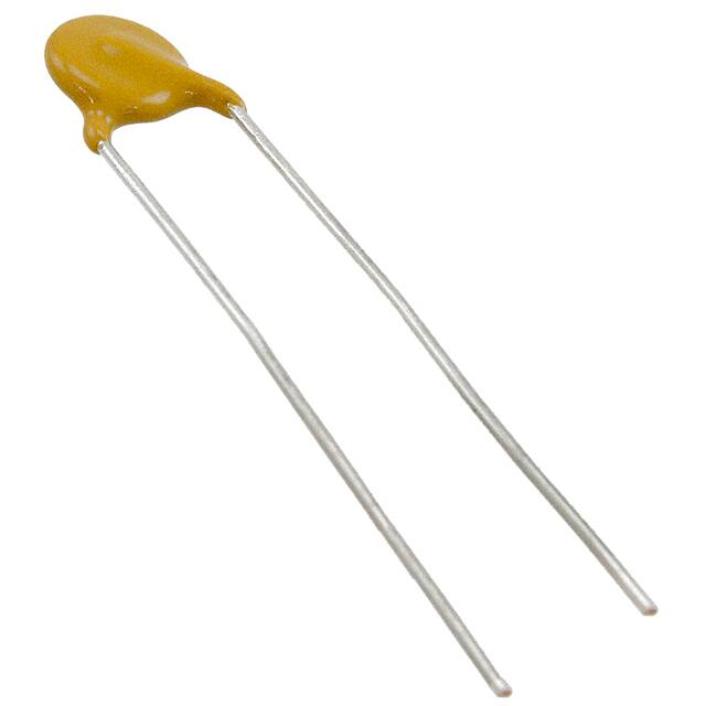

VY1 Series www.vishay.com Vishay BCcomponents EMI Suppression Safety Capacitor, Ceramic Disc, Class X1, 760 VAC, Class Y1, 500 VAC FEATURES • • • • • Complying with IEC 60384-14 High reliability Vertical (inline) kinked or straight leads Singlelayer AC disc safety capacitors Material categorization: for definitions of compliance please see www.vishay.com/doc?99912 APPLICATIONS LINKS TO ADDITIONAL RESOURCES 3D 3D 3D Models • • • • • X1, Y1 according to IEC 60384-14 Line-to-line filtering (Class X) Line-to-ground filtering (Class Y) Primary and secondary coupling (SMPS) EMI / RFI suppression and filtering DESIGN Models QUICK REFERENCE DATA DESCRIPTION Ceramic Class VALUE 1 Ceramic Dielectric U2J Voltage (VAC) Min. Capacitance (pF) Max. Capacitance (pF) Mounting 500 U2J 760 10 22 2 Y5S, Y5U, Y5S, Y5U, Y5V Y5V 500 760 33 4700 Radial OPERATING TEMPERATURE RANGE -40 °C to +125 °C TEMPERATURE CHARACTERISTICS Class 1: N750 (U2J) Class 2: Y5S, Y5U, Y5V SECTIONAL SPECIFICATIONS Climatic category (according to EN 60058-1) Class 1 and class 2: 40/125/21 COATING According to UL 94 V-0 Epoxy resin, isolating, flame retardant Halogen-free available Reinforced insulation APPROVALS IEC 60384-14 UL 60384-14 DIN EN 60384-14 CSA E60384-1:03, CSA E60384-14:09 CQC11-471112-2009 The capacitor consists of a ceramic disc which is silver plated on both sides. Connection leads are made of tinned copper clad steel having a diameter of 0.6 mm. The capacitors may be supplied with vertical (inline) kinked leads having a lead spacing of 10.0 mm, or 12.5 mm. Encapsulation is made of flame retardant epoxy resin in accordance with UL 94 V-0. CAPACITANCE RANGE 10 pF to 4700 pF RATED VOLTAGE UR IEC 60384-14: (X1): 760 VAC, 50 Hz (Y1): 500 VAC, 50 Hz 1500 VDC TEST VOLTAGE Component test (100 %): 4000 VAC, 50 Hz, 2 s Random sampling test (destructive test): 4000 VAC, 50 Hz, 60 s Voltage proof of coating (destructive test): 4000 VAC, 50 Hz, 60 s INSULATION RESISTANCE ≥ 10 000 MΩ CAPACITANCE TOLERANCE ± 20 % (code M); ± 10 % (code K) DISSIPATION FACTOR Class 1: max. 0.5 % (1 MHz) Class 2: max. 2.5 % (1 kHz) PACKAGING Bulk, tape and reel, taped ammopack Revision: 16-Sep-2021 Document Number: 28537 1 For technical questions, contact: cdc@vishay.com THIS DOCUMENT IS SUBJECT TO CHANGE WITHOUT NOTICE. THE PRODUCTS DESCRIBED HEREIN AND THIS DOCUMENT ARE SUBJECT TO SPECIFIC DISCLAIMERS, SET FORTH AT www.vishay.com/doc?91000 VY1 Series www.vishay.com Vishay BCcomponents DIMENSIONS in millimeters F e = 3.0 max. SH = 4.0 max. Ø 0.6 ± 0.05 Dmax. Tmax. L = 30.0 ± 5.0 Capacitors with 10.0 mm or 12.5 mm lead spacing TECHNICAL DATA CAPACITANCE C (pF) CAPACITANCE TOLERANCE (%) BODY DIAMETER Dmax. (mm) BODY THICKNESS Tmax. (mm) LEAD SPACING F (mm) ± 1 mm ± 10 8.0 5.0 10.0 or 12.5 PART NUMBER MISSING DIGITS SEE ORDERING CODE BELOW U2J (N750) 10 15 VY1100K31U2JQ6### 22 VY1150K31U2JQ6### VY1220K31U2JQ6### Y5S (2C3) 33 VY1330K31Y5SQ6### 47 VY1470K31Y5SQ6### 68 VY1680K31Y5SQ6### 100 ± 10 8.0 5.0 10.0 or 12.5 VY1101K31Y5SQ6### 150 VY1151K31Y5SQ6### 220 VY1221K31Y5SQ6### 330 VY1331K31Y5SQ6### Y5U (2E3) 470 1000 1500 2200 VY1471#31Y5UQ6### 8.0 680 VY1681#31Y5UQ6### 9.0 ± 20 (1) 10.5 12.0 VY1102#35Y5UQ6### 5.0 10.0 or 12.5 VY1152#41Y5UQ6### VY1222#47Y5UQ6### 3300 15.0 VY1332#59Y5UQ6### 3900 15.5 VY1392#61Y5UQ6### 4700 16.0 VY1472#63Y5UQ6### Y5V (2F3) MINI SIZE SERIES 1000 7.5 VY1102M29Y5VQ6### 1500 8.5 VY1152M33Y5VQ6### 2200 3300 ± 20 9.5 11.0 5.5 10.0 or 12.5 VY1222M37Y5VQ6### VY1332M43Y5VQ6### 3900 12.0 VY1392M47Y5VQ6### 4700 13.0 VY1472M51Y5VQ6### Notes • Straight leads available on request • Coating extension DR valid for straight leads only (1) ± 10 % available on request Revision: 16-Sep-2021 Document Number: 28537 2 For technical questions, contact: cdc@vishay.com THIS DOCUMENT IS SUBJECT TO CHANGE WITHOUT NOTICE. THE PRODUCTS DESCRIBED HEREIN AND THIS DOCUMENT ARE SUBJECT TO SPECIFIC DISCLAIMERS, SET FORTH AT www.vishay.com/doc?91000 VY1 Series www.vishay.com Vishay BCcomponents ORDERING CODE # 7th digit Capacitance tolerance ± 10 % = K, ± 20 % = M ### 15th to 17th digit Lead configuration Available configurations see below Example VY1 101 Series Capacitance value K 31 Tolerance Size code code Y5S Q Temperature coefficient Rated voltage 6 T Lead wire Packaging / diameter lead length Q= X1/Y1 500 V (AC) 3 = bulk T = tape and reel U= ammopack V 0 Lead style Lead spacing L= straight V = inline kinked 0 = 10.0 X = 12.5 PACKAGING SIZE CODE BODY DIAMETER Dmax. (mm) 31 to 47 51 to 63 12.0 16.0 PACKAGING QUANTITIES REEL 500 500 BULK 1000 500 AMMO 750 750 Note • The capacitors are supplied in bulk packaging (cardboard boxes), in tape on reel or in ammopack STRAIGHT LEADS Tmax. Dmax. coating extension e 3.0 max. 30 mm to 3.0 mm (ΔR) F d = 0.6 mm P D P2 ΔP ΔP Δh T Δh H1 F Ød W2 L H0 W1 W0 W L1 P0 P1 F A D0 t1 t detail A The sprocket hole pitch (P0) is 12.7 mm for lead spacing 10.0 mm and 12.5 mm Revision: 16-Sep-2021 Document Number: 28537 3 For technical questions, contact: cdc@vishay.com THIS DOCUMENT IS SUBJECT TO CHANGE WITHOUT NOTICE. THE PRODUCTS DESCRIBED HEREIN AND THIS DOCUMENT ARE SUBJECT TO SPECIFIC DISCLAIMERS, SET FORTH AT www.vishay.com/doc?91000 VY1 Series www.vishay.com Vishay BCcomponents DIMENSIONS OF TAPE DIMENSIONS (mm) SYMBOL PARAMETER D (1) Body diameter 16.0 max. d Lead diameter 0.6 ± 0.05 P Pitch of component 25.4 ± 1 P0 (2) Pitch of sprocket hole 12.7 ± 0.3 P1 (3) Distance, hole center to lead 7.7 or 6.4 ± 1.0 P2 (3) Distance, hole to center of component 12.7 ± 1.5 F Lead spacing 10.0 or 12.5 + 0.6/- 0.4 ± 1.0 max. Δh Average deviation across tape ΔP Average deviation in direction of reeling ± 1.0 max. W Carrier tape width 18.0 + 1/- 0.5 W0 Hold-down tape width 5.0 min. W1 Position of sprocket hole 9.0 + 0.75/- 0.5 W2 Distance of hold-down tape 3.0 max. H1 Maximum component height 40.0 H0 Height to seating plane (for kinked leads) 16.0 ± 0.5 H0 Height to seating plane (for straight leads) 20.0 ± 0.5 L Length of cut leads 11.0 max. L1 Length of lead protrusion 1.0 max. D0 Diameter of sprocket hole 4.0 ± 0.2 t Total tape thickness 0.9 max. t1 Total tape thickness with lead wire t+d Notes (1) See “Technical Data” table (2) Cumulative pitch error: ± 1 mm/20 pitches (3) Obliquity maximum 3° REEL AND TAPE DATA in millimeters 51 max. 355.6 ± 2.0 330 28 ± 1.5 8.0 45 max. 360 55 Reel with capacitors on tape Revision: 16-Sep-2021 Ammopack with capacitors on tape Document Number: 28537 4 For technical questions, contact: cdc@vishay.com THIS DOCUMENT IS SUBJECT TO CHANGE WITHOUT NOTICE. THE PRODUCTS DESCRIBED HEREIN AND THIS DOCUMENT ARE SUBJECT TO SPECIFIC DISCLAIMERS, SET FORTH AT www.vishay.com/doc?91000 VY1 Series www.vishay.com Vishay BCcomponents APPROVALS IEC 60384-14 - Safety tests This approval together with CB test certificate substitutes all national approvals. CB Certificate Y1-capacitor: CB test certificate: US-26561-UL 10 pF to 4.7 nF 500 VAC X1-capacitor: CB test certificate: US-26561-UL 10 pF to 4.7 nF 760 VAC VDE Y1-capacitor: VDE marks approval: 40012673 10 pF to 4.7 nF 500 VAC X1-capacitor: VDE marks approval: 40012673 10 pF to 4.7 nF 760 VAC DIN EN 60384-14 VDE 0565-1-1:2006-04 - Safety tests Underwriters Laboratories Inc./Canadian Standards Association Y1-capacitor: CSA test certificate: E183844 10 pF to 4.7 nF 500 VAC X1-capacitor: CSA test certificate: E183844 10 pF to 4.7 nF 760 VAC UL 60384-14, CSA E60384-1:03, CSA E60384-14:09 Fixed capacitors for electromagnetic interference suppression and connection to the supply mains. CQC Y1-capacitor: CQC test certificate: CQC05001015032 10 pF to 4.7 nF 500 VAC X1-capacitor: CQC test certificate: CQC05001015032 10 pF to 4.7 nF 760 VAC MARKING Sample (2 sides) 10 VY1 472M Y1 500~ X1 760~ xxxx 250~ 4 digit date code (year/week; add suffix “V” for mini size series) Revision: 16-Sep-2021 Document Number: 28537 5 For technical questions, contact: cdc@vishay.com THIS DOCUMENT IS SUBJECT TO CHANGE WITHOUT NOTICE. THE PRODUCTS DESCRIBED HEREIN AND THIS DOCUMENT ARE SUBJECT TO SPECIFIC DISCLAIMERS, SET FORTH AT www.vishay.com/doc?91000 VY1 Series www.vishay.com Vishay BCcomponents PERFORMANCE TEST Visual and mechanical inspection Capacitance (C) Dissipation factor (DF) TEST CONDITION Optical inspection, dimensions measured with caliper 25 °C ± 3 °C , relative humidity (RH) ≤ 75 %, 1.0 VRMS ± 0.2 VRMS at 1 kHz for Y5U and Y5S, and 1 MHz for U2J TEST LIMITS No visible damage, marking legible Capacitance within specified tolerance DF ≤ 0.3 % for U2J and DF ≤ 2.5 % for Y5S and Y5U Insulation resistance (IR) Measured within 60 s ± 5 s after charging at 500 VDC 10 000 MΩ min. Dielectric strength 4000 VAC at 50 Hz/60 Hz for 1 min, 50 mA max. No failure Temperature characteristic RH ≤ 75 %, 1.0 VRMS ± 0.2 VRMS at 1 kHz for Y5U and Y5S, and 1 MHz for U2J U2J: -750 ppm ± 120 ppm Y5S: ± 22 % Y5U: +22 %/-56 % Impulse voltage 3 pulses of 8 kV No failure Life test Humidity test 1000 h at 125 °C ± 2 °C, 850 VAC/50 Hz; once every hour 1000 VAC for 0.1 s 500 h at 500 VAC, 50 Hz and 500 h unloaded 40 °C, RH = 90 % to 95% External appearance: no visible damage ΔC/C ≤ ± 15 % DF ≤ 0.5 % for U2J and ≤ 5 % for Y5S and Y5U IR ≥ 3000 MΩ Dielectric strength: no failure External appearance: no visible damage ΔC/C ≤ ± 10 % for U2J and ≤ ± 15 % for Y5S and Y5U DF ≤ 0.5 % for U2J and ≤ 5 % for Y5S and Y5U IR ≥ 3000 MΩ Dielectric strength: no failure Robustness of termination Pull test: 0.5 kg tensile weight in radial direction for 10 s ± 1 s Bending strength: capacitor body rotated by 90° in both directions No damage to capacitor body and lead wire Soldering effect Immersion of lead wires into 260 °C ± 5 °C solder for 10 s ± 2 s; min. distance from body: 1.5 mm Hand soldering at 400 °C ± 10 °C for 3 s to 4 s; min. distance from body: 1.5 mm External appearance: no visible damage ΔC/C ≤ ± 5 % for U2J and ≤ ± 10 % for Y5S and Y5U Dielectric strength: no failure Resin (adhesive) Vibration test Solder the capacitor onto test jig (glass epoxy body) and use resin (adhesive) to stick the body to the test jig. The capacitor must be soldered firmly to the supporting lead wire. Vibration change from 10 Hz to 2000 Hz and back to 10 Hz; Total amplitude: 1.5 mm; Acceleration: 100 m/s2; Sweep rate: 1 oct/min, each axis 2 h (6 h in total) Revision: 16-Sep-2021 External appearance: no visible damage Capacitance within specified tolerance DF ≤ 0.3 % for U2J and ≤ 2.5 % for Y5S and Y5U IR ≥ 10 000 GΩ Document Number: 28537 6 For technical questions, contact: cdc@vishay.com THIS DOCUMENT IS SUBJECT TO CHANGE WITHOUT NOTICE. THE PRODUCTS DESCRIBED HEREIN AND THIS DOCUMENT ARE SUBJECT TO SPECIFIC DISCLAIMERS, SET FORTH AT www.vishay.com/doc?91000 VY1 Series www.vishay.com Vishay BCcomponents LEAKAGE CURRENT VS. VOLTAGE (Typical) 180 3500 4700 pF 3000 3300 pF 2500 2200 pF 2000 1500 pF 1500 1000 pF 1000 680 pF 500 470 pF 330 pF 220 pF 150 pF Leakage Current (µA) RMS Leakage Current (µA) RMS 4000 0 160 140 100 pF 120 100 68 pF 80 47 pF 60 33 pF 40 22 pF 22 pF 10 pF 20 0 0 500 1000 1500 2000 2500 3000 3500 0 4000 500 1000 1500 2000 2500 3000 3500 4000 AC Voltage (V) RMS AC Voltage (V) RMS IMPEDANCE VS. FREQUENCY (Typical) Impedance (Ω) 100 Lead configuration: - Length = 30 mm - Lead spacing: Standard - Lead diameter: Standard - Inline crimp 10 0.1 nF 1.0 nF 1 0.01 nF 0.68 nF 2.2 nF 4.7 nF 0.1 1 10 Frequency (MHz) 100 Note • The capacitors meet the essential requirements of “EIA 198”. Unless stated otherwise all electrical values apply at an ambient temperature of 25 °C ± 3 °C, at normal atmospheric conditions RELATED DOCUMENTS General Information www.vishay.com/doc?28536 CB Test Certificate www.vishay.com/doc?22249 VDE Marks Approval www.vishay.com/doc?22251 UL Test Certificate www.vishay.com/doc?22250 CQC Test Certificate www.vishay.com/doc?22248 LTspice® www.vishay.com/doc?28568 Models SAMPLE KITS Part Number (VY1 Sample Kit) Link (VY1 Sample Kit) Part Number (VY1...Y5V Sample Kit) Link (VY1...Y5V Sample Kit) Revision: 16-Sep-2021 VY11-KIT-HF www.vishay.com/doc?28552 VY1-KIT-MS www.vishay.com/doc?28561 Document Number: 28537 7 For technical questions, contact: cdc@vishay.com THIS DOCUMENT IS SUBJECT TO CHANGE WITHOUT NOTICE. THE PRODUCTS DESCRIBED HEREIN AND THIS DOCUMENT ARE SUBJECT TO SPECIFIC DISCLAIMERS, SET FORTH AT www.vishay.com/doc?91000 Legal Disclaimer Notice www.vishay.com Vishay Disclaimer ALL PRODUCT, PRODUCT SPECIFICATIONS AND DATA ARE SUBJECT TO CHANGE WITHOUT NOTICE TO IMPROVE RELIABILITY, FUNCTION OR DESIGN OR OTHERWISE. Vishay Intertechnology, Inc., its affiliates, agents, and employees, and all persons acting on its or their behalf (collectively, “Vishay”), disclaim any and all liability for any errors, inaccuracies or incompleteness contained in any datasheet or in any other disclosure relating to any product. Vishay makes no warranty, representation or guarantee regarding the suitability of the products for any particular purpose or the continuing production of any product. To the maximum extent permitted by applicable law, Vishay disclaims (i) any and all liability arising out of the application or use of any product, (ii) any and all liability, including without limitation special, consequential or incidental damages, and (iii) any and all implied warranties, including warranties of fitness for particular purpose, non-infringement and merchantability. Statements regarding the suitability of products for certain types of applications are based on Vishay's knowledge of typical requirements that are often placed on Vishay products in generic applications. Such statements are not binding statements about the suitability of products for a particular application. It is the customer's responsibility to validate that a particular product with the properties described in the product specification is suitable for use in a particular application. Parameters provided in datasheets and / or specifications may vary in different applications and performance may vary over time. All operating parameters, including typical parameters, must be validated for each customer application by the customer's technical experts. Product specifications do not expand or otherwise modify Vishay's terms and conditions of purchase, including but not limited to the warranty expressed therein. Hyperlinks included in this datasheet may direct users to third-party websites. These links are provided as a convenience and for informational purposes only. Inclusion of these hyperlinks does not constitute an endorsement or an approval by Vishay of any of the products, services or opinions of the corporation, organization or individual associated with the third-party website. Vishay disclaims any and all liability and bears no responsibility for the accuracy, legality or content of the third-party website or for that of subsequent links. Except as expressly indicated in writing, Vishay products are not designed for use in medical, life-saving, or life-sustaining applications or for any other application in which the failure of the Vishay product could result in personal injury or death. Customers using or selling Vishay products not expressly indicated for use in such applications do so at their own risk. Please contact authorized Vishay personnel to obtain written terms and conditions regarding products designed for such applications. No license, express or implied, by estoppel or otherwise, to any intellectual property rights is granted by this document or by any conduct of Vishay. Product names and markings noted herein may be trademarks of their respective owners. © 2021 VISHAY INTERTECHNOLOGY, INC. ALL RIGHTS RESERVED Revision: 09-Jul-2021 1 Document Number: 91000

物料型号:VY1系列
器件简介:该系列是EMI抑制安全电容器,采用陶瓷圆盘结构,符合Class X1和Class Y1标准,分别能承受760 VAC和500 VAC的电压。
引脚分配:电容器可能配备有垂直(内联)弯曲引脚或直引脚,引脚间距为10.0 mm或12.5 mm。
参数特性: - 工作温度范围:-40 °C至+125 °C - 电容范围:10 pF至4700 pF - 额定电压:IEC 60384-14标准下,X1为760 VAC,50 Hz;Y1为500 VAC,50 Hz - 电容公差:±20%(代码M)或±10%(代码K) - 耗散因数:Class 1最大0.5%(1 MHz),Class 2最大2.5%(1 kHz) - 绝缘电阻:≥ 10,000 MΩ
功能详解: - 用于线路对线路(Class X)和线路对地(Class Y)的滤波 - 用于开关电源(SMPS)的一次和二次耦合 - 用于EMI/RFI抑制和滤波
应用信息: - 符合IEC 60384-14标准的X1、Y1电容器 - 用于电源线路的EMI/RFI抑制和滤波
封装信息:电容器采用符合UL 94 V-0标准的阻燃环氧树脂封装,有散装、卷带和弹药包等包装方式。
