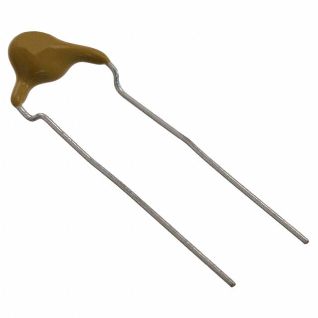

    贴片电容(MLCC) 径向 33pF ±10% 440V U2J
VY2330K29U2JS6TV0 数据手册
VY2 Series www.vishay.com Vishay BCcomponents EMI Suppression Safety Capacitor, Ceramic Disc, Class X1, 440 VAC, Class Y2, 300 VAC FEATURES • • • • • Complying with IEC 60384-14 High reliability Vertical (inline) kinked or straight leads Singlelayer AC disc safety capacitors Material categorization: for definitions of compliance please see www.vishay.com/doc?99912 APPLICATIONS • • • • • LINKS TO ADDITIONAL RESOURCES 3D 3D 3D Models DESIGN Models QUICK REFERENCE DATA DESCRIPTION VALUE Ceramic Class Ceramic Dielectric Voltage (VAC) X1, Y2 according to IEC 60384-14 Line-to-line filtering (Class X) Line-to-ground filtering (Class Y) Primary and secondary coupling (SMPS) EMI / RFI suppression and filtering 1 2 N750 Y5S, Y5U, Y5V 300 440 300 440 Min. Capacitance (pF) 10 68 Max. Capacitance (pF) 47 10 000 Mounting Radial OPERATING TEMPERATURE RANGE -40 °C to +125 °C TEMPERATURE CHARACTERISTICS Class 1: N750 (U2J) Class 2: Y5S, Y5U, Y5V The capacitor consists of a ceramic disc which is silver plated on both sides. Connection leads are made of tin plated copper-clad steel having a diameter of 0.6 mm. The capacitors may be supplied with vertical (inline) kinked leads having a lead spacing of 5.0 mm, 7.5 mm, 10.0 mm, or 12.5 mm. Encapsulation is made of flame retardant epoxy resin in accordance with UL 94 V-0. CAPACITANCE RANGE 10 pF to 0.01 μF RATED VOLTAGE UR IEC 60384-14: (X1): 440 VAC, 50 Hz (Y2): 300 VAC, 50 Hz 1000 VDC TEST VOLTAGE According to UL 94 V-0 Epoxy resin, isolating, flame retardant Component test (100 %): 2600 VAC, 50 Hz, 2 s (2600 VAC for LS 7.5 mm and above) (2200 VAC for LS 5.0 mm) Random sampling test (destructive test): 2600 VAC, 50 Hz, 60 s Voltage proof of coating (destructive test): 2600 VAC, 50 Hz, 60 s APPROVALS INSULATION RESISTANCE SECTIONAL SPECIFICATIONS Climatic category (according to EN 60058-1) Class 1 and class 2: 40/125/21 COATING IEC 60384-14 UL 60384-14 DIN EN 60384-14 CSA E60384-1:03, CSA E60384-14:09 CQC11-471112 PACKAGING Bulk, tape and reel, taped ammopack Revision: 16-Aug-2021 ≥ 10 000 MΩ CAPACITANCE TOLERANCE ± 20 % (code M); ± 10 % (code K) DISSIPATION FACTOR Class 1: max. 0.5 % (1 MHz) Class 2: max. 2.5 % (1 kHz) Document Number: 28535 1 For technical questions, contact: cdc@vishay.com THIS DOCUMENT IS SUBJECT TO CHANGE WITHOUT NOTICE. THE PRODUCTS DESCRIBED HEREIN AND THIS DOCUMENT ARE SUBJECT TO SPECIFIC DISCLAIMERS, SET FORTH AT www.vishay.com/doc?91000 VY2 Series www.vishay.com Vishay BCcomponents DIMENSIONS in millimeters F e = 3.0 max. SH = 4.0 max. Ø 0.6 ± 0.05 Dmax. Tmax. L = 30.0 ± 5.0 Capacitors with 5.0 mm, 7.5 mm, 10 mm, or 12.5 mm lead spacing. Coating extension e valid for straight leads only. TECHNICAL DATA CAPACITANCE C (pF) CAPACITANCE TOLERANCE (%) BODY DIAMETER Dmax. (mm) BODY THICKNESS Tmax. (mm) LEAD SPACING (1) F (mm) ± 1 mm PART NUMBER MISSING DIGITS SEE ORDERING CODE BELOW U2J (N750) 10 VY2100K29U2JS6### 15 22 VY2150K29U2JS6### ± 10 7.5 5.0 5.0, 7.5, 10.0, or 12.5 VY2220K29U2JS6### 33 VY2330K29U2JS6### 47 VY2470K29U2JS6### Y5S (2C3) 68 VY2680K29Y5SS6### 100 VY2101K29Y5SS6### 150 220 ± 10 7.5 5.0 5.0, 7.5, 10.0, or 12.5 VY2151K29Y5SS6### VY2221K29Y5SS6### 330 VY2331K29Y5SS6### 470 VY2471K29Y5SS6### Y5U (2E3) 680 1500 8.0 2200 9.0 3300 VY2681M29Y5US6### 7.5 1000 ± 20 10.5 3900 11.0 4700 12.5 6800 14.5 10 000 16.0 VY2102M29Y5US6### 5.0, 7.5, 10.0, or 12.5 VY2152M31Y5US6### VY2222M35Y5US6### VY2332M41Y5US6### 5.0 VY2392M43Y5US6### VY2472M49Y5US6### 7.5, 10.0, or 12.5 VY2682M59Y5US63## VY2103M63Y5US63## Y5V (2F3) MINI SIZE SERIES 1000 7.5 VY2102M29Y5VS6### 1500 7.5 VY2152M29Y5VS6### 2200 8.0 3300 9.0 3900 ± 20 10.0 VY2222M31Y5VS6### 5.0 5.0, 7.5, 10.0, or 12.5 VY2332M35Y5VS6### VY2392M39Y5VS6### 4700 10.5 VY2472M41Y5VS6### 6800 12.0 VY2682M47Y5VS6### 10 000 15.0 VY2103M59Y5VS6### Note (1) Straight leads are available on request Revision: 16-Aug-2021 Document Number: 28535 2 For technical questions, contact: cdc@vishay.com THIS DOCUMENT IS SUBJECT TO CHANGE WITHOUT NOTICE. THE PRODUCTS DESCRIBED HEREIN AND THIS DOCUMENT ARE SUBJECT TO SPECIFIC DISCLAIMERS, SET FORTH AT www.vishay.com/doc?91000 VY2 Series www.vishay.com Vishay BCcomponents ORDERING CODE 15th to 17th digit ### Example VY2 Series Lead configuration 221 K Capacitance Tolerance value code Available configurations see below 29 Y5S S 6 U V 7 Size code Temperature coefficient Rated voltage Lead wire diameter Packaging / lead length Lead style Lead spacing 3 = bulk T = tape and reel U = ammopack L= straight V = inline kinked 5 = 5.0 7 = 7.5 0 = 10.0 X = 12.5 S= X1/Y2 300 V (AC) LEADSPACING 5.0 mm AND 7.5 mm PACKAGING PACKAGING QUANTITIES SIZE CODE BODY DIAMETER Dmax. (mm) BULK REEL AMMO 29 to 49 12.5 1000 1000 1000 59 to 63 16.0 500 - - LEADSPACING 10.0 mm AND 12.5 mm PACKAGING PACKAGING QUANTITIES CAPACITANCE VALUE SIZE CODE BODY DIAMETER Dmax. (mm) BULK REEL AMMO 10 pF to 4700 pF 29 to 49 12.5 1000 500 750 6800 pF to 0.01 μF 59 to 63 16.0 500 500 750 Note • The capacitors are supplied in bulk packaging (cardboard boxes), in tape on reel in ammopack STRAIGHT LEADS Dmax. Tmax. coating extension e 3.0 max. 30 mm to 5.0 mm (ΔR) F d = 0.6 mm Revision: 16-Aug-2021 Document Number: 28535 3 For technical questions, contact: cdc@vishay.com THIS DOCUMENT IS SUBJECT TO CHANGE WITHOUT NOTICE. THE PRODUCTS DESCRIBED HEREIN AND THIS DOCUMENT ARE SUBJECT TO SPECIFIC DISCLAIMERS, SET FORTH AT www.vishay.com/doc?91000 VY2 Series www.vishay.com D Vishay BCcomponents P2 P ΔP Δh ΔP H1 W2 t1 H0 t detail A W1 W0 W A P1 Ød Direction of unreeling F P0 L1 D0 Fig. 1 - Kinked capacitors on tape, lead spacing 5.0 mm (0.2") and 7.5 mm (0.3") P P2 ΔP ΔP D Δh T Δh H1 F Ød t W2 L H0 W1 detail A t1 W0 W L1 P0 P1 F A D0 Fig. 2 - Inline kink (V) leaded capacitors on tape, lead spacing 10 mm (0.40") DIMENSION OF TAPE SYMBOL PARAMETER D (1) d P P0 (2) P1 (3) P2 (3) F Δh ΔP W W0 W1 W2 H1 H0 H0 L L1 D0 t t1 Body diameter Lead diameter Pitch of component Pitch of sprocket hole Distance, hole center to lead Distance, hole to center of component Lead spacing Average deviation across tape Average deviation in direction of reeling Carrier tape width Hold-down tape width Position of sprocket hole Distance of hold-down tape Maximum component height Height to seating plane (for kinked leads) Height to seating plane (for straight leads) Length of cut leads Length of lead protrusion Diameter of sprocket hole Total tape thickness Maximum thickness of tape and wires FIG. 1 (5 mm) 11.0 max. 0.6 ± 0.05 12.7 ± 1 12.7 ± 0.3 3.85 ± 0.7 6.35 ± 1.3 5.0 (+ 0.6 / - 0.4) ± 1.0 max. ± 1.0 max. 18.0 + 1 / - 0.5 5.0 min. 9.0 + 0.75 / - 0.5 3.0 max. 32 16.0 ± 0.5 20.0 ± 0.5 11.0 max. 1.0 max. 4.0 ± 0.2 0.9 max. 1.5 max. DIMENSIONS (mm) FIG. 1 (7.5 mm) FIG. 2 (10 mm) 14.0 max. 16.0 max. 0.6 ± 0.05 0.6 ± 0.05 15.0 ± 1 25.4 ± 1 15.0 ± 0.3 12.7 ± 0.3 3.75 ± 0.7 7.7 ± 1.0 7.5 ± 1.5 12.7 ± 1.5 7.5 (+ 0.6 / - 0.4) 10.0 (+ 0.6 / - 0.4) ± 1.0 max. ± 1.0 max. ± 1.0 max. ± 1.0 max. 18.0 + 1/- 0.5 18.0 + 1 / - 0.5 5.0 min. 5.0 min. 9.0 + 0.75 / - 0.5 9.0 + 0.75 / - 0.5 3.0 max. 3.0 max. 40 40 16.0 ± 0.5 16.0 ± 0.5 20.0 ± 0.5 20.0 ± 0.5 11.0 max. 11.0 max. 1.0 max. 1.0 max. 4.0 ± 0.2 4.0 ± 0.2 0.9 max. 0.9 max. 1.5 max. 1.5 max. Notes See “Technical Data” table Cumulative pitch error: ± ≤ 1 mm/20 pitches Obliquity maximum 3° (1) (2) (3) Revision: 16-Aug-2021 Document Number: 28535 4 For technical questions, contact: cdc@vishay.com THIS DOCUMENT IS SUBJECT TO CHANGE WITHOUT NOTICE. THE PRODUCTS DESCRIBED HEREIN AND THIS DOCUMENT ARE SUBJECT TO SPECIFIC DISCLAIMERS, SET FORTH AT www.vishay.com/doc?91000 VY2 Series www.vishay.com Vishay BCcomponents REEL AND TAPE DATA in millimeters 51 max. 355.6 ± 2.0 330 28 ± 1.5 8.0 45 max. 360 55 Ammopack with capacitors on tape APPROVALS IEC 60384-14 - Safety tests This approval together with CB test certificate substitutes all national approvals. CB Certificate Y2-capacitor: CB test certificate: US-26163-UL 10 pF to 10 nF 300 VAC X1-capacitor: CB test certificate: US-26163-UL 10 pF to 10 nF 440 VAC Y2-capacitor: VDE marks approval: 40009669 10 pF to 10 nF 300 VAC X1-capacitor: VDE marks approval: 40009669 10 pF to 10 nF 440 VAC VDE DIN EN 60384-14 VDE 0565-1-1:2006-04 - Safety tests Underwriters Laboratories Inc. / Canadian Standards Association Y2-capacitor: UL-test certificate: E183844 10 pF to 10 nF 300 VAC X1-capacitor: UL-test certificate: E183844 10 pF to 10 nF 440 VAC UL 60384-14.1, CSA E60384-1:03 2nd edition, CSA E60384-14:09 2nd edition Across-the-line, antenna-coupling, and line-by-pass component CQC Y2-capacitor: CQC test certificate: CQC05001012316 10 pF to 10 nF 300 VAC X1-capacitor: CQC test certificate: CQC05001012316 10 pF to 10 nF 440 VAC Revision: 16-Aug-2021 Document Number: 28535 5 For technical questions, contact: cdc@vishay.com THIS DOCUMENT IS SUBJECT TO CHANGE WITHOUT NOTICE. THE PRODUCTS DESCRIBED HEREIN AND THIS DOCUMENT ARE SUBJECT TO SPECIFIC DISCLAIMERS, SET FORTH AT www.vishay.com/doc?91000 VY2 Series www.vishay.com Vishay BCcomponents MARKING Sample (2 sides) 10 VY2 472 M Y2 300V ~ X1 440V ~ xxxx 4 digit date code (year/week; add suffix “V” for mini size series) Front Back PERFORMANCE TEST Visual and mechanical inspection Capacitance (C) Dissipation factor (DF) Insulation resistance (IR) Dielectric strength TEST CONDITION TEST LIMITS Optical inspection, dimensions measured with caliper No visible damage, marking legible 25 °C ± 3 °C, relative humidity (RH) ≤ 75 %, 1.0 VRMS ± 0.2 VRMS at 1 kHz for Y5U and Y5S, and 1 MHz for U2J Capacitance within specified tolerance DF ≤ 0.3 % for U2J and DF ≤ 2.5 % for Y5S and Y5U Measured within 60 s ± 5 s after charging at 500 VDC 10 000 MΩ min. 2600 VAC at 50 Hz / 60 Hz for 1 min, 50 mA max. No failure Temperature characteristic RH ≤ 75 %, 1.0 VRMS ± 0.2 VRMS at 1 kHz for Y5U and Y5S, and 1 MHz for U2J U2J: -750 ppm ± 120 ppm Y5S: ± 22 % Y5U: +22 % / -56 % Impulse voltage 3 pulses of 5 kV No failure Life test 1000 h at 125 °C ± 2 °C, 550 VAC/50 Hz; once every hour 1000 VAC for 0.1 s Humidity test 500 h at 440 VAC, 50 Hz and 500 h unloaded 40 °C, RH = 90 % to 95 % Robustness of termination Soldering effect Pull test: 0.5 kg tensile weight in radial direction for 10 s ± 1 s Bending strength: capacitor body rotated by 90° in both directions Immersion of lead wires into 260 °C ± 5 °C solder for 10 s ± 2 s; min. distance from body: 1.5 mm Hand soldering at 400 °C ± 10 °C for 3 s to 4 s; min. distance from body: 1.5 mm External appearance: no visible damage ΔC/C ≤ ± 15 % DF ≤ 0.5 % for U2J and ≤ 5 % for Y5S and Y5U IR ≥ 3000 MΩ Dielectric strength: no failure External appearance: no visible damage ΔC/C ≤ ± 10 % for U2J and ≤ ± 15 % for Y5S and Y5U DF ≤ 0.5 % for U2J and ≤ 5 % for Y5S and Y5U IR ≥ 3000 MΩ Dielectric strength: no failure No damage to capacitor body and lead wire External appearance: no visible damage ΔC/C ≤ ± 5 % for U2J and ≤ ± 10 % for Y5S and Y5U Dielectric strength: no failure Resin (adhesive) Vibration test Solder the capacitor onto test jig (glass epoxy body) and use resin (adhesive) to stick the body to the test jig. The capacitor must be soldered firmly to the supporting lead wire. Vibration change from 10 Hz to 2000 Hz and back to 10 Hz; Total amplitude: 1.5 mm; Acceleration: 100 m/s2; Sweep rate: 1 oct/min, each axis 2 h (6 h in total) Revision: 16-Aug-2021 External appearance: no visible damage Capacitance within specified tolerance DF ≤ 0.3 % for U2J and ≤ 2.5 % for Y5S and Y5U IR ≥ 10 000 GΩ Document Number: 28535 6 For technical questions, contact: cdc@vishay.com THIS DOCUMENT IS SUBJECT TO CHANGE WITHOUT NOTICE. THE PRODUCTS DESCRIBED HEREIN AND THIS DOCUMENT ARE SUBJECT TO SPECIFIC DISCLAIMERS, SET FORTH AT www.vishay.com/doc?91000 VY2 Series www.vishay.com Vishay BCcomponents LEAKAGE CURRENT VS. VOLTAGE (Typical) 120 60 Hz, 25 °C 3.0 2.5 3900 pF 3300 pF 2.0 1.5 2200 pF 1500 pF 1.0 1000 pF 680 pF 470 pF 330 pF 220 pF 150 pF 0.5 0.0 0 100 pF 4700 pF 200 400 600 800 1000 1200 1400 1600 1800 2000 2200 2400 2600 AC Voltage (V) RMS Leakage Current (μA) RMS Leakage Current (mA) RMS 3.5 100 60 Hz, 25 °C 80 68 pF 60 47 pF 40 33 pF 22 pF 20 10 pF 0 0 200 400 600 800 1000 1200 1400 1600 1800 2000 2200 2400 2600 AC Voltage (V) RMS Note • The capacitors meet the essential requirements of EIA 198. Unless stated otherwise all electrical values apply at an ambient temperature of 25 °C ± 3 °C, at normal atmospheric conditions RELATED DOCUMENTS General Information www.vishay.com/doc?28536 CB Test Certificate www.vishay.com/doc?22254 VDE Marks Approval www.vishay.com/doc?22256 UL Test Certificate www.vishay.com/doc?22253 CQC Test Certificate www.vishay.com/doc?22255 LTspice® Models www.vishay.com/doc?28568 SAMPLE KITS Part Number (VY2 Sample Kit) Link (VY2 Sample Kit) Part Number (VY2...Y5V Sample Kit) Link (VY2...Y5V Sample Kit) Revision: 16-Aug-2021 VY21-KIT-HF www.vishay.com/doc?28554 VY2-KIT-MS www.vishay.com/doc?28562 Document Number: 28535 7 For technical questions, contact: cdc@vishay.com THIS DOCUMENT IS SUBJECT TO CHANGE WITHOUT NOTICE. THE PRODUCTS DESCRIBED HEREIN AND THIS DOCUMENT ARE SUBJECT TO SPECIFIC DISCLAIMERS, SET FORTH AT www.vishay.com/doc?91000 Legal Disclaimer Notice www.vishay.com Vishay Disclaimer ALL PRODUCT, PRODUCT SPECIFICATIONS AND DATA ARE SUBJECT TO CHANGE WITHOUT NOTICE TO IMPROVE RELIABILITY, FUNCTION OR DESIGN OR OTHERWISE. Vishay Intertechnology, Inc., its affiliates, agents, and employees, and all persons acting on its or their behalf (collectively, “Vishay”), disclaim any and all liability for any errors, inaccuracies or incompleteness contained in any datasheet or in any other disclosure relating to any product. Vishay makes no warranty, representation or guarantee regarding the suitability of the products for any particular purpose or the continuing production of any product. To the maximum extent permitted by applicable law, Vishay disclaims (i) any and all liability arising out of the application or use of any product, (ii) any and all liability, including without limitation special, consequential or incidental damages, and (iii) any and all implied warranties, including warranties of fitness for particular purpose, non-infringement and merchantability. Statements regarding the suitability of products for certain types of applications are based on Vishay's knowledge of typical requirements that are often placed on Vishay products in generic applications. Such statements are not binding statements about the suitability of products for a particular application. It is the customer's responsibility to validate that a particular product with the properties described in the product specification is suitable for use in a particular application. Parameters provided in datasheets and / or specifications may vary in different applications and performance may vary over time. All operating parameters, including typical parameters, must be validated for each customer application by the customer's technical experts. Product specifications do not expand or otherwise modify Vishay's terms and conditions of purchase, including but not limited to the warranty expressed therein. Hyperlinks included in this datasheet may direct users to third-party websites. These links are provided as a convenience and for informational purposes only. Inclusion of these hyperlinks does not constitute an endorsement or an approval by Vishay of any of the products, services or opinions of the corporation, organization or individual associated with the third-party website. Vishay disclaims any and all liability and bears no responsibility for the accuracy, legality or content of the third-party website or for that of subsequent links. Except as expressly indicated in writing, Vishay products are not designed for use in medical, life-saving, or life-sustaining applications or for any other application in which the failure of the Vishay product could result in personal injury or death. Customers using or selling Vishay products not expressly indicated for use in such applications do so at their own risk. Please contact authorized Vishay personnel to obtain written terms and conditions regarding products designed for such applications. No license, express or implied, by estoppel or otherwise, to any intellectual property rights is granted by this document or by any conduct of Vishay. Product names and markings noted herein may be trademarks of their respective owners. © 2021 VISHAY INTERTECHNOLOGY, INC. ALL RIGHTS RESERVED Revision: 09-Jul-2021 1 Document Number: 91000
