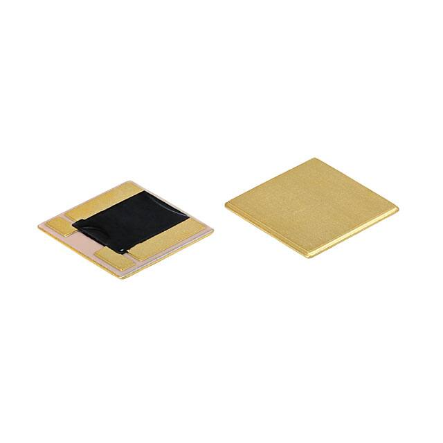

WFP www.vishay.com Vishay Dale Power Metal Plate™ Current Sense Resistors, Low Value (2 mΩ to 8 mΩ), Hybrid Mount, High Power FEATURES • 3939 size package with Kelvin terminals • Ideal for all types of current sensing and pulse applications including switching and linear power supplies, instruments, power amplifiers, Available shunts, and high power current sensing modules • Proprietary processing technique produces low resistance values (2 mΩ to 8 mΩ) • Solid metal manganese-copper and nickel- Available chromium alloy resistive element with low TCR (< 30 ppm/°C) • Max. solder temperature up to 280 °C / 30 s or 250 °C / 5 min Available • Very low inductance < 10 nH • Finishes available for wire bonding, sintering, and soldering (backside); Electroless Nickel Immersion Gold (ENIG) • Low thermal EMF (< 2 μV/°C) • AEC-Q200 qualified • Material categorization: for definitions of compliance please see www.vishay.com/doc?99912 LINKS TO ADDITIONAL RESOURCES 3D 3D 3D Models Note * This datasheet provides information about parts that are RoHS-compliant and / or parts that are non RoHS-compliant. For example, parts with lead (Pb) terminations are not RoHS-compliant. Please see the information / tables in this datasheet for details STANDARD ELECTRICAL SPECIFICATIONS GLOBAL MODEL SIZE POWER RATING (1) W TOLERANCE % RESISTANCE VALUE RANGE Ω WEIGHT (typical) g/1000 pieces WFPA3939 3939 20 at 120 °C ± 1.0, ± 5.0 0.002 to 0.005 437 WFPB3939 3939 20 at 120 °C ± 1.0, ± 5.0 0.0051 to 0.008 437 Note (1) Terminal temperature GLOBAL PART NUMBER INFORMATION Global Part Numbering Example: WFPA39392L000FEA W F P A GLOBAL MODEL (3 digits) ELEMENT MATERIAL (1 digit) WFP A = CuMn B = NiCrAl 3 9 3 CASE SIZE (4 digits) 3939 9 2 L 0 0 0 F E RESISTANCE VALUE (5 digits) TOLERANCE CODE (1 digit) PACKAGING CODE (1) (2 digits) L = mΩ* R = decimal 2L000 = 0.002 Ω R0100 = 0.01 Ω F = ± 1.0 % J = ± 5.0 % EA = lead (Pb)-free, tape / reel EK = lead (Pb)-free, bulk * Use “L” for resistance values < 0.01 Ω A SPECIAL (2 digits) Dash numbers 1 thru 99 as applicable Notes • Resistance values available per WSL decade values (www.vishay.com/doc?30117) (1) Packaging code: EB (lead (Pb)-free) is a non-standard packaging code designating 500 piece reels. This non-standard packaging code is identical to our standard EA (lead (Pb)-free), except that it has a package quantity of 500 pieces Revision: 26-Jan-2021 Document Number: 30394 1 For technical questions, contact: ww2bresistors@vishay.com THIS DOCUMENT IS SUBJECT TO CHANGE WITHOUT NOTICE. THE PRODUCTS DESCRIBED HEREIN AND THIS DOCUMENT ARE SUBJECT TO SPECIFIC DISCLAIMERS, SET FORTH AT www.vishay.com/doc?91000 WFP www.vishay.com Vishay Dale TECHNICAL SPECIFICATIONS PARAMETER UNIT 3939 RESISTOR CHARACTERISTICS Temperature coefficient (20 °C to 60 °C) (complete resistor) ppm/°C ± 75 Temperature coefficient (20 °C to 60 °C) (only element material) ppm/°C ± 30 Operating temperature range °C -65 to +170 Dielectric withstanding VAC 100 Maximum working voltage V (P x R)1/2 Maximum terminal temperature °C 120 DIMENSIONS in inches (millimeters) 0.030 (0.75) 0.012 (0.30) 0.099 (2.52) 0.09 (2.29) 0.279 (7.09) 0.122 (3.10) 0.025 (0.64) 0.025 (0.64) 0.053 (1.36) 0.075 (1.90) 0.394 (10.01) 0.410 (10.41) 0.075 (1.90) 0.270 (6.86) 0.270 (6.86) 0.075 (1.90) 0.071 (1.80) 0.071 (1.80) 0.410 (10.41) 0.394 (10.01) Bond area Solder pads Bond connections Note • Thermal resistance (°C/W): < 2.5 °C/W MATERIAL MIN. (μm) MAX. (μm) Au 0.05 0.15 Ni 3.1 6.1 Au 0.05 0.15 Ni 3.1 6.1 Backside finish Top side termination Revision: 26-Jan-2021 Cu (reference only) 50 Ni (WFMB only) < 0.01 Document Number: 30394 2 For technical questions, contact: ww2bresistors@vishay.com THIS DOCUMENT IS SUBJECT TO CHANGE WITHOUT NOTICE. THE PRODUCTS DESCRIBED HEREIN AND THIS DOCUMENT ARE SUBJECT TO SPECIFIC DISCLAIMERS, SET FORTH AT www.vishay.com/doc?91000 WFP www.vishay.com Vishay Dale DERATING Axis Title 10000 120 1000 80 1st line 2nd line 2nd line Rated Power (%) 100 60 100 40 20 10 0 0 20 40 60 80 100 120 140 160 180 Terminal Temperature (°C) PERFORMANCE TYPICAL PERFORMANCE TEST CONDITIONS OF TEST TEST LIMITS ALLOY A CuMn ALLOY B NiCr Thermal shock -55 °C to +150 °C, 1000 cycles, 15 min at each extreme ± 0.5 % ± 0.65 % ± 0.1 % Short time overload 2 x rated power, 5 s ± 0.5 % ± 0.05 % ± 0.05 % Low temperature storage -55 °C for 45 min ± 0.1 % ± 0.1 % ± 0.1 % High temperature exposure 1000 h at +170 °C ± 1.0 % ± 0.6 % ± 0.1 % Bias humidity +85 °C, 85 % RH, 10 % power, 1000 h ± 0.5 % ± 0.2 % ± 0.1 % Mechanical shock 100 g’s for 6 ms, 5 pulses ± 0.2 % ± 0.05 % ± 0.05 % Vibration Frequency varied, 10 Hz to 2000 Hz in 1 min, 3 directions, 12 h ± 0.2 % ± 0.05 % ± 0.05 % Load life 1000 h at 125 °C, 1.5 h “ON”, 0.5 h “OFF” ± 1.0 % ± 0.8 % ± 0.1 % Resistance to solder heat MIL-STD-202, method 210, test condition K ± 0.3 % ± 0.2 % ± 0.05 % Moisture resistance MIL-STD-202, method 106, 0 % power, 7b not required ± 0.3 % ± 0.05 % ± 0.05 % PACKAGING (1) REEL MODEL WFPA3939 WFPB3939 TAPE WIDTH DIAMETER PIECES/REEL CODE 16 mm / embossed plastic 330 mm / 13" 3000 EA Notes • Embossed carrier tape per EIA-481 (1) Additional packaging details at www.vishay.com/doc?20051 Revision: 26-Jan-2021 Document Number: 30394 3 For technical questions, contact: ww2bresistors@vishay.com THIS DOCUMENT IS SUBJECT TO CHANGE WITHOUT NOTICE. THE PRODUCTS DESCRIBED HEREIN AND THIS DOCUMENT ARE SUBJECT TO SPECIFIC DISCLAIMERS, SET FORTH AT www.vishay.com/doc?91000 Legal Disclaimer Notice www.vishay.com Vishay Disclaimer ALL PRODUCT, PRODUCT SPECIFICATIONS AND DATA ARE SUBJECT TO CHANGE WITHOUT NOTICE TO IMPROVE RELIABILITY, FUNCTION OR DESIGN OR OTHERWISE. Vishay Intertechnology, Inc., its affiliates, agents, and employees, and all persons acting on its or their behalf (collectively, “Vishay”), disclaim any and all liability for any errors, inaccuracies or incompleteness contained in any datasheet or in any other disclosure relating to any product. Vishay makes no warranty, representation or guarantee regarding the suitability of the products for any particular purpose or the continuing production of any product. To the maximum extent permitted by applicable law, Vishay disclaims (i) any and all liability arising out of the application or use of any product, (ii) any and all liability, including without limitation special, consequential or incidental damages, and (iii) any and all implied warranties, including warranties of fitness for particular purpose, non-infringement and merchantability. Statements regarding the suitability of products for certain types of applications are based on Vishay's knowledge of typical requirements that are often placed on Vishay products in generic applications. Such statements are not binding statements about the suitability of products for a particular application. It is the customer's responsibility to validate that a particular product with the properties described in the product specification is suitable for use in a particular application. Parameters provided in datasheets and / or specifications may vary in different applications and performance may vary over time. All operating parameters, including typical parameters, must be validated for each customer application by the customer's technical experts. Product specifications do not expand or otherwise modify Vishay's terms and conditions of purchase, including but not limited to the warranty expressed therein. Hyperlinks included in this datasheet may direct users to third-party websites. These links are provided as a convenience and for informational purposes only. Inclusion of these hyperlinks does not constitute an endorsement or an approval by Vishay of any of the products, services or opinions of the corporation, organization or individual associated with the third-party website. Vishay disclaims any and all liability and bears no responsibility for the accuracy, legality or content of the third-party website or for that of subsequent links. Except as expressly indicated in writing, Vishay products are not designed for use in medical, life-saving, or life-sustaining applications or for any other application in which the failure of the Vishay product could result in personal injury or death. Customers using or selling Vishay products not expressly indicated for use in such applications do so at their own risk. Please contact authorized Vishay personnel to obtain written terms and conditions regarding products designed for such applications. No license, express or implied, by estoppel or otherwise, to any intellectual property rights is granted by this document or by any conduct of Vishay. Product names and markings noted herein may be trademarks of their respective owners. © 2021 VISHAY INTERTECHNOLOGY, INC. ALL RIGHTS RESERVED Revision: 09-Jul-2021 1 Document Number: 91000
