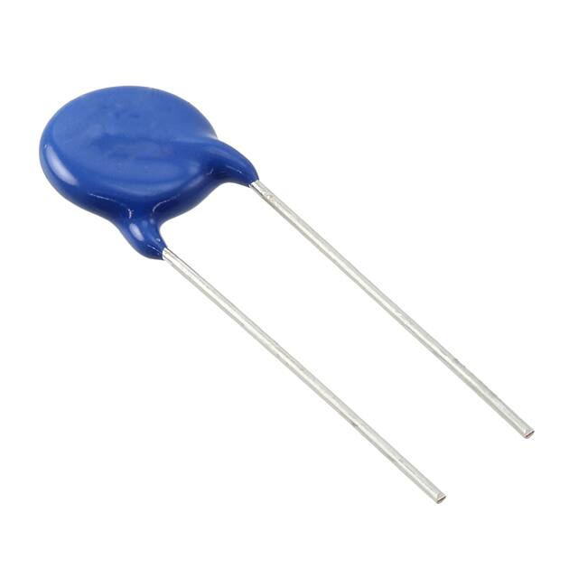

WKO Series www.vishay.com Vishay Roederstein EMI Suppression Capacitor, Ceramic Disc, Class X1, 440 VAC, Class Y2, 300 VAC FEATURES • Complying with IEC 60384-14 • High reliability • Wide range of different leadstyles • Singlelayer AC disc safety capacitors • Material categorization: for definitions of compliance please see www.vishay.com/doc?99912 APPLICATIONS • X1, Y2 according to IEC 60384-14.4 • Line-to-line filtering (Class X) LINKS TO ADDITIONAL RESOURCES • Line-to-ground filtering (Class Y) 3D 3D • EMI / RFI suppression and filtering • Primary and secondary coupling (SMPS) 3D Models DESIGN QUICK REFERENCE DATA DESCRIPTION The capacitors consist of ceramic disc both sides of which are silver plated. Connection leads are made of tinned copper having diameters of 0.6 mm or 0.8 mm. VALUE Ceramic Class 1 Ceramic Dielectric Voltage (VAC) 2 N750 N750 Y5S, Y5T, Y5U Y5S, Y5T, Y5U The capacitors may be supplied with straight or kinked leads having a lead spacing of 7.5 mm or 12.5 mm. 300 440 300 440 Coating is made of blue colored flame retardant epoxy resin in accordance with UL 94 V-0. Min. Capacitance (pF) 33 68 Max. Capacitance (pF) 47 4700 Mounting Radial OPERATING TEMPERATURE RANGE -40 °C to +125 °C (1) CAPACITANCE RANGE 33 pF to 4.7 nF TOLERANCE ON CAPACITANCE ± 10 %, ± 20 % Note (1) For explanation about the difference of operating temperature range and temperature characteristic of capacitance please see www.vishay.com/doc?48299 RATED VOLTAGE • X1: 440 VAC, 50 Hz (IEC 60384-14) 440 VAC, 50 Hz / 60 Hz (US/UL/CSA 60384-14) TEMPERATURE CHARACTERISTICS • Y2: 300 VAC, 50 Hz (IEC 60384-14) 300 VAC, 50 Hz / 60 Hz (US/UL/CSA 60384-14) Class 1 N750 (U2J) Class 2 Y5S, Y5T, Y5U SECTIONAL SPECIFICATIONS Climatic category (according to EN 60058-1) Class 1 40 / 125 / 21 Class 2 40 / 125 / 21 APPROVALS TEST VOLTAGE • 2600 VAC, 50 Hz, 2 s Component test (100 %) • 2600 VAC, 50 Hz, 60 s Random sampling test (destructive) • 2600 VAC, 50 Hz, 60 s Voltage proof of coating (destructive) INSULATION RESISTANCE AT 500 VDC ≥ 6000 MΩ (60 s) IEC 60384-14 DISSIPATION FACTOR UL 60384-14 Class 1: max. 0.5 % (1 MHz) CSA E60384-14 Class 2: max. 2.5 % (1 kHz) Revision: 10-Sep-2021 Document Number: 22204 1 For technical questions, contact: slcap@vishay.com THIS DOCUMENT IS SUBJECT TO CHANGE WITHOUT NOTICE. THE PRODUCTS DESCRIBED HEREIN AND THIS DOCUMENT ARE SUBJECT TO SPECIFIC DISCLAIMERS, SET FORTH AT www.vishay.com/doc?91000 WKO Series www.vishay.com Vishay Roederstein DIMENSIONS in millimeters Smax. 3.0 max. Dmax. V F 30 - 3 or 10 ± 1 Ø d ± 0.05 TECHNICAL DATA CAPACITANCE (1) C (pF) CAPACITANCE TOLERANCE BODY DIAMETER DMAX. (mm) BODY THICKNESS SMAX. (mm) LEAD SPACING (2) F (mm) ± 1 mm LEAD DIAMETER (2) d (mm) ± 0.05 mm WIDTH (2) V (mm) ± 0.5 mm N750 (U2J) 33 ± 10 %, 8.0 5.0 7.5 0.6 1.6 ± 20 % 47 Y5S (2C3) 68 ± 10 %, 8.0 5.0 7.5 0.6 1.9 ± 20 % 100 Y5T (2D3) 150 ± 10 %, 220 8.0 5.0 7.5 0.6 1.9 ± 20 % 330 Y5U (2E3) 470 8.0 0.6 2.0 680 9.0 1000 10.0 7.5 1500 12.0 ± 10 %, 5.0 ± 20 % 2200 13.0 0.8 1.6 3300 15.0 3900 16.0 4700 18.0 12.5 Notes (1) Capacitance values from 1 nF to 4.7 nF: the alternative usage of VKO series is recommended for new application (2) Standard lead configuration, other lead spacing and diameter available on request PART NUMBER MISSING DIGITS SEE ORDERING CODE BELOW WKO330#CP###KR WKO470#CP###KR WKO680#CP###KR WKO101#CP###KR WKO151#CP###KR WKO221#CP###KR WKO331#CP###KR WKO471#CP###KR WKO681#CP###KR WKO102#CP###KR WKO152#CP###KR WKO222#CP###KR WKO332#CP###KR WKO392#CP###KR WKO472#CP###KR ORDERING CODE # ### Example 7th digit 10th to 12th digit WKO Series Capacitance tolerance Lead configuration 222 M Capacitance Tolerance code value ± 10 % = K, ± 20 % = M See “General Information” www.vishay.com/doc?22001 CP CJ0 K R Lead Voltage code Internal code RoHS compliant configuration MARKING WKO 440~X1 300~Y2 33p M WKO 33 pF to 1.0 nF Revision: 10-Sep-2021 WKO 2n2 M IEC 384-14 440 300 250~ X1 Y2 WKO 1.5 nF to 4.7 nF Document Number: 22204 2 For technical questions, contact: slcap@vishay.com THIS DOCUMENT IS SUBJECT TO CHANGE WITHOUT NOTICE. THE PRODUCTS DESCRIBED HEREIN AND THIS DOCUMENT ARE SUBJECT TO SPECIFIC DISCLAIMERS, SET FORTH AT www.vishay.com/doc?91000 WKO Series www.vishay.com Vishay Roederstein APPROVALS IEC 60384-14 - Safety tests This approval together with CB test certificate substitutes all national approvals. CB Certificate (www.vishay.com/doc?22217) Y2-capacitor: CB test certificate: US-26157-UL 33 pF to 4.7 nF 300 VAC X1-capacitor: CB test certificate: US-26157-UL 33 pF to 4.7 nF 440 VAC Y2-capacitor: VDE marks approval: 136820 33 pF to 4.7 nF 300 VAC X1-capacitor: VDE marks approval: 136820 33 pF to 4.7 nF 440 VAC Minimum thickness of insulation: 0.4 mm VDE (www.vishay.com/doc?22219) DIN EN 60384-14 (VDE 0565-1-1) Minimum thickness of insulation: 0.4 mm Underwriters Laboratories Inc. / Canadian Standards Association (www.vishay.com/doc?22218) Y2-capacitor: UL-test certificate: E183844 33 pF to 4.7 nF 300 VAC X1-capacitor: UL-test certificate: E183844 33 pF to 4.7 nF 440 VAC UL 60384-14, CSA E60384-14 Minimum thickness of insulation: 0.4 mm IMPEDANCE VS. FREQUENCY (typical) 3000 10 Z (Ω) I (μA) AC CURRENT VS. VOLTAGE (typical) 4.7 nF 2000 1 4700 pF 3900 pF 3300 pF 2200 pF 1500 pF 1000 pF 680 pF 470 pF 330 pF 220 pF 150 pF 100 pF 68 pF 47 pF 33 pF 3.3 nF 2.2 nF 1000 0.1 1 nF 0 0.01 0 500 1000 1500 2000 1 2500 10 100 UR (V~) 1000 f (MHz) STORAGE The capacitors must not be stored in a corrosive atmosphere, where sulphide or chloride gas, acid, alkali or salt are present. Exposure of the components to moisture, should be avoided. The solderability of the leads is not affected by storage of up to 24 months (temperature +10 °C to +35 °C, relative humidity up to 60 %). Class 2 ceramic dielectric capacitors are also subject to aging, see www.vishay.com/doc?22001. SOLDERING SOLDERING SPECIFICATIONS Soldering test for capacitors with wire leads: (according to IEC 60068-2-20, solder bath method) Soldering temperature Soldering duration Distance from component body Revision: 10-Sep-2021 SOLDERABILITY RESISTANCE TO SOLDERING HEAT 235 °C ± 5 °C 260 °C ± 5 °C 2 s ± 0.5 s 10 s ± 1 s ≥ 2 mm ≥ 5 mm Document Number: 22204 3 For technical questions, contact: slcap@vishay.com THIS DOCUMENT IS SUBJECT TO CHANGE WITHOUT NOTICE. THE PRODUCTS DESCRIBED HEREIN AND THIS DOCUMENT ARE SUBJECT TO SPECIFIC DISCLAIMERS, SET FORTH AT www.vishay.com/doc?91000 WKO Series www.vishay.com Vishay Roederstein SOLDERING RECOMMENDATIONS Soldering of the component should be achieved using a Sn60/40 type or a silver-bearing Sn62/36/2Ag type solder. Ceramic capacitors are very sensitive to rapid changes in temperature (thermal shock) therefore the solder heat resistance specification (see Soldering Specifications table) should not be exceeded. Subjecting the capacitor to excessive heating may result in thermal shocks that can crack the ceramic body. Similarly, excessive heating can cause the internal solder junction to melt. CLEANING The components should be cleaned immediately following the soldering operation with vapor degreasers. SOLVENT RESISTANCE The coating and marking of the capacitors are resistant to the following test method: IEC 60068-2-45 (method XA). MOUNTING If a defined product stop is required for mounting on a PCB, a mechanically formed product stop (kinked or inline wire) or a mounting tool should be used. We do not recommend modifying the lead terminals, e.g. bending or cropping. This action could break the coating or crack the ceramic insert. If however, the lead must be modified in any way, we recommend support of the lead with a clamping fixture next to the coating. OPERATING VOLTAGE In case the voltage is applied to the circuit, starting as well as stopping, may generate irregular voltage for a transit period because of resonance or switching. Be sure to use a capacitor with a rated voltage range that includes these irregular voltages. OPERATING TEMPERATURE AND SELF-GENERATED HEAT Keep the surface temperature of a capacitor below the upper limit of its rated operating temperature range. Be sure to take into account the heat generated by the capacitor itself. When the capacitor is used in a high frequency, pulse, or similar application, it may have self-generated heat due to dielectric dissipation. Temperature increase due to self-generated heating should not exceed 20 °C while operating at an atmosphere temperature of 25 °C. When measuring, the surface temperature, make sure that the capacitor is not affected by radiant, conductive and convective heat by its surroundings. Excessive heat may lead to thermo-mechanical deterioration of the capacitor's characteristics and reliability. RELATED DOCUMENTS General Information www.vishay.com/doc?22001 CB Test Certificate www.vishay.com/doc?22217 VDE Marks Approval www.vishay.com/doc?22219 UL Test Certificate www.vishay.com/doc?22218 Revision: 10-Sep-2021 Document Number: 22204 4 For technical questions, contact: slcap@vishay.com THIS DOCUMENT IS SUBJECT TO CHANGE WITHOUT NOTICE. THE PRODUCTS DESCRIBED HEREIN AND THIS DOCUMENT ARE SUBJECT TO SPECIFIC DISCLAIMERS, SET FORTH AT www.vishay.com/doc?91000 Legal Disclaimer Notice www.vishay.com Vishay Disclaimer ALL PRODUCT, PRODUCT SPECIFICATIONS AND DATA ARE SUBJECT TO CHANGE WITHOUT NOTICE TO IMPROVE RELIABILITY, FUNCTION OR DESIGN OR OTHERWISE. Vishay Intertechnology, Inc., its affiliates, agents, and employees, and all persons acting on its or their behalf (collectively, “Vishay”), disclaim any and all liability for any errors, inaccuracies or incompleteness contained in any datasheet or in any other disclosure relating to any product. Vishay makes no warranty, representation or guarantee regarding the suitability of the products for any particular purpose or the continuing production of any product. To the maximum extent permitted by applicable law, Vishay disclaims (i) any and all liability arising out of the application or use of any product, (ii) any and all liability, including without limitation special, consequential or incidental damages, and (iii) any and all implied warranties, including warranties of fitness for particular purpose, non-infringement and merchantability. Statements regarding the suitability of products for certain types of applications are based on Vishay's knowledge of typical requirements that are often placed on Vishay products in generic applications. Such statements are not binding statements about the suitability of products for a particular application. It is the customer's responsibility to validate that a particular product with the properties described in the product specification is suitable for use in a particular application. Parameters provided in datasheets and / or specifications may vary in different applications and performance may vary over time. All operating parameters, including typical parameters, must be validated for each customer application by the customer's technical experts. Product specifications do not expand or otherwise modify Vishay's terms and conditions of purchase, including but not limited to the warranty expressed therein. Hyperlinks included in this datasheet may direct users to third-party websites. These links are provided as a convenience and for informational purposes only. Inclusion of these hyperlinks does not constitute an endorsement or an approval by Vishay of any of the products, services or opinions of the corporation, organization or individual associated with the third-party website. Vishay disclaims any and all liability and bears no responsibility for the accuracy, legality or content of the third-party website or for that of subsequent links. Except as expressly indicated in writing, Vishay products are not designed for use in medical, life-saving, or life-sustaining applications or for any other application in which the failure of the Vishay product could result in personal injury or death. Customers using or selling Vishay products not expressly indicated for use in such applications do so at their own risk. Please contact authorized Vishay personnel to obtain written terms and conditions regarding products designed for such applications. No license, express or implied, by estoppel or otherwise, to any intellectual property rights is granted by this document or by any conduct of Vishay. Product names and markings noted herein may be trademarks of their respective owners. © 2021 VISHAY INTERTECHNOLOGY, INC. ALL RIGHTS RESERVED Revision: 09-Jul-2021 1 Document Number: 91000
WKO222MCPQL0KR
物料型号:Vishay WKO系列
器件简介:WKO系列是Vishay Roederstein生产的电磁干扰(EMI)抑制陶瓷圆盘电容器。这些电容器符合IEC 60384-14标准,分为X1类(440 VAC)和Y2类(300 VAC)。
引脚分配:电容器的连接引脚由直径为0.6毫米或0.8毫米的镀锡铜制成,可以提供直引脚或弯曲引脚,引脚间距为7.5毫米或12.5毫米。
参数特性: - 工作温度范围:-40°C至+125°C - 电容值范围:33pF至4.7nF - 电容公差:±10%或±20% - 额定电压:X1类为440 VAC,Y2类为300 VAC - 绝缘电阻:≥6000 MΩ(500 VDC下,60秒) - 耗散因数:Class 1最大0.5%(1 MHz),Class 2最大2.5%(1 kHz)
功能详解:WKO系列电容器用于EMI/RFI抑制和滤波,适用于线路对线路(Class X)和线路对地(Class Y)的滤波,以及开关电源(SMPS)的主次级耦合。
应用信息:这些电容器广泛应用于需要EMI抑制的场合,如电源线滤波、开关电源等。
封装信息:电容器由蓝色阻燃环氧树脂涂层包裹,符合UL 94 V-0标准。封装尺寸根据电容值不同而有所变化,具体尺寸信息在文档中有详细说明。
