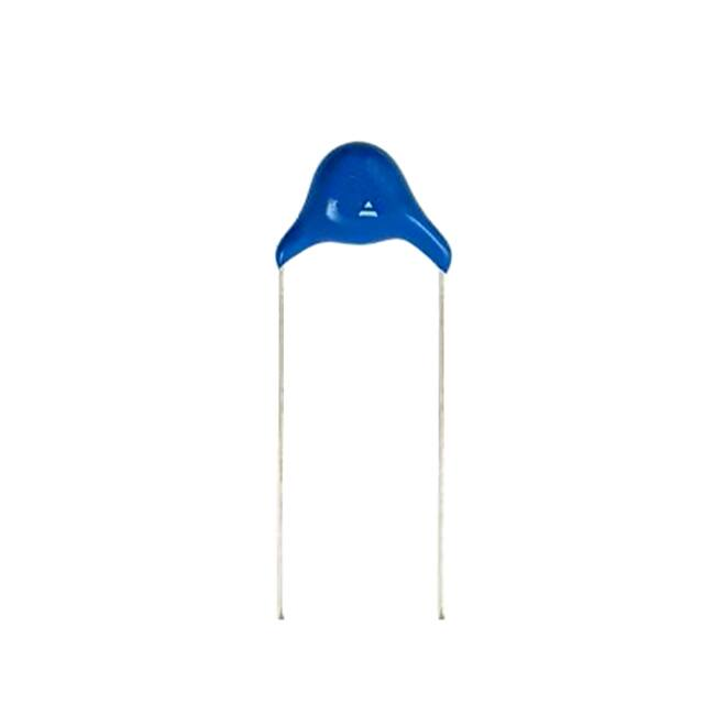

WKP Series www.vishay.com Vishay Roederstein EMI Suppression Capacitor, Ceramic Disc, Class X1, 760 VAC, Class Y1, 500 VAC FEATURES • Complying with IEC 60384-14 • High reliability • Wide range of different leadstyles • Singlelayer AC disc safety capacitors • Material categorization: for definitions of compliance please see www.vishay.com/doc?99912 APPLICATIONS • X1, Y1 according to IEC 60384-14 • Line-to-line filtering (Class X) LINKS TO ADDITIONAL RESOURCES • Line-to-ground filtering (Class Y) • EMI / RFI suppression and filtering 3D 3D • Primary and secondary coupling (SMPS) 3D Models DESIGN QUICK REFERENCE DATA DESCRIPTION The capacitors consist of ceramic disc both sides of which are silver plated. Connection leads are made of tinned copper having diameters of 0.6 mm or 0.8 mm. VALUE Ceramic Class 1 Ceramic Dielectric Voltage (VAC) 2 N750 N750 Y5S, Y5T, Y5U Y5S, Y5T, Y5U The capacitors may be supplied with straight or kinked leads having a lead spacing of 10.0 mm or 12.5 mm. 500 760 500 760 Coating is made of blue colored flame retardant epoxy resin in accordance with UL 94 V-0. Min. Capacitance (pF) 33 47 Max. Capacitance (pF) 33 4700 Mounting Radial OPERATING TEMPERATURE RANGE -40 °C to +125 °C (1) CAPACITANCE RANGE 33 pF to 4.7 nF TOLERANCE ON CAPACITANCE ± 10 %, ± 20 % Note (1) For explanation about the difference of operating temperature range and temperature characteristic of capacitance please see www.vishay.com/doc?48299 RATED VOLTAGE • X1: 760 VAC, 50 Hz (IEC 60384-14) 760 VAC, 50 Hz / 60 Hz (US/UL/CSA 60384-14) TEMPERATURE CHARACTERISTICS • Y1: 500 VAC, 50 Hz (IEC 60384-14) 500 VAC, 50 Hz / 60 Hz (US/UL/CSA 60384-14) Class 1 N750 (U2J) Class 2 Y5S, Y5T, Y5U SECTIONAL SPECIFICATIONS Climatic category (according to EN 60068-1) Class 1 40 / 125 / 21 Class 2 40 / 125 / 21 APPROVALS TEST VOLTAGE • 4000 VAC, 50 Hz, 2 s Component test (100 %) • 4000 VAC, 50 Hz, 60 s Random sampling test (destructive) • 4000 VAC, 50 Hz, 60 s Voltage proof of coating (destructive) INSULATION RESISTANCE AT 500 VDC ≥ 10 000 MΩ (60 s) IEC 60384-14 DISSIPATION FACTOR UL 60384-14 Class 1: max. 0.5 % (1 kHz) CSA E60384-14 Class 2: max. 2.5 % (1 kHz) Revision: 10-Sep-2021 Document Number: 22206 1 For technical questions, contact: slcap@vishay.com THIS DOCUMENT IS SUBJECT TO CHANGE WITHOUT NOTICE. THE PRODUCTS DESCRIBED HEREIN AND THIS DOCUMENT ARE SUBJECT TO SPECIFIC DISCLAIMERS, SET FORTH AT www.vishay.com/doc?91000 WKP Series www.vishay.com Vishay Roederstein DIMENSIONS in millimeters Smax. 3.0 max. Dmax. V F 30 - 3 or 10 ± 1 Ø d ± 0.05 TECHNICAL DATA CAPACITANCE (2) C (pF) CAPACITANCE TOLERANCE BODY DIAMETER DMAX. (mm) BODY THICKNESS SMAX. (mm) LEAD SPACING (1) F (mm) ± 1 mm LEAD DIAMETER (1) d (mm) ± 0.05 mm WIDTH (1) V (mm) ± 0.5 mm ± 10 %, ± 20 % 8.0 6.0 12.5 0.6 1.9 ± 10 %, ± 20 % 8.0 6.0 12.5 0.6 2.3 PART NUMBER MISSING DIGITS SEE ORDERING CODE BELOW N750 (U2J) 33 WKP330#CP###KR Y5S (2C3) 47 WKP470#CP###KR 68 WKP680#CP###KR 100 WKP101#CP###KR Y5T (2D3) 150 ± 10 %, ± 20 % 220 8.0 6.0 12.5 0.6 2.3 0.6 2.5 WKP151#CP###KR WKP221#CP###KR Y5U (2E3) 330 WKP331#CP###KR 8.0 470 680 WKP471#CP###KR 9.0 1000 WKP681#CP###KR 10.0 ± 10 %, ± 20 % 1500 WKP102#CP###KR 12.0 6.0 WKP152#CP###KR 12.5 2200 13.0 3300 15.0 3900 16.0 WKP392#CP###KR 4700 18.0 WKP472#CP###KR 0.8 WKP222#CP###KR 2.7 WKP332#CP###KR Notes (1) Standard lead configuration, other lead spacing and diameter available on request (2) Capacitance values from 1 nF to 4.7 nF: the alternative usage of smaller VKP series is recommended for new application. ORDERING CODE # 7th digit Capacitance tolerance ± 10 % = K, ± 20 % = M ### 10th to 12th digit Lead configuration See “General Information” www.vishay.com/doc?22001 Example WKP 222 M CP ED0 K R Series Capacitance value Tolerance code Voltage code Lead configuration Internal code RoHS compliant Revision: 10-Sep-2021 Document Number: 22206 2 For technical questions, contact: slcap@vishay.com THIS DOCUMENT IS SUBJECT TO CHANGE WITHOUT NOTICE. THE PRODUCTS DESCRIBED HEREIN AND THIS DOCUMENT ARE SUBJECT TO SPECIFIC DISCLAIMERS, SET FORTH AT www.vishay.com/doc?91000 WKP Series www.vishay.com Vishay Roederstein MARKING WKP IEC 384-14 760 500 250~ X1 Y1 760~X1 500~Y1 33p M WKP 2n2 M WKP 33 pF to 1.5 nF WKP 2.2 nF to 4.7 nF APPROVALS IEC 60384-14 - Safety tests This approval together with CB test certificate substitutes all national approvals. CB Certificate (www.vishay.com/doc?22214) Y1-capacitor: CB test certificate: US-26549-UL 33 pF to 4.7 nF 500 VAC X1-capacitor: CB test certificate: US-26549-UL 33 pF to 4.7 nF 760 VAC Y1-capacitor: VDE marks approval: 136493 33 pF to 4.7 nF 500 VAC X1-capacitor: VDE marks approval: 136493 33 pF to 4.7 nF 760 VAC Minimum thickness of insulation: 0.4 mm VDE (www.vishay.com/doc?22216) DIN EN 60384-14 (VDE 0565-1-1) Minimum thickness of insulation: 0.4 mm Underwriters Laboratories Inc. / Canadian Standards Association (www.vishay.com/doc?22215) Y1-capacitor: UL-test certificate: E183844 33 pF to 4.7 nF 500 VAC X1-capacitor: UL-test certificate: E183844 33 pF to 4.7 nF 760 VAC UL 60384-14, CSA E60384-14 Minimum thickness of insulation: 0.4 mm IMPEDANCE VS. FREQUENCY (typical) 5000 Z (Ω) I (μA) AC CURRENT VS. VOLTAGE (typical) 4000 10 4.7 nF 1 3000 2000 2.2 nF 1000 1.0 nF 4700 pF 3900 pF 3300 pF 2200 pF 1500 pF 1000 pF 680 pF 470 pF 330 pF 220 pF 150 pF 100 pF 68 pF 3.3 nF 0.1 470 pF 0 0.01 0 500 1000 1500 2000 2500 3000 3500 4000 UR (V~) Revision: 10-Sep-2021 1 10 100 1000 f (MHz) Document Number: 22206 3 For technical questions, contact: slcap@vishay.com THIS DOCUMENT IS SUBJECT TO CHANGE WITHOUT NOTICE. THE PRODUCTS DESCRIBED HEREIN AND THIS DOCUMENT ARE SUBJECT TO SPECIFIC DISCLAIMERS, SET FORTH AT www.vishay.com/doc?91000 WKP Series www.vishay.com Vishay Roederstein STORAGE The capacitors must not be stored in a corrosive atmosphere, where sulphide or chloride gas, acid, alkali or salt are present. Exposure of the components to moisture, should be avoided. The solderability of the leads is not affected by storage of up to 24 months (temperature +10 °C to +35 °C, relative humidity up to 60 %). Class 2 ceramic dielectric capacitors are also subject to aging, see www.vishay.com/doc?22001. SOLDERING SOLDERING SPECIFICATIONS Soldering test for capacitors with wire leads: (according to IEC 60068-2-20, solder bath method) Soldering temperature Soldering duration Distance from component body SOLDERABILITY RESISTANCE TO SOLDERING HEAT 235 °C ± 5 °C 260 °C ± 5 °C 2 s ± 0.5 s 10 s ± 1 s ≥ 2 mm ≥ 5 mm SOLDERING RECOMMENDATIONS Soldering of the component should be achieved using a Sn60/40 type or a silver-bearing Sn62/36/2Ag type solder. Ceramic capacitors are very sensitive to rapid changes in temperature (thermal shock) therefore the solder heat resistance specification (see Soldering Specifications table) should not be exceeded. Subjecting the capacitor to excessive heating may result in thermal shocks that can crack the ceramic body. Similarly, excessive heating can cause the internal solder junction to melt. CLEANING The components should be cleaned immediately following the soldering operation with vapor degreasers. SOLVENT RESISTANCE The coating and marking of the capacitors are resistant to the following test method: IEC 60068-2-45 (method XA). MOUNTING If a defined product stop is required for mounting on a PCB, a mechanically formed product stop (kinked or inline wire) or a mounting tool should be used. We do not recommend modifying the lead terminals, e.g. bending or cropping. This action could break the coating or crack the ceramic insert. If however, the lead must be modified in any way, we recommend support of the lead with a clamping fixture next to the coating. OPERATING VOLTAGE In case the voltage is applied to the circuit, starting as well as stopping, may generate irregular voltage for a transit period because of resonance or switching. Be sure to use a capacitor with a rated voltage range that includes these irregular voltages. OPERATING TEMPERATURE AND SELF-GENERATED HEAT Keep the surface temperature of a capacitor below the upper limit of its rated operating temperature range. Be sure to take into account the heat generated by the capacitor itself. When the capacitor is used in a high frequency, pulse, or similar application, it may have self-generated heat due to dielectric dissipation. Temperature increase due to self-generated heating should not exceed 20 °C while operating at an atmosphere temperature of 25 °C. When measuring, the surface temperature, make sure that the capacitor is not affected by radiant, conductive and convective heat by its surroundings. Excessive heat may lead to thermo-mechanical deterioration of the capacitor's characteristics and reliability. RELATED DOCUMENTS General Information www.vishay.com/doc?22001 CB Test Certificate www.vishay.com/doc?22214 VDE Marks Approval www.vishay.com/doc?22216 UL Test Certificate www.vishay.com/doc?22215 Revision: 10-Sep-2021 Document Number: 22206 4 For technical questions, contact: slcap@vishay.com THIS DOCUMENT IS SUBJECT TO CHANGE WITHOUT NOTICE. THE PRODUCTS DESCRIBED HEREIN AND THIS DOCUMENT ARE SUBJECT TO SPECIFIC DISCLAIMERS, SET FORTH AT www.vishay.com/doc?91000 Legal Disclaimer Notice www.vishay.com Vishay Disclaimer ALL PRODUCT, PRODUCT SPECIFICATIONS AND DATA ARE SUBJECT TO CHANGE WITHOUT NOTICE TO IMPROVE RELIABILITY, FUNCTION OR DESIGN OR OTHERWISE. Vishay Intertechnology, Inc., its affiliates, agents, and employees, and all persons acting on its or their behalf (collectively, “Vishay”), disclaim any and all liability for any errors, inaccuracies or incompleteness contained in any datasheet or in any other disclosure relating to any product. Vishay makes no warranty, representation or guarantee regarding the suitability of the products for any particular purpose or the continuing production of any product. To the maximum extent permitted by applicable law, Vishay disclaims (i) any and all liability arising out of the application or use of any product, (ii) any and all liability, including without limitation special, consequential or incidental damages, and (iii) any and all implied warranties, including warranties of fitness for particular purpose, non-infringement and merchantability. Statements regarding the suitability of products for certain types of applications are based on Vishay's knowledge of typical requirements that are often placed on Vishay products in generic applications. Such statements are not binding statements about the suitability of products for a particular application. It is the customer's responsibility to validate that a particular product with the properties described in the product specification is suitable for use in a particular application. Parameters provided in datasheets and / or specifications may vary in different applications and performance may vary over time. All operating parameters, including typical parameters, must be validated for each customer application by the customer's technical experts. Product specifications do not expand or otherwise modify Vishay's terms and conditions of purchase, including but not limited to the warranty expressed therein. Hyperlinks included in this datasheet may direct users to third-party websites. These links are provided as a convenience and for informational purposes only. Inclusion of these hyperlinks does not constitute an endorsement or an approval by Vishay of any of the products, services or opinions of the corporation, organization or individual associated with the third-party website. Vishay disclaims any and all liability and bears no responsibility for the accuracy, legality or content of the third-party website or for that of subsequent links. Except as expressly indicated in writing, Vishay products are not designed for use in medical, life-saving, or life-sustaining applications or for any other application in which the failure of the Vishay product could result in personal injury or death. Customers using or selling Vishay products not expressly indicated for use in such applications do so at their own risk. Please contact authorized Vishay personnel to obtain written terms and conditions regarding products designed for such applications. No license, express or implied, by estoppel or otherwise, to any intellectual property rights is granted by this document or by any conduct of Vishay. Product names and markings noted herein may be trademarks of their respective owners. © 2021 VISHAY INTERTECHNOLOGY, INC. ALL RIGHTS RESERVED Revision: 09-Jul-2021 1 Document Number: 91000

物料型号:WKP系列
器件简介: - 这些电容器是用于电磁干扰(EMI)抑制和滤波的陶瓷圆盘安全电容器。 - 符合IEC 60384-14标准,X1类为760 VAC,Y1类为500 VAC。 - 特点是高可靠性、多种引脚样式、单层交流圆盘结构,并且符合RoHS标准。
引脚分配: - 电容器的连接引脚由直径为0.6 mm或0.8 mm的镀锡铜制成。 - 引脚可以是直的或弯曲的,引脚间距为10.0 mm或12.5 mm。
参数特性: - 电容值范围:33 pF至4.7 nF。 - 工作温度范围:-40 °C至+125 °C。 - 电容公差:±10%或±20%。 - 额定电压:X1类为760 VAC,Y1类为500 VAC。
功能详解: - 用于线路间(X1类)和线路对地(Y1类)的滤波。 - 用于EMI/RFI抑制和滤波。 - 用于开关电源的主次级耦合。
应用信息: - 适用于需要EMI抑制的多种应用场景,如电源线滤波。
封装信息: - 电容器由蓝色阻燃环氧树脂涂层包裹,符合UL 94 V-0标准。 - 提供径向安装方式。
其他技术细节: - 绝缘电阻:≥ 10,000 MΩ (60秒, 500 VDC)。 - 损耗因数:Class 1最大0.5% (1 kHz),Class 2最大2.5% (1 kHz)。 - 测试电压:4000 VAC,50 Hz,2秒(组件测试),60秒(破坏性抽样测试)。
订购代码: - 提供了详细的订购代码示例,包括系列、电容值、容差代码、电压代码、引脚配置和RoHS合规性。
存储和焊接规格: - 电容器不应存储在腐蚀性环境中。 - 焊接时应使用Sn60/40型或含银Sn62/36/2Ag型焊料,避免热冲击。
