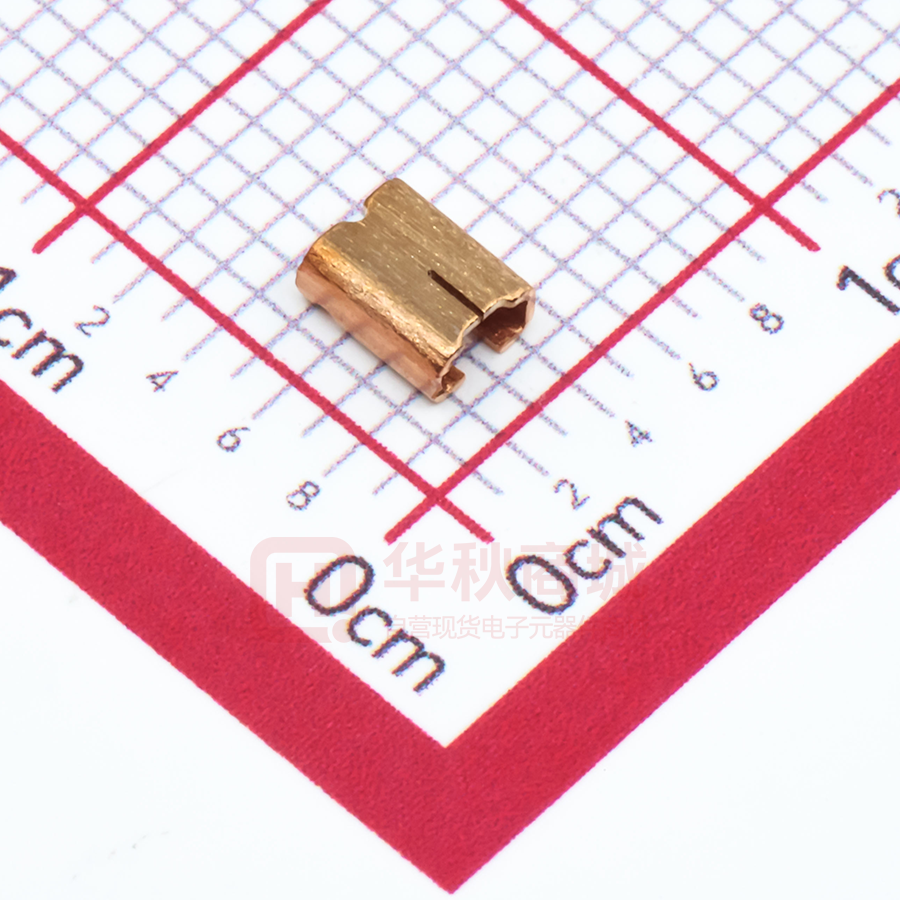

WSK1216 www.vishay.com Vishay Dale Power Metal Strip® Resistors, Low Value, High Power, Surface-Mount, 4-Terminal FEATURES • 4-terminal design allows for 1 % tolerance down to 0.0002 Ω • High power-to-footprint print size ratio • All welded Power Metal Strip® construction is ideal for all types of current sensing, voltage division and pulse applications • Proprietary processing technique produces extremely low resistance values, down to 0.0002 Ω • Sulfur resistance by construction that is unaffected by high sulfur environments • Solid metal manganese-copper and manganese-coppertin alloy resistive element with low TCR (< 20 ppm/°C) • Very low inductance 0.5 nH to 5 nH • Low thermal EMF (< 3 μV/°C) • Maximum solder temperature up to 350 °C for 30 s • AEC-Q200 qualified (1) • PATENT(S): www.vishay.com/patents • Material categorization: for definitions of compliance please see www.vishay.com/doc?99912 LINKS TO ADDITIONAL RESOURCES 3D 3D 3D Models Design Tools Infographics Notes • Follow link to Overview of Automotive Grade Products for more details: www.vishay.com/doc?49924 (1) Flame retardance test may not be applicable to some resistor technologies STANDARD ELECTRICAL SPECIFICATIONS GLOBAL MODEL SIZE WSK1216 1216 POWER RATING P70 °C W 3.0 5.0 8.0 8.0 THERMAL RESISTANCE °C/W 14.5 7.3 3.6 3 RESISTANCE VALUE RANGE (1) Ω 1m 0.5m 0.3m 0.2m TOLERANCE ±% 1.0 1.0 1.0 1.0 WEIGHT (typical) g/1000 pieces 60 60 60 60 Notes • The full power rating of Power Metal Strip resistors are dependent upon the ability of the circuit board to dissipate the heat energy created in the resistance element. It is recommended to follow common design practices for power semiconductors that ensure the junction temperature is maintained with in thermal limits by using large pad surfaces, thermal vias, heavier copper weights, internal layers as well as other thermal spreading features. The thermal resistance values provided function in the same manner as junction to terminal temperature (1) Other values may be available, contact factory GLOBAL PART NUMBER INFORMATION Global Part Numbering Example: WSK12161L000FEA (WSK1216, 0.001 Ω, ± 1 %) (visit www.vishay.net Vishay Dale parts numbering manual for all options) W S K 1 2 1 6 1 L 0 0 0 F E A GLOBAL MODEL (7 digits) RESISTANCE VALUE (5 digits) TOLERANCE CODE (1 digit) PACKAGING CODE (1) (2 digits) SPECIAL (2) (2 digits) WSK1216 L = mΩ 1L000 = 0.0010 Ω L5000 = 0.0005 Ω F = ± 1.0 % EA = lead (Pb)-free, tape / reel (dash number) (up to 2 digits) From 1 to 99 as applicable Notes (1) Packaging code: EB (lead (Pb)-free) is a non-standard packaging code designating 1000 piece reels. The non-standard packaging code is identical to our standard EA (lead (Pb)-free), except that it has a package quantity of 1000 pieces (2) Follow link for customization capabilities: www.vishay.com/doc?48163 PATENT(S): www.vishay.com/patents This Vishay product is protected by one or more United States and international patents. Revision: 10-Dec-2021 Document Number: 30189 1 For technical questions, contact: ww2bresistors@vishay.com THIS DOCUMENT IS SUBJECT TO CHANGE WITHOUT NOTICE. THE PRODUCTS DESCRIBED HEREIN AND THIS DOCUMENT ARE SUBJECT TO SPECIFIC DISCLAIMERS, SET FORTH AT www.vishay.com/doc?91000 WSK1216 www.vishay.com Vishay Dale TECHNICAL SPECIFICATIONS PARAMETER Component temperature coefficient (including terminal) (1) Element TCR (3) Operating temperature range Maximum working voltage (4) UNIT WSK RESISTOR CHARACTERISTICS ppm/°C < 35 ppm, 0.2 mΩ and 0.3 mΩ < 50 ppm, 1 mΩ < 150 ppm, 0.5 mΩ ppm/°C < 20 °C -65 to +170 V (P x R)1/2 Notes (1) Component TCR - total TCR that includes the TCR effects of the resistor element and the copper terminal; over temperature of +20 °C to +60 °C (2) Element TCR - only applies to the alloy used for the resistor element (3) Maximum working voltage - the WSL is not voltage sensitive, but is limited by power / energy dissipation and is also not ESD sensitive DIMENSIONS in inches (millimeters) CONSTRUCTION OUTLINE W L R N 2 H S U 3 1 Resistive element: refer to table below for element material 2 Terminal: solid copper 3 Terminal / element weld c w a b 1 d DIMENSIONS in inches (millimeters) MODEL WSK1216 MODEL WSK1216 W L H R (REF.) S U N 0.122 - 0.014 (3.1 - 0.35) 0.150 ± 0.012 (3.81 ± 0.3) 0.075 - 0.014 (1.9 - 0.35) 0.106 (2.70) 0.020 ± 0.004 (0.5 ± 0.1) 0.031 + 0.012 (0.8 + 0.3) 0.024 ± 0.006 (0.6 ± 0.15) SOLDER PAD DIMENSIONS MODEL a b c d w 0.116 (2.95) 0.024 (0.61) 0.020 (0.50) 0.028 (0.70) 0.142 (3.60) WSK1216 RESISTANCE VALUE (mΩ) ELEMENT MATERIAL 0.2 MnCuSn 0.3 MnCuSn 0.5 MnCuSn 1.0 MnCu Notes • 3D models available: www.vishay.com/doc?30334 • Surface mount solder profile recommendations: www.vishay.com/doc?31052 Revision: 10-Dec-2021 Document Number: 30189 2 For technical questions, contact: ww2bresistors@vishay.com THIS DOCUMENT IS SUBJECT TO CHANGE WITHOUT NOTICE. THE PRODUCTS DESCRIBED HEREIN AND THIS DOCUMENT ARE SUBJECT TO SPECIFIC DISCLAIMERS, SET FORTH AT www.vishay.com/doc?91000 WSK1216 www.vishay.com Vishay Dale DERATING - AMBIENT TEMPERATURE DERATING - TERMINAL TEMPERATURE Axis Title Axis Title 10000 120 10000 120 Stability < 1.0 % 100 1st line 2nd line 60 60 Stability < 0.5 % 100 40 100 40 1000 80 1st line 2nd line 1000 80 2nd line P/PNorm. (%) 2nd line Rated Power (%) 100 20 20 0 25 50 70 10 0 10 0 -65 -50 -25 0 100 125 150170 20 40 60 80 100 120 140 160 180 TK - Terminal Temperature (°C) Ambient Temperature (°C) PULSE CAPABILITY click to get started VE TI A R ST U ILL S SE O RP PU LY ON www.vishay.com/resistors/power-metal-strip-calculator PERFORMANCE TEST CONDITIONS OF TEST TEST LIMITS Thermal shock -55 °C to +150 °C, 1000 cycles, 15 min at each extreme ± 0.5 % Short time overload Refer to link for short time overload performance and pulse capability; www.vishay.com/resistors/power-metal-strip-calculator/ ± 0.5 % Low temperature operation -65 °C for 24 h ± 0.5 % High temperature exposure 2000 h at +170 °C ± 0.5 % Bias humidity +85 °C, 85 % RH, 10 % bias, 1000 h ± 0.5 % Mechanical shock 100 g’s for 6 ms, 5 pulses ± 0.5 % Vibration Frequency varied 10 Hz to 2000 Hz in 1 min, 3 directions, 12 h ± 0.5 % Load life 2000 h at +70 °C, 1.5 h “ON”, 0.5 h “OFF” ± 1.0 % Resistance to solder heat 3 x at 250 °C ± 5 °C for 30 s ± 5 s ± 0.5 % Moisture resistance MIL-STD-202, method 106, 0 % power, 7b not required ± 0.5 % PACKAGING (1) MODEL WSK1216 REEL TAPE WIDTH DIAMETER PIECES/REEL CODE 12 mm / embossed plastic 330 mm / 13" 2000 EA Notes • Embossed carrier tape per EIA-481 (1) Additional packaging details at www.vishay.com/doc?20051 Revision: 10-Dec-2021 Document Number: 30189 3 For technical questions, contact: ww2bresistors@vishay.com THIS DOCUMENT IS SUBJECT TO CHANGE WITHOUT NOTICE. THE PRODUCTS DESCRIBED HEREIN AND THIS DOCUMENT ARE SUBJECT TO SPECIFIC DISCLAIMERS, SET FORTH AT www.vishay.com/doc?91000 Legal Disclaimer Notice www.vishay.com Vishay Disclaimer ALL PRODUCT, PRODUCT SPECIFICATIONS AND DATA ARE SUBJECT TO CHANGE WITHOUT NOTICE TO IMPROVE RELIABILITY, FUNCTION OR DESIGN OR OTHERWISE. Vishay Intertechnology, Inc., its affiliates, agents, and employees, and all persons acting on its or their behalf (collectively, “Vishay”), disclaim any and all liability for any errors, inaccuracies or incompleteness contained in any datasheet or in any other disclosure relating to any product. Vishay makes no warranty, representation or guarantee regarding the suitability of the products for any particular purpose or the continuing production of any product. To the maximum extent permitted by applicable law, Vishay disclaims (i) any and all liability arising out of the application or use of any product, (ii) any and all liability, including without limitation special, consequential or incidental damages, and (iii) any and all implied warranties, including warranties of fitness for particular purpose, non-infringement and merchantability. Statements regarding the suitability of products for certain types of applications are based on Vishay's knowledge of typical requirements that are often placed on Vishay products in generic applications. Such statements are not binding statements about the suitability of products for a particular application. It is the customer's responsibility to validate that a particular product with the properties described in the product specification is suitable for use in a particular application. Parameters provided in datasheets and / or specifications may vary in different applications and performance may vary over time. All operating parameters, including typical parameters, must be validated for each customer application by the customer's technical experts. Product specifications do not expand or otherwise modify Vishay's terms and conditions of purchase, including but not limited to the warranty expressed therein. Hyperlinks included in this datasheet may direct users to third-party websites. These links are provided as a convenience and for informational purposes only. Inclusion of these hyperlinks does not constitute an endorsement or an approval by Vishay of any of the products, services or opinions of the corporation, organization or individual associated with the third-party website. Vishay disclaims any and all liability and bears no responsibility for the accuracy, legality or content of the third-party website or for that of subsequent links. Except as expressly indicated in writing, Vishay products are not designed for use in medical, life-saving, or life-sustaining applications or for any other application in which the failure of the Vishay product could result in personal injury or death. Customers using or selling Vishay products not expressly indicated for use in such applications do so at their own risk. Please contact authorized Vishay personnel to obtain written terms and conditions regarding products designed for such applications. No license, express or implied, by estoppel or otherwise, to any intellectual property rights is granted by this document or by any conduct of Vishay. Product names and markings noted herein may be trademarks of their respective owners. © 2022 VISHAY INTERTECHNOLOGY, INC. ALL RIGHTS RESERVED Revision: 01-Jan-2022 1 Document Number: 91000

物料型号为 WSK1216,由 Vishay Dale 生产。
以下是该器件的中文分析:
器件简介: - WSK1216 是一种 Power Metal Strip® 电阻器,具有低值、高功率、表面安装、4端子设计。
- 采用全焊接 Power Metal Strip® 结构,适合所有类型的电流检测、电压分割和脉冲应用。
引脚分配: - 4端子设计,允许实现低至 0.0002 Ω 的 1% 容差。
参数特性: - 高功率与封装尺寸比。
- 专有的加工技术可生产极低阻值,低至 0.0002 Ω。
- 由于构造原因,对高硫环境具有抗硫性。
- 电阻元件由低温度系数的锰铜和锰铜锡合金制成(TCR < 20 ppm/°C)。
- 非常低的电感(0.5 nH 至 5 nH)。
- 低热电势(< 3 μV/°C)。
- 最大焊接温度可达 350 °C,持续 30 秒。
- 符合 AEC-Q200 标准。
功能详解: - 电阻器的全功率额定值取决于电路板散热能力。
- 建议遵循功率半导体的通用设计实践,以确保结温保持在热限制内。
应用信息: - 适用于汽车应用,包括电流检测、电压分割和脉冲应用。
封装信息: - 尺寸为 1216,功率额定值为 3.0 W、5.0 W 和 8.0 W。
- 热阻分别为 14.5 C/W、7.3 C/W 和 3.6 C/W。
- 容差为 ±1.0%。
- 电阻值范围从 1m Ω 到 1 Ω。
- 典型重量为每 1000 件 60 克。
测试条件: - 热冲击、短时过载、低温运行、高温暴露、偏置湿度、机械冲击、振动、负载寿命和耐焊热性测试均在规定的条件下进行,以确保稳定性和性能。
包装信息: - WSK1216 电阻器采用 12 mm 压花塑料卷装,卷径为 330 mm,每卷 2000 件。
法律声明: - Vishay 保留随时更改产品、产品规格和数据的权利,以提高可靠性、功能或设计等。
- Vishay 不对任何错误、不准确或不完整信息承担任何责任,并声明不提供任何明示或暗示的保证。
