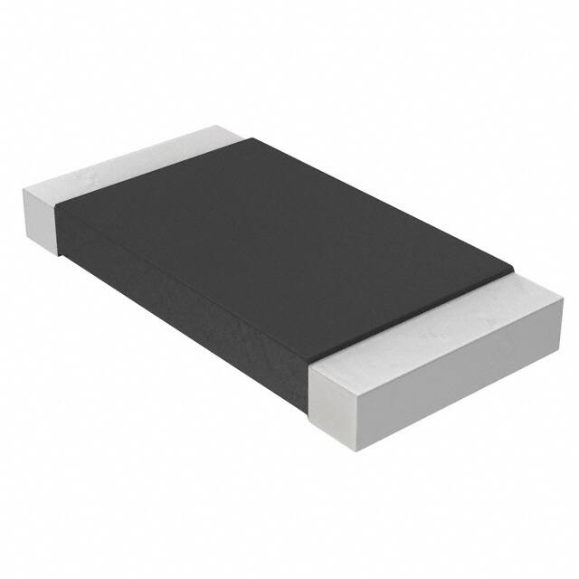

WSL www.vishay.com Vishay Dale Power Metal Strip® Resistors, Low Value (Down to 0.0005 Ω), Surface-Mount FEATURES • All welded construction of the Power Metal Strip® resistors are ideal for all types of current sensing, voltage division and pulse applications Available • Proprietary processing technique produces extremely low resistance values (down to 0.0005 Ω) • Sulfur resistance by construction that is Available unaffected by high sulfur environments • Very low inductance 0.5 nH to 5 nH Available • Low thermal EMF (< 3 μV/°C) • AEC-Q200 qualified (1) Available • Material categorization: for definitions of compliance please see www.vishay.com/doc?99912 LINKS TO ADDITIONAL RESOURCES 3D 3D 3D Models Design Tools Videos Notes * This datasheet provides information about parts that are RoHS-compliant and / or parts that are non-RoHS-compliant. For example, parts with lead (Pb) terminations are not RoHS-compliant. Please see the information / tables in this datasheet for details • Follow link to Overview of Automotive Grade Products for more details: www.vishay.com/doc?49924 (1) Flame retardance test may not be applicable to some resistor technologies STANDARD ELECTRICAL SPECIFICATIONS GLOBAL MODEL RESISTANCE VALUE RANGE Ω (2) POWER RATING P70 °C W SIZE TOL. ± 0.5 % WEIGHT (typical) g/1000 pieces TOL. ± 1.0 % WSL0603 0603 0.1 0.01 to 0.1 0.01 to 0.1 WSL0805 0805 0.125 0.005 to 0.2 0.005 to 0.2 WSL1206 1206 0.25 0.005 to 0.2 0.0005 to 0.2 WSL2010 2010 0.5 0.004 to 0.5 0.001 to 0.5 0.003 to 0.5 0.0005 to 0.5 WSL2512 2512 1.0 (1) WSL2816 2816 2.0 0.003 to 0.1 0.002 to 0.1 Notes • Part marking: value; tolerance: due to resistor size limitations some resistors will be marked with only the resistance value (1) For values above 0.1 Ω derate linearly to 80 % rated power at 0.5 Ω (2) WSL1206 0.0005 Ω to 0.00099 Ω is only available with 2 % tolerance (G tolerance code) 1.9 4.8 16.2 38.9 63.6 118 GLOBAL PART NUMBER INFORMATION Global Part Numbering Example: WSL25124L000FEA (visit www.vishay.net Vishay Dale parts numbering manual for all options) W S L 2 5 1 2 4 L 0 0 0 F E A GLOBAL MODEL (7 digits) RESISTANCE VALUE (1) (5 digits) TOLERANCE CODE (1 digit) PACKAGING CODE (2) (2 digits) SPECIAL (3) (up to 2 digits) WSL0603 WSL0805 WSL1206 WSL2010 WSL2512 WSL2816 L = mΩ* R = decimal 5L000 = 0.005 Ω R0100 = 0.01 Ω D = ± 0.5 % F = ± 1.0 % J = ± 5.0 % EA = lead (Pb)-free, tape / reel EH = lead (Pb)-free, tape / reel (WSL2816) (dash number) from 1 to 99 as applicable * Use “L” for resistance values < 0.01 Ω TA = tin / lead, tape / reel (R86) TG = tin / lead, tape / reel (RT1, for WSL0603 and WSL0805) TH = tin / lead, tape / reel (RJ9, WSL2816) BA = tin / lead, bulk (B43) Notes (1) WSL marking (www.vishay.com/doc?30327); WSL decade values (www.vishay.com/doc?30117) (2) Packaging code: EB (lead (Pb)-free) and TB (tin / lead) are non-standard packaging codes designating 1000 piece reels. These non-standard packaging codes are identical to our standard EA (lead (Pb)-free) and TA (tin / lead), except that they have a package quantity of 1000 pieces (3) Follow link for customization capabilities: www.vishay.com/doc?48163 Document Number: 30100 1 For technical questions, contact: ww2bresistors@vishay.com THIS DOCUMENT IS SUBJECT TO CHANGE WITHOUT NOTICE. THE PRODUCTS DESCRIBED HEREIN AND THIS DOCUMENT ARE SUBJECT TO SPECIFIC DISCLAIMERS, SET FORTH AT www.vishay.com/doc?91000 Revision: 24-Mar-2020 WSL www.vishay.com Vishay Dale TECHNICAL SPECIFICATIONS PARAMETER WSL RESISTOR CHARACTERISTICS WSL0603 (1) WSL0805 WSL1206 WSL2010 WSL2512 WSL2816 ± 75 for 50 mΩ to 100 mΩ ± 75 for 7 mΩ to 500 mΩ ± 110 for 10 mΩ to 49 mΩ ± 110 for 5 mΩ to 6.9 mΩ ± 150 for 3 mΩ to 4.9 mΩ ± 275 for 1 mΩ to 2.9 mΩ ± 400 for 0.5 mΩ to 0.99 mΩ < 20 -65 to +170 (P x R)1/2 UNIT Component temperature coefficient (including terminal) (2) TCR measured from -55 °C to +155 °C ppm/°C Element TCR (3) Operating temperature range Maximum working voltage (4) ppm/°C °C V Notes (1) Consult factory for detailed TCR performance across temperature range associated with PCN-DR-00003-2020 for WSL0603. TCR performance is improved for +25 °C to +155 °C (2) Component TCR - total TCR that includes the TCR effects of the resistor element and the copper terminal (3) Element TCR - only applies to the alloy used for the resistor element; refer to item 1 in the construction illustration on the following page (4) Maximum working voltage - the WSL is not voltage sensitive, but is limited by power / energy dissipation and is also not ESD sensitive DIMENSIONS in inches (millimeters) H l b W a T L Typical sensing traces Notes • 3D models available: www.vishay.com/doc?30306 • Surface mount solder profile recommendations: www.vishay.com/doc?31052 MODEL RESISTANCE RANGE (Ω) WSL0603 (1) 0.01 to 0.1 WSL0805 0.005 to 0.2 L 0.060 ± 0.010 (1.52 ± 0.254) 0.080 ± 0.010 (2.03 ± 0.254) DIMENSIONS W H 0.030 ± 0.010 0.016 ± 0.005 (0.76 ± 0.254) (0.406 ± 0.127) 0.050 ± 0.010 0.013 ± 0.005 (1.27 ± 0.254) (0.330 ± 0.127) 0.0005 to 0.00099 0.001 to 0.0019 WSL1206 0.002 to 0.0059 0.041 ± 0.010 (1.04 ± 0.254) 0.126 ± 0.010 (3.20 ± 0.254) 0.063 ± 0.010 (1.60 ± 0.254) 0.025 ± 0.010 (0.635 ± 0.254) 0.200 ± 0.010 (5.08 ± 0.254) 0.100 ± 0.010 (2.54 ± 0.254) 0.025 ± 0.010 (0.635 ± 0.254) 0.006 to 0.20 0.001 to 0.0069 WSL2010 0.007 to 0.5 0.0005 to 0.00099 0.001 to 0.0049 WSL2512 0.005 to 0.0069 0.250 ± 0.010 (6.35 ± 0.254) 0.125 ± 0.010 (3.18 ± 0.254) 0.025 ± 0.010 (0.635 ± 0.254) 0.280 ± 0.010 (7.1 ± 0.254) 0.165 ± 0.010 (4.2 ± 0.254) 0.025 ± 0.010 (0.635 ± 0.254) 0.007 to 0.5 0.002 to 0.00399 WSL2816 0.004 to 0.1 T 0.015 ± 0.010 (0.381 ± 0.254) 0.015 ± 0.010 (0.381 ± 0.254) 0.025 ± 0.010 (0.635 ± 0.254) 0.020 ± 0.010 (0.508 ± 0.254) 0.058 ± 0.010 (1.47 ± 0.254) 0.020 ± 0.010 (0.508 ± 0.254) 0.107 ± 0.010 (2.72 ± 0.254) 0.087 ± 0.010 (2.21 ± 0.254) 0.047 ± 0.010 (1.19 ± 0.254) 0.030 ± 0.010 (0.762 ± 0.254) 0.098 ± 0.010 (2.49 ± 0.254) 0.062 ± 0.010 (1.57 ± 0.254) SOLDER PAD DIMENSIONS a b l 0.040 0.040 0.020 (1.01) (1.01) (0.50) 0.040 0.050 0.020 (1.02) (1.27) (0.50) 0.089 0.076 0.023 (2.26) (1.93) (0.58) 0.086 0.076 0.029 (2.18) (1.93) (0.74) 0.070 0.076 0.061 (1.78) (1.93) (1.55) 0.065 0.076 0.071 (1.65) (1.93) (1.80) 0.093 0.120 0.055 (2.36) (3.05) (1.40) 0.055 0.120 0.130 (1.40) (3.05) (3.30) 0.120 (3.05) 0.083 (2.11) 0.065 (1.65) 0.135 (3.43) 0.096 (2.45) 0.050 (1.27) 0.145 (3.68) 0.185 (4.7) 0.125 (3.18) 0.160 (4.06) 0.060 (1.52) 0.125 (3.20) Note (1) PCN-DR-00003-2020 changed terminal height for WSL0603 from 0.013" ± 0.005" for clad construction to 0.016" ± 0.005" for welded construction Document Number: 30100 2 For technical questions, contact: ww2bresistors@vishay.com THIS DOCUMENT IS SUBJECT TO CHANGE WITHOUT NOTICE. THE PRODUCTS DESCRIBED HEREIN AND THIS DOCUMENT ARE SUBJECT TO SPECIFIC DISCLAIMERS, SET FORTH AT www.vishay.com/doc?91000 Revision: 24-Mar-2020 WSL www.vishay.com Vishay Dale Rated Power in % DERATING PULSE CAPABILITY 120 click to get started 100 80 60 40 US ILL 20 0 - 65 - 50 - 25 0 25 50 75 100 125 150 VE TI A TR ES OS P R PU LY ON 170 Ambient Temperature in °C 70 www.vishay.com/resistors/power-metal-strip-calculator WELDED CONSTRUCTION 2816, 2512, 2010, 1206, 0603 CLAD CONSTRUCTION 0805 1 Resistive element: solid metal nickel-chrome or manganese-copper alloy resistive element with low TCR (< 20 ppm/°C) 4 2 3 1 2 Plated terminal: solid copper, 100 % Sn (100 μ" min.) with 100 % Ni (20 μ" min.) under layer finish 3 Terminal / element weld 1 Resistive element: Ni-Cr 4 2 Terminal: solid copper, 100 % Sn (100 μ" min.) with 100 % Ni (20 μ" min.) under layer finish 3 Terminal to element weld 1 2 4 High temperature encapsulant: “siliconized polyester” coating material 3 4 Silicone coating with ink print PERFORMANCE TEST Thermal shock Short time overload Low temperature operation High temperature exposure Bias humidity Mechanical shock Vibration Load life Resistance to solder heat Moisture resistance PACKAGING CONDITIONS OF TEST TEST LIMITS -55 °C to +150 °C, 1000 cycles, 15 min at each extreme Refer to link for short time overload performance and pulse capability; www.vishay.com/resistors/power-metal-strip-calculator/ -65 °C for 24 h 1000 h at + 170 °C +85 °C, 85 % RH, 10 % bias, 1000 h 100 g’s for 6 ms, 5 pulses Frequency varied 10 Hz to 2000 Hz in 1 min, 3 directions, 12 h 1000 h at rated power, + 70 °C, 1.5 h “ON”, 0.5 h “OFF” +260 °C solder, 10 s to 12 s dwell, 25 mm/s emergence MIL-STD-202, method 106, 0 % power, 7a and 7b not required ± 0.5 % + 0.0005 Ω ± 0.5 % + 0.0005 Ω ± 0.5 % + 0.0005 Ω ± 1.0 % + 0.0005 Ω ± 0.5 % + 0.0005 Ω ± 0.5 % + 0.0005 Ω ± 0.5 % + 0.0005 Ω ± 1.0 % + 0.0005 Ω ± 0.5 % + 0.0005 Ω ± 0.5 % + 0.0005 Ω (1) MODEL WSL0603 WSL0805 WSL1206 WSL2010 WSL2512 WSL2816 REEL TAPE WIDTH DIAMETER PIECES/REEL CODE 8 mm / punched paper 8 mm / punched paper 8 mm / embossed plastic 12 mm / embossed plastic 12 mm / embossed plastic 12 mm / embossed plastic 178 mm / 7" 178 mm / 7" 178 mm / 7" 178 mm / 7" 178 mm / 7" 178 mm / 7" 5000 5000 4000 4000 2000 2000 EA EA EA EA EA EH Notes • Embossed carrier tape per EIA-481 (1) Additional packaging details at www.vishay.com/doc?20051 Document Number: 30100 3 For technical questions, contact: ww2bresistors@vishay.com THIS DOCUMENT IS SUBJECT TO CHANGE WITHOUT NOTICE. THE PRODUCTS DESCRIBED HEREIN AND THIS DOCUMENT ARE SUBJECT TO SPECIFIC DISCLAIMERS, SET FORTH AT www.vishay.com/doc?91000 Revision: 24-Mar-2020 Legal Disclaimer Notice www.vishay.com Vishay Disclaimer ALL PRODUCT, PRODUCT SPECIFICATIONS AND DATA ARE SUBJECT TO CHANGE WITHOUT NOTICE TO IMPROVE RELIABILITY, FUNCTION OR DESIGN OR OTHERWISE. Vishay Intertechnology, Inc., its affiliates, agents, and employees, and all persons acting on its or their behalf (collectively, “Vishay”), disclaim any and all liability for any errors, inaccuracies or incompleteness contained in any datasheet or in any other disclosure relating to any product. Vishay makes no warranty, representation or guarantee regarding the suitability of the products for any particular purpose or the continuing production of any product. To the maximum extent permitted by applicable law, Vishay disclaims (i) any and all liability arising out of the application or use of any product, (ii) any and all liability, including without limitation special, consequential or incidental damages, and (iii) any and all implied warranties, including warranties of fitness for particular purpose, non-infringement and merchantability. Statements regarding the suitability of products for certain types of applications are based on Vishay’s knowledge of typical requirements that are often placed on Vishay products in generic applications. Such statements are not binding statements about the suitability of products for a particular application. It is the customer’s responsibility to validate that a particular product with the properties described in the product specification is suitable for use in a particular application. Parameters provided in datasheets and / or specifications may vary in different applications and performance may vary over time. All operating parameters, including typical parameters, must be validated for each customer application by the customer’s technical experts. Product specifications do not expand or otherwise modify Vishay’s terms and conditions of purchase, including but not limited to the warranty expressed therein. Except as expressly indicated in writing, Vishay products are not designed for use in medical, life-saving, or life-sustaining applications or for any other application in which the failure of the Vishay product could result in personal injury or death. Customers using or selling Vishay products not expressly indicated for use in such applications do so at their own risk. Please contact authorized Vishay personnel to obtain written terms and conditions regarding products designed for such applications. No license, express or implied, by estoppel or otherwise, to any intellectual property rights is granted by this document or by any conduct of Vishay. Product names and markings noted herein may be trademarks of their respective owners. © 2019 VISHAY INTERTECHNOLOGY, INC. ALL RIGHTS RESERVED Revision: 01-Jan-2019 1 Document Number: 91000 Mouser Electronics Authorized Distributor Click to View Pricing, Inventory, Delivery & Lifecycle Information: Vishay: WSL2010R3320FBA WSL1206R0330FBA WSL1206R0100DTA WSL1206R0100FTB WSL1206R0500FBA WSL1206R0200FTB WSL1206R0400FBA WSL1206R0800FBA WSL1206R0600FBA WSL1206R0300FBA WSL1206R1500FBA WSL2010R4700FBA WSL2010R1200FBA WSL2010R1500FBA WSL2010R1800FBA WSL2010R2500FBA WSL2010R2200FBA WSL2010R2700FBA WSL2010R0500FBA WSL2010R0100FBA WSL2010R0300FBA WSL2010R0600FBA WSL2010R0200FBA WSL2010R2000FBA WSL2010R5000FBA WSL2010R1000FBA WSL2010R4000FBA WSL2010R3000FBA WSL0805R1800FBA WSL0805R1200FBA WSL12067L500FTB WSL2010R2000FEB WSL2512R0390FTA WSL2512R0240FTA WSL2512R0220FTA WSL2512R0330FBA WSL2512R0750FBA WSL2512R0160FTB WSL2512R0120FBA WSL2512R0270FTA WSL2512R0250FBA WSL25127L000FBA WSL25125L000FBA WSL25123L000FBA WSL25126L000FBA WSL2512R0560FTA WSL2512R0680FBA WSL2512R0620FBA WSL2010R0680FBA WSL1206R0400FEK WSL2010R0500DTA WSL2010R5000FTA WSL1206R0200DTB WSL0805R0250FTB WSL25127L500FBA WSL2512R3320FTB WSL2512R5110FTB WSL2512R1620FTB WSL2512R1210FTB WSL2512R1460FTB WSL2512R2320FTB WSL1206R2400FTB WSL1206R2500FTB WSL1206R1400FTB WSL1206R1300FTB WSL1206R1100FTB WSL2010R4990FTB WSL2512R0470FTB WSL2512R0430FTB WSL25129L000FTB WSL25122L000JTB WSL25128L000FTB WSL2512R0140FTB WSL2512R0510FTB WSL2512R0590FTB WSL2512R0370FTB WSL25125L000JTB WSL2010R0240FTB WSL2010R0220FTB WSL2010R0650FTB WSL2010R0620FTB WSL2010R0470FTB WSL20106L000FTB WSL2010R0160FTB WSL2010R0170FTB WSL2010R0520FTB WSL2512R4870FTB WSL2512R4020FTB WSL2512R4990FTB WSL2512R4530FTB WSL2512R2700FTB WSL2512R1800FTB WSL2512R1300FTB WSL0805R0100FTB WSL0805R0200FTB WSL0805R1500FTB WSL2010R0330FEB WSL1206R0650FTB WSL1206R0680FTB WSL1206-18 .002 1%TR

物料型号: 文档中列出了多种型号,例如WSL0603、WSL0805、WSL1206、WSL2010、WSL2512和WSL2816。
器件简介: Power Metal Strip® 电阻器,低值(低至0.0005 Ω),表面贴装。适用于电流检测、电压分配和脉冲应用。
引脚分配: 文档中没有明确提到具体的引脚分配,但提到了焊接结构和端子/元件焊接。
参数特性: - 组件温度系数(TCR):不同型号的TCR值不同,范围从75 ppm/°C到400 ppm/°C。 - 工作温度范围:-65°C 至 +170°C。 - 最大工作电压:由功率/能量耗散限制,不是ESD敏感。
功能详解: - 所有焊接构造,适用于各种电流检测、电压分配和脉冲应用。 - 专有加工技术生产极低电阻值(低至0.0005 Ω)。 - 对高硫环境无影响的硫电阻构造。 - 非常低的电感(0.5 nH至5 nH)。 - 低热EMF(<3 μV/°C)。
应用信息: 适用于汽车领域,并且有AEC-Q200认证。
封装信息: 提供了不同尺寸的封装信息,包括WSL0603、WSL0805、WSL1206、WSL2010、WSL2512和WSL2816的尺寸和焊盘尺寸。
