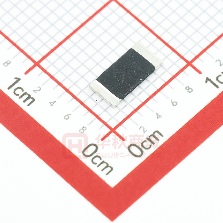

    贴片电阻 2512 15mΩ ±1% 1W ±75ppm/℃
WSL2512R0150FEA 数据手册
Upgrade for Higher Current to WSLP and for Zero Ohm Jumper to WSL-9 WSL www.vishay.com Vishay Dale Power Metal Strip® Resistors, Low Value (Down to 0.0005 Ω), Surface-Mount FEATURES • All welded construction of the Power Metal Strip® resistors are ideal for all types of current sensing, voltage division and pulse applications • Proprietary processing technique produces extremely low resistance values (down to 0.0005 Ω) • Sulfur resistance by construction that is unaffected by high sulfur environments • Very low inductance 0.5 nH to 5 nH • Low thermal EMF (< 3 μV/°C) • AEC-Q200 qualified (1) • Material categorization: for definitions of compliance please see www.vishay.com/doc?99912 LINKS TO ADDITIONAL RESOURCES 3D 3D 3D Models Design Tools Videos Available Available Available Available Notes * This datasheet provides information about parts that are RoHS-compliant and / or parts that are non-RoHS-compliant. For example, parts with lead (Pb) terminations are not RoHS-compliant. Please see the information / tables in this datasheet for details • Follow link to Overview of Automotive Grade Products for more details: www.vishay.com/doc?49924 • “SMD Current Sense: AEC-Q200 vs. Vishay Qualification” technical note: www.vishay.com/doc?30416 (1) Flame retardance test may not be applicable to some resistor technologies STANDARD ELECTRICAL SPECIFICATIONS RESISTANCE VALUE RANGE Ω (2) WEIGHT (typical) POWER RATING P70 °C GLOBAL SIZE MODEL g/1000 pieces W TOL. ± 0.5 % TOL. ± 1.0 % WSL0603 0603 0.1 0.01 to 0.1 0.01 to 0.1 1.9 WSL0805 0805 0.125 0.005 to 0.2 0.005 to 0.2 4.8 WSL1206 1206 0.25 0.005 to 0.2 0.0005 to 0.2 16.2 WSL2010 2010 0.5 0.004 to 0.5 0.001 to 0.5 38.9 WSL2512 2512 1.0 (1) 0.003 to 0.5 0.0005 to 0.5 63.6 WSL2816 2816 2.0 0.003 to 0.1 0.002 to 0.1 118 Notes • Part marking: value; tolerance: due to resistor size limitations some resistors will be marked with only the resistance value • “Thermal Management for Surface-Mount Devices” white paper: www.vishay.com/doc?30380 (1) For values above 0.1 Ω derate linearly to 80 % rated power at 0.5 Ω (2) WSL1206 0.0005 Ω to 0.00099 Ω is only available with 2 % tolerance (G tolerance code) GLOBAL PART NUMBER INFORMATION Global Part Numbering Example: WSL25124L000FEA (visit www.vishay.net Vishay Dale parts numbering manual for all options) W S L 2 5 1 2 4 L 0 0 0 F E A GLOBAL MODEL (7 digits) RESISTANCE VALUE (1) (5 digits) TOLERANCE CODE (1 digit) PACKAGING CODE (2) (2 digits) SPECIAL (3) (up to 2 digits) WSL0603 WSL0805 WSL1206 WSL2010 WSL2512 WSL2816 L = mΩ* R = decimal 5L000 = 0.005 Ω R0100 = 0.01 Ω D = ± 0.5 % F = ± 1.0 % J = ± 5.0 % EA = lead (Pb)-free, tape / reel EH = lead (Pb)-free, tape / reel (WSL2816) (dash number) from 1 to 99 as applicable * Use “L” for resistance values < 0.01 Ω TA = tin / lead, tape / reel (R86) TG = tin / lead, tape / reel (RT1, for WSL0603 and WSL0805) TH = tin / lead, tape / reel (RJ9, WSL2816) SB = tin / lead, tape / reel for DLA drawings Notes • Per PCN-DR-00009-2022-REV-0, WSL marking will be removed effective March 1st, 2023 (1) WSL marking (www.vishay.com/doc?30327); WSL decade values (www.vishay.com/doc?30117) (2) Packaging code: EB (lead (Pb)-free) and TB (tin / lead) are non-standard packaging codes designating 1000 piece reels. These non-standard packaging codes are identical to our standard EA (lead (Pb)-free) and TA (tin / lead), except that they have a package quantity of 1000 pieces (3) Follow link for customization capabilities: www.vishay.com/doc?48163 Document Number: 30100 1 For technical questions, contact: ww2bresistors@vishay.com THIS DOCUMENT IS SUBJECT TO CHANGE WITHOUT NOTICE. THE PRODUCTS DESCRIBED HEREIN AND THIS DOCUMENT ARE SUBJECT TO SPECIFIC DISCLAIMERS, SET FORTH AT www.vishay.com/doc?91000 Revision: 08-Aug-2022 Upgrade for Higher Current to WSLP and for Zero Ohm Jumper to WSL-9 WSL www.vishay.com Vishay Dale TECHNICAL SPECIFICATIONS PARAMETER WSL RESISTOR CHARACTERISTICS WSL0805 WSL1206 WSL2010 WSL2512 WSL2816 WSL0603 (1) ± 75 for 50 mΩ to 100 mΩ ± 75 for 7 mΩ to 500 mΩ ± 110 for 10 mΩ to 49 mΩ ± 110 for 5 mΩ to 6.9 mΩ ± 150 for 3 mΩ to 4.9 mΩ ± 275 for 1 mΩ to 2.9 mΩ ± 400 for 0.5 mΩ to 0.99 mΩ < 20 -65 to +170 (P x R)1/2 UNIT Component temperature coefficient (including terminal) (2) TCR measured from -55 °C to +155 °C ppm/°C Element TCR (3) Operating temperature range Maximum working voltage (4) ppm/°C °C V Notes • “Temperature Coefficient of Resistance for Current Sensing” white paper: www.vishay.com/doc?30405 (1) Consult factory for detailed TCR performance across temperature range associated with PCN-DR-00003-2020 for WSL0603. TCR performance is improved for +25 °C to +155 °C (2) Component TCR - total TCR that includes the TCR effects of the resistor element and the copper terminal (3) Element TCR - only applies to the alloy used for the resistor element; refer to item 1 in the construction illustration on the following page (4) Maximum working voltage - the WSL is not voltage sensitive, but is limited by power / energy dissipation and is also not ESD sensitive DIMENSIONS in inches (millimeters) H l b W a T L Typical sensing traces Notes • 3D models available: www.vishay.com/doc?30306 • Surface mount solder profile recommendations: www.vishay.com/doc?31052 MODEL RESISTANCE RANGE (Ω) WSL0603 (1) 0.01 to 0.1 WSL0805 (2) 0.005 to 0.2 L 0.060 ± 0.010 (1.52 ± 0.254) 0.080 ± 0.010 (2.03 ± 0.254) DIMENSIONS W H 0.030 ± 0.010 0.016 ± 0.005 (0.76 ± 0.254) (0.406 ± 0.127) 0.016 ± 0.005 0.050 ± 0.010 (1.27 ± 0.254) (0.406 ± 0.127) 0.0005 to 0.00099 0.001 to 0.0019 WSL1206 0.002 to 0.0059 0.041 ± 0.010 (1.04 ± 0.254) 0.126 ± 0.010 (3.20 ± 0.254) 0.063 ± 0.010 (1.60 ± 0.254) 0.025 ± 0.010 (0.635 ± 0.254) 0.200 ± 0.010 (5.08 ± 0.254) 0.100 ± 0.010 (2.54 ± 0.254) 0.025 ± 0.010 (0.635 ± 0.254) 0.006 to 0.20 0.001 to 0.0069 WSL2010 0.007 to 0.5 0.0005 to 0.00099 0.001 to 0.0049 WSL2512 0.005 to 0.0069 0.250 ± 0.010 (6.35 ± 0.254) 0.125 ± 0.010 (3.18 ± 0.254) 0.025 ± 0.010 (0.635 ± 0.254) 0.280 ± 0.010 (7.1 ± 0.254) 0.165 ± 0.010 (4.2 ± 0.254) 0.025 ± 0.010 (0.635 ± 0.254) 0.007 to 0.5 0.002 to 0.00399 WSL2816 0.004 to 0.1 T 0.015 ± 0.010 (0.381 ± 0.254) 0.015 ± 0.010 (0.381 ± 0.254) 0.025 ± 0.010 (0.635 ± 0.254) 0.020 ± 0.010 (0.508 ± 0.254) 0.058 ± 0.010 (1.47 ± 0.254) 0.020 ± 0.010 (0.508 ± 0.254) 0.107 ± 0.010 (2.72 ± 0.254) 0.087 ± 0.010 (2.21 ± 0.254) 0.047 ± 0.010 (1.19 ± 0.254) 0.030 ± 0.010 (0.762 ± 0.254) 0.098 ± 0.010 (2.49 ± 0.254) 0.062 ± 0.010 (1.57 ± 0.254) SOLDER PAD DIMENSIONS a b l 0.040 0.040 0.020 (1.01) (1.01) (0.50) 0.040 0.050 0.020 (1.02) (1.27) (0.50) 0.089 0.076 0.023 (2.26) (1.93) (0.58) 0.086 0.076 0.029 (2.18) (1.93) (0.74) 0.070 0.076 0.061 (1.78) (1.93) (1.55) 0.065 0.076 0.071 (1.65) (1.93) (1.80) 0.093 0.120 0.055 (2.36) (3.05) (1.40) 0.055 0.120 0.130 (1.40) (3.05) (3.30) 0.120 (3.05) 0.083 (2.11) 0.065 (1.65) 0.135 (3.43) 0.096 (2.45) 0.050 (1.27) 0.145 (3.68) 0.185 (4.7) 0.125 (3.18) 0.160 (4.06) 0.060 (1.52) 0.125 (3.20) Notes (1) PCN-DR-00003-2020 changed terminal height for WSL0603 from 0.013" ± 0.005" for clad construction to 0.016" ± 0.005" for welded construction (2) PCN-DR-00021-2021-REV-1 changed terminal height for WSLP0805 from 0.013" ± 0.005" for clad construction to 0.016" ± 0.005" for welded construction Document Number: 30100 2 For technical questions, contact: ww2bresistors@vishay.com THIS DOCUMENT IS SUBJECT TO CHANGE WITHOUT NOTICE. THE PRODUCTS DESCRIBED HEREIN AND THIS DOCUMENT ARE SUBJECT TO SPECIFIC DISCLAIMERS, SET FORTH AT www.vishay.com/doc?91000 Revision: 08-Aug-2022 Upgrade for Higher Current to WSLP and for Zero Ohm Jumper to WSL-9 WSL www.vishay.com Vishay Dale Rated Power in % DERATING PULSE CAPABILITY 120 click to get started 100 80 60 40 US ILL 20 0 - 65 - 50 - 25 0 25 50 75 100 125 150 VE TI A TR ES OS P R PU LY ON 170 Ambient Temperature in °C 70 www.vishay.com/resistors/power-metal-strip-calculator WELDED CONSTRUCTION 1 Resistive element: solid metal nickel-chrome or manganese-copper alloy resistive element with low TCR (< 20 ppm/°C) 2 Plated terminal: solid copper, 100 % Sn (100 μ" min.) with 100 % Ni (20 μ" min.) under layer finish 4 2 3 1 3 Terminal / element weld 4 Silicone coating with ink print PERFORMANCE TEST CONDITIONS OF TEST TEST LIMITS Thermal shock -55 °C to +150 °C, 1000 cycles, 15 min at each extreme ± (0.5 % + 0.0005 Ω) )Short time overload Refer to link for short time overload performance and pulse capability; www.vishay.com/resistors/power-metal-strip-calculator/ ± (0.5 % + 0.0005 Ω) Low temperature operation -65 °C for 24 h ± (0.5 % + 0.0005 Ω) High temperature exposure 1000 h at + 170 °C ± (1.0 % + 0.0005 Ω) Bias humidity +85 °C, 85 % RH, 10 % bias, 1000 h ± (0.5 % + 0.0005 Ω) Mechanical shock 100 g’s for 6 ms, 5 pulses ± (0.5 % + 0.0005 Ω) Vibration Frequency varied 10 Hz to 2000 Hz in 1 min, 3 directions, 12 h ± (0.5 % + 0.0005 Ω) Load life 1000 h at rated power, + 70 °C, 1.5 h “ON”, 0.5 h “OFF” ± (1.0 % + 0.0005 Ω) Resistance to solder heat +260 °C solder, 10 s to 12 s dwell, 25 mm/s emergence ± (0.5 % + 0.0005 Ω) Moisture resistance MIL-STD-202, method 106, 0 % power, 7a and 7b not required ± (0.5 % + 0.0005 Ω) PACKAGING (1) MODEL REEL TAPE WIDTH DIAMETER PIECES/REEL CODE WSL0603 8 mm / punched paper 178 mm / 7" 5000 EA WSL0805 8 mm / punched paper 178 mm / 7" 5000 EA WSL1206 8 mm / embossed plastic 178 mm / 7" 4000 EA WSL2010 12 mm / embossed plastic 178 mm / 7" 4000 EA WSL2512 12 mm / embossed plastic 178 mm / 7" 2000 EA WSL2816 12 mm / embossed plastic 178 mm / 7" 2000 EH Notes • Embossed carrier tape per EIA-481 (1) Additional packaging details at www.vishay.com/doc?20051 Document Number: 30100 3 For technical questions, contact: ww2bresistors@vishay.com THIS DOCUMENT IS SUBJECT TO CHANGE WITHOUT NOTICE. THE PRODUCTS DESCRIBED HEREIN AND THIS DOCUMENT ARE SUBJECT TO SPECIFIC DISCLAIMERS, SET FORTH AT www.vishay.com/doc?91000 Revision: 08-Aug-2022 Legal Disclaimer Notice www.vishay.com Vishay Disclaimer ALL PRODUCT, PRODUCT SPECIFICATIONS AND DATA ARE SUBJECT TO CHANGE WITHOUT NOTICE TO IMPROVE RELIABILITY, FUNCTION OR DESIGN OR OTHERWISE. Vishay Intertechnology, Inc., its affiliates, agents, and employees, and all persons acting on its or their behalf (collectively, “Vishay”), disclaim any and all liability for any errors, inaccuracies or incompleteness contained in any datasheet or in any other disclosure relating to any product. Vishay makes no warranty, representation or guarantee regarding the suitability of the products for any particular purpose or the continuing production of any product. To the maximum extent permitted by applicable law, Vishay disclaims (i) any and all liability arising out of the application or use of any product, (ii) any and all liability, including without limitation special, consequential or incidental damages, and (iii) any and all implied warranties, including warranties of fitness for particular purpose, non-infringement and merchantability. Statements regarding the suitability of products for certain types of applications are based on Vishay's knowledge of typical requirements that are often placed on Vishay products in generic applications. Such statements are not binding statements about the suitability of products for a particular application. It is the customer's responsibility to validate that a particular product with the properties described in the product specification is suitable for use in a particular application. Parameters provided in datasheets and / or specifications may vary in different applications and performance may vary over time. All operating parameters, including typical parameters, must be validated for each customer application by the customer's technical experts. Product specifications do not expand or otherwise modify Vishay's terms and conditions of purchase, including but not limited to the warranty expressed therein. Hyperlinks included in this datasheet may direct users to third-party websites. These links are provided as a convenience and for informational purposes only. Inclusion of these hyperlinks does not constitute an endorsement or an approval by Vishay of any of the products, services or opinions of the corporation, organization or individual associated with the third-party website. Vishay disclaims any and all liability and bears no responsibility for the accuracy, legality or content of the third-party website or for that of subsequent links. Except as expressly indicated in writing, Vishay products are not designed for use in medical, life-saving, or life-sustaining applications or for any other application in which the failure of the Vishay product could result in personal injury or death. Customers using or selling Vishay products not expressly indicated for use in such applications do so at their own risk. Please contact authorized Vishay personnel to obtain written terms and conditions regarding products designed for such applications. No license, express or implied, by estoppel or otherwise, to any intellectual property rights is granted by this document or by any conduct of Vishay. Product names and markings noted herein may be trademarks of their respective owners. © 2022 VISHAY INTERTECHNOLOGY, INC. ALL RIGHTS RESERVED Revision: 01-Jan-2022 1 Document Number: 91000
WSL2512R0150FEA
1. 物料型号:WSL系列,包括WSL0603、WSL0805、WSL1206、WSL2010、WSL2512和WSL2816等型号。 2. 器件简介:这些电阻器采用全焊接结构,非常适合用于电流检测、电压分割和脉冲应用。 3. 引脚分配:文档中没有明确说明引脚分配,但提到了焊接结构和端子的详细信息。 4. 参数特性: - 电阻值范围从0.0005 Ω至0.5 Ω。 - 公差±0.5%至±5%。 - 非常低的电感值(0.5 nH至5 nH)。 - 低热电势(小于3 μV/°C)。 - 符合AEC-Q200标准。 5. 功能详解:这些电阻器具有极低的电阻值,适用于高电流环境,并且对高硫环境具有抵抗力。 6. 应用信息:适用于汽车行业,并且有符合RoHS标准的选项。 7. 封装信息:提供了不同尺寸的封装信息,包括0603、0805、1206、2010、2512和2816等。
