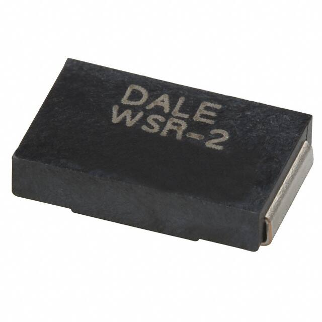

WSR www.vishay.com Vishay Dale Power Metal Strip® Resistors, Low Value (down to 0.001 ), Surface Mount FEATURES • Molded high temperature encapsulation • All welded construction of the Power Metal Strip® resistors are ideal for all types of current sensing, voltage division and pulse applications • Proprietary processing technique produces extremely low resistance values (down to 0.001 ) Available Available • Sulfur resistance by construction that is unaffected by high sulfur environments DESIGN SUPPORT TOOLS Models Available • Solid metal nickel-chrome or manganesecopper alloy resistive element with low TCR (< 20 ppm/°C) click logo to get started Design Tools Available Available • Very low inductance 0.5 nH to 5 nH Available • Excellent frequency response to 50 MHz • Low thermal EMF (< 3 μV/°C) • AEC-Q200 qualified (1) • Material categorization: for definitions of compliance please see www.vishay.com/doc?99912 Notes • This datasheet provides information about parts that are RoHS-compliant and / or parts that are non-RoHS-compliant. For example, parts with lead (Pb) terminations are not RoHS-compliant. Please see the information / tables in this datasheet for details • Follow link to Overview of Automotive Grade Products for more details: www.vishay.com/doc?49924 (1) Flame retardance test may not be applicable to some resistor technologies STANDARD ELECTRICAL SPECIFICATIONS RESISTANCE VALUE RANGE  GLOBAL MODEL SIZE POWER RATING P70 °C W Tol. ± 0.5 % Tol. ± 1.0 % WEIGHT (typical) g/1000 pieces WSR2 4527 2.0 0.005 to 1.0 0.001 to 1.0 440 WSR3 4527 3.0 (1) 0.005 to 0.2 0.001 to 0.2 440 Notes • Part marking: DALE, model, value, tolerance, date code (1) The WSR3 requires a minimum of 1050 sq. mil. circuit traces connecting to the recommended solder pad GLOBAL PART NUMBER INFORMATION Global Part Numbering example: WSR25L000FEA (visit www.vishay.net Vishay Dale parts numbering manual for all options) W S R 2 5 L 0 0 0 F E A GLOBAL MODEL RESISTANCE VALUE (1) TOLERANCE CODE PACKAGING CODE (2) SPECIAL (3) WSR2 WSR3 L = m* R = decimal 5L000 = 0.005  R0100 = 0.01  * Use “L” for resistance values < 0.01  D = ± 0.5 % F = ± 1.0 % J = ± 5.0 % EA = lead (Pb)-free, tape/reel EK = lead (Pb)-free, bulk (dash number) (up to 2 digits) from 1 to 99 as applicable TA = tin/lead, tape/reel (R86) BA = tin/lead, bulk (B43) Notes (1) WSR Marking (www.vishay.com/doc?30327) (2) Packaging code: EB (lead (Pb)-free) and TB (tin / lead) are non-standard packaging codes designating 1000 piece reels. These non-standard packaging codes are identical to our standard EA (lead (Pb)-free) and TA (tin / lead), except that they have a package quantity of 1000 pieces (3) Follow link for customization capabilities: www.vishay.com/doc?48163 Revision: 09-Jan-2019 Document Number: 30101 1 For technical questions, contact: ww2bresistors@vishay.com THIS DOCUMENT IS SUBJECT TO CHANGE WITHOUT NOTICE. THE PRODUCTS DESCRIBED HEREIN AND THIS DOCUMENT ARE SUBJECT TO SPECIFIC DISCLAIMERS, SET FORTH AT www.vishay.com/doc?91000 WSR www.vishay.com Vishay Dale TECHNICAL SPECIFICATIONS PARAMETER UNIT WSR2 AND WSR3 RESISTOR CHARACTERISTICS ± 75 for 0.010  to 1.0  ± 110 for 0.005  to 0.0099  Temperature coefficient TCR measured from -55 °C to 150 °C ± 300 for 0.004  to 0.0049  ppm/°C ± 450 for 0.003  to 0.0039  ± 600 for 0.002  to 0.0029  ± 750 for 0.001  to 0.0019  Element TCR ppm/°C < 20 VAC > 500 Insulation resistance  > 109 Operating temperature range °C -65 to +275 Maximum working voltage V (P x R)1/2 Dielectric withstanding voltage DIMENSIONS in inches (millimeters) H W I W1 T b a L Notes • 3D models available: www.vishay.com/doc?30336 • Surface mount solder profile recommendations: www.vishay.com/doc?31052 DIMENSIONS SOLDER PAD DIMENSIONS MODEL WSR2,  WSR3 L H T W W1 a b l 0.455 ± 0.032 (11.56 ± 0.813) 0.095 ± 0.005 (2.41 ± 0.127) 0.100 ± 0.010 (2.54 ± 0.254) 0.275 ± 0.005 (6.98 ± 0.127) 0.215 ± 0.005 (5.46 ± 0.127) 0.155 (3.94) 0.230 (5.84) 0.205 (5.21) Note • Sensing locations are based on the construction of the part; terminals are wrapped from the outside to underneath. These options place the sensing location nearest the temperature stable resistance element, which minimizes contact resistance and optimizes TCR TYPICAL SENSING LAYOUT a a c b l c a b c l 0.155 (3.94) 0.230 (5.84) 0.020 (0.51) 0.205 (5.21) Revision: 09-Jan-2019 Document Number: 30101 2 For technical questions, contact: ww2bresistors@vishay.com THIS DOCUMENT IS SUBJECT TO CHANGE WITHOUT NOTICE. THE PRODUCTS DESCRIBED HEREIN AND THIS DOCUMENT ARE SUBJECT TO SPECIFIC DISCLAIMERS, SET FORTH AT www.vishay.com/doc?91000 WSR www.vishay.com Vishay Dale Rated Power in % DERATING PULSE CAPABILITY 120 100 click to get started 80 60 40 US ILL 20 0 - 65 - 25 25 75 70 125 175 225 E IV AT R T ES OS P R PU LY ON 275 Ambient Temperature °C www.vishay.com/resistors/power-metal-strip-calculator PERFORMANCE TEST LIMITS TEST CONDITIONS OF TEST WSR2 WSR3 Thermal shock -55 °C to +150 °C, 1000 cycles, 15 min at each extreme ± 0.5 % + 0.0005  ± 0.5 % + 0.0005  Short time overload WSR2: 5x rated power for 5 s WSR3: 4x rated power for 5 s ± 0.5 % + 0.0005  ± 2.0 % + 0.0005  Low temperature storage -65 °C for 24 h ± 0.5 % + 0.0005  ± 0.5 % + 0.0005  High temperature exposure 1000 h at +275 °C ± 1.0 % + 0.0005  ± 1.0 % + 0.0005  Bias humidity +85 °C, 85 % RH, 10 % bias, 1000 h ± 0.5 % + 0.0005  ± 0.5 % + 0.0005  Mechanical shock 100 g’s for 6 ms, 5 pulses ± 0.5 % + 0.0005  ± 0.5 % + 0.0005  Vibration Frequency varied 10 Hz to 2000 Hz in 1 min, 3 directions, 12 h ± 0.5 % + 0.0005  ± 0.5 % + 0.0005  Load life 1000 h at rated power, +70 °C, 1.5 h “ON”, 0.5 h “OFF” ± 1.0 % + 0.0005  ± 2.0 % + 0.0005  Resistance to solder heat +260 °C solder, 10 s to 12 s dwell, 25 mm/s emergence ± 0.5 % + 0.0005  ± 0.5 % + 0.0005  Moisture resistance MIL-STD-202, method 106, 0 % power, 7a and 7b not required ± 0.5 % + 0.0005  ± 0.5 % + 0.0005  PACKAGING (1) REEL MODEL WSR2 and WSR3 TAPE WIDTH DIAMETER PIECES/REEL CODE 24 mm/embossed plastic 330 mm/13" 1500 EA Notes • Embossed Carrier Tape per EIA-481 (1) Additional packaging details at www.vishay.com/doc?20051 Revision: 09-Jan-2019 Document Number: 30101 3 For technical questions, contact: ww2bresistors@vishay.com THIS DOCUMENT IS SUBJECT TO CHANGE WITHOUT NOTICE. THE PRODUCTS DESCRIBED HEREIN AND THIS DOCUMENT ARE SUBJECT TO SPECIFIC DISCLAIMERS, SET FORTH AT www.vishay.com/doc?91000 Legal Disclaimer Notice www.vishay.com Vishay Disclaimer ALL PRODUCT, PRODUCT SPECIFICATIONS AND DATA ARE SUBJECT TO CHANGE WITHOUT NOTICE TO IMPROVE RELIABILITY, FUNCTION OR DESIGN OR OTHERWISE. Vishay Intertechnology, Inc., its affiliates, agents, and employees, and all persons acting on its or their behalf (collectively, “Vishay”), disclaim any and all liability for any errors, inaccuracies or incompleteness contained in any datasheet or in any other disclosure relating to any product. Vishay makes no warranty, representation or guarantee regarding the suitability of the products for any particular purpose or the continuing production of any product. To the maximum extent permitted by applicable law, Vishay disclaims (i) any and all liability arising out of the application or use of any product, (ii) any and all liability, including without limitation special, consequential or incidental damages, and (iii) any and all implied warranties, including warranties of fitness for particular purpose, non-infringement and merchantability. Statements regarding the suitability of products for certain types of applications are based on Vishay's knowledge of typical requirements that are often placed on Vishay products in generic applications. Such statements are not binding statements about the suitability of products for a particular application. It is the customer's responsibility to validate that a particular product with the properties described in the product specification is suitable for use in a particular application. Parameters provided in datasheets and / or specifications may vary in different applications and performance may vary over time. All operating parameters, including typical parameters, must be validated for each customer application by the customer's technical experts. Product specifications do not expand or otherwise modify Vishay's terms and conditions of purchase, including but not limited to the warranty expressed therein. Hyperlinks included in this datasheet may direct users to third-party websites. These links are provided as a convenience and for informational purposes only. Inclusion of these hyperlinks does not constitute an endorsement or an approval by Vishay of any of the products, services or opinions of the corporation, organization or individual associated with the third-party website. Vishay disclaims any and all liability and bears no responsibility for the accuracy, legality or content of the third-party website or for that of subsequent links. Except as expressly indicated in writing, Vishay products are not designed for use in medical, life-saving, or life-sustaining applications or for any other application in which the failure of the Vishay product could result in personal injury or death. Customers using or selling Vishay products not expressly indicated for use in such applications do so at their own risk. Please contact authorized Vishay personnel to obtain written terms and conditions regarding products designed for such applications. No license, express or implied, by estoppel or otherwise, to any intellectual property rights is granted by this document or by any conduct of Vishay. Product names and markings noted herein may be trademarks of their respective owners. © 2021 VISHAY INTERTECHNOLOGY, INC. ALL RIGHTS RESERVED Revision: 09-Jul-2021 1 Document Number: 91000

物料型号:WSR2 和 WSR3
器件简介: - 这些电阻器适用于汽车应用,具有高温封装和全焊接结构,非常适合电流检测、电压分割和脉冲应用。 - 采用专有工艺技术生产极低电阻值(低至0.001Ω)。 - 具有低温度系数(TCR < 20 ppm/°C)的实心金属镍铬或锰铜合金电阻元件。 - 非常低的电感(0.5 nH 至 5 nH),出色的频率响应至50 MHz,低热电势(< 3 μV/°C)。 - 符合AEC-Q200标准。
引脚分配:文档中没有提供具体的引脚分配图,但提到了WSR3需要至少1050平方密耳的电路板连接到推荐的焊盘。
参数特性: - 温度系数(TCR):根据电阻值不同,TCR值在75 ppm/°C 至 750 ppm/°C 之间。 - 元件TCR:小于20 ppm/°C。 - 介质耐压:大于500 VAC。 - 绝缘电阻:大于10^9 Ω。 - 工作温度范围:-65°C 至 +275°C。 - 最大工作电压:(PxR)^1/2 V。
功能详解: - 电阻器设计用于高温环境,具有优异的热冲击、短时过载、低温存储、高温暴露、偏置湿度、机械冲击、振动、负载寿命和耐焊热性能。
应用信息: - 适用于电流检测、电压分割和脉冲应用。
封装信息: - WSR2 和 WSR3 的尺寸数据和焊盘尺寸在文档中有详细说明。 - 包装信息:24 mm/压纹塑料卷带,330 mm/13"直径,每卷1500件。
注意: - 文档最后包含了免责声明,强调所有产品规格和数据如有更改,恕不另行通知,以提高可靠性、功能或设计等。 - Vishay不保证产品的适用性,客户有责任验证产品规格是否适合特定应用。
