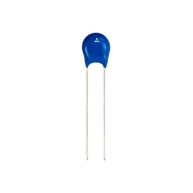

WYO Series www.vishay.com Vishay Roederstein EMI Suppression Capacitor, Ceramic Disc, Class X1, 440 VAC, Class Y2, 250 VAC FEATURES • Complying with IEC 60384-14 • High reliability • Wide range of capacitance values • Wide range of different leadstyles • Singlelayer AC disc safety capacitors • Material categorization: for definitions of compliance please see www.vishay.com/doc?99912 APPLICATIONS • X1, Y2 according to IEC 60384-14 LINKS TO ADDITIONAL RESOURCES • Line-to-line filtering (Class X) 3D 3D • Line-to-ground filtering (Class Y) • EMI / RFI suppression and filtering 3D Models • Primary and secondary coupling (SMPS) QUICK REFERENCE DATA DESCRIPTION VALUE Ceramic Class 2 Ceramic Dielectric DESIGN Y5U Voltage (VAC) 440 250 Min. Capacitance (pF) 1000 Max. Capacitance (pF) 12 000 Mounting Radial OPERATING TEMPERATURE RANGE -40 °C to +125 °C (1) Note (1) For explanation about the difference of operating temperature range and temperature characteristic of capacitance please see www.vishay.com/doc?48299 TEMPERATURE CHARACTERISTICS Class 2 Y5U SECTIONAL SPECIFICATIONS Climatic category (according to EN 60058-1) Class 2 40 / 125 / 21 The capacitors consist of ceramic disc both sides of which are silver plated. Connection leads are made of tinned copper having diameters of 0.6 mm. The capacitors may be supplied with straight or kinked leads having a lead spacing of 5.0 mm or 7.5 mm. Coating is made of blue colored flame retardant epoxy resin in accordance with UL 94 V-0. CAPACITANCE RANGE 1.0 nF to 12 nF TOLERANCE ON CAPACITANCE ± 20 % RATED VOLTAGE • X1: 440 VAC, 50 Hz (IEC 60384-14) 440 VAC, 50 Hz / 60 Hz (US/UL/CSA 60384-14) • Y2: 250 VAC, 50 Hz (IEC 60384-14) 250 VAC, 50 Hz / 60 Hz (US/UL/CSA 60384-14) TEST VOLTAGE • 2500 VAC, 50 Hz, 2 s Component test (100 %) IEC 60384-14 • 1500 VAC, 50 Hz, 60 s Random sampling test (destructive) UL 60384-14 • 2000 VAC, 60 Hz, 60 s Voltage proof of coating (destructive) DIN EN 60384-14 INSULATION RESISTANCE AT 500 VDC CSA E60384-14 ≥ 6000 MΩ (60 s) APPROVALS DISSIPATION FACTOR Class 2: max. 2.5 % (1 kHz) Revision: 10-Sep-2021 Document Number: 22202 1 For technical questions, contact: slcap@vishay.com THIS DOCUMENT IS SUBJECT TO CHANGE WITHOUT NOTICE. THE PRODUCTS DESCRIBED HEREIN AND THIS DOCUMENT ARE SUBJECT TO SPECIFIC DISCLAIMERS, SET FORTH AT www.vishay.com/doc?91000 WYO Series www.vishay.com Vishay Roederstein DIMENSIONS in millimeters Thickness 3.0 max. Diameter Lead length Width ad Le cing a sp Lead diameter TECHNICAL DATA CAPACITANCE C (pF) CAPACITANCE TOLERANCE BODY DIAMETER DMAX. (mm) ± 20 % 6.5 8.0 8.0 9.0 9.0 11.0 12.5 12.5 17.0 17.0 21.0 21.0 Y5U (2E3) 1000 1500 1800 2200 2500 3300 4700 5000 6800 8200 10 000 12 000 BODY THICKNESS SMAX. (mm) LEAD SPACING (1) F (mm) ± 1 mm LEAD DIAMETER (1) d (mm) ± 0.05 mm WYO102#CM###KR WYO152#CM###KR WYO182#CM###KR WYO222#CM###KR WYO252#CM###KR WYO332#CM###KR WYO472#CM###KR WYO502#CM###KR WYO682#CM###KR WYO822#CM###KR WYO103#CM###KR WYO123#CM###KR 5.0 1.4 4.5 PART NUMBER MISSING DIGITS SEE ORDERING CODE BELOW WIDTH (1) V (mm) ± 0.5 mm 0.6 7.5 1.6 Note (1) Standard lead configuration, other lead spacing and diameter available on request ORDERING CODE # 7th digit ### 10th Example to 12th digit Capacitance tolerance ± 10 % = K, ± 20 % = M Lead configuration See “General Information” www.vishay.com/doc?22001 WYO 103 Series Capacitance value M Tolerance code STANDARD EXAMPLE FOR MARKING 440~X1 WYO 2n2 M 250~Y2 WYO 1.0 nF to 2.5 nF Revision: 10-Sep-2021 CM CF0 Voltage code Lead configuration K R Internal code RoHS compliant STANDARD EXAMPLE FOR LABEL PRINTING WYO 4n7 M IEC 384-14 440 250 250~ X1 Y2 WYO 3.3 nF to 12 nF Document Number: 22202 2 For technical questions, contact: slcap@vishay.com THIS DOCUMENT IS SUBJECT TO CHANGE WITHOUT NOTICE. THE PRODUCTS DESCRIBED HEREIN AND THIS DOCUMENT ARE SUBJECT TO SPECIFIC DISCLAIMERS, SET FORTH AT www.vishay.com/doc?91000 WYO Series www.vishay.com Vishay Roederstein APPROVALS IEC 60384-14 - Safety tests This approval together with CB test certificate substitutes all national approvals. CB Certificate (www.vishay.com/doc?22225) Y2-capacitor: CB test certificate: US-26154-UL 1 nF to 12 nF 250 VAC X1-capacitor: CB test certificate: US-26154-UL 1 nF to 12 nF 440 VAC Y2-capacitor: VDE marks approval: 133769 1 nF to 12 nF 250 VAC X1-capacitor: VDE marks approval: 133769 1 nF to 12 nF 440 VAC Minimum thickness of insulation: 0.4 mm VDE (www.vishay.com/doc?22227) DIN EN 60384-14 (VDE 0565-1-1) Minimum thickness of insulation: 0.4 mm Underwriters Laboratories Inc. / Canadian Standards Association (www.vishay.com/doc?22226) Y2-capacitor: UL-test certificate: E183844 1 nF to 12 nF 250 VAC X1-capacitor: UL-test certificate: E183844 1 nF to 12 nF 440 VAC UL 60384-14, CSA E60384-14 Minimum thickness of insulation: 0.4 mm IMPEDANCE VS. FREQUENCY (typical) 4000 Z (Ω) I (μA) AC CURRENT VS. VOLTAGE (typical) 8.2 nF 100 3000 10 4.7 nF 2000 1 12 nF 0.1 1 nF 0 0.01 0 500 1000 1500 2000 2500 0.1 1 10 UR (V~) 1 nF 2.2 nF 5 nF 2.5 nF 3.3 nF 1000 100 f (MHz) STORAGE The capacitors must not be stored in a corrosive atmosphere, where sulphide or chloride gas, acid, alkali or salt are present. Exposure of the components to moisture, should be avoided. The solderability of the leads is not affected by storage of up to 24 months (temperature +10 °C to +35 °C, relative humidity up to 60 %). Class 2 ceramic dielectric capacitors are also subject to aging, see www.vishay.com/doc?22001. SOLDERING SOLDERING SPECIFICATIONS Soldering test for capacitors with wire leads: (according to IEC 60068-2-20, solder bath method) Soldering temperature Soldering duration Distance from component body Revision: 10-Sep-2021 SOLDERABILITY RESISTANCE TO SOLDERING HEAT 235 °C ± 5 °C 260 °C ± 5 °C 2 s ± 0.5 s 10 s ± 1 s ≥ 2 mm ≥ 5 mm Document Number: 22202 3 For technical questions, contact: slcap@vishay.com THIS DOCUMENT IS SUBJECT TO CHANGE WITHOUT NOTICE. THE PRODUCTS DESCRIBED HEREIN AND THIS DOCUMENT ARE SUBJECT TO SPECIFIC DISCLAIMERS, SET FORTH AT www.vishay.com/doc?91000 WYO Series www.vishay.com Vishay Roederstein SOLDERING RECOMMENDATIONS Soldering of the component should be achieved using a Sn60/40 type or a silver-bearing Sn62/36/2Ag type solder. Ceramic capacitors are very sensitive to rapid changes in temperature (thermal shock) therefore the solder heat resistance specification (see Soldering Specifications table) should not be exceeded. Subjecting the capacitor to excessive heating may result in thermal shocks that can crack the ceramic body. Similarly, excessive heating can cause the internal solder junction to melt. CLEANING The components should be cleaned immediately following the soldering operation with vapor degreasers. SOLVENT RESISTANCE The coating and marking of the capacitors are resistant to the following test method: IEC 60068-2-45 (method XA). MOUNTING If a defined product stop is required for mounting on a PCB, a mechanically formed product stop (kinked or inline wire) or a mounting tool should be used. We do not recommend modifying the lead terminals, e.g. bending or cropping. This action could break the coating or crack the ceramic insert. If however, the lead must be modified in any way, we recommend support of the lead with a clamping fixture next to the coating. OPERATING VOLTAGE In case the voltage is applied to the circuit, starting as well as stopping, may generate irregular voltage for a transit period because of resonance or switching. Be sure to use a capacitor with a rated voltage range that includes these irregular voltages. OPERATING TEMPERATURE AND SELF-GENERATED HEAT Keep the surface temperature of a capacitor below the upper limit of its rated operating temperature range. Be sure to take into account the heat generated by the capacitor itself. When the capacitor is used in a high frequency, pulse, or similar application, it may have self-generated heat due to dielectric dissipation. Temperature increase due to self-generated heating should not exceed 20 °C while operating at an atmosphere temperature of 25 °C. When measuring, the surface temperature, make sure that the capacitor is not affected by radiant, conductive and convective heat by its surroundings. Excessive heat may lead to thermo-mechanical deterioration of the capacitor's characteristics and reliability. RELATED DOCUMENTS General Information www.vishay.com/doc?22001 CB Test Certificate www.vishay.com/doc?22225 VDE Marks Approval www.vishay.com/doc?22227 UL Test Certificate www.vishay.com/doc?22226 Revision: 10-Sep-2021 Document Number: 22202 4 For technical questions, contact: slcap@vishay.com THIS DOCUMENT IS SUBJECT TO CHANGE WITHOUT NOTICE. THE PRODUCTS DESCRIBED HEREIN AND THIS DOCUMENT ARE SUBJECT TO SPECIFIC DISCLAIMERS, SET FORTH AT www.vishay.com/doc?91000 Legal Disclaimer Notice www.vishay.com Vishay Disclaimer ALL PRODUCT, PRODUCT SPECIFICATIONS AND DATA ARE SUBJECT TO CHANGE WITHOUT NOTICE TO IMPROVE RELIABILITY, FUNCTION OR DESIGN OR OTHERWISE. Vishay Intertechnology, Inc., its affiliates, agents, and employees, and all persons acting on its or their behalf (collectively, “Vishay”), disclaim any and all liability for any errors, inaccuracies or incompleteness contained in any datasheet or in any other disclosure relating to any product. Vishay makes no warranty, representation or guarantee regarding the suitability of the products for any particular purpose or the continuing production of any product. To the maximum extent permitted by applicable law, Vishay disclaims (i) any and all liability arising out of the application or use of any product, (ii) any and all liability, including without limitation special, consequential or incidental damages, and (iii) any and all implied warranties, including warranties of fitness for particular purpose, non-infringement and merchantability. Statements regarding the suitability of products for certain types of applications are based on Vishay's knowledge of typical requirements that are often placed on Vishay products in generic applications. Such statements are not binding statements about the suitability of products for a particular application. It is the customer's responsibility to validate that a particular product with the properties described in the product specification is suitable for use in a particular application. Parameters provided in datasheets and / or specifications may vary in different applications and performance may vary over time. All operating parameters, including typical parameters, must be validated for each customer application by the customer's technical experts. Product specifications do not expand or otherwise modify Vishay's terms and conditions of purchase, including but not limited to the warranty expressed therein. Hyperlinks included in this datasheet may direct users to third-party websites. These links are provided as a convenience and for informational purposes only. Inclusion of these hyperlinks does not constitute an endorsement or an approval by Vishay of any of the products, services or opinions of the corporation, organization or individual associated with the third-party website. Vishay disclaims any and all liability and bears no responsibility for the accuracy, legality or content of the third-party website or for that of subsequent links. Except as expressly indicated in writing, Vishay products are not designed for use in medical, life-saving, or life-sustaining applications or for any other application in which the failure of the Vishay product could result in personal injury or death. Customers using or selling Vishay products not expressly indicated for use in such applications do so at their own risk. Please contact authorized Vishay personnel to obtain written terms and conditions regarding products designed for such applications. No license, express or implied, by estoppel or otherwise, to any intellectual property rights is granted by this document or by any conduct of Vishay. Product names and markings noted herein may be trademarks of their respective owners. © 2021 VISHAY INTERTECHNOLOGY, INC. ALL RIGHTS RESERVED Revision: 09-Jul-2021 1 Document Number: 91000

物料型号:WYO系列
器件简介: - 该系列电容器是用于EMI抑制的陶瓷圆盘电容器,符合Class X1和Class Y2标准,分别适用于440 VAC和250 VAC的电压环境。
引脚分配: - 电容器采用径向安装方式,引脚由直径0.6mm的镀锡铜制成,可提供直引脚或弯曲引脚,引脚间距为5.0mm或7.5mm。
参数特性: - 电容值范围:1.0 nF至12 nF - 电容公差:± 20% - 额定电压:X1为440 VAC,Y2为250 VAC - 测试电压:组件测试2500 VAC,破坏性抽样测试1500 VAC,涂层电压证明2000 VAC - 绝缘电阻:≥ 6000 MΩ (60 s) - 耗散因子:Class 2最大2.5% (1 kHz)
功能详解: - 符合IEC 60384-14标准,用于线路间(X1类)和线路对地(Y2类)的EMI/RFI抑制和滤波,以及一次和二次耦合(SMPS)。
应用信息: - 适用于X1和Y2线路滤波,EMI/RFI抑制和滤波,以及开关电源的一次和二次耦合。
封装信息: - 电容器由陶瓷圆盘构成,双面银镀。封装采用符合UL 94 V-0标准的蓝色阻燃环氧树脂。
存储: - 应避免在腐蚀性气氛中存储,如硫化物或氯化物气体、酸、碱或盐。
焊接: - 推荐使用Sn60/40型或含银Sn62/36/2Ag型焊料,注意不要超过焊接耐热规格,避免热冲击导致陶瓷破裂。
清洁: - 焊接后应立即用蒸汽去油剂清洁组件。
溶剂抵抗: - 电容器的涂层和标记能抵抗IEC 60068-2-45 (方法XA)的测试方法。
安装: - 如果需要在PCB上定义产品停止点,应使用机械成型的产品停止点或安装工具。
操作电压: - 确保使用额定电压范围内的电容器,以包含由于共振或开关产生的不规则电压。
操作温度和自生热: - 确保电容器表面温度低于额定工作温度范围的上限,并考虑电容器自身由于介质耗散产生的热。
相关文档: - 提供了包括一般信息、CB测试证书、VDE标志批准和UL测试证书的链接。
