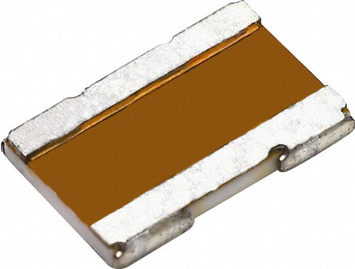

VCS1625Z (Z-Foil) Vishay Foil Resistors Ultra High Precision Z-Foil Surface Mount Current Sensing Chip Resistor with TCR of ± 0.05 ppm/°C and Power Coefficient of 5 ppm at Rated Power FEATURES PR O DU CT  Temperature coefficient of resistance (TCR): ± 0.05 ppm/°C typical (0 °C to + 60 °C) ± 0.2 ppm/°C typical (- 55 °C to + 125 °C, + 25 °C ref.) (see table 1)  Resistance range: 0.3  to 10 (for higher or lower values please contact us)  Foil resistors are not restricted to standard values, we can supply specific “as required” values at no extra cost or delivery (e.g. 1.234  vs. 1 )  Tolerance: to ± 0.2 %  Power coefficient “R due to self heating”: 5 ppm at rated power  Load life stability: 0.02 % at 70 °C, 2000 h at rated power  Electrostatic discharge (ESD) up to 25 000 V  Short time overload < 0.005 %  Power rating: 0.5 W at + 70 °C (figure 1)  Non inductive, non capacitive design  Rise time: 1 ns effectively no ringing  Current rating: 5 A maximum  Current noise: < - 40 dB  Voltage coefficient: < 0.1 ppm/V  Non inductive: < 0.08 µH  Non hot spot design  Prototype samples available from 72 h. For more information, please contact foil@vishaypg.com  For better performances please contact us INTRODUCTION The Z-foil technology provides a significant reduction of the resistive component’s sensitivity to ambient temperature variations (TCR) and applied power changes (PCR). Designers can now guarantee a high degree of stability and accuracy in fixed-resistor applications using solutions based on Vishay‘s revolutionary Z-foil technology. Model VCS1625Z is a surface mount chip resistor designed with 4 pads for Kelvin connection. Utilizing Vishay’s Bulk Metal® Z-foil as the resistance element, it provides performance capabilities far greater than other resistor technologies can supply in a product of comparable size. 0.05 ppm/°C absolute TCR removes errors due to temperature gradients. This small device dissipates heat almost entirely through the pads so surface mount users are encouraged to be generous with the board’s pads and traces. IM PR O VE D Our application engineering department is available to advise and to make recommendations. For non-standard technical requirements and special applications, please contact us. TERMINATIONS  Two lead (Pb)-free options are available: gold plated or tin plated  Tin/lead plated Percent of Rated Power FIGURE 1 - POWER DERATING CURVE APPLICATIONS + 70 °C - 55 °C  Military R I  Medical  Automatic test equipment (ATE) E E  Airborne (in heads-up display I V systems)  High precision instrumentation  Electron beam recording equipment  Electron microscopes  Current sensing applications  Forced balance electronic scales  Applications that require superior frequency stability 100 75 1 50 25 0 - 75 - 50 - 25 0 + 25 + 50 + 75 + 100 + 125 + 150 + 175 Ambient Temperature (°C) 1 2 I I2 TABLE 1 - SPECIFICATIONS (2) MODEL NUMBER RESISTANCE RANGE RESISTANCE TOLERANCE TYPICAL TCR and MAX. SPREAD (- 55 °C to + 125 °C, + 25 °C) POWER RATING at + 70 °C (1) MAXIMUM CURRENT (1) VCS1625Z > 2.0  to 10  0.3  to 2.0  ± 0.2 %, ± 0.5 %; ± 1.0 % ± 0.5 %; ± 1.0 % ± 0.2 ± 2.8 ppm/°C 0.5 W on FR4 PCB 5A Notes (1) Whichever is lower (2) Tighter performances are available. Please contact application engineering foil@vishaypg.com * Pb containing materials are not RoHS compliant, exemptions may apply Document Number: 63094 Revision: 23-Mar-10 For any questions, contact: foil@vishaypg.com www.foilresistors.com 1 VCS1625Z (Z-Foil) Vishay Foil Resistors FIGURE 2 - DIMENSIONS in inches (millimeters) Solder Pad Layout E1 H E2 I2 Top View Bottom View INCHES L 0.250 ± 0.010 H 0.160 ± 0.010 W 0.040 maximum A 0.080 ± 0.005 B 0.040 ± 0.010 I1 B 0.070 (1.78) I1 0.200 (5.08) W Electrical Schematic A 0.070 (1.78) E1 PR O DU CT L Mounting Pads (4) R E2 I2 0.260 (6.60) MILLIMETERS 6.35 ± 0.25 4.06 ± 0.25 1.02 maximum 2.03 ± 0.13 1.02 ± 0.25 FIGURE 3 - TRIMMING TO VALUES (Conceptual Illustration) FIGURE 4 - TYPICAL TCR CURVE Z-FOIL + 500 + 400 + 300 Current Path Before Trimming IM PR O VE D Interloop Capacitance Reduction in Series Current Path After Trimming Trimming Process Removes this Material from Shorting Strip Area Changing Current Path and Increasing Resistance Mutual Inductance Reduction due to Opposing Current in Adjacent Lines + 200 + 100 ΔR 0 R (ppm) - 100 0.05 ppm/°C - 200 - 0.1 ppm/°C 0.1 ppm/°C - 300 0.14 ppm/°C - 400 0.2 ppm/°C - 0.16 ppm/°C - 500 - 55 - 25 0 + 25 + 60 + 75 + 100 + 125 Ambient Temperature (°C) Note: Foil shown in black, etched spaces in white TABLE 2 - PERFORMANCE SPECIFICATIONS MIL-PRF-55342 R LIMITS TYPICAL R LIMITS MAXIMUM R LIMITS (1) Thermal shock 5 x (- 65 °C to + 150 °C) ± 0.10 % ± 0.005 % (50 ppm) ± 0.01 % (100 ppm) Low temperature operation ± 0.10 % ± 0.005 % (50 ppm) ± 0.01 % (100 ppm) Short time overload ± 0.10 % ± 0.005 % (50 ppm) ± 0.02 % (200 ppm) High temperature exposure ± 0.10 % ± 0.01 % (100 ppm) ± 0.02 % (200 ppm) Resistance to soldering heat ± 0.2 % ± 0.01 % (100 ppm) ± 0.03 % (300 ppm) Moisture resistance ± 0.2 % ± 0.01 % (100 ppm) ± 0.03 % (300 ppm) Load life 2000 h at 70 °C: rated power on ceramic PCB ± 0.5 % ± 0.02 % (200 ppm) ± 0.04 % (400 ppm) TEST Note (1) Measurement error 0.001R www.foilresistors.com 2 For any questions, contact: foil@vishaypg.com Document Number: 63094 Revision: 23-Mar-10 VCS1625Z (Z-Foil) Vishay Foil Resistors TABLE 3 - GLOBAL PART NUMBER INFORMATION NEW GLOBAL PART NUMBER: Y16071R50000D9W (preferred part number format) VALUE CHARACTERISTICS (1) Y R= 0 = standard part, tin/lead termination 9 = standard part, lead (Pb)-free termination 129 = standard part, gold plated Other = custom Y 1 6 0 7 1 R PR O DU CT DENOTES PRECISION 5 0 0 0 0 D 9 W PRODUCT CODE RESISTANCE TOLERANCE PACKAGING 1607 = VCS1625Z E = ± 0.2 % D = ± 0.5 % F = ± 1.0 % G = ± 2.0 % J = ± 5.0 % R = tape and reel W = waffle pack FOR EXAMPLE: ABOVE GLOBAL ORDER Y1607 1R50000 D 9 W: TYPE: VCS1625Z VALUE: 1.5  ABSOLUTE TOLERANCE: ± 0.5 % TERMINATION: lead (Pb)-free PACKAGING: waffle pack HISTORICAL PART NUMBER: VCS1625Z 1R5000 TCR0.2 D S W (will continue to be used) 1R5000 TCR0.2 MODEL OHMIC VALUE TCR VCS1625Z 1.5  Characteristic IM PR O VE D VCS1625Z D S W RESISTANCE TOLERANCE TERMINATION PACKAGING S = lead (Pb)-free B = tin/lead G = gold plated T = tape and reel W = waffle pack E = ± 0.2 % D = ± 0.5 % F = ± 1.0 % G = ± 2.0 % J = ± 5.0 % Note (1) Application engineering release: for non-standard requests, please contact application engineering. Document Number: 63094 Revision: 23-Mar-10 For any questions, contact: foil@vishaypg.com www.foilresistors.com 3 Legal Disclaimer Notice Vishay Precision Group, Inc. Disclaimer ALL PRODUCTS, PRODUCT SPECIFICATIONS AND DATA ARE SUBJECT TO CHANGE WITHOUT NOTICE. Vishay Precision Group, Inc., its affiliates, agents, and employees, and all persons acting on its or their behalf (collectively, “VPG”), disclaim any and all liability for any errors, inaccuracies or incompleteness contained herein or in any other disclosure relating to any product. The product specifications do not expand or otherwise modify VPG’s terms and conditions of purchase, including but not limited to, the warranty expressed therein. VPG makes no warranty, representation or guarantee other than as set forth in the terms and conditions of purchase. To the maximum extent permitted by applicable law, VPG disclaims (i) any and all liability arising out of the application or use of any product, (ii) any and all liability, including without limitation special, consequential or incidental damages, and (iii) any and all implied warranties, including warranties of fitness for particular purpose, non-infringement and merchantability. Information provided in datasheets and/or specifications may vary from actual results in different applications and performance may vary over time. Statements regarding the suitability of products for certain types of applications are based on VPG’s knowledge of typical requirements that are often placed on VPG products. It is the customer’s responsibility to validate that a particular product with the properties described in the product specification is suitable for use in a particular application. You should ensure you have the current version of the relevant information by contacting VPG prior to performing installation or use of the product, such as on our website at vpgsensors.com. No license, express, implied, or otherwise, to any intellectual property rights is granted by this document, or by any conduct of VPG. The products shown herein are not designed for use in life-saving or life-sustaining applications unless otherwise expressly indicated. Customers using or selling VPG products not expressly indicated for use in such applications do so entirely at their own risk and agree to fully indemnify VPG for any damages arising or resulting from such use or sale. Please contact authorized VPG personnel to obtain written terms and conditions regarding products designed for such applications. Product names and markings noted herein may be trademarks of their respective owners. Copyright Vishay Precision Group, Inc., 2014. All rights reserved. Document No.: 63999 Revision: 15-Jul-2014 www.vpgsensors.com 1

物料型号:VCS1625Z (Z-Foil)
器件简介:VCS1625Z是一款采用Z-foil技术的表面贴装芯片电阻,具有极低的温度系数(TCR)和功率系数(PCR),保证了固定电阻应用中的稳定性和准确性。
引脚分配:该电阻设计有4个焊盘用于Kelvin连接。
参数特性: - 温度系数(TCR):±0.05 ppm/°C(0°C至+60°C),±0.2 ppm/°C(-55°C至+125°C,以+25°C为基准) - 电阻范围:0.3Ω至10Ω - 公差:±0.2% - 功率系数(PCR):在额定功率下为5ppm - 负载寿命稳定性:在70°C下,2000小时后为0.02% - 静电放电(ESD):高达25000V - 短时过载:<0.005% - 功率等级:在+70°C下为0.5W - 非感性、非容性设计 - 上升时间:1ns,无振荡 - 最大电流等级:5A - 电流噪声:<-40dB - 电压系数:<0.1ppm/V - 非感性:<0.08μH - 无热点设计
功能详解:VCS1625Z电阻通过减少电阻元件对环境温度变化和应用功率变化的敏感性,提供了高稳定性和准确性。它几乎完全通过焊盘散热,适合表面贴装用户使用。
应用信息:适用于军事、医疗、自动测试设备(ATE)、航空(在抬头显示系统中)、高精度仪器、电子束记录设备、电子显微镜、电流感应应用、强制平衡电子秤等需要优越频率稳定性的应用。
封装信息:提供了两种无铅选项:镀金或镀锡。还提供了尺寸图和电气原理图。
