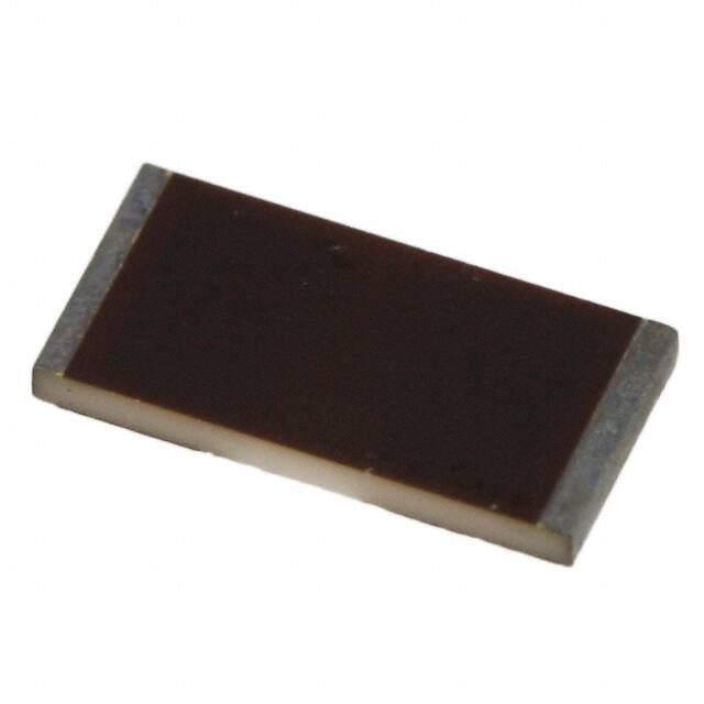

FRSH Series (Z1 Foil Technology) 0603, 0805, 1206, 1506, 2010, 2512 Ultra High Precision Foil Wraparound Surface Mount Chip Resistor with Extended Pads for High Power/High Temperature Applications up to +225°C FEATURES Vishay Foil Resistors (VFR) introduces a new line of Ultra Precision Bulk Metal® Z1 Foil Technology: wraparound surface mount chip resistors with extended pads for high temperature up to + 225 °C(1) (working power: to 330mW at +200 °C). The new extended pad designs also exhibit better heat dissipation, thus enabling higher power usage (Working Power: to 1200mW at + 70°C (1)). The FRSH has a full wraparound termination that ensures safe handling during the manufacturing process, as well as providing stability during multiple thermal cyclings. The FRSH is available in any value within the specified resistance range. VFR's application engineering department is available to advise and make recommendations. For non-standard technical requirements and special applications, please contact foil@vpgsensors.com. TABLE 1 - TOLERANCE AND TCR VS. RESISTANCE VALUE (1)(2) (- 55 °C to + 200 °C, + 25 °C Ref.) RESISTANCE VALUE () 100to 125K 50to < 100 25to < 50 10 to < 25 TOLERANCE (%) ± 0.02 ± 0.05 ± 0.1 ± 0.25 TCR Typical (ppm/°C) ±2.5 Note (1) Performances obtained with ceramic PCB. See Table 2 for power spec. (2) For tighter performances and non-standard values up to 150 k, please contact VFR's application engineering department by sending an e-mail to the address in the footer below. Document Number: 63211 Revision: 27-Oct-15 FIGURE 1 - POWER DERATING CURVE Percent of Rated Power INTRODUCTION  Temperature coefficient of resistance (TCR): ±2.5 ppm/°C typical (- 55 °C to + 200 °C, + 25 °C ref.)  Resistance range: 10 to 125 k(for higher  and lower values, please contact VFR's application engineering department)  Resistance tolerance: to ± 0.02 %  Working power(1): to 1200mW at + 70 °C;  to 330mW at + 200 °C  Long term stability: to ± 0.05 % at + 225 °C for 2000h, no power  Load life stability: to ± 0.05 % typical at + 200 °C for 2000h (working power)  Bulk Metal Foil resistors are not restricted to standard values; specific "as required" values can be supplied at no extra cost or delivery (e.g. 1K2345 vs. 1K)  Thermal stabilization time < 1 s (nominal value achieved within 10 ppm of steady state value)  Electrostatic discharge (ESD) at least to 25 kV  Non inductive, non capacitive design  Rise time: 1 ns effectively no ringing  Current noise: 0.010 µV (RMS)/Volt of applied voltage  (< - 40 dB)  Voltage coefficient: < 0.1 ppm/V  Non inductive: < 0.08 µH  Non hot spot design  Terminal finishes available:  High temperature solder  Matched sets are available on request  Prototype quantities available, please contact foil@vpgsensors.com +70°C -55°C 100 75 50 25 0 -75 For any questions, contact foil@vpgsensors.com -50 -25 0 +25 +50 +75 +100 +125 +150 +175 +200 +225 +250 Ambient Temperature (°C) www.vishayfoilresistors.com 1 FRSH Series (Z1 Foil Technology) 0603, 0805, 1206, 1506, 2010, 2512 HIGH TEMPERATURE PRODUCTS Resistors are the passive building blocks of an electrical circuit. They may be used for dropping the voltage, buffering the surge when the circuit is turned on, providing feedback in a monitoring loop, sensing current flow, etc. When the application requires stability over time and load, initial accuracy, minimal change with temperature for more than 200°C, resistance to moisture and a number of other characteristics that will be described below, the Z1 Foil Technology products have the attributes needed for such application. Over the past few months, there has been considerable growth in the demand for precise, stable and reliable resistors that can operate in harsh environments such as 85°C/85% RH and especially at high temperatures to 200°C. Many analog circuits for industrial, military, aerospace, medical, downhole, oil well and automotive applications require passive components such as resistors to have a minimal drift from their initial values when operating above +175°C and in humid environments. In these applications, the most important factor is the temperature dependence and the end of life tolerance (which is part of the stability) and to a lesser extent, the initial tolerance. The Z1 Foil Technology resistors provide stabilities well under the maximum allowable drift required by customers’ specifications through thousands of hours of operation under harsh conditions, such as the extreme temperatures and radiation-rich environments of downhole oil-well logging applications, in the frigid arctic, under the sea or in deep space. All Bulk Metal Foil resistors receive stabilization processing, such as repetitive short term power overloads, to assure reliable service through the unpredictable stresses of extreme operation. Compared to Bulk Metal Foil, thick and thin film resistor elements are produced with a non-controllable material. Heat or mechanical stresses on the resistive elements cause the particles forming the film to expand. However, after these stresses are alleviated, the articles in the film matrix do not return to the exact original position. That degenerates their overall stability. VPG's ultra high precision Bulk Metal Foil technology includes many types of resistors with a variety of standard configurations that can withstand unconventional environmental conditions above and below the earth’s surface using special post manufacturing operations specially developed for this purpose. The stability of a resistor depends primarily on its history of exposures to high temperature. Stability is affected by: In very high-precision resistors that need to operate in an environment with temperatures above +175°C, these effects must be taken into account to achieve high stability with changes in load (Joule Effect) and ambient temperature. The Z1 Foil Technology provides an order of magnitude reduction in the Bulk Metal Foil element’s sensitivity to temperature changes—both external and internal—with emphasis on long-term stability in high temperature environments. In order to take full advantage of the low TCR and longterm stability improvement, it is necessary to take into account the differences in the resistor’s response to each of the above-mentioned effects. As described below, new products have been developed to successfully deal with these factors. For high temperature applications where stability and total error budget is the main concern, the new generation of Vishay Foil resistors offers the best resilience against time at elevated temperature. The Z1 Foil Technology allows us to produce customer-oriented products designed to satisfy unique and specific technical requirements. In addition to the special chip stabilization under extreme environment conditions in the production line, we offer additional specially oriented post manufacturing operations (PMO) for high temperature applications that require an even higher degree of reliability and stability. Electrostatic discharge (ESD) is another potential problem that can cause unpredictable failure in high temperature applications that increase the sensitivity of the resistors to ESD. ESD damage to electronic devices can occur at any point in the device’s life cycle, from manufacturing to field service. A resistor that is exposed to an ESD event may fail immediately or may experience a latent defect. With latent defects, premature failure can occur after the resistor is already functioning in the finished product after an unpredictable length of service. Bulk Metal Foil resistors are capable of withstanding electrostatic discharges at least to 25 kV without degradation. The VFR Application Engineering department is always available to assist with any special requirements you might have. If you are not sure which resistor best suits your needs, please do not hesitate to contact them for more information: foil@vpgsensors.com 1. Changes in the ambient temperature and heat from adjacent components (defined by the temperature coefficient of resistance, or TCR) 2. Destabilizing thermal shock of suddenly-applied power (defined by the power coefficient of resistance, or PCR) 3. Long-term exposure to applied power (load-life stability) 4. Repetitive stresses from being switched on and off www.vishayfoilresistors.com 2 For any questions, contact foil@vpgsensors.com Document Number: 63211 Revision: 27-Oct-15 FRSH Series (Z1 Foil Technology) 0603, 0805, 1206, 1506, 2010, 2512 TABLE 2 - SPECIFICATIONS(1) FIGURE 2 - TRIMMING TO VALUES (Conceptual Illustration) Interloop capacitance reduction in series Current path before trimming Mutual inductance reduction due to change in current direction Current path after trimming Trimming process removes this material from shorting strip area changing current path and increasing resistance Foil shown in black, etched spaces in white CHIP SIZE RATED POWER (mW) at + 70°C WORKING POWER (mW) at + 200 °C* RESISTANCE RANGE () 0603 0805 1206 1506 2010 2512 120 300 500 600 800 1200 33 83 140 167 220 330 100 to 4K 10to 8K 10to 25K 10to 30K 10 to 70K 10to 125K Note * Maximum working voltage for a given resistance value is calculated using V = P  R . Note To acquire a precision resistance value, the Bulk Metal Foil chip is trimmed by selectively removing built-in “shorting bars.” To increase the resistance in known increments, marked areas are cut, producing progressively smaller increases in resistance. This method reduces the effect of “hot spots” and improves the long-term stability of VFR resistors. TABLE 3 - DIMENSIONS AND LAND PATTERN in Inches (Millimeters) Top View Recommended Land Pattern* L W T L ± 0.005 (0.13) Footprint Z D Extended Pads CHIP SIZE X G W ± 0.005 (0.13) THICKNESS MAXIMUM D ± 0.005 (0.13) Z G X 0603 0.063 (1.60) 0.032(0.81) 0.025 (0.64) 0.011 (0.28) 0.102 (2.59) 0.031 (0.78) 0.031 (0.78) 0805 1206 1506 2010 2512 0.080 (2.03) 0.126 (3.20) 0.150 (3.81) 0.198 (5.03) 0.249 (6.32) 0.050 (1.27) 0.062 (1.57) 0.062 (1.57) 0.097 (2.46) 0.127 (3.23) 0.025 (0.64) 0.025 (0.64) 0.025 (0.64) 0.025 (0.64) 0.025 (0.64) 0.015 (0.38) 0.035 (0.89) 0.047 (1.20) 0.071 (1.82) 0.095 (2.43) 0.122 (3.10) 0.175 (4.45) 0.199 (5.05) 0.247 (6.27) 0.291 (7.39) 0.028 (0.71) 0.029 (0.74) 0.029 (0.74) 0.029 (0.74) 0.029 (0.74) 0.050 (1.27) 0.071 (1.80) 0.071 (1.80) 0.103 (2.62) 0.127 (3.23) * For 0603 and 0805 land pattern dimensions are per IPC-782 TABLE 4 - FRSH PERFORMANCE LIMITS (MIL-PRF-55342) TEST Short-Time Overload CONDITIONS TYPICAL LIMIT % (PPM) MAX LIMIT % (PPM)(1)(2) 6.25 x Pnom. ±0.005% (50) ±0.01% (100) High Temperature Exposure +225°C, 2,000 h ±0.05% (500) ±1% (10,000) Low Temperature Operation –65°C, 45 min at rated power ±0.005% (50) ±0.01% (100) Moisture Resistance Per MIL-PRF-55342 (p. 4.8.9) ±0.01% (100) ±0.01% (100) Stability under load, 200°C, 2,000 h Derated power (see table 2) ±0.05% (500) ±0.4% (4000) Load-Life Test, 70°C, 2,000 h @ rated power (see table 2) ±0.005% (50) ±0.01% (100) 100 x (–65°C to + 200°C) ±0.02% (200) ±0.3% (3000) Thermal Shock Notes Performances obtained with ceramic PCB. As shown + 0.01  to allow for measurement errors at low values. (1) (2) Document Number: 63211 Revision: 27-Oct-15 For any questions, contact foil@vpgsensors.com www.vishayfoilresistors.com 3 FRSH Series (Z1 Foil Technology) 0603, 0805, 1206, 1506, 2010, 2512 FIGURE 3 - RECOMMENDED MOUNTING Notes (1) IR and vapor phase reflow are recommended. (2) Avoid the use of cleaning agents which could attack epoxy resins, which form part of the resistor construction (3) Vacuum pick up is recommended for handling (4) In case of using soldering iron, measurement precautions should be taken to avoid damaging the resistor TABLE 5 - GLOBAL PART NUMBER INFORMATION (1) NEW GLOBAL PART NUMBER: Y406412K7560Q0R (preferred part number format) DENOTES PRECISION VALUE CHARACTERISTICS Y R =  K = k 0 = standard (High Temperature solder) 1 to 999 = custom Y 4 0 6 4 1 2 K 7 5 6 0 Q 0 R PRODUCT CODE RESISTANCE TOLERANCE PACKAGING 4061 = FRSH 0603 4062 = FRSH 0805 4063 = FRSH 1206 4064 = FRSH 1506 4065 = FRSH 2010 4066 = FRSH 2512 Q = ± 0.02 % A = ± 0.05 % B = ± 0.10 % C = ± 0.25 % D = ± 0.5 % F = ± 1.0 % R = tape and reel W = waffle pack FOR EXAMPLE: ABOVE GLOBAL ORDER Y4064 12K7560 Q 0 R: TYPE: FRSH1506 VALUES: 12.7560 k ABSOLUTE TOLERANCE: 0.02 % TERMINATION: Standard PACKAGING: tape and reel HISTORICAL PART NUMBER: FRSH1506 12K756 TCR2.5 Q B T (will continue to be used) FRSH1506 12K756 TCR2.5 Q B T MODEL RESISTANCE VALUE TCR CHARACTERISTICS TOLERANCE TERMINATION PACKAGING FRSH 0603 FRSH 0805 FRSH 1206 FRSH 1506 FRSH 2010 FRSH 2512 12.756 k Q = ± 0.02 % A = ± 0.05 % B = ± 0.10 % C = ± 0.25 % D = ± 0.5 % F = ± 1.0 % B = Standard T = tape and reel W = waffle pack Note (1) For non-standard requests, please contact application engineering. www.vishayfoilresistors.com 4 For any questions, contact foil@vpgsensors.com Document Number: 63211 Revision: 27-Oct-15 Legal Disclaimer Notice Vishay Precision Group, Inc. Disclaimer ALL PRODUCTS, PRODUCT SPECIFICATIONS AND DATA ARE SUBJECT TO CHANGE WITHOUT NOTICE. Vishay Precision Group, Inc., its affiliates, agents, and employees, and all persons acting on its or their behalf (collectively, “VPG”), disclaim any and all liability for any errors, inaccuracies or incompleteness contained herein or in any other disclosure relating to any product. The product specifications do not expand or otherwise modify VPG’s terms and conditions of purchase, including but not limited to, the warranty expressed therein. VPG makes no warranty, representation or guarantee other than as set forth in the terms and conditions of purchase. To the maximum extent permitted by applicable law, VPG disclaims (i) any and all liability arising out of the application or use of any product, (ii) any and all liability, including without limitation special, consequential or incidental damages, and (iii) any and all implied warranties, including warranties of fitness for particular purpose, non-infringement and merchantability. Information provided in datasheets and/or specifications may vary from actual results in different applications and performance may vary over time. Statements regarding the suitability of products for certain types of applications are based on VPG’s knowledge of typical requirements that are often placed on VPG products. It is the customer’s responsibility to validate that a particular product with the properties described in the product specification is suitable for use in a particular application. You should ensure you have the current version of the relevant information by contacting VPG prior to performing installation or use of the product, such as on our website at vpgsensors.com. No license, express, implied, or otherwise, to any intellectual property rights is granted by this document, or by any conduct of VPG. The products shown herein are not designed for use in life-saving or life-sustaining applications unless otherwise expressly indicated. Customers using or selling VPG products not expressly indicated for use in such applications do so entirely at their own risk and agree to fully indemnify VPG for any damages arising or resulting from such use or sale. Please contact authorized VPG personnel to obtain written terms and conditions regarding products designed for such applications. Product names and markings noted herein may be trademarks of their respective owners. Copyright Vishay Precision Group, Inc., 2014. All rights reserved. Document No.: 63999 Revision: 15-Jul-2014 www.vpgsensors.com 1

物料型号:FRSH系列,包括0603、0805、1206、1506、2010、2512封装尺寸。
器件简介:FRSH系列是超高精度箔式绕线表面贴装芯片电阻,采用Z1箔技术,适用于高达+225°C的高温应用。这些电阻具有扩展的焊盘设计,以改善散热并提高功率使用。
引脚分配:文档中没有明确指出具体的引脚分配,但提到了电阻具有全环绕终止,确保在制造过程中安全处理,并在多次热循环中提供稳定性。
参数特性: - 温度系数(TCR):典型值为±2.5 ppm/°C(-55°C至+200°C,+25°C参考)。 - 电阻范围:10Ω至125 kΩ。 - 电阻公差:高达±0.02%。 - 工作功率:在+70°C下高达1200mW,在+200°C下高达330mW。 - 长期稳定性:在+225°C下2000小时内高达±0.05%,无功率。 - 负载寿命稳定性:在+200°C下2000小时内典型值为±0.05%。
功能详解: - 电阻不仅限于标准值,可以提供特定“按需”值,无需额外费用或交货期。 - 热稳定时间小于1秒(在10 ppm内达到稳态值)。 - 静电放电(ESD)至少可承受25 kV。 - 非感性、非容性设计。 - 上升时间:1纳秒,无振荡。 - 电流噪声:0.010 µV(RMS)/应用电压伏特(<-40 dB)。 - 电压系数:<0.1 ppm/V。 - 非感性:<0.08 µH。 - 非热点设计。
应用信息: - 电阻是电路的被动构建块,可用于降低电压、缓冲启动时的浪涌、提供监控环路中的反馈、感应电流流动等。 - 在需要超过200°C的稳定性、初始精度、温度变化最小、抵抗湿度和其他特性的应用中,Z1箔技术产品具有所需的属性。
封装信息: - 提供了不同尺寸的推荐焊盘图案和尺寸,包括0603和0805的IPC-782标准焊盘尺寸。
