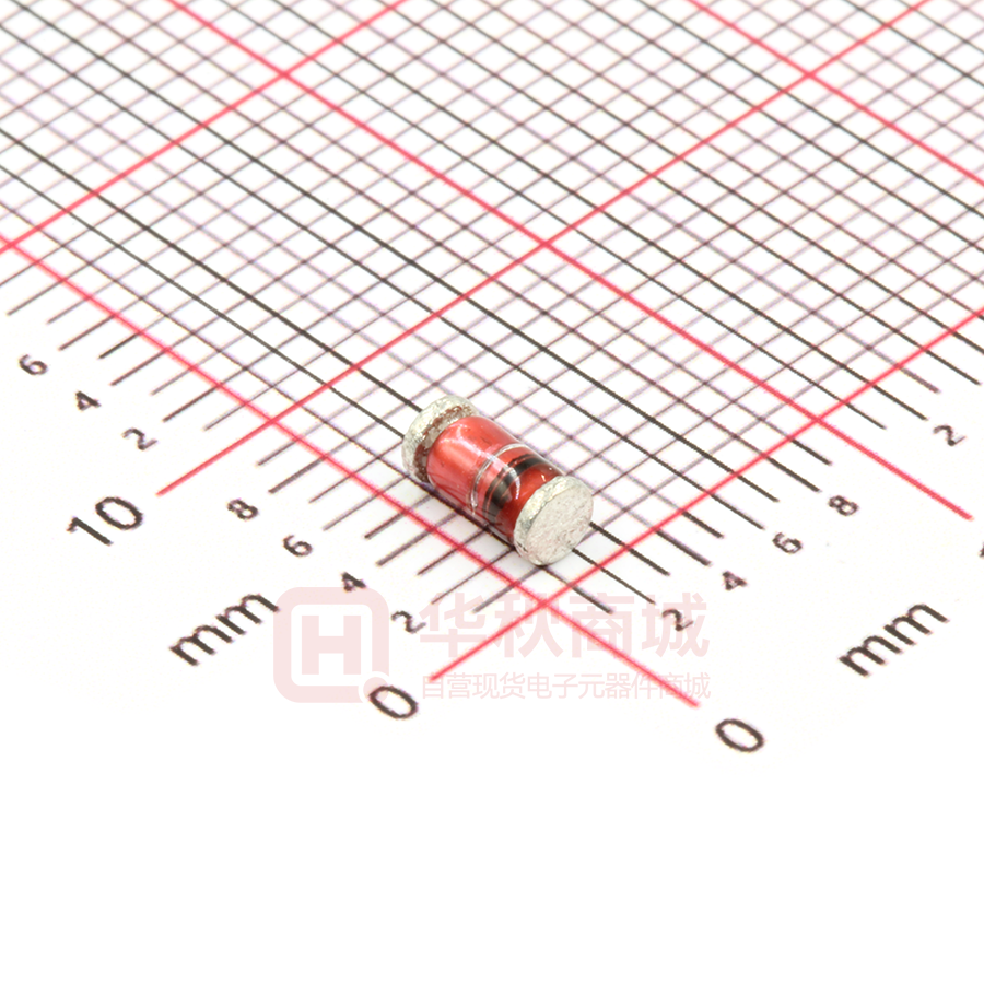

ZM4728A to ZM4761A www.vishay.com Vishay Semiconductors Zener Diodes FEATURES • Silicon planar power Zener diodes • For use in stablilizing and clipping circuits with high power rating • Standard Zener voltage tolerance is ± 5 % • These diodes are also available in the DO-41 case with type designation 1N4728A to 1N4761A • Material categorization: for definitions of compliance www.vishay.com/doc?99912 LINKS TO ADDITIONAL RESOURCES 3D 3D please see 3D Models PRIMARY CHARACTERISTICS PARAMETER VALUE UNIT VZ range nom. 3.3 to 75 V Test current IZT 3.3 to 76 mA VZ specification Thermal equilibrium Circuit configuration Single ORDERING INFORMATION DEVICE NAME ORDERING CODE TAPED UNITS PER REEL MINIMUM ORDER QUANTITY ZM4728A to ZM4761A ZM4728A to ZM4761A-series-GS18 5 000 (12 mm tape on 13" reel) 10 000/box ZM4728A to ZM4761A ZM4728A to ZM4761A-series-GS08 1 500 (12 mm tape on 7" reel) 12 000/box PACKAGE PACKAGE NAME MELF (DO-213AB) glass WEIGHT MOLDING COMPOUND FLAMMABILITY RATING MOISTURE SENSITIVITY LEVEL SOLDERING CONDITIONS 135 mg UL 94 V-0 MSL level 1 (according J-STD-020) Peak temperature max. 260 °C ABSOLUTE MAXIMUM RATINGS (Tamb = 25 °C, unless otherwise specified) PARAMETER Power dissipation Zener current Junction to ambient air Junction temperature Storage temperature range TEST CONDITION SYMBOL VALUE UNIT Valid provided that electrodes are kept at ambient temperature Ptot 1000 mW RthJA 170 K/W Tj 175 °C Tstg -65 to +175 °C See table “Characteristics” Valid provided that electrodes are kept at ambient temperature Rev. 1.6, 25-Nov-2021 Document Number: 85786 1 For technical questions within your region: DiodesAmericas@vishay.com, DiodesAsia@vishay.com, DiodesEurope@vishay.com THIS DOCUMENT IS SUBJECT TO CHANGE WITHOUT NOTICE. THE PRODUCTS DESCRIBED HEREIN AND THIS DOCUMENT ARE SUBJECT TO SPECIFIC DISCLAIMERS, SET FORTH AT www.vishay.com/doc?91000 ZM4728A to ZM4761A www.vishay.com Vishay Semiconductors ELECTRICAL CHARACTERISTICS (Tamb = 25 °C, unless otherwise specified) ZENER VOLTAGE RANGE (3) PART NUMBER VZ at IZT1 TEST CURRENT IZT1 V REVERSE LEAKAGE CURRENT IZT2 mA IR at VR μA NOM. DYNAMIC RESISTANCE (1) f = 1 kHz ZZ at IZT1 MAX. ZZK at IZT2 Ω V MAX. MAX. SURGE CURRENT (4) REGULATOR CURRENT (2) IZSM IZM mA mA MAX. ZM4728A 3.3 76 1 100 1 10 400 1380 276 ZM4729A 3.6 69 1 100 1 10 400 1260 252 ZM4730A 3.9 64 1 50 1 9 400 1190 234 ZM4731A 4.3 58 1 10 1 9 400 1070 217 ZM4732A 4.7 53 1 10 1 8 500 970 193 ZM4733A 5.1 49 1 10 1 7 550 890 178 ZM4734A 5.6 45 1 10 2 5 600 810 162 ZM4735A 6.2 41 1 10 3 2 700 730 146 ZM4736A 6.8 37 1 10 4 3.5 700 660 133 ZM4737A 7.5 34 0.5 10 5 4 700 605 121 ZM4738A 8.2 31 0.5 10 6 4.5 700 550 110 ZM4739A 9.1 28 0.5 10 7 5 700 500 100 ZM4740A 10 25 0.25 10 7.6 7 700 454 91 ZM4741A 11 23 0.25 5 8.4 8 700 414 83 ZM4742A 12 21 0.25 5 9.1 9 700 380 76 ZM4743A 13 19 0.25 5 9.9 10 700 344 69 ZM4744A 15 17 0.25 5 11.4 14 700 304 61 ZM4745A 16 15.5 0.25 5 12.2 16 700 285 57 ZM4746A 18 14 0.25 5 13.7 20 750 250 50 ZM4747A 20 12.5 0.25 5 15.2 22 750 225 45 ZM4748A 22 11.5 0.25 5 16.7 23 750 205 41 ZM4749A 24 10.5 0.25 5 18.2 25 750 190 38 ZM4750A 27 9.5 0.25 5 20.6 35 750 170 34 ZM4751A 30 8.5 0.25 5 22.8 40 1000 150 30 ZM4752A 33 7.5 0.25 5 25.1 45 1000 135 27 ZM4753A 36 7 0.25 5 27.4 50 1000 125 25 ZM4754A 39 6.5 0.25 5 29.7 60 1000 115 23 ZM4755A 43 6 0.25 5 32.7 70 1500 110 22 ZM4756A 47 5.5 0.25 5 35.8 80 1500 95 19 ZM4757A 51 5 0.25 5 38.8 95 1500 90 18 ZM4758A 56 4.5 0.25 5 42.6 110 2000 80 16 ZM4759A 62 4 0.25 5 47.1 125 2000 70 14 ZM4760A 68 3.7 0.25 5 51.7 150 2000 65 13 ZM4761A 75 3.3 0.25 5 56 175 2000 60 12 ZM4762A 82 3 0.25 5 62.2 200 3000 55 11 ZM4763A 91 2.8 0.25 5 69.2 250 3000 50 10 ZM4764A 100 2.5 0.25 5 76 350 3000 45 9 Notes (1) The Zener impedance is derived from the 1 kHz AC voltage which results when an AC current having an RMS value equal to 10 % of the Zener current (IZT1 or IZT2) is superimposed on IZT1 or IZT2. Zener impedance is measured at two points to insure a sharp knee on the breakdown curve and to eliminate unstable units (2) Valid provided that electrodes are kept at ambient temperature (3) Measured under thermal equilibrium and DC test conditions (4) Width of the test pulse is 8.3 ms Rev. 1.6, 25-Nov-2021 Document Number: 85786 2 For technical questions within your region: DiodesAmericas@vishay.com, DiodesAsia@vishay.com, DiodesEurope@vishay.com THIS DOCUMENT IS SUBJECT TO CHANGE WITHOUT NOTICE. THE PRODUCTS DESCRIBED HEREIN AND THIS DOCUMENT ARE SUBJECT TO SPECIFIC DISCLAIMERS, SET FORTH AT www.vishay.com/doc?91000 ZM4728A to ZM4761A www.vishay.com Vishay Semiconductors BASIC CHARACTERISTICS (Tamb = 25 °C, unless otherwise specified) W 1.0 Ptot 0.8 0.6 0.4 0.2 0 18289 0 100 200 °C Tamb Fig. 1 - Admissible Power Dissipation vs. Ambient Temperature PACKAGE DIMENSIONS in millimeters (inches): MELF DO-213AB (glass) 2.6 (0.102) 2.4 (0.094) Cathode identification 0.55 (0.022) 5.2 (0.205) 4.8 (0.189) The gap between plug and glass can be either on cathode or anode side Foot print recommendation: 4.00 (0.157) max. 3.00 (0.118) min. min. 1.25 (0.049) 6.50 (0.256) 18317 ref. Rev. 1.6, 25-Nov-2021 Document Number: 85786 3 For technical questions within your region: DiodesAmericas@vishay.com, DiodesAsia@vishay.com, DiodesEurope@vishay.com THIS DOCUMENT IS SUBJECT TO CHANGE WITHOUT NOTICE. THE PRODUCTS DESCRIBED HEREIN AND THIS DOCUMENT ARE SUBJECT TO SPECIFIC DISCLAIMERS, SET FORTH AT www.vishay.com/doc?91000 Legal Disclaimer Notice www.vishay.com Vishay Disclaimer ALL PRODUCT, PRODUCT SPECIFICATIONS AND DATA ARE SUBJECT TO CHANGE WITHOUT NOTICE TO IMPROVE RELIABILITY, FUNCTION OR DESIGN OR OTHERWISE. Vishay Intertechnology, Inc., its affiliates, agents, and employees, and all persons acting on its or their behalf (collectively, “Vishay”), disclaim any and all liability for any errors, inaccuracies or incompleteness contained in any datasheet or in any other disclosure relating to any product. Vishay makes no warranty, representation or guarantee regarding the suitability of the products for any particular purpose or the continuing production of any product. To the maximum extent permitted by applicable law, Vishay disclaims (i) any and all liability arising out of the application or use of any product, (ii) any and all liability, including without limitation special, consequential or incidental damages, and (iii) any and all implied warranties, including warranties of fitness for particular purpose, non-infringement and merchantability. Statements regarding the suitability of products for certain types of applications are based on Vishay's knowledge of typical requirements that are often placed on Vishay products in generic applications. Such statements are not binding statements about the suitability of products for a particular application. It is the customer's responsibility to validate that a particular product with the properties described in the product specification is suitable for use in a particular application. Parameters provided in datasheets and / or specifications may vary in different applications and performance may vary over time. All operating parameters, including typical parameters, must be validated for each customer application by the customer's technical experts. Product specifications do not expand or otherwise modify Vishay's terms and conditions of purchase, including but not limited to the warranty expressed therein. Hyperlinks included in this datasheet may direct users to third-party websites. These links are provided as a convenience and for informational purposes only. Inclusion of these hyperlinks does not constitute an endorsement or an approval by Vishay of any of the products, services or opinions of the corporation, organization or individual associated with the third-party website. Vishay disclaims any and all liability and bears no responsibility for the accuracy, legality or content of the third-party website or for that of subsequent links. Except as expressly indicated in writing, Vishay products are not designed for use in medical, life-saving, or life-sustaining applications or for any other application in which the failure of the Vishay product could result in personal injury or death. Customers using or selling Vishay products not expressly indicated for use in such applications do so at their own risk. Please contact authorized Vishay personnel to obtain written terms and conditions regarding products designed for such applications. No license, express or implied, by estoppel or otherwise, to any intellectual property rights is granted by this document or by any conduct of Vishay. Product names and markings noted herein may be trademarks of their respective owners. © 2022 VISHAY INTERTECHNOLOGY, INC. ALL RIGHTS RESERVED Revision: 01-Jan-2022 1 Document Number: 91000
