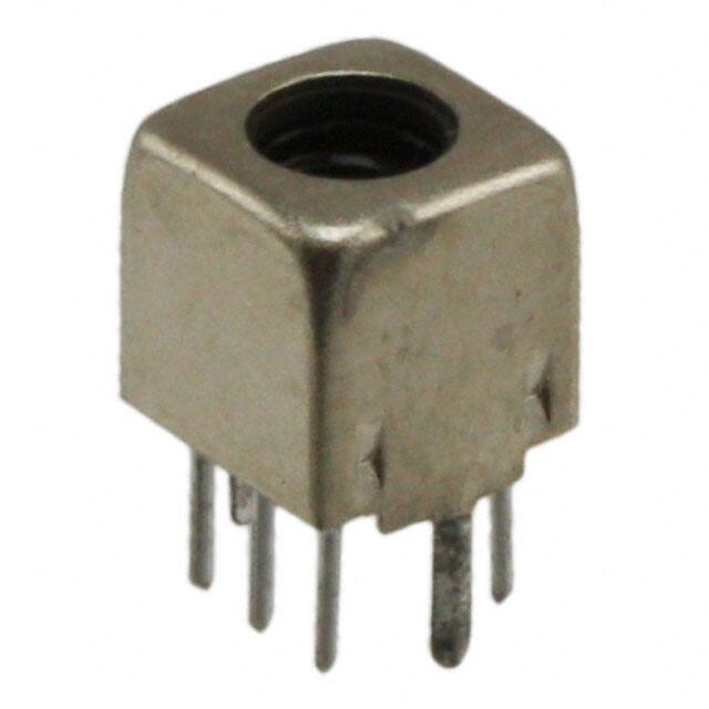

    插件,5.9x5.9mm
    可调电感 470nH ±6% Radial, Horizontal, 4 Leads
294SN-T1013Z 数据手册
TYPE Variable Coils 5K 5KM 5mm TYPE 5KM Frequency Range: 30-150MHz Inductance Range: 0.05-10µH Temperature Coefficient: TC (L) 80±120ppm/°C TC (F) 0±120ppm/°C Internal Capacitance Value: 5-56pF 65 5mm TYPE 5K Frequency Range: 30-150MHz Inductance Range: 0.08-1.0µH Temperature Coefficient: 220±150ppm/°C Unit: mm Unit: mm Features • The dual, closely spaced slots on the bobbin produces high Q, tight tolerances, stable winding impedance, low distributed capacitance, and added stability in humid conditions. Features • Available with internal capacitor. • Spiral wound with high number of closely spaced slots on form, to yields low distributed capacitance, low temperature coefficient, and added stability in humid conditions. STANDARD COILS SELECTION GUIDE TYPE 5K TOKO Part Number 294SN-T1008Z 294SN-T1009Z 294SN-T1010Z 294SN-T1011Z 294SN-T1012Z 294SN-T1013Z 294SN-T1014Z 294SN-T1015Z Inductance Range (µH) 0.08 ±2% 0.10 ±6% 0.15 ±6% 0.22 ±6% 0.33 ±6% 0.47 ±6% 0.68 ±6% 1.00 ±6% Q (min.) 45 45 45 45 45 45 45 45 Test Frequency (MHz) 75.0 75.0 75.0 45.0 45.0 45.0 45.0 30.0 STANDARD COILS SELECTION GUIDE TYPE 5KM TOKO Part Number 369SNS-1646Z 369SNS-1647Z 369SNS-1648Z 369SNS-1649Z 369SNS-1650Z 369SNS-1651Z 369SNS-1652Z 369SNS-1653Z 369SNS-1654Z 369SNS-1655Z 369SNS-1656Z 369SNS-1657Z 369SNS-1658Z 369SNS-1659Z 369SNS-1660Z 369SNS-1661Z 369SNS-1662Z 369SNS-1663Z 369SNS-1664Z 369SNS-1665Z 369SNS-1666Z 369SNS-1667Z 369SNS-1668Z 369SNS-1676Z 369SNS-1677Z Inductance Range (µH) 0.10 ±5% 0.12 ±5% 0.15 ±5% 0.18 ±6% 0.22 ±6% 0.27 ±6% 0.33 ±6% 0.39 ±6% 0.47 ±6% 0.56 ±6% 0.68 ±6% 0.82 ±6% 1.00 ±6% 1.20 ±6% 1.50 ±6% 1.80 ±5% 2.20 ±5% 2.70 ±5% 3.30 ±6% 3.90 ±6% 4.70 ±6% 5.60 ±5% 6.80 ±5% 8.20 ±5% 10.00± 3% Q (min.) 35 35 35 35 35 35 35 35 35 35 35 35 25 25 25 25 25 25 25 25 25 25 25 25 25 Test Frequency (MHz) 50 50 50 50 50 50 50 50 50 50 50 50 7.96 7.96 7.96 7.96 7.96 7.96 7.96 7.96 7.96 7.96 7.96 7.96 7.96
