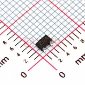

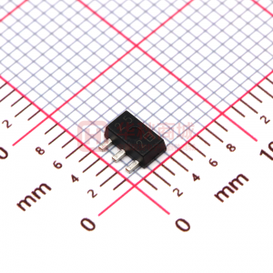

◆CMOS Low Power Consumption ◆Operational Voltage Range : Up to 20V ◆Dropout Voltage : 200mV@30mA 670mV@100mA ◆Maximum Output Current : More Than 150mA ◆Highly Accurate : ±2% ◆Output Voltage Range : 1.8V ~ 18.0V ◆Current Limiter Circuit Built-In ◆SOT-23 / SOT-89 / TO-92 / SOT-223 / USP-6B Package ◆Low ESR Capacitors Compatible ■APPLICATIONS ●Battery powered equipment ●Reference voltage ●Cameras, video cameras ●Palmtops ■GENERAL DESCRIPTION The XC6202 series are highly precise, low power consumption, high voltage, positive voltage regulators manufactured using CMOS and laser trimming technologies. The XC6202 consists of a current limiter circuit, a driver transistor, a precision reference voltage and an error correction circuit. Output voltage is selectable in 100mV steps from 1.8V ~ 18V. The series is also compatible with low ESR ceramic capacitors which give added output stability. Since the current limiter circuit is built-in, the IC is protected against overshoot currents at such times of output shorts etc. SOT-23 available. (150mW), SOT-89 (500mW), TO-92 (300mW), SOT-223 (1200mW) and USP-6B (100mW) packages are ■FEATURES : 150mA : 200mV @ 30mA : Up to 20V : 1.8V ~ 18V (Selectable in 100mV steps) Highly Accurate :±2% Low Power Consumption : 10μA (TYP.) (VOUT=3.3V) Operational Temperature Range : -40℃ ~ 85℃ Line Regulation : 0.01% / V (TYP.) Ultra Small Packages : SOT-23 (150mW), SOT-89 (500mW), TO-92 (300mW), SOT-223 (1200mW), USP-6B (100mW) Low ESR Capacitor Compatible : Ceramic capacitor Maximum Output Current Dropout Voltage Operational Voltage Range Output Voltage Range ■TYPICAL APPLICATION CIRCUIT ■TYPICAL PERFORMANCE CHARACTERISTICS XC6202 ETR0302_001.doc 181 XC6202 Series ■PIN CONFIGURATION NC VSS NC USP-6B (BOTTOM VIEW) VIN NC VOUT *The dissipation pad for the USP-6B package should be solder-plated in recommended mount pattern and metal masking so as to enhance mounting strength and heat release. If the pad needs to be connected to other pins, it should be connected to the VSS pin. ■PIN ASSIGNMENT PIN NUMBER SOT-23 SOT-89/TO-92/ SOT-223 USP-6B PIN NAME FUNCTION 1 3 2 - 1 2 3 - 3 5 1 2, 4, 6 VOUT VSS VIN NC Output Ground Power Input No connection ■PRODUCT CLASSIFICATION ●Ordering Information XC6202P①②③④⑤ DESIGNATOR DESCRIPTION SYMBOL DESCRIPTION : For the voltage above 10V, see the example 10=A, 11=B 12=C, 13=D, 14=E, 15=F, 16=G, 17=H, 18=J e.g. VOUT= 3.0V → ①:3, ②:0 VOUT= 12V → ①:C, ②:0 VOUT= 15V → ①:F, ②:0 : ±2% : SOT-23 : SOT-89 : TO-92 : SOT-223 : USP-6B : Embossed tape, standard feed : Embossed tape, reverse feed : Paper Tape (TO-92) : Bag (TO-92) ①② Output Voltage 18 ~ J0 ③ Accuracy 2 M P ④ Package T F D R L H B ⑤ Device Orientation 182 XC6202 Series ■PACKAGING INFORMATION ●SOT-23 ●SOT-89 183 XC6202 Series ■PACKAGING INFORMATION (Continued) ●TO-92 ●SOT-223 184 XC6202 Series ■PACKAGING INFORMATION (Continued) ●USP-6B 185 XC6202 Series ■MARKING RULE ●SOT-23, SOT-89, SOT-223 3 ② ④ ① ② ③ ④ ① 1 2 1 2 3 ③ ①②③④ 1 2 3 ①Represents product series MARK 2 ②Represents output voltage range MARK 4 5 6 7 8 9 ③Represents output voltage MARK 0 1 2 3 4 5 6 7 8 9 A B C D E - - - - - - - - - - - - - - - 3.1 3.2 3.3 3.4 3.5 3.6 3.7 3.8 3.9 4.0 4.1 4.2 4.3 4.4 4.5 VOLTAGE (V) 6.1 6.2 6.3 6.4 6.5 6.6 6.7 6.8 6.9 7.0 7.1 7.2 7.3 7.4 7.5 9.1 9.2 9.3 9.4 9.5 9.6 9.7 9.8 9.9 10.0 10.1 10.2 10.3 10.4 10.5 12.1 12.2 12.3 12.4 12.5 12.6 12.7 12.8 12.9 13.0 13.1 13.2 13.3 13.4 13.5 15.1 15.2 15.3 15.4 15.5 15.6 15.7 15.8 15.9 16.0 16.1 16.2 16.3 16.4 16.5 MARK F H K L M N P R S T U V X Y Z - - 1.8 1.9 2.0 2.1 2.2 2.3 2.4 2.5 2.6 2.7 2.8 2.9 3.0 4.6 4.7 4.8 4.9 5.0 5.1 5.2 5.3 5.4 5.5 5.6 5.7 5.8 5.9 6.0 VOLTAGE (V) 7.6 7.7 7.8 7.9 8.0 8.1 8.2 8.3 8.4 8.5 8.6 8.7 8.8 8.9 9.0 10.6 10.7 10.8 10.9 11.0 11.1 11.2 11.3 11.4 11.5 11.6 11.7 11.8 11.9 12.0 13.6 13.7 13.8 13.9 14.0 14.1 14.2 14.3 14.4 14.5 14.6 14.7 14.8 14.9 15.0 16.6 16.7 16.8 16.9 17.0 17.1 17.2 17.3 17.4 17.5 17.6 17.7 17.8 17.9 18.0 VOLTAGE (V) 0.1 ~ 3.0 3.1 ~ 6.0 6.1 ~ 9.0 9.1 ~ 12.0 12.1 ~ 15.0 15.1 ~ 18.0 PRODUCT SERIES PRODUCT SERIES XC6202Pxxxxx XC6202Pxxxxx ④Represents production lot number 0 to 9, A to Z reversed character 0 to 9, A to Z repeated. (G, I, J, O, Q, W excepted) 186 XC6202 Series ■MARKING RULE(Continued) ●TO-92 (T TYPE) ①Represents type of regulator MARK P ②Represents integer of the output voltage MARK 1 2 3 4 5 6 7 8 9 VOLTAGE (V) 1.x 2.x 3.x 4.x 5.x 6.x 7.x 8.x 9.x PRODUCT SERIES XC6202P1xxxx XC6202P2xxxx XC6202P3xxxx XC6202P4xxxx XC6202P5xxxx XC6202P6xxxx XC6202P7xxxx XC6202P8xxxx XC6202P9xxxx MARK A B C D E F G H J VOLTAGE (V) 10.x 11.x 12.x 13.x 14.x 15.x 16.x 17.x 18.x PRODUCT SERIES XC6202PAxxxx XC6202PBxxxx XC6202PCxxxx XC6202PDxxxx XC6202PExxxx XC6202PFxxxx XC6202PGxxxx XC6202PHxxxx XC6202PJxxxx PRODUCT SERIES XC6202Pxxxxx ③Represents decimal number of output voltage MARK 3 0 ④Represents detect voltage accuracy MARK 2 1 DETECT VOLTAGE ACCURACY within ±2% within ±1% PRODUCT SERIES XC6202Pxx2xx XC6202Pxx1xx VOLTAGE (V) x.3 x.0 PRODUCT SERIES XC6202Px3xxx XC6202Px0xxx ⑤Represents a least significant digit of production year MARK 3 4 ⑥Represents production lot number 0 to 9, A to Z repeated (G, I, J, O, Q, W excepted) Note: No character inversion used. PRODUCTION YEAR 2003 2004 187 XC6202 Series ■MARKING RULE (Continued) ●USP-6B ①②Represents product series MARK ① 0 ② 2 PRODUCT SERIES XC6202PxxxDx ③Represents type of regulator MARK P PRODUCT SERIES XC6202Pxxxxx ④Represents integer of the output voltage MARK 1 2 3 4 5 6 7 8 9 VOLTAGE (V) 1.x 2.x 3.x 4.x 5.x 6.x 7.x 8.x 9.x PRODUCT SERIES XC6202P1xxDx XC6202P2xxDx XC6202P3xxDx XC6202P4xxDx XC6202P5xxDx XC6202P6xxDx XC6202P7xxDx XC6202P8xxDx XC6202P9xxDx MARK A B C D E F G H J VOLTAGE (V) 10.x 11.x 12.x 13.x 14.x 15.x 16.x 17.x 18.x PRODUCT SERIES XC6202PAxxDx XC6202PBxxDx XC6202PCxxDx XC6202PDxxDx XC6202PExxDx XC6202PFxxDx XC6202PGxxDx XC6202PHxxDx XC6202PJxxDx ⑤Represents decimal number of output voltage MARK 3 0 VOLTAGE (V) X.3 X.0 PRODUCT SERIES XC6202Px3xDx XC6202Px0xDx ⑥Represents production lot number 0 to 9, A to Z repeated (G, I, J, O, Q, W excepted) Note: No character inversion used. 188 XC6202 Series ■BLOCK DIAGRAM ■ABSOLUTE MAXIMUM RATINGS Ta = 25℃ PARAMETER Input Voltage Output Current Output Voltage SOT-25 SOT-89 Power TO-92 Dissipation USP-6B SOT-223 Operating Temperature Range Storage Temperature Range SYMBOL VIN IOUT VOUT RATINGS 22.0 500 VSS-0.3 ~ VIN+0.3 150 500 300 100 1,200 * -40~+85 -55~+125 UNITS V mA V Pd mW Topr Tstg ℃ ℃ * Circuits board mounting: Double-sided board 189 XC6202 Series ■ELECTRICAL CHARACTERISTICS XC6202P182 VOUT(T)=1.8V (*1) Topr=25℃ CONDITIONS VIN=2.8V IOUT=30mA VIN=2.8V VOUT≧VOUT(E)×0.9 VIN=2.3V 1mA≦IOUT≦100mA IOUT=30mA IOUT=100mA VIN=2.8V IOUT=1mA 2.8V≦VIN≦20V IOUT=30mA -40℃≦Topr≦85℃ VIN=3.8V MIN 1.764 60 TYP 1.800 10 340 1000 10 0.01 ±100 40 MAX 1.836 80 470 1500 24 0.20 20 UNITS V mA mV mV μA %/V V ppm /℃ mA CIRCUIT PARAMETER Output Voltage Maximum Output Current Load Regulation Dropout Voltage(*3) Supply Current Line Regulation Input Voltage Output Voltage Temperature Characteristics Short-circuit Current SYMBOL VOUT(E) (*2) IOUTmax △VOUT Vdif1 Vdif2 ISS △VOUT △VIN・△VOUT VIN △VOUT △Topr・△VOUT Ishort ② ② ② ② ① ② ② ② XC6202P332 VOUT(T)=3.3V (*1) Topr=25℃ CONDITIONS VIN=4.3V IOUT=30mA VIN=4.3V VOUT≧VOUT(E)×0.9 VIN=4.3V 1mA≦IOUT≦100mA IOUT=30mA IOUT=100mA VIN=4.3V IOUT=1mA 4.3V≦VIN≦20V IOUT=30mA -40℃≦Topr≦85℃ VIN=5.3V MIN 3.234 150 TYP 3.300 25 200 670 10 0.01 ±100 40 MAX 3.366 90 280 900 24 0.20 20 UNITS V mA mV mV μA %/V V ppm /℃ mA CIRCUIT PARAMETER Output Voltage Maximum Output Current Load Regulation Dropout Voltage(*3) Supply Current Line Regulation Input Voltage Output Voltage Temperature Characteristics Short-circuit Current SYMBOL VOUT(E) (*2) IOUTmax △VOUT Vdif1 Vdif2 ISS △VOUT △VIN・△VOUT VIN △VOUT △Topr・△VOUT Ishort ② ② ② ② ① ② ② ② 190 XC6202 Series ■ELECTRICAL CHARACTERISTICS (Continued) XC6202P502 VOUT(T)=5.0V (*1) Topr=25℃ PARAMETER Output Voltage Maximum Output Current Load Regulation Dropout Voltage(*3) Supply Current Line Regulation Input Voltage Output Voltage Temperature Characteristics Short-circuit Current SYMBOL VOUT(E) (*2) IOUTmax △VOUT Vdif1 Vdif2 ISS △VOUT △VIN・△VOUT VIN △VOUT △Topr・△VOUT Ishort CONDITIONS VIN=6V IOUT=30mA VIN=6V VOUT≧VOUT(E)×0.9 VIN=6V 1mA≦IOUT≦100mA IOUT=30mA IOUT=100mA VIN=6V IOUT=1mA 6V≦VIN≦20V IOUT=30mA -40℃≦Topr≦85℃ VIN=7V MIN 4.900 200 - TYP 5.000 30 130 440 10 0.01 ±100 40 MAX 5100 100 190 550 24 0.20 20 - UNITS V mA mV mV μA %/V V ppm /℃ mA CIRCUIT ② ② ② ② ① ② ② ② XC6202PC02 VOUT(T)=3.3V(*1) SYMBOL VOUT(E) (*2) IOUTmax △VOUT Vdif1 Vdif2 ISS △VOUT △VIN・△VOUT VIN △VOUT △Topr・△VOUT Ishort CONDITIONS VIN=13V IOUT=30mA VIN=13V VOUT≧VOUT(E)×0.9 VIN=13V 1mA≦IOUT≦100mA IOUT=30mA IOUT=100mA VIN=13V IOUT=1mA 13V≦VIN≦20V IOUT=30mA -40℃≦Topr≦85℃ VIN=7V MIN 11.760 200 TYP 12.000 60 90 290 12 0.01 ±100 40 MAX 12.240 230 150 380 28 0.20 20 - Topr=25℃ UNITS V mA mV mV μA %/V V ppm /℃ mA CIRCUIT PARAMETER Output Voltage Maximum Output Current Load Regulation Dropout Voltage(*3) Supply Current Line Regulation Input Voltage Output Voltage Temperature Characteristics Short-circuit Current ② ② ② ② ① ② ② ② 191 XC6202 Series ■ELECTRICAL CHARACTERISTICS (Continued) XC6202PJ02 VOUT(T)=18V (*1) Topr=25℃ CONDITIONS VIN=19V IOUT=30mA VIN=19V VOUT≧VOUT(E)×0.9 VIN=19V 1mA≦IOUT≦100mA IOUT=30mA IOUT=100mA VIN=19V IOUT=1mA 19V≦VIN≦20V IOUT=30mA -40℃≦Topr≦85℃ VIN=20V MIN. 17.640 200 TYP. 18.000 120 80 280 15 0.01 ±100 40 MAX. 18.360 380 150 380 30 0.20 20 UNITS V mA mV mV μA %/V V ppm /℃ mA CIRCUIT PARAMETER Output Voltage Maximum Output Current Load Regulation Dropout Voltage(*3) Supply Current Line Regulation Input Voltage Output Voltage Temperature Characteristics Short-circuit Current SYMBOL VOUT(E) (*2) IOUTmax △VOUT Vdif1 Vdif2 ISS △VOUT △VIN・△VOUT VIN △VOUT △Topr・△VOUT Ishort ② ② ② ② ① ② ② ② *1. VOUT(T) = Specified output voltage. *2. VOUT(E) = Effective output voltage (i.e. the output voltage when “VOUT(T)+1.0V” is provided at the VIN pin while maintaining certain IOUT value). *3. Vdif = VIN1 - VOUT1 *4. VOUT1 = A voltage equal to 98% of the output voltage when “VOUT (T) + 1.0V” is input. *5. VIN1 = The input voltage when VOUT1 is output following a gradual decrease in the input voltage. ■TEST CIRCUITS CIRCUIT ① CIRCUIT ② 192 XC6202 Series ■TYPICAL PERFORMANCE CHARACTERISTICS ●XC6202P182 (1) Output Voltage vs. Output Current (2) Output Voltage vs. Input Voltage (3) Dropout Voltage vs. Output Current 193 XC6202 Series ■TYPICAL PERFORMANCE CHARACTERISTICS (Continued) ●XC6202P182 (Continued) (4) Supply Current vs. Input Voltage XC6202P182 (1.8V) XC6202P182 (1.8V) (5) Output Voltage vs. Ambient Temperature XC6202P182 (1.8V) (6) Supply Current vs. Ambient Temperature XC6202P182 (1.8V) (7) Current Limiter Circuit XC6202P182 (1.8V) 194 XC6202 Series ■TYPICAL PERFORMANCE CHARACTERISTICS (Continued) ●XC6202P182 (Continued) (8) Input Transient Response 1 XC6202P182 (1.8V) XC6202P182 (1.8V) (9) Input Transient Response 2 XC6202P182 (1.8V) XC6202P182 (1.8V) (10) Load Transient Response XC6202P182 XC6202P182(1.8V) (1.8V) 2.2 1.8 Output Voltage VIN=2.8V,tr=tf=5 μsec CIN=CL=1μF(ceramic) Topr=25℃ , 150 1.4 1 Output Current 90 60 30mA 1mA 0.6 0.2 30 0 Time (1msec/div) Output Current:IOUT(mA) Output Voltage:VOUT(V) 120 195 XC6202 Series ■TYPICAL PERFORMANCE CHARACTERISTICS (Continued) ●XC6202P182 (Continued) (11) Ripple Rejection Rate XC6202P182 (1.8V) XC6202P182 (1.8V) XC6202P182 (1.8V) 196 XC6202 Series ■TYPICAL PERFORMANCE CHARACTERISTICS (Continued) ●XC6202P332 (1) Output Voltage vs. Output Current XC6202P332 (3.3V) (2) Output Voltage vs. Input Voltage XC6202P332 (3.3V) XC6202P332 (3.3V) (3) Dropout Voltage vs. Output Current XC6202P332 (3.3V) 197 XC6202 Series ■TYPICAL PERFORMANCE CHARACTERISTICS (Continued) ●XC6202P332 (Continued) (4) Supply Current vs. Input Voltage XC6202P332 (3.3V) XC6202P332 (3.3V) (5) Output Voltage vs. Ambient Temperature XC6202P332 (3.3V) (6) Supply Current vs. Ambient Temperature XC6202P332 (3.3V) (7) Current Limiter Circuit XC6202P332 (3.3V) 198 XC6202 Series ■TYPICAL PERFORMANCE CHARACTERISTICS (Continued) ●XC6202P332 (Continued) (8) Input Transient Response 1 XC6202P332 (3.3V) (9) Input Transient Response 2 XC6202P332 (3.3V) XC6202P332 (3.3V) (10) Load Transient Response XC6202P332 (3.3V) 199 XC6202 Series ■TYPICAL PERFORMANCE CHARACTERISTICS (Continued) ●XC6202P332 (Continued) (11) Ripple Rejection Rate XC6202P332 (3.3V) XC6202P332 (3.3V) XC6202P332 (3.3V) XC6202P332 (3.3V) XC6202P332 (3.3V) 200 XC6202 Series ■TYPICAL PERFORMANCE CHARACTERISTICS (Continued) ●XC6202P502 (1) Output Voltage vs. Output Current XC6202P502 (5.0V) (2) Output Voltage vs. Input Voltage XC6202P502 (5.0V) XC6202P502 (5.0V) 4 (3) Dropout Voltage vs. Output Current XC6202P502 (5.0V) 201 XC6202 Series ■TYPICAL PERFORMANCE CHARACTERISTICS (Continued) ●XC6202P502 (Continued) (4) Supply Current vs. Input Voltage XC6202P502 (5.0V) XC6202P502 (5.0V) (5) Output Voltage vs. Ambient Temperature XC6202P502 (5.0V) (6) Supply Current vs. Ambient Temperature XC6202P502 (5.0V) (7) Current Limiter Circuit XC6202P502 (5.0V) 202 XC6202 Series ■TYPICAL PERFORMANCE CHARACTERISTICS (Continued) ●XC6202P502 (Continued) (8) Input Transient Response 1 XC6202P502 (5.0V) XC6202P502 (5.0V) (9) Input Transient Response 2 XC6202P502 (5.0V) XC6202P502 (5.0V) (10) Load Transient Response XC6202P502 (5.0V) 203 XC6202 Series ■TYPICAL PERFORMANCE CHARACTERISTICS (Continued) ●XC6202P502 (Continued) (11) Ripple Rejection Rate XC6202P502 (5.0V) XC6202P502 (5.0V) XC6202P502 (5.0V) 204 XC6202 Series ■TYPICAL PERFORMANCE CHARACTERISTICS (Continued) ●XC6202PC02 (1) Output Voltage vs. Output Current XC6202PC02 (12V) (2) Output Voltage vs. Input Voltage XC6202PC02 (12V) XC6202PC02 (12V) (3) Dropout Voltage vs. Output Current XC6202PC02 (12V) 205 XC6202 Series ■TYPICAL PERFORMANCE CHARACTERISTICS (Continued) ●XC6202PC02 (Continued) (4) Supply Current vs. Input Voltage XC6202PC02 (12V) XC6202PC02 (12V) (5) Output Voltage vs. Ambient Temperature XC6202PC02 (12V) (6) Supply Current vs. Ambient Temperature XC6202PC02 (12V) (7) Current Limiter Circuit XC6202PC02 (12V) 206 XC6202 Series ■TYPICAL PERFORMANCE CHARACTERISTICS (Continued) ●XC6202PC02 (Continued) (8) Input Transient Response 1 XC6202PC02 (12V) XC6202PC02 (12V) (9) Input Transient Response 2 XC6202PC02 (12V) XC6202PC02 (12V) (10) Load Transient Response XC6202PC02 (12V) Output Current:IOUT(mA) 207 XC6202 Series ■TYPICAL PERFORMANCE CHARACTERISTICS (Continued) ●XC6202PC02 (Continued) (11) Ripple Rejection Rate XC6202PC02 (12V) XC6202PC02 (12V) XC6202PC02 (12V) 208 XC6202 Series ■TYPICAL PERFORMANCE CHARACTERISTICS (Continued) ●XC6202PJ02 (1) Output Voltage vs. Output Current XC6202PJ02 (18V) (2) Output Voltage vs. Input Voltage XC6202PJ02 (18V) (3) Dropout Voltage vs. Output Current XC6202PJ02 (18V) (4) Supply Current vs. Input Voltage XC6202PJ02 (18V) (5) Output Voltage vs. Ambient Temperature XC6202PJ02 (18V) (6) Supply Current vs. Ambient Temperature XC6202PJ02 (18V) 209 XC6202 Series ■TYPICAL PERFORMANCE CHARACTERISTICS (Continued) ●XC6202PJ02 (Continued) (7) Current Limiter Circuit XC6202PJ02 (18V) (8) Input Transient Response 1 XC6202PJ02 (18V) XC6202PJ02 (18V) (9) Input Transient Response 2 XC6202PJ02 (18V) XC6202PJ02 (18V) Time(1msec/div) 210 XC6202 Series ■TYPICAL PERFORMANCE CHARACTERISTICS (Continued) ●XC6202PJ02 (Continued) (10) Load Transient Response XC6202PJ02 (18V) (11) Ripple Rejection Rate XC6202PJ02 (18V) XC6202PJ02 (18V) XC6202PJ02 (18V) 211
