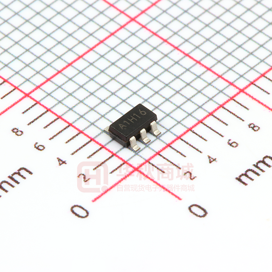

XC6206J302MR-G
XC6206J302MR-G
    TOREX(特瑞仕)
    SOT-25
    输出类型:固定 输出极性:正 最大输入电压:6V 输出电压:3V 输出电流:200mA 3.0V低功耗LDO,200mA,待机电流1μA,压差200mV@100mA
XC6206J302MR-G 数据手册
XC6206J Series ETR03085-001 Low Consumption Current Regulators ■GENERAL DESCRIPTION XC6206J series are highly precise, low noise, positive voltage LDO regulators manufactured using CMOS processes. The series achieves very low supply current, 1.0μA (TYP.) and consists of a reference voltage source, an error amplifier, current limit circuit, and a phase compensation circuit plus a driver transistor. The series is also compatible with low ESR ceramic capacitors (CL), which give added output stability. The current limiter’s fold-back circuit also operates as a short protect for the output current limiter and the output pin. ■APPLICATIONS ● Mobile devices / terminals ● Communication equipment (Bluetooth, Wi-Fi, GPS etc) ● Module (Communication ,Camera, etc) ● Cell phones ● Smartphones ■FEATURES External Capacitor Operating Ambient Temperature Package : 200mA : 200mV@IOUT=100mA (VOUT=3.0V) : 1.5V ~ 6.0V : 0.9 ~ 4.0V (0.1V increments) : 1.0μA (TYP.) : Current Limit 300mA (TYP.) Short Circuit Protection 50mA (TYP.) : 0.1μF~1.0μF : - 40℃~+85℃ : SOT-25-02 Environmentally Friendly : EU RoHS Compliant, Pb Free Maximum Output Current Dropout Voltage Operating Voltage Range Output Voltage Low Consumption Current Protection Circuit ■ TYPICAL APPLICATION CIRCUIT ■ TYPICAL PERFORMANCE CHARACTERISTICS ●Supply Current vs. Input Voltage XC6206J202MR-G Supply Current: ISS(uA) 3.0 Ta=-40℃ 2.5 Ta=25℃ 2.0 Ta=85℃ 1.5 1.0 0.5 0.0 0 1 2 3 4 5 6 Input Voltage: VIN(V) 1/16 XC6206J Series ■BLOCK DIAGRAM * Diodes inside the circuits are ESD protection diodes and parasitic diodes. ■PRODUCT CLASSIFICATION ●Ordering Information XC6206J①②③④⑤-⑥ DESIGNATOR ITEM SYMBOL ①② Output Voltage 09~40 ③ Output Voltage Accuracy 2 ④⑤-⑥ (*1) Package (Order Unit) MR-G (*1) DESCRIPTION Output voltage ex.) 3.0V ⇒ ①= 3, ②= 0 ±2% (VOUT(T)≧1.5V), ±30mV(VOUT(T)
