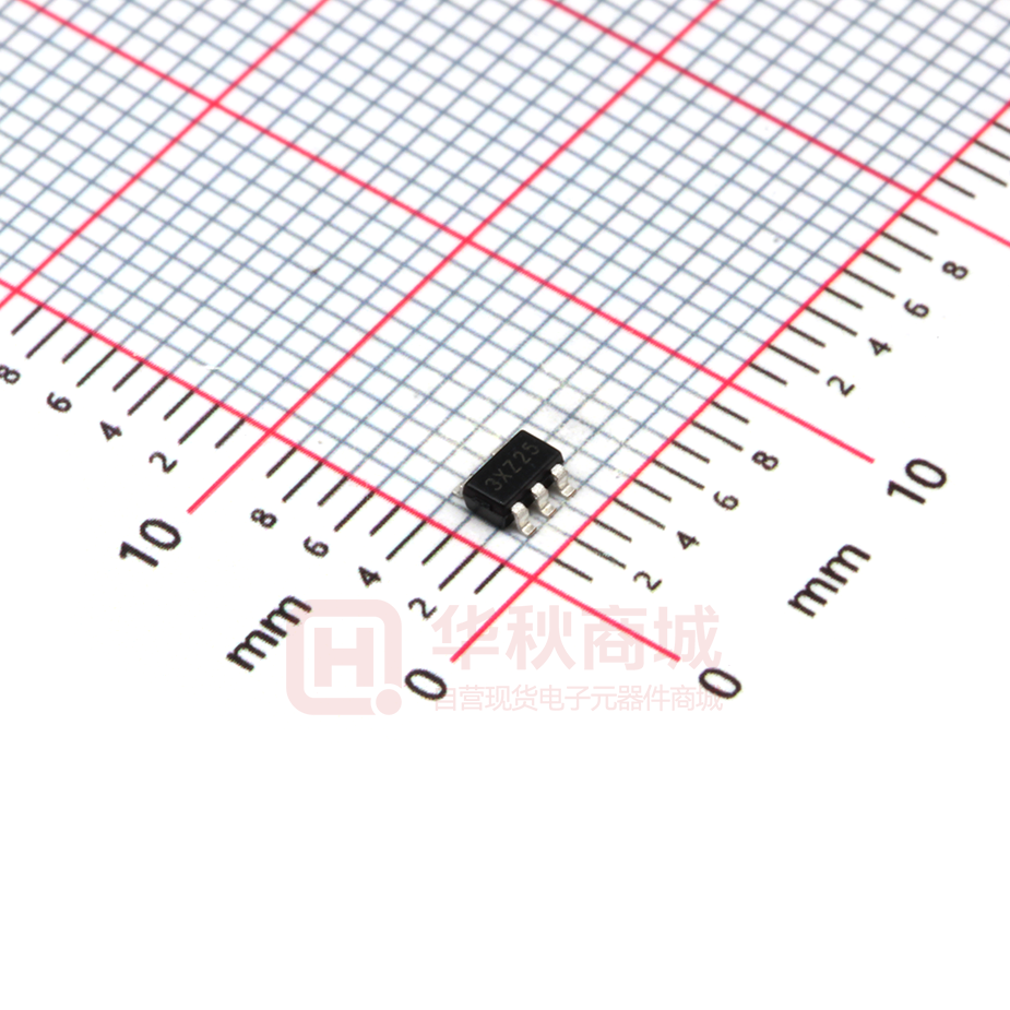

XC6221 Series ETR0328_015 ■GENERAL DESCRIPTION The XC6221 series is a high accuracy, low noise, high speed, low dropout CMOS regulator with high ripple rejection. The series includes a reference voltage source, an error amplifier, a current limiter, and a phase compensation circuit. The CE function enables the entire circuit to be in stand-by state by inputting low level signal. As for the XC6221B/D stand-by mode, the electric charge at the output capacitor (CL) will be discharged by the internal auto-discharge switch, and as a result the VOUT pin quickly returns to the VSS level. The output stabilization capacitor (CL) is also compatible with low ESR ceramic capacitors. Output voltage is selectable in 0.05V increments within a range of 0.80V~5.00V, using the laser trimming technology set in factory. The current limiter's fold-back circuit also operates as a short circuit protection and an output current limiter at the output pin. The series achieves a fast response with only 25μA of low power consumption. Also the series has low dropout voltage characteristics, which is 80mV at IOUT=100mA and VOUT=3.0V. With the use of small USP-4 and ultra small USPN-4 packages, a small footprint circuit can be designed. ■APPLICATIONS ■FEATURES ●Smart phones / Mobile phones Maximum Output Current Dropout Voltage Operating Voltage Range Output Voltage Range Accuracy ●Portable game consoles ●Digital still cameras / Camcorders ●Digital audio equipments ●Mobile devices / terminals Low Power Consumption Stand-by Current High Ripple Rejection CE Function : 200mA : 80mV@ IOUT=100mA,VOUT=3.0V : 1.6V ~ 6.0V : 0.80V~5.00V (0.05V increments) : +2% (VOUT >1.50V) (Standard) +30mV (VOUT≦1.45V) (Standard) +1% (VOUT >2.00V) (High Accuracy) +20mV (VOUT≦1.95V) (High Accuracy) : 25μA (TYP.) : Less than 0.1μA : 70dB @ 1kHz : CE Active High Standby current below 0.1μA CL High-Speed Auto-Discharge (XC6221B/D) CE Pin internally pulled-down (XC6221C/D) : 1.0μF ceramic capacitor Low ESR Capacitor Low Output Noise Operating Ambient Temperature : -40℃~+85℃ Packages : USP-4, SOT-25, SSOT-24 USPN-4 : EU RoHS Compliant, Pb Free Environmentally Friendly ■ TYPICAL PERFORMANCE CHARACTERISTICS ●Load Transient Response 1.9 XC6221x182 VIN=VCE=2.8V , Tr=Tf=5μs Ta=25℃ , CIN=CL=1.0μF (ceramic) 300 1.8 250 1.7 200 1.6 1.5 150 100mA Output Current 100 1.4 Output Current: I OUT (mA) Output Voltage Output Voltage: VOUT (V) ■TYPICAL APPLICATION CIRCUIT 50 10mA 1.3 0 Time: (500μs/div) 1/28 XC6221 Series ■PIN CONFIGURATION VSS 2 3 CE VOUT 1 4 VIN VOUT NC 5 4 1 2 3 VIN VSS CE USP-4 (BOTTOM VIEW) SOT-25 (TOP VIEW) VSS 2 3 CE VOUT 1 4 VIN VIN VOUT 4 3 1 2 CE VSS SSOT-24 (TOP VIEW) *It is recommended that the heat dissipation pad of the USP-4 package is soldered by using the reference mount pattern and metal mask pattern for mounting strength. USPN-4 (BOTTOM VIEW) The mount pattern should be electrically opened or connected to the VSS (No.2) pin. ■PIN ASSIGNMENT PIN NUMBER PIN NAME FUNCTIONS 4 VIN Power Input 3 1 VOUT Output 2 2 2 VSS Ground 3 3 1 3 CE ON/OFF Control - 4 - - NC No Connection USP-4 SOT-25 SSOT-24 USPN-4 4 1 4 1 5 2 ■CE PIN LOGIC CONDITION PIN NAME DESIGNATOR CONDITIONS H 1.2V≦VCE≦6.0V L VCE≦0.3V CE * VCE : CE pin voltage 2/28 XC6221 Series ■PIN FUNCTION ASSIGNMENT XC6221A/B (CE no pull-down resistor) CE LEVEL IC OPERATION HIGH LOW OPEN ON OFF Undefined state XC6221C/D (CE pull-down resistor) CE LEVEL IC OPERATION HIGH LOW OPEN ON OFF ■PRODUCT CLASSIFICATION ●Ordering Information XC6221 ①②③④⑤⑥-⑦(*1) DESIGNATOR ① ②③ ITEM Type of Regulator Output Voltage SYMBOL A No CE pull-down resistor without CL auto discharge B No CE pull-down resistor with CL auto discharge C CE pull-down resistor without CL auto discharge D CE pull-down resistor with CL auto discharge 08 ~ 50 2 A ④ Output Accuracy 1 B GR ⑤⑥-⑦(*1) Packages (Order Unit) DESCRIPTION ex.) VOUT= 3.00V → ② = 3, ③ = 0 +30mV @ 0.80V≦VOUT≦1.40V When 0.1V steps such as VOUT=0.80V → ②=0, ③=8, ④=2 +2% @ VOUT>1.50V When 0.1V steps such as VOUT=3.00V → ②=3, ③=0, ④=2 +30mV @ 0.85V≦VOUT≦1.45V When 0.05V steps such as VOUT=0.85V → ②=0, ③=8, ④=A +2% @ VOUT>1.55V When 0.05V steps such as VOUT=3.05V → ②=3, ③=0, ④=A +20mV @ 0.80V≦VOUT≦1.90V When 0.1V steps such as VOUT=0.80V → ②=0, ③=8, ④=1 +1% @ VOUT>2.00V When 0.1V steps such as VOUT= 3.00V → ②=3, ③=0, ④=1 +20mV @ 0.85V≦VOUT≦1.95V When 0.05V steps such as VOUT=0.85V → ②=0, ③=8, ④=B +1% @ VOUT>2.00V When 0.05V steps such as VOUT= 3.05V → ②=3, ③=0, ④=B USP-4 (3,000/Reel) GR-G USP-4 (3,000/Reel) MR SOT-25 (3,000/Reel) MR-G SOT-25 (3,000/Reel) NR SSOT-24 (3,000/Reel) NR-G SSOT-24 (3,000/Reel) 7R-G USPN-4 (5,000/Reel) (*1) The “-G” suffix indicates that the products are Halogen and Antimony free as well as being fully EU RoHS compliant. (*2) The range of the output voltage of USPN-4 package is 1.20V≦VOUT≦5.00V. 3/28 XC6221 Series ■BLOCK DIAGRAMS ON/OFF Control CE V IN CE CE/ Error Amp ON/OFF Control CE - Current Limit CE + each circuit V IN CE/ V OUT Error Amp Current Limit + each circuit V OUT R1 R1 Rdischg CE/ R2 R2 Voltage Reference Voltage Reference V SS ●XC6221A Series XC6221Aシリーズ ●XC6221B Series XC6221Bシリーズ ON/OFF CE V IN Control ON/OFF CE CE/ R Pull -down Error Amp Current Limit CE + each circuit V IN Control R Pull -down CE V SS CE/ V OUT Error Amp Current Limit + each circuit V OUT R1 R1 Rdischg CE/ R2 R2 Voltage Reference Voltage Reference V SS ●XC6221C Series XC6221Cシリーズ V SS ●XC6221D Series XC6221Dシリーズ *Diodes inside the circuit are an ESD protection diode and a parasitic diode. ■ABSOLUTE MAXIMUM RATINGS Ta=25℃ UNITS PARAMETER SYMBOL RATINGS Input Voltage Output Current VIN IOUT VSS -0.3 ~ +6.5 400(*1) V mA Output Voltage VOUT VSS – 0.3 ~ VIN + 0.3 V CE Input Voltage VCE VSS – 0.3 ~ +6.5 120 1000(PCB mounted)(*2) 250 (*2) 600(PCB mounted) 150 500(PCB mounted)(*2) 100 (*2) 600(PCB mounted) - 40 ~ + 85 - 55 ~ +125 V USP-4 SOT-25 Power Dissipation Pd SSOT-24 USPN-4 Operating Ambient Temperature Storage Temperature Topr Tstg mW ℃ ℃ *1 IOUT≦Pd / (VIN-VOUT) *2 These values are example data which is taken with the PCB mounted. Please refer to pages 21 to 24 for details. 4/28 XC6221 Series ■ELECTRICAL CHARACTERISTICS ●XC6221A/B/C/D series Ta=25℃ PARAMETER SYMBOL Output Voltage (Standard) VOUT(E) Output Voltage (High Accuracy) VOUT(E) Output Current IOUTMAX Load Regulation CONDITIONS 1.50V
