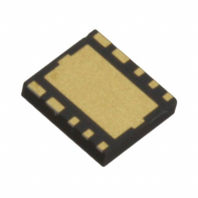

XC9242/XC9243 Series ETR0521-012 2A Synchronous Step-Down DC/DC Converters ☆GreenOperation Compatible ■GENERAL DESCRIPTION The XC9242/XC9243 series is a group of synchronous-rectification step-down DC/DC converters with a built-in 0.11Ω (TYP.) P-channel MOS driver transistor and 0.12Ω(TYP.) N-channel MOS switching transistor, designed to allow the use of ceramic capacitors. The small on-resistances of these two internal driver transistors enable a high efficiency, stable power supply with an output current up to 2A. The XC9242/XC9243 series has operating voltage range of 2.7V~6.0V and a 0.8V (±2.0%) reference voltage, and using externally connected resistors, the output voltage can be set freely from 0.9V. With an internal switching frequency of 1.2MHz or 2.4MHz, small external components can be used. The XC9242 series is PWM control, and the XC9243 series is PWM/PFM, which automatically switches from PWM to PFM during light loads and provides high efficiency, high load response, low voltage ripple, can be achieved over a wide range of load conditions. The series have a high speed soft-start as fast as 1ms in typical for quick turn-on. It’s suitable for large-current application due to limit current is configured 4.0A in typical. During stand-by, all circuits are shutdown to reduce current consumption to as low as 1.0μA or less. The integrated CL discharge function which enables the electric charge at the output capacitor CL to be discharged via the internal discharge switch located between the LX and VSS pins. Due to CL discharge function, malfunction on LX is prevented when Stand-by mode. With the built-in UVLO (Under Voltage Lock Out) function, the internal P-channel driver transistor is forced OFF when input voltage becomes 2.5V or lower. The series are available in USP-10B, SOP-8FD packages. ■APPLICATIONS ● ● ● ● ● Smart phones / Mobile phones Bluetooth Mobile devices / terminals Portable game consoles Digital still cameras / Camcorders ■FEATURES Driver Transistor : Input Voltage Range Output Voltage Setting FB Voltage High Efficiency Output Current Oscillation Frequency Maximum Duty Cycle Functions : : : : : : : : Output Capacitor Control Methods : : Operating Ambient Temperature Packages Environmentally Friendly : : : 0.11Ω P-ch Driver Transistor 0.12Ω N-ch Switching Transistor 2.7V∼6.0V 0.9V∼VIN 0.8V±2.0% 95%(TYP.)* 2.0A 1.2MHz±15%, 2.4MHz±15% 100% Soft-Start Circuit Built-In CL Discharge Current Limit Circuit(automatic return) Thermal Shutdown UVLO Low ESR Ceramic Capacitor PWM control (XC9242) PWM/PFM Auto (XC9243) -40℃ ~ +85℃ USP-10B, SOP-8FD EU RoHS Compliant, Pb Free * Performance depends on external components and wiring on the PCB. ■TYPICAL APPLICATION CIRCUIT ■TYPICAL PERFORMANCE CHARACTERISTICS ●Efficiency vs. Output Current (fosc=1.2MHz, VOUT=3.3V) ●XC9242/XC9243 Series (FB Type) XC9242B 08C L=4.7μH(SLF7055),CIN1 =20μF(LMK212ABJ106KGx2) CIN2 =1μF(LMK107BJ105KAx1),CL =20μF(LMK212ABJ106KGx2) RFB1 =47kΩ, RFB2 =15kΩ, CFB=330pF 100 90 Efficiency: EFFI (%) 80 70 60 VIN=5.0V 50 40 30 20 10 0 0.1 1 10 100 1000 10000 Output Current: I OUT (mA) 1/29 XC9242/XC9243 Series ■BLOCK DIAGRAM ●XC9242/XC9243 Series * Diodes inside the circuits are ESD protection diodes and parasitic diodes. ■ PRODUCT CLASSIFICATION ●Ordering Information XC9242①②③④⑤⑥-⑦ (*1) Fixed PWM control XC9243①②③④⑤⑥-⑦ (*1) PWM / PFM automatic switching control (*1) (*2) DESIGNATOR ITEM SYMBOL ① ②③ Functional Selection Output Voltage ④ Oscillation Frequency ⑤⑥-⑦(*1) Package (Order Unit) B 08 C D DR-G QR-G DESCRIPTION CL Discharge Reference Voltage is fixed at 0.8V 1.2MHz 2.4MHz USP-10B (3,000/Reel)(*2) SOP-8FD (1,000/Reel) The “-G” suffix denotes Halogen and Antimony free as well as being fully EU RoHS compliant. The USP-10B reels are shipped in a moisture-proof packing. Selection Guide 2/29 TYPE SOFT-START TIME CHIP ENABLE CURRENT LIMITER THERMAL SHUTDOWN UVLO CL AUTODISCHARGE B Fixed Yes Yes Yes Yes Yes XC9242/XC9243 Series ■PIN CONFIGURATION LX 1 8 LX PGND 2 7 PVIN FB 3 6 AVIN AGND 4 5 CE USP-10B (BOTTOM VIEW) SOP-8FD (TOP VIEW) SOP-8FD (TOP VIEW) USP-10B * Please connect the power input pins (No.8 and No.9) and analog input pin (No.7) when operating. * Please connect the two Lx pins (No.1 and 10). * Please connect the power ground pins (No.2 and 3) and analog ground pin (No.5) when operating. * It is recommended that the heat dissipation pad of the USP-10B package is soldered by using the reference mount pattern and metal mask pattern for mounting strength. The mount pattern should be electrically opened or connected to AGND pin (No.5) and PGND pin (No.2, and 3). SOP-8FD * Please connect the power input pin (No.7) and analog input pin (No.6) when operating. * Please connect the two Lx pins (No.1 and 8). * Please connect the two power ground pins (No.2 and 4). * It is recommended that the heat dissipation pad of the SOP-8FD package is soldered by using the reference mount pattern and metal mask pattern for mounting strength. The mount pattern should be electrically opened or connected to AGND pin (No.6) and PGND pin (No.7). ■ PIN ASSIGNMENT PIN NUMBER USP-10B SOP-8FD 1,10 2,3 4 5 6 7 8,9 1,8 2 3 4 5 6 7 PIN NAME FUNCTIONS Lx PGND FB AGND CE AVIN PVIN Switching Output Power Ground Output Voltage Monitor Analog Ground Chip Enable Analog Input Power Input ■ CE PIN FUNCTION PIN NAME CE SIGNAL STATUS H Active L Stand-by * Please do not leave the CE pin open. 3/29 XC9242/XC9243 Series ■ ABSOLUTE MAXIMUM RATINGS Ta=25℃ PARAMETER PVIN Pin Voltage AVIN Pin Voltage CE Pin Voltage FB Pin Voltage Lx Pin Voltage Lx Pin Current USP-10B Power Dissipation SOP-8FD Operating Ambient Temperature Storage Temperature SYMBOL RATINGS UNIT VPVIN VAVIN VCE VFB VLx ILx Pd Pd Topr Tstg -0.3 ~ +7.0(*1) V -0.3 ~ +7.0 -0.3 ~ +7.0 -0.3 ~ +7.0 or VPVIN +0.3 (*2) (*3) ±6.0 150 300 -40 ~ +85 -55 ~ +125 V V V A mW mW ℃ ℃ All voltages are described based on the ground voltage of AGND and PGND. (*1) Please connect PVIN pin and AVIN pin for use. (*2) The maximum value should be either +7.0 or VPVIN+0.3 in the lowest. (*3) It is measured when the two Lx pins (USP-10B No.1 and 10, SOP-8FD No.1 and 8) are tied up to each other. 4/29 XC9242/XC9243 Series ■ ELECTRICAL CHARACTERISTICS ●XC9242/XC9243, fOSC=1.2MHz, Ta=25℃ PARAMETER SYMBOL CONDITIONS MIN TYP. MAX. UNIT CIRCUIT 0.784 0.800 0.816 V ③ 2.7 - 6.0 V ① 2.0 - - A ① 2.00 - 2.68 V ③ VIN=VCE=5.0V, VFB=0.88V - 41 78 μA ② VIN=5.0V, VCE=0V, VFB=0.88V - 0.01 1.00 μA ② 1020 1200 1380 kHz ① - 280 - mA ① - 180 250 % ① 100 - - 0 % % ③ ③ - 95 - % ① - 0.11 0.21 Ω ④ - 0.12 0.30 (*7) Ω - - 0.01 1.00 (*8) μA ⑤ - 4.0 - A ④ - ±100 - ppm/℃ ① 1.2 - VIN V ③ AGND - 0.4 V ③ -0.1 -0.1 -0.1 -0.1 - 0.1 0.1 0.1 0.1 μA μA μA μA ⑤ ⑤ ⑤ ⑤ 0.3 1.0 2.0 ms ① - 150 - ℃ - 80 20 130 160 ℃ Ω ⑥ FB Voltage VFB VIN= 5.0V, VCE =5.0V Voltage to start oscillation while VFB=0.72V → 0.88V Operating Voltage Range VIN When connected to external components (*1,*2) Maximum Output Current IOUTMAX UVLO Voltage VUVLO Quiescent Current Iq Stand-by Current ISTB Oscillation Frequency fOSC PFM Switch Current PFM Duty Limit (*4) (*4) IPFM DTYLIMIT_PFM Maximum Duty Limit Minimum Duty Limit DMAX DMIN Efficiency EFFI LXSW”H”ON Resistance RLxH LXSW”L”ON Resistance RLxL LXSW”H” Leakage Current ILeakH Current Limit Output Voltage Temperature Characteristics ILIM ΔVOUT/ (VOUT・Δtopr) CE”H” Voltage VCEH CE”L” Voltage VCEL CE”H” Current CE”L” Current FB”H” Current FB”L” Current ICEH ICEL IFBH IFBL Soft-Start Time tSS Thermal Shutdown Temperature Hysteresis Width CL Discharge VIN=VCE=5.0V When connected to external components VCE=5.0V, VFB=0.72V (*3) Voltage which Lx pin holding ”L” level VIN=VCE=5.0V, IOUT=300mA When connected to external components VIN=VCE=4.0V, IOUT=1mA When connected to external components VIN=VCE=2.7V, IOUT=1mA When connected to external components VIN=VCE=5.0V, VFB=0.72V VIN=VCE=5.0V, VFB=0.88V (*5) VIN=VCE=5.0V, IOUT=500mA RFB1=47kΩ, RFB2=15kΩ, CFB=330pF VIN=VCE=4.0V, VFB=0.72V (*6) VIN=5.0V, VCE=0V, VFB=0.88V, VLx=0V (*9) VIN=VCE=5.0V, VFB=0.72V IOUT=100mA -40℃≦Topr≦85℃ When connected to external components VIN=5.0V, VFB=0.72V Applied voltage to VCE Voltage changes Lx to “H” level VIN=5.0V, VFB=0.72V Applied to VCE Voltage changes Lx to “L” level VIN=5.0V, VCE=5.0V, VFB=0V VIN=5.0V, VCE=0V, VFB=0V VIN=5.0V, VCE=0V, VFB=5.0V VIN=5.0V, VCE=0V, VFB=0V VIN=5.0V, VCE=0V→5.0V, IOUT=1mA When connected to external components TTSD THYS RDCHG VIN=5.0V, VCE=0V, VFB=0.72V, VLx=1.0V NOTE: External Components: CIN1=20μF(ceramic), CIN2=1μF(ceramic), L=4.7μH(SLF7055T-4R7 TDK), CL=20μF(ceramic) RFB1=15kΩ, RFB2=30kΩ, CFB=1000pF Condition: Unless otherwise stated, ”H”=VIN ~ VIN - 1.2V, “L”=+ 0.1V ~ -0.1V (*1) Mount conditions affect heat dissipation. Maximum output current is not guaranteed when TTSD starts to operate earlier. (*2) When the difference between the input and the output is small, some cycles may be skipped completely before current maximizes. If current is further pulled from this state, output voltage will decrease because of P-ch driver ON resistance. (*3) These values include UVLO detect voltage, UVLO release voltage and hysteresis operating voltage range. UVLO release voltage is defined as the VIN voltage which makes Lx pin “H”. (*4) XC9242 series exclude IPFM and DTYLIMIT_PFM because those are only for the PFM control’s functions. (*5) EFFI = { ( output voltage×output current ) / ( input voltage×input current) }×100 (*6) On resistance = (VIN – Lx pin measurement voltage) / 100mA (*7) Design value (*8) When temperature is high, a current of approximately 20μA (maximum) may leak. (*9) Current limit denotes the level of detection at peak of coil current. 5/29 XC9242/XC9243 Series ■ ELECTRICAL CHARACTERISTICS (Continued) XC9242/XC9243, fOSC=2.4MHz, Ta=25℃ PARAMETER SYMBOL CONDITIONS MIN. TYP. MAX. UNIT CIRCUIT 0.784 0.800 0.816 V ③ 2.7 - 6.0 V ① 2.0 - - A ① 2.00 - 2.68 V ③ VIN=VCE=5.0V, VFB=0.88V - 53 92 μA ② VIN=5.0V, VCE=0V, VFB=0.88V - 0.01 1.00 μA ② 2040 2400 2760 kHz ① - 680 - mA ① - 180 250 % ① VIN= VCE =5.0V FB Voltage VFB Voltage to start oscillation while VFB=0.72V → 0.88V Operating Voltage Range VIN Maximum Output Current IOUTMAX UVLO Voltage VUVLO Quiescent Current Iq Stand-by Current ISTB Oscillation Frequency PFM Switch Current PFM Duty Limit (*4) (*4) fOSC IPFM DTYLIMIT_PFM When connected to external components VIN=VCE=5.0V (*1,*2) When connected to external components VCE=5.0V, VFB=0.72V Voltage which Lx pin holding ”L” level (*3) VIN=VCE=5.0V, IOUT=1000mA When connected to external components VIN=VCE=6.0V, IOUT=1mA When connected to external components VIN=VCE=2.7V, IOUT=1mA When connected to external components Maximum Duty Limit DMAX VIN=VCE=5.0V, VFB=0.72V 100 - - % ③ Minimum Duty Limit DMIN VIN=VCE=5.0V, VFB=0.88V - - 0 % ③ - 95 - % ① - 0.11 0.21 Ω ④ Efficiency LXSW”H”ON Resistance EFFI RLXH LXSW”L”ON Resistance RLXL LXSW”H” Leakage Current ILeakH Current Limit ILIM Output Voltage Temperature Characteristics ΔVOUT/ (VOUT・Δtopr) VIN=VCE=5.0V, IOUT=500mA (*5) RFB1=47kΩ, RFB2=15kΩ, CFB=330pF VIN=VCE=4.0V, VFB=0.72V (*6) VIN=5.0V, VCE=0V, VFB=0.88V, VLx=0V VIN=VCE=5.0V, VFB=0.72V (*9) - 0.12 0.30 (*7) - 0.01 1.00 (*8) - 4.0 - A ④ - ±100 - ppm/℃ ① 1.2 - VIN V ③ AGND - 0.4 V ③ Ω - μA ⑤ IOUT=100mA -40℃≦Topr≦85℃ When connected to external components VIN=5.0V, VFB=0.72V CE”H” Voltage VCEH CE”L” Voltage VCEL CE”H” Current ICEH VIN=5.0V, VCE=5.0V, VFB=0V -0.1 - 0.1 μA ⑤ CE”L” Current ICEL VIN=5.0V, VCE=0V, VFB=0V -0.1 - 0.1 μA ⑤ FB”H” Current IFBH VIN=5.0V,VCE=0V, VFB=5.0V -0.1 - 0.1 μA ⑤ FB”L” Current IFBL VIN=5.0V,VCE=0V, VFB=0V -0.1 - 0.1 μA ⑤ 0.3 1.0 2.0 ms ① - 150 - ℃ - Soft-Start Time Thermal Shutdown Temperature tSS Applied voltage to VCE Voltage changes Lx to “H” level VIN=5.0V, VFB=0.72V Applied voltage to VCE Voltage changes Lx to “L” level VIN=5.0V, VCE=0V→5.0V, IOUT=1mA When connected to external components TTSD Hysteresis Width THYS CL Discharge RDCHG VIN=5.0V, VCE=0V, VFB=0.72V, VLx=1.0V - 20 - ℃ - 80 130 160 Ω ⑥ NOTE: External Components: CIN1=20μF(ceramic), CIN2=1μF(ceramic), L=2.2μH(SLF7055T-2R2 TDK), CL=20μF(ceramic) RFB1=15kΩ, RFB2=30kΩ, CFB=1000pF Condition: Unless otherwise stated, ”H”= VIN ~ VIN - 1.2V, “L”= + 0.1V ~ -0.1V (*1) Mount conditions affect heat dissipation. Maximum output current is not guaranteed when TTSD starts to operate earlier. (*2) When the difference between the input and the output is small, some cycles may be skipped completely before current maximizes. If current is further pulled from this state, output voltage will decrease because of P-ch driver ON resistance. (*3) These values include UVLO detect voltage, UVLO release voltage and hysteresis operating voltage range. UVLO release voltage is defined as the VIN voltage which makes Lx pin “H”. (*4) XC9242 series exclude IPFM and DTYLIMIT_PFM because those are only for the PFM control’s functions. (*5) EFFI = { ( output voltage×output current ) / ( input voltage×input current) }×100 (*6) On resistance = (VIN – Lx pin measurement voltage) / 100mA (*7) Design value (*8) When temperature is high, a current of approximately 20μA (maximum) may leak. (*9) Current limit denotes the level of detection at peak of coil current. 6/29 XC9242/XC9243 Series ■TYPICAL APPLICATION CIRCUIT ●XC9242/XC9243 Series External Components 1.2MHz L: 2.4MHz L: 4.7μH(SLF7055T-4R7) 2.2μH(SLF7055T-2R2) 4.7μH(SPM6530T-4R7) CIN1: 2.2μH(SPM6530T-2R2) 20μF (LMK212ABJ106KG 10V/10μF x2) CIN1: 20μF (LMK212ABJ106KG 10V/10μF x2) CIN2 1μF (LMK107BJ105KA 10V/1μF x1) CIN2 1μF (LMK107BJ105KA 10V/1μF x1) CL: 20μF (LMK212ABJ106KG 10V/10μF x2) CL: 20μF (LMK212ABJ106KG 10V/10μF x2) Output voltage can be set by adding external split resistors. Output voltage is determined by the following equation, based on the values of RFB1 and RFB2. The sum of RFB1 and RFB2 should normally be 100kΩ or less. reference voltage. When input voltage (VIN) ≦setting output voltage, output voltage (VOUT) can not output the power more than input voltage Output voltage range is 0.9V~5.5V by a 0.8V (±2.0%) (VIN). VOUT = 0.8 x (RFB1 + RFB2) / RFB2 The value of CFB, speed-up capacitor for phase compensation, should be fZFB= 1 / (2 x π x CFB x RFB1) which is equal to 10kHz. Adjustments are required from 1kHz to 10kHz depending on the application, value of inductance (L), and value of load capacitance (CL). [Example of calculation] When RFB1=47kΩ, RFB2=15kΩ, VOUT=0.8×(47kΩ+15kΩ) / 15kΩ =3.3V When CFB=330pF, fzfb= 1/(2×π×330pF×47 kΩ) =10.26kHz VOUT (V) RFB1 (kΩ) RFB2 (kΩ) CFB (pF) VOUT (V) RFB1 (kΩ) RFB2 (kΩ) CFB (pF) 1.0 1.2 1.5 1.8 7.5 15 26 30 30 30 30 24 2000 1000 560 510 2.5 3.0 3.3 5.0 51 33 47 43 24 12 15 8.2 300 470 330 390 7/29 XC9242/XC9243 Series ■ OPERATIONAL DESCRIPTION The XC9242/XC9243 series consists of a reference voltage source, ramp wave circuit, error amplifier, PWM comparator, phase compensation circuit, output voltage adjustment resistors, P-channel MOS driver transistor, N-channel MOS switching transistor for the synchronous switch, current limiter circuit, UVLO circuit and others. (See the block diagram above.) The series ICs compare, using the error amplifier, the voltage of the internal voltage reference source with the feedback voltage from the FB pin. Phase compensation is performed on the resulting error amplifier output, to input a signal to the PWM comparator to determine the turn-on time during PWM operation. The PWM comparator compares, in terms of voltage level, the signal from the error amplifier with the ramp wave from the ramp wave circuit, and delivers the resulting output to the buffer driver circuit to cause the Lx pin to output a switching duty cycle. ensure stable output voltage. This process is continuously performed to The current feedback circuit monitors the P-channel MOS driver transistor current for each switching operation, and modulates the error amplifier output signal to provide multiple feedback signals. This enables a stable feedback loop even when a low ESR capacitor such as a ceramic capacitor is used ensuring stable output voltage. The reference voltage source provides the reference voltage to ensure stable output voltage of the DC/DC converter. The ramp wave circuit determines switching frequency. The frequency is fixed internally and can be selected from 1.2MHz or 2.4MHz. Clock pulses generated in this circuit are used to produce ramp waveforms needed for PWM operation, and to synchronize all the internal circuits. The error amplifier is designed to monitor output voltage. the external split resistors, R1 and R2. increases. The amplifier compares the reference voltage with the feedback voltage divided by When a voltage lower than the reference voltage is fed back, the output voltage of the error amplifier The gain and frequency characteristics of the error amplifier output are fixed internally to deliver an optimized signal to the mixer. The XC9242/XC0243 series includes a fold-back circuit, which aids the operation of the current limiter and circuit protection. The XC9242/XC9243 series monitors the current flowing through the P-channel MOS driver transistor ①When current flowing through P-channel MOS driver transistor reaches current limit ILIM, the current limiter circuit operates to limit the inductor current ILX. If this state continues, the fold-back circuit operates and limit the output current in order to protect the IC from damage. ②The output voltage is automatically resumed if the load goes light. 8/29 When it is resumed, the soft-start function operates. XC9242/XC9243 Series ■OPERATIONAL DESCRIPTION (Continued) For protection against heat damage, the thermal shutdown function monitors chip temperature. When the chip’s temperature reaches O 150 C (TYP.), the thermal shutdown circuit starts operating and the P-channel driver transistor will be turned off. At the same time, the output O voltage decreases. When the temperature drops to 130 C (TYP.) after shutting off the current flow, the IC performs the soft start function to initiate output startup operation. < Function of CE pin > The XC9242/9243 series will enter into stand-by mode by inputting a low level signal to the CE pin. During a stand-by mode, the current consumption of the IC becomes 0μA (TYP.). The IC starts its operation by inputting a high level signal to the CE pin. The input of the CE pin is a CMOS input and the sink current is 0μA (TYP.). When the VIN pin voltage becomes 2.4V (TYP.) or lower, the P-channel MOS driver transistor output driver transistor is forced OFF to prevent false pulse output caused by unstable operation of the internal circuitry. When the VIN pin voltage becomes 2.68V (MAX.) or higher, switching operation takes place. By releasing the UVLO function, the IC performs the soft start function to initiate output startup operation. The soft start function operates even when the VIN pin voltage falls momentarily below the UVLO operating voltage. The UVLO circuit does not cause a complete shutdown of the IC, but causes pulse output to be suspended; therefore, the internal circuitry remains in operation. The XC9242/XC9243 series provide 1.0ms (TYP). Soft start time is defined as the time interval to reach 90% of the output voltage from the time when the VCE is turned on. The XC9242/XC9243 series can quickly discharge the electric charge at the output capacitor (CL) when a low signal to the CE pin which enables a whole IC circuit put into OFF state, is inputted via the N-channel MOS switch transistor located between the LX pin and the VGND pin. When the IC is disabled, electric charge at the output capacitor (CL) is quickly discharged so that it may avoid application malfunction. Discharge time of the output capacitor (CL) is set by the CL auto-discharge resistance (R) and the output capacitor (CL). By setting time constant of a CL auto-discharge resistance value [R] and an output capacitor value (CL) as τ(τ=C x R), discharge time of the output voltage after discharge via the N-channel transistor is calculated by the following formulas. V = VOUT(E)×e -t /τ or t = τln (VOUT(E) /V) V : Output voltage after discharge VOUT(E) : Output voltage t: Discharge time τ: CL×RDCHG CL : Capacitance of Output capacitor RDCHG : CL auto-discharge resistance Output Voltage Dischage characteristics RDCHG = 130Ω(TYP.) Rdischg CL=20μF 5.0 4.5 Output Voltage: V OUT (V) 4.0 3.5 3.0 2.5 VOUT =1.2V VOUT = 1.2V 2.0 VOUT VOUT =1.8V = 1.8V 1.5 VOUT =3.3V VOUT = 3.3V 1.0 0.5 0.0 0 2 4 6 8 10 12 14 16 18 20 Discharge Time: t(ms) 9/29 XC9242/XC9243 Series ■OPERATIONAL DESCRIPTION (Continued) (*1) In PFM control operation, until coil current reaches to a specified level (IPFM), the IC keeps the P-channel MOS driver transistor on. case, time that the P-channel MOS driver transistor is kept on (tON) can be given by the following formula. Please refer to IPFM① tON = L × IPFM / (VIN - VOUT) In this (*1) < PFM Duty Limit > In PFM control operation, the PFM duty limit (DTYLIMIT_PFM) is set to 200% (TYP.). Therefore, under the condition that the duty increases (e.g. the condition that the step-down ratio is small), it’s possible for P-channel MOS driver transistor to be turned off even when coil current doesn’t reach to IPFM. (*1) Please refer to IPFM② XC9242 Series is excluded. Fig. 10/29 Fig. XC9242/XC9243 Series ■NOTE ON USE 1. 2. 3. 4. 5. Please use this IC within the stated maximum ratings. For temporary, transitional voltage drop or voltage rising phenomenon, the IC is liable to malfunction should the ratings be exceeded. Where wiring impedance is high, operations may become unstable due to noise and/or phase lag depending on output current. Please wire the input capacitor (CIN) and the output capacitor (CL) as close to the IC as possible. When the difference between VIN and VOUT is large in PWM control, very narrow pulses will be outputted, and there is the possibility that some cycles may be skipped completely. When the difference between VIN and VOUT is small, and the load current is heavy, very wide pulses will be outputted and there is the possibility that some cycles may be skipped completely. With the IC, the peak current of the coil is controlled by the current limit circuit. Since the peak current increases when dropout voltage or load current is high, current limit starts operation, and this can lead to instability. When peak current becomes high, please adjust the coil inductance value and fully check the circuit operation. In addition, please calculate the peak current according to the following formula: Ipk = (VIN-VOUT)×OnDuty / (2×L×fOSC) + IOUT L : Coil Inductance Value fOSC: Oscillation Frequency 6. Use of the IC at voltages below the recommended voltage range may lead to instability. 7. This IC should be used within the stated absolute maximum ratings in order to prevent damage to the device. 8. When the IC is used in high temperature, output voltage may increase up to input voltage level at no load because of the leak current of the P-channel driver transistor. 9. The XC9242/XC9243 uses fold-back circuit limiter. However, fold-back may become “droop” affected by the wiring conditions. Care must be taken especially for CIN distance and position. 10. If CL capacitance reduction happens such as in the case of low temperature, the IC may enter unstable operation. Care must be taken for CL capacitor selection and its capacitance value. Ta = - 50 ℃ VIN = 3.6V, VOUT = 0.9V, fOSC = 2.4MHz 1ch VLx :2.0V/di v CIN = 20 μF(Ceramic) CL = 14.7μF(Ceramic) IOUT = 300mA 2ch VOUT :50mV/di v x-axis : 2.0μs / div 11. Torex places an importance on improving our products and its reliability. However, by any possibility, we would request user fail-safe design and post-aging treatment on system or equipment. 11/29 XC9242/XC9243 Series ■NOTE ON USE (Continued) ●Instructions of pattern layouts 1. 2. 3. 4. 5. 6. In order to stabilize VIN voltage level, we recommend that a by-pass capacitor (CIN) be connected as close as possible to the PVIN & PGND pins and the AVIN & AGND pins. Make sure to avoid noise from the PVIN pin to the AVIN pin. Please connect the AGND pin and PGND pin in the shortest length for wiring. Please mount each external component as close to the IC as possible. Wire external components as close to the IC as possible and use thick, short connecting traces to reduce the circuit impedance. This series’ internal driver transistors bring on heat because of the output current and ON resistance of P-channel and N-channel MOS driver transistors. Make sure that the PCB GND traces are as thick as possible, as variations in ground potential caused by high ground currents at the time of switching may result in instability of the IC. st nd 1 Layer(USP-10B) 2 Layer(USP-10B) rd th 3 Layer(USP-10B) 4 Layer(USP-10B) ●PCB (USP-10B) ●Typical Application Circuit (USP-10B) 1) XC9242/XC9243 Series 1) XC9242/XC9243 Series US P- 10B 12/29 XC9242/XC9243 Series ■NOTE ON USE (Continued) st 1 Layer(SOP-8FD) rd 3 Layer(SOP-8FD) nd 2 Layer(SOP-8FD) th 4 Layer(SOP-8FD) ●PCB(SOP8-FD) Typical Application Circuit(SOP8-FD) 1) XC9242/XC9243 Series 1) XC9242/XC9243 Series 13/29 XC9242/XC9243 Series ■TEST CIRCUITS 14/29 XC9242/XC9243 Series ■TYPICAL PERFORMANCE CHARACTERISTICS (1) Efficiency vs. Output Current XC9242B08C (VOUT=1.2V) XC9243B08C (VOUT=1.2V) L=4.7μH(SLF7055),CIN=20μF(LMK212ABJ106KGx2) CIN=1μF(LMK107BJ105KAx1),CL=20μF(LMK212ABJ106KGx2) RFB1=15kΩ, RFB2=30kΩ, CFB=1000pF 100 90 80 70 60 50 40 30 20 10 0 VIN=3.7V Efficiency: EFFI (%) Efficiency: EFFI (%) L=4.7μH(SLF7055),CIN=20μF(LMK212ABJ106KGx2) CIN=1μF(LMK107BJ105KAx1),CL=20μF(LMK212ABJ106KGx2) RFB1=15kΩ, RFB2=30kΩ, CFB=1000pF VIN=5.0V 0.1 1 10 100 1000 Output Current: IOUT (mA) 100 90 80 70 60 50 40 30 20 10 0 10000 VIN=5.0V VIN=3.7V 0.1 XC9242B08D (VOUT=1.2V) 1 10 100 1000 Output Current: IOUT (mA) XC9243B08D (VOUT=1.2V) L=2.2μH(SLF7055),CIN=20μF(LMK212ABJ106KGx2) CIN=1μF(LMK107BJ105KAx1),CL=20μF(LMK212ABJ106KGx2) RFB1=15kΩ, RFB2=30kΩ, CFB=1000pF L=2.2μH(SLF7055),CIN=20μF(LMK212ABJ106KGx2) CIN=1μF(LMK107BJ105KAx1),CL=20μF(LMK212ABJ106KGx2) RFB1=15kΩ, RFB2=30kΩ, CFB=1000pF 100 100 90 90 80 VIN=3.7V 70 60 Efficiency: EFFI (%) Efficiency: EFFI (%) 80 10000 VIN=5.0V 50 40 30 70 60 VIN=3.7V 40 30 20 20 10 10 0 VIN=5.0V 50 0 0.1 1 10 100 1000 10000 0.1 1 Output Current: IOUT (mA) 10 100 1000 Output Current: IOUT (mA) 10000 (2) Output Voltage vs. Output Current XC9242B08C (VOUT=1.2V) XC9243B08C (VOUT=1.2V) L=4.7μH(SLF7055),CIN=20μF(LMK212ABJ106KGx2) CIN=1μF(LMK107BJ105KAx1),CL=20μF(LMK212ABJ106KGx2) RFB1=15kΩ, RFB2=30kΩ, CFB=1000pF L=4.7μH(SLF7055),CIN=20μF(LMK212ABJ106KGx2) CIN=1μF(LMK107BJ105KAx1),CL=20μF(LMK212ABJ106KGx2) RFB1=15kΩ, RFB2=30kΩ, CFB=1000pF 1.4 Output Voltage: VOUT (V) Output Voltage: VOUT (V) 1.4 1.3 1.2 VIN=3.7V, 5.0V 1.1 1 1.3 1.2 VIN=3.7V, 5.0V 1.1 1 0.1 1 10 100 1000 Output Current: IOUT (mA) 10000 0.1 1 10 100 1000 Output Current: IOUT (mA) 10000 15/29 XC9242/XC9243 Series ■TYPICAL PERFORMANCE CHARACTERISTICS (Continued) (2) Output Voltage vs. Output Current XC9242B08D (VOUT=1.2V) XC9243B08D (VOUT=1.2V) L=2.2μH(SLF7055),CIN=20μF(LMK212ABJ106KGx2) CIN=1μF(LMK107BJ105KAx1),CL=20μF(LMK212ABJ106KGx2) RFB1=15kΩ, RFB2=30kΩ, CFB=1000pF L=2.2μH(SLF7055),CIN=20μF(LMK212ABJ106KGx2) CIN=1μF(LMK107BJ105KAx1),CL=20μF(LMK212ABJ106KGx2) RFB1=15kΩ, RFB2=30kΩ, CFB=1000pF 1.4 Output Voltage: VOUT (V) Output Voltage: VOUT (V) 1.4 1.3 1.2 VIN=3.7V, 5.0V 1.1 1 0.1 1 10 100 1000 1.3 1.2 VIN=3.7V, 5.0V 1.1 1 10000 0.1 Output Current: IOUT (mA) 1 10 100 1000 Output Current: IOUT (mA) 10000 (3) Ripple Voltage vs. Output Current XC9242B08C (VOUT=1.2V) XC9243B08C (VOUT=1.2V) L=4.7μH(SLF7055),CIN=20μF(LMK212ABJ106KGx2) CIN=1μF(LMK107BJ105KAx1),CL=20μF(LMK212ABJ106KGx2) RFB1=15kΩ, RFB2=30kΩ, CFB=1000pF L=4.7μH(SLF7055),CIN=20μF(LMK212ABJ106KGx2) CIN=1μF(LMK107BJ105KAx1),CL=20μF(LMK212ABJ106KGx2) RFB1=15kΩ, RFB2=30kΩ, CFB=1000pF 90 90 80 80 70 60 50 VIN = 5.0V 40 VIN = 3.7V 30 20 Ripple Voltage: Vr(mV) 100 Ripple Voltage: Vr(mV) 100 10 70 60 50 VIN = 3.7V 40 30 20 10 0 0 0.1 1 10 100 1000 Output Current: IOUT (mA) 10000 0.1 XC9242B08D (VOUT=1.2V) 1 10 100 1000 Output Current: IOUT (mA) L=2.2μH(SLF7055),CIN=20μF(LMK212ABJ106KGx2) CIN=1μF(LMK107BJ105KAx1),CL=20μF(LMK212ABJ106KGx2) RFB1=15kΩ, RFB2=30kΩ, CFB=1000pF 90 80 80 Ripple Voltage: Vr(mV) 100 90 Ripple Voltage: Vr(mV) 100 70 60 50 40 30 VIN = 5.0V, 3.7V 20 10000 XC9243B08D (VOUT=1.2V) L=2.2μH(SLF7055),CIN=20μF(LMK212ABJ106KGx2) CIN=1μF(LMK107BJ105KAx1),CL=20μF(LMK212ABJ106KGx2) RFB1=15kΩ, RFB2=30kΩ, CFB=1000pF VIN = 3.7V 70 VIN = 5.0V 60 50 40 30 20 10 10 0 0 0.1 16/29 VIN = 5.0V 1 10 100 1000 Output Current: IOUT (mA) 10000 0.1 1 10 100 1000 Output Current: IOUT (mA) 10000 XC9242/XC9243 Series ■TYPICAL PERFORMANCE CHARACTERISTICS (Continued) (4) FB Voltage vs. Ambient Temperature (5) UVLO Voltage vs. Ambient Temperature XC9242B08C XC9242B08C 2.7 VIN = 6.0V VIN = 5.0V VIN = 4.0V 0.86 0.84 UVLO Voltage: UVLO (V) Feedback Voltage: VFB (V) 0.88 0.82 0.80 0.78 0.76 0.74 0.72 -50 2.6 2.5 UVLO 2.4 2.3 2.2 2.1 2.0 -25 0 25 50 75 Ambient Temperature: Ta (℃) 100 -50 -25 0 25 50 75 Ambient Temperature: Ta (℃) 100 (6) Quiescent Current vs. Ambient Temperature 100 90 80 70 60 50 40 30 20 10 0 -50 XC9242B08D VIN = 6.0V VIN = 5.0V VIN = 4.0V Quiescent Current: Iq (μA) Quiescent Current: Iq (μA) XC9242B08C -25 0 25 50 75 Ambient Temperature: Ta (℃) 100 100 90 80 70 60 50 40 30 20 10 0 -50 VIN = 6.0V VIN = 5.0V VIN = 4.0V -25 0 25 50 75 Ambient Temperature: Ta (℃) 100 (7) Stand-by Current vs. Ambient Temperature XC9242B08D XC9242B08C 5.0 VIN = 6.0V VIN = 5.0V VIN = 4.0V 4.0 Standby Current: ISTB (μA) Standby Current: ISTB (μA) 5.0 3.0 2.0 1.0 VIN = 6.0V VIN = 5.0V VIN = 4.0V 4.0 3.0 2.0 1.0 0.0 0.0 -50 -25 0 25 50 75 Ambient Temperature: Ta (℃) 100 -50 -25 0 25 50 75 Ambient Temperature: Ta (℃) 100 17/29 XC9242/XC9243 Series ■TYPICAL PERFORMANCE CHARACTERISTICS (Continued) (8) Oscillation Frequency vs. Ambient Temperature XC9242B08C XC9242B08D 3000 Oscillation Freqency: fOSC (KHz) Oscillation Freqency: fOSC (KHz) 1800 1600 1400 1200 VIN = 6.0V VIN = 5.0V VIN = 4.0V 1000 800 600 2800 2600 2400 VIN = 6.0V VIN = 5.0V VIN = 4.0V 2200 2000 1800 -50 -25 0 25 50 75 Ambient Temperature: Ta (℃) 100 -50 -25 0 25 50 75 Ambient Temperature: Ta (℃) 100 (9) PFM Switching Current vs. Ambient Temperature XC9243B08C VIN = 6.0V PFM SW Current: IPFM (mA) PFM SW Current: IPFM (mA) 1000 900 800 700 600 500 400 300 200 100 0 -50 XC9243B08D VIN = 5.0V VIN = 4.0V -25 0 25 50 75 Ambient Temperature: Ta (℃) 100 2000 1800 1600 1400 1200 1000 800 600 400 200 0 -50 VIN = 6.0V VIN = 5.0V VIN = 4.0V -25 0 25 50 75 Ambient Temperature: Ta (℃) 100 (10) PFM Duty Limit vs. Ambient Temperature XC9243B08D 300 PFM Duty Limit: DTYLIMIT_PFM (%) PFM Duty Limit: DTYLIMIT_PFM (%) XC9243B08C 250 200 150 100 50 18/29 0 -50 -25 0 25 50 75 Ambient Temperature: Ta (℃) 100 300 250 200 150 100 50 0 -50 -25 0 25 50 75 Ambient Temperature: Ta (℃) 100 XC9242/XC9243 Series ■TYPICAL PERFORMANCE CHARACTERISTICS (Continued) (11) Pch Driver ON Resistance vs. Ambient Temperature (12) Nch Driver ON Resistance vs. Ambient Temperature 300 XC9242B08C Lx SW Nch ON Resistance: RLxL (mΩ) Lx SW Pch ON Resistance: RLxH (mΩ) XC9242B08C VIN = 6.0V VIN = 5.0V VIN = 4.0V 250 200 150 100 50 0 -50 -25 0 25 50 75 Ambient Temperature: Ta (℃) 300 200 150 100 50 0 -50 100 (13) LxSW”H” Leakage Current vs. Ambient Temperature VIN = 6.0V VIN = 5.0V VIN = 4.0V 250 8000 VIN = 6.0V 4.0 Current Limit: ILIM (mA) LxSW H Leakage Current: ILx (μA) XC9242B08C 5.0 VIN = 5.0V VIN = 4.0V 3.0 2.0 1.0 -25 0 25 50 75 Ambient Temperature : Ta (℃) 6000 5000 4000 3000 1.4 1.2 1.2 CE L Voltage VCEL (V) CE H Voltage VCEH (V) 100 XC9242B08C 1.4 1.0 0.8 0.6 0.0 -50 -25 0 25 50 75 Ambient Temperature : Ta (℃) (16) CE”L” Voltage vs. Ambient Temperature XC9242B08C 0.2 VIN = 6.0V VIN = 5.0V VIN = 4.0V 7000 2000 -50 100 (15) CE”H” Voltage vs. Ambient Temperature 0.4 100 (14) Current Limit vs. Ambient Temperature XC9242B08C 0.0 -50 -25 0 25 50 75 Ambient Temperature: Ta (℃) VIN = 6.0V VIN = 5.0V VIN = 4.0V -25 0 25 50 75 Ambient Temperature: Ta (℃) 100 1.0 0.8 0.6 0.4 0.2 0.0 -50 VIN = 6.0V VIN = 5.0V VIN = 4.0V -25 0 25 50 75 Ambient Temperature: Ta (℃) 100 19/29 XC9242/XC9243 Series ■TYPICAL PERFORMANCE CHARACTERISTICS (Continued) (18) CL Discharge Resistance vs. Ambient Temperature (17) Soft-Start Time vs. Ambient Temperature 20/29 2.0 1.8 1.6 1.4 1.2 1.0 0.8 0.6 0.4 0.2 0.0 -50 XC9242B08C VIN = 6.0V VIN = 5.0V VIN = 4.0V -25 0 25 50 75 Ambient Temperature: Ta (℃) 100 CL Discharge Resistance: RDCHG (Ω) Soft-Start Time: tSS (ms) XC9242B08C 300 VIN = 6.0V VIN = 5.0V VIN = 4.0V 250 200 150 100 50 0 -50 -25 0 25 50 75 Ambient Temperature: Ta (℃) 100 XC9242/XC9243 Series ■TYPICAL PERFORMANCE CHARACTERISTICS (Continued) (19) Load Transient Response XC9242B08C L=4.7μH(SLF7055),CIN1=20μF(LMK212ABJ106KGx2) CIN2=1μF(LMK107BJ105KAx1),CL=20μF(LMK212ABJ106KGx2) RFB1=15kΩ, RFB2=30kΩ, CFB=1000pF VIN = 5.0V, VOUT = 1.2V, IOUT = 1mA ⇒ 1.5A VIN = 5.0V, VOUT = 1.2V, IOUT = 1.5A ⇒ 1mA VOUT : 200mV/div VOUT : 100mV/div ILx : 1.0A/div ILx : 1.0A/div x-axis : 10μs / div x-axis : 10μs / div XC9243B08C L=4.7μH(SLF7055),CIN1=20μF(LMK212ABJ106KGx2) CIN2=1μF(LMK107BJ105KAx1),CL=20μF(LMK212ABJ106KGx2) RFB1=15kΩ, RFB2=30kΩ, CFB=1000pF VIN = 5.0V, VOUT = 1.2V, IOUT = 1mA ⇒ 1.5A VIN = 5.0V, VOUT = 1.2V, IOUT = 1.5A ⇒ 1mA VOUT : 100mV/div VOUT : 200mV/div ILx : 1.0A/div ILx : 1.0A/div x-axis : 10μs / div x-axis : 1ms / div 21/29 XC9242/XC9243 Series ■TYPICAL PERFORMANCE CHARACTERISTICS (Continued) (19) Load Transient Response XC9242B08D L=2.2μH(SLF7055),CIN1=20μF(LMK212ABJ106KGx2) CIN2=1μF(LMK107BJ105KAx1),CL=20μF(LMK212ABJ106KGx2) RFB1=15kΩ, RFB2=30kΩ, CFB=1000pF VIN = 5.0V, VOUT = 1.2V, IOUT = 1mA ⇒ 1.5A VIN = 5.0V, VOUT = 1.2V, IOUT = 1.5A ⇒ 1mA VOUT : 100mV/div VOUT : 200mV/div ILx : 1.0A/div ILx : 1.0A/div x-axis : 10μs / div x-axis : 10μs / div XC9243B08D L=2.2μH(SLF7055),CIN1=20μF(LMK212ABJ106KGx2) CIN2=1μF(LMK107BJ105KAx1),CL=20μF(LMK212ABJ106KGx2) RFB1=15kΩ, RFB2=30kΩ, CFB=1000pF VIN = 5.0V, VOUT = 1.2V, IOUT = 1mA ⇒ 1.5A VIN = 5.0V, VOUT = 1.2V, IOUT = 1.5A ⇒ 1mA VOUT : 100mV/div VOUT : 200mV/div ILx : 1.0A/div ILx : 1.0A/div x-axis : 10μs / div 22/29 x-axis : 1ms / div XC9242/XC9243 Series ■TYPICAL PERFORMANCE CHARACTERISTICS (Continued) (20) Frequency Response Test Condition: Measurement equipment:NF FRA5097 Version:3.00 OSC amplitude=20.0mVpeak OSC.Dcbias=0.00V OSC waveform:SIN, Sweep minimum frequency=1Hz Sweep maximum frequency=15MHz Sweep resolution=300steps/sweep Integration period=100cycle, Delay time=0cycle Order of harmonic analysis=1, Measure mode:CH1&CH2 Auto integration:OFF, Amplitude compression:OFF Slow sweep:OFF XC9242B08CDR L=4.7μH(SLF7055), CIN=20μF(LMK212ABJ106KGx2) CIN=1μF(LMK107BJ105KAx1),CL=20μF(LMK212ABJ106KGx2) RFB1=15kΩ, RFB2=30kΩ, CFB=1000pF VIN=5.0V, VCE=VIN, VOUT=1.2V, IOUT=1mA L=4.7μH(SLF7055),CIN=20μF(LMK212ABJ106KGx2) CIN=1μF(LMK107BJ105KAx1),CL=20μF(LMK212ABJ106KGx2) RFB1=15kΩ, RFB2=30kΩ, CFB=1000pF VIN=5.0V, VCE=VIN, VOUT=1.2V, IOUT=1000mA 23/29 XC9242/XC9243 Series ■TYPICAL PERFORMANCE CHARACTERISTICS (Continued) (20) Frequency Response (Continued) Test Condition: Measurement equipment:NF FRA5097 Version:3.00 OSC amplitude=20.0mVpeak OSC.Dcbias=0.00V OSC waveform:SIN, Sweep minimum frequency=1Hz Sweep maximum frequency=15MHz Sweep resolution=300steps/sweep Integration period=100cycle, Delay time=0cycle Order of harmonic analysis=1, Measure mode:CH1&CH2 Auto integration:OFF, Amplitude compression:OFF Slow sweep:OFF XC9242B08DDR L=2.2μH(SLF7055),CIN=20μF(LMK212ABJ106KGx2) CIN=1μF(LMK107BJ105KAx1),CL=20μF(LMK212ABJ106KGx2) RFB1=15kΩ, RFB2=30kΩ, CFB=1000pF VIN=5.0V, VCE=VIN, VOUT=1.2V, IOUT=1mA L=2.2μH(SLF7055),CIN=20μF(LMK212ABJ106KGx2) CIN=1μF(LMK107BJ105KAx1),CL=20μF(LMK212ABJ106KGx2) RFB1=15kΩ, RFB2=30kΩ, CFB=1000pF VIN=5.0V, VCE=VIN, VOUT=1.2V, IOUT=1000mA 24/29 XC9242/XC9243 Series ■PACKAGING INFORMATION ●USP-10B (unit: mm) 2.9±0.05 1pin INDENT 0.2±0.05 0.2±0.05 0.2±0.05 1 2 3 10 9 8 (0.45) (0.65) (0.65) 7 6 (0.2) (0.5) (0.5) 2.5±0.05 0.1±0.03 Reference Pattern Layout (unit: mm) ●USP-10B Reference Metal Mask Design (unit: mm) 0.55 1.25 1.35 0.2375 0.475 0.30 1.25 1.35 0.55 0.675 0.4375 0.2 0.5 0.125 0.25 ●USP-10B 5 0.25 0.1±0.03 4 0.15 1.05 0.45±0.05 1.05 0.45±0.05 0.125 25/29 XC9242/XC9243 Series ■ PACKAGING INFORMATION (Continued) 6.0±0.2 (2.4) 1.55±0.2 0∼0.11 (1.45) 3.9±0.1 0.4 MIN ●SOP-8FD (unit: mm) ●SOP-8FD Reference Pattern Layout (unit: mm) ●SOP-8FD 0.6 0.5 1.0 2.3 1.52 1.62 2.4 4.88 1.0 4.88 3.3 1.27 26/29 Reference Metal Mask Design (unit: mm) 1.27 XC9242/XC9243 Series ■MARKING RULE ●USP-10B ① represents product series MARK PRODUCT SERIES 2 9 B XC9242******-G 8 C XC9243******-G 3 4 5 ① ② ③ 10 ④ ⑤ ⑥ 1 7 6 ② represents product function MARK FUNCTION PRODUCT SERIES B CL High Speed Discharge XC924*B*****-G ③ represents reference voltage MARK OUTPUT VOLTAGE (V) PRODUCT SERIES 8 0.8 XC924*B08***-G MARK OSCILLATION FREQUENCY (MHz) PRODUCT SERIES C 1.2 XC924*B**C**-G D 2.4 XC924*B**D**-G ④ represents oscillation frequency ⑤⑥ represents production lot number 01 to 09, 0A to 0Z, 11 to 9Z, A1 to A9, AA to AZ, B1 to ZZ repeated (G, I, J, O, Q, W excluded) *No character inversion used. 27/29 XC9242/XC9243 Series ■MARKING RULE (Continued) ●SOP-8FD ① represents product series MARK PRODUCT SERIES B XC9242******-G C XC9243******-G ② represents product function MARK FUNCTION PRODUCT SERIES B CL High Speed Discharge XC924*B*****-G ③ represents oscillation frequency MARK OSCILLATION FREQUENCY (MHz) PRODUCT SERIES C 1.2 XC924*B**C**-G D 2.4 XC924*B**D**-G ④⑤ represents production lot number 01 to 09, 0A to 0Z, A1 to A9, AA to AZ, B1 to ZZ repeated (G, I, J, O, Q, W excluded) *No character inversion used. 28/29 XC9242/XC9243 Series 1. The products and product specifications contained herein are subject to change without notice to improve performance characteristics. Consult us, or our representatives before use, to confirm that the information in this datasheet is up to date. 2. We assume no responsibility for any infringement of patents, patent rights, or other rights arising from the use of any information and circuitry in this datasheet. 3. Please ensure suitable shipping controls (including fail-safe designs and aging protection) are in force for equipment employing products listed in this datasheet. 4. The products in this datasheet are not developed, designed, or approved for use with such equipment whose failure of malfunction can be reasonably expected to directly endanger the life of, or cause significant injury to, the user. (e.g. Atomic energy; aerospace; transport; combustion and associated safety equipment thereof.) 5. Please use the products listed in this datasheet within the specified ranges. Should you wish to use the products under conditions exceeding the specifications, please consult us or our representatives. 6. We assume no responsibility for damage or loss due to abnormal use. 7. All rights reserved. No part of this datasheet may be copied or reproduced without the prior permission of TOREX SEMICONDUCTOR LTD. 29/29
