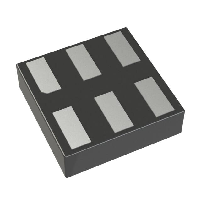

XC9244/XC9245 Series ETR0520-006 400mA Synchronous Step-Down DC/DC Converters ■GENERAL DESCRIPTION ☆GreenOperation Compatible The XC9244/XC9245 series is a group of synchronous-rectification type step-down DC/DC converters with a built-in 0.65Ω P-channel MOS driver transistor and 0.45Ω N-channel MOS switching transistor, designed to allow the use of ceramic capacitors. Output current of 400mA (MAX.) to be configured using only a coil and capacitor connected externally. The output voltage can be set from 0.8V to 4.0V in increments of 0.05V (accuracy: ±2.0%). With an internal switching frequency of 1.2MHz, small external components can be used. USPN-6 package is suitable for the application which requires low profile and small-footprint. The XC9244 series is PWM fixed frequency control, and the XC9245 series is PWM/PFM, which automatically switches from PWM to PFM during light loads, high efficiency can be achieved over a wide range of load conditions. When stand-by mode, due to stop all operation, supply current is reduced to 1μA or less. The integrated CL discharge function which enables the electric charge at the output capacitor CL to be discharged via the internal discharge switch located between the VOUT and VSS pins. The CL discharge function prevents malfunction on VOUT connecting application during stand-by mode. The XC9244/XC9245 series has a high speed soft-start as fast as 0.25ms in typical for quick turn-on. Current limiter circuit (Constant Current & Latching) is built-in for preventing from thermal destruction. With UVLO (Under Voltage Lock Out) function, the internal P channel driver transistor is forced OFF when input voltage becomes 2.25V or lower. ■FEATURES ■APPLICATIONS ●Smart phones / Mobile phones devices / terminals ●Portable ●Digital ●Note : Input Voltage : 0.65Ω P-ch Driver Transistor 0.45Ω N-ch Synchronous Switch Transistor ●Bluetooth ●Mobile Driver Transistor Built-In game consoles still cameras / Camcorders PCs / Tablet PCs 2.3V ~ 6.0V Output Voltage Selectable : 0.8V ~ 4.0V (0.05V Increments) High Efficiency : 90% (TYP.)* Output Current : 400mA Oscillation Frequency : 1.2MHz ±15% Maximum Duty Cycle : 100% Function : Current Limiter Circuit (Constant Current & Latching) CL High Speed Discharge Soft Start Circuit Capacitor : Low ESR Ceramic Capacitor Control Methods : PWM (XC9244) Operating Ambient Temperature : -40℃∼+85℃ PWM/PFM Auto (XC9245) Package : USPN-6 Environmentally Friendly : EU RoHS Compliant, Pb Free * The characteristics change with external parts, substrate wiring, etc. ■TYPICAL APPLICATION CIRCUIT ■TYPICAL PERFORMANCE CHARACTERISTICS XC9244/XC9245A33C L VIN CE CIN (ceramic) CIN=4.7μF(LMK212BJ475) VOUT 400mA CE VOUT VSS CL (ceramic) L=4.7μH(SPM3012),CL=10μF(LMK212BJ106) 100 Lx Efficiency : EFFI (%) VIN 80 60 VIN=4.2V 40 VIN=5.0V 20 PWM Control VIN=4.2V 5.0V 0 0.1 1 10 100 1000 Output Current : IOUT (mA) 1/24 XC9244/XC9245 Series ■BLOCK DIAGRAM XC9244/XC9245 Series, Type A ■PRODUCT CLASSIFICATION ●Ordering Information XC9244①②③④⑤⑥-⑦ Fixed PWM control XC9245①②③④⑤⑥-⑦ PWM / PFM automatic switching control DESIGNATOR ITEM SYMBOL ① Type A Output Voltage ②③ Oscillation Frequency Package (Order Unit) ④ ⑤⑥-⑦ (*1) 08∼40 (*1) C 7R-G DESCRIPTION Refer to Selection Guide Output voltage options e.g. 1.2V → ②=1, ③=2 1.25V → ②=1, ③=C 0.05V increments: 0.05=A, 0.15=B, 0.25=C, 0.35=D, 0.45=E, 0.55=F, 0.65=H, 0.75=K, 0.85=L, 0.95=M Refer to “Stadard Voltage” 1.2MHz USPN-6 (5,000/Reel) The “-G” suffix denotes Halogen and Antimony free as well as being fully EU RoHS compliant. Selection Guide TYPE OUTPUT VOLTAGE CL AUTO-DISCHARGE LATCH UVLO CHIP ENABLE CURRENT LIMIT SOFT-START TIME A Fixed Yes Yes Yes Yes Yes Fixed Standard Voltage VOUT(V) 1.0V 1.2V 1.5V 1.8V 2.5V 2.8V 3.3V PRODUCT NAME Fixed PWM PWM/PFM Auto XC9244A10C7R-G XC9244A12C7R-G XC9244A15C7R-G XC9244A18C7R-G XC9244A25C7R-G XC9244A28C7R-G XC9244A33C7R-G XC9245A10C7R-G XC9245A12C7R-G XC9245A15C7R-G XC9245A18C7R-G XC9245A25C7R-G XC9245A28C7R-G XC9245A33C7R-G *For other voltages, please contact your local Torex sales office or representative. 2/24 XC9244/XC9245 Series ■PIN CONFIGURATION VSS 6 1 VOUT Lx 5 2 VSS VIN 4 3 CE USPN-6 (BOTTOM VIEW) *If the pad needs to be connected to other pins, it should be connected to the VSS (No. 2 and 6) pin. ■PIN ASSIGNMENT PIN NUMBER USPN-6 PIN NAME FUNCTION 4 2, 6 3 1 5 VIN VSS CE VOUT LX Power Input Ground Chip Enable Output Voltage Monitor Switching Output ■FUNCTION XC9244/XC9245 Series, Type A PIN NAME CE SIGNAL STATUS L Stand-by H Active * Please do not leave the CE pin open. ■ABSOLUTE MAXIMUM RATINGS Ta=25℃ PARAMETER SYMBOL RATINGS UNITS VIN Pin Voltage VIN -0.3∼+6.5 V Lx Pin Voltage VLx -0.3∼VIN+0.3 or +6.5 (*1) V VOUT Pin Voltage VOUT -0.3∼VIN+0.3 or +6.5 (*1) V CE Pin Voltage VCE -0.3∼ +6.5 V Lx Pin Current ILx ±1500 mA Pd 100 mW Power Dissipation USPN-6 Operating Ambient Temperature Topr -40∼+85 ℃ Storage Temperature Tstg -55∼+125 ℃ * All voltages are described based on the VSS pin. (*1) The maximum value should be either VIN+0.3 or +6.5 in the lowest. 3/24 XC9244/XC9245 Series ■ELECTRICAL CHARACTERISTICS XC9244/XC9245 Ta=25℃ PARAMETER SYMBOL Output Voltage VOUT Operating Voltage Range VIN Maximum Output Current IOUTMAX UVLO Voltage VUVLO Quiescent Current Iq Stand-by Current ISTB Oscillation Frequency fOSC PFM Switch Current PFM Duty Limit (*3) IPFM (*3) DTYLIMIT_PFM CONDITIONS When connected to external components, VIN=VCE=5.0V, IOUT=30mA When connected to external components (*1) ,VIN=VCE=VOUT(E)+2.0V, VIN=VCE,VOUT=0V,Voltage which Lx pin holding “L” level (*2,*9) MIN. TYP. MAX. UNITS CIRCUIT V ① 2.3 - 6.0 V ① 400 - - mA ① 1.60 1.90 2.25 V ③ VIN=VCE=5.0V, VOUT=VOUT(E) × 1.1V - 18 30 μA ② VIN=5.0V, VCE=0V, VOUT=0V - 0.0 1.0 μA ② 1020 1200 1380 kHz ① 125 180 235 mA ① - - 300 % ① When connected to external components, VIN=VCE=5.0V, IOUT=200mA When connected to external components, VIN=VCE = (C-1) , IOUT=1mA VIN=VCE= (C-2), IOUT=1mA Maximum Duty Cycle DMAX VIN=VCE =5.0V, VOUT=VOUT(E) × 0.9V 100 - - % ③ Minimum Duty Cycle DMIN VIN=VCE=5.0V, VOUT=VOUT(E) × 1.1V - - 0 % ③ Efficiency EFFI - - % ① Lx SW”H”ON Resistance RLXH - 0.65 0.85 Ω ④ Ω - 1.00 μA ⑤ Lx SW”L”ON Resistance When connected to external components, VIN=VCE=VOUT(E) +1.5V, IOUT =100mA (*4) VIN=VCE=5.0V, VOUT=0V, ILX=100mA (*5) RLXL VIN=VCE=5.0V - Lx SW”H” Leakage Current ILeakH VIN=VOUT=5.0V, VCE=0V, VLX=0V - 0.00 Lx SW”L” Leakage Current (*7) ILeakL VIN=VOUT=5.0V, VCE=0V, VLX=5.0V - 0.00 1.00 μA ⑤ ILIM VIN=VCE=5.0V, VOUT=VOUT(E) ×0.9V 700 900 1200 mA ⑥ - ±100 - ppm/℃ ① (*8) 0.65 (*6) (*7) Current Limit 0.45 (*6) Output Voltage Temperature ΔVOUT/ Characteristics (VOUT・ΔTopr) CE ”H” Voltage VCEH VIN=5.0V, VOUT=0V, Applied voltage to (*9) VCE,Voltage changes Lx to “H” level 1.20 - 6.00 V ③ CE ”L” Voltage VCEL VIN=5.0V, VOUT=0V, Applied voltage to (*9) VCE,Voltage changes Lx to “L” level VSS - 0.25 V ③ CE ”H” Current ICEH VIN=5.0V, VCE=5.0V, VOUT=0V -0.1 - 0.1 μA ⑤ CE ”L” Current ICEL VIN=5.0V, VCE=0V, VOUT=0V -0.1 - 0.1 μA ⑤ Soft-Start Time tSS - 0.25 - ms ① Latch Time tLAT 0.50 1.00 5.00 ms ⑦ CL Discharge RDCHG 50 120 200 Ω ⑧ IOUT=30mA, -40℃≦Topr≦85℃ When connected to external components, VIN=5.0V, VCE=0V → 5.0V, IOUT=1mA VIN=VCE=5.0V, VOUT=0.8×VOUT(E), Short Lx at 1Ω resistance (*10) VIN=5.0V, VCE=0V, VOUT=5.0V NOTE: Unless otherwise stated, VIN=5.0V, VOUT(E)=Nominal Voltage (*1) When the difference between the input and the output is small, some cycles may be skipped completely before current maximizes. If current is further pulled from this state, output voltage will decrease because of P-ch driver ON resistance. (*2) Including UVLO detect voltage, hysteresis operating voltage range for UVLO release voltage. UVLO release voltage is VIN voltage which is Lx pin becomes “H”. (*3) XC9244 series exclude IPFM and DTYLIMIT_PFM because those are only for the PFM control’s functions. (*4) EFFI = { ( output voltage×output current ) / ( input voltage×input current) }×100 (*5) ON resistance= (VIN - Lx pin measurement voltage) / 100mA (*6) Design value (*7) When temperature is high, a current of approximately 10μA (maximum) may leak. (*8)Current limit denotes the level of detection at peak of coil current. (*9) "H"=VIN∼VIN - 1.2V, "L"=+ 0.1V ∼ - 0.1V (*10) Time until it short-circuits VOUT with GND via 1Ωof resistor from an operational state and is set to Lx=0V from current limit pulse generating. 4/24 XC9244/XC9245 Series ■ELECTRICAL CHARACTERISTICS (Continued) SPEC Table 1) IPFM,DTYLIMIT_PFM,VOUT,EFFI NOMINAL OUTPUT IPFM DTYLIMIT_PFM VOLTAGE VOUT EFFI (TYP.) MIN. TYP. MAX. 0.80 0.784 0.800 0.816 77 0.85 0.833 0.850 0.867 78 0.90 0.882 0.900 0.918 79 0.95 0.931 0.950 0.969 80 1.00 0.980 1.000 1.020 81 1.05 1.029 1.050 1.071 82 1.10 1.078 1.100 1.122 83 1.15 1.127 1.150 1.173 84 1.176 1.200 1.224 85 1.225 1.250 1.275 85 1.274 1.300 1.326 86 1.35 1.323 1.350 1.377 86 1.40 1.372 1.400 1.428 86 1.45 1.421 1.450 1.479 86 1.50 1.470 1.500 1.530 87 1.55 1.519 1.550 1.581 87 1.60 1.568 1.600 1.632 87 1.65 1.617 1.650 1.683 87 1.70 1.666 1.700 1.734 88 1.75 1.715 1.750 1.785 88 1.80 1.764 1.800 1.836 88 1.85 1.813 1.850 1.887 88 1.90 1.862 1.900 1.938 89 1.95 1.911 1.950 1.989 89 2.00 1.960 2.000 2.040 89 2.05 2.009 2.050 2.091 89 2.10 2.058 2.100 2.142 89 2.107 2.150 2.193 90 2.156 2.200 2.244 90 2.205 2.250 2.295 90 2.30 2.254 2.300 2.346 90 2.35 2.303 2.350 2.397 90 2.40 2.352 2.400 2.448 91 2.45 2.401 2.450 2.499 91 2.50 2.450 2.500 2.550 91 2.55 2.499 2.550 2.601 91 2.60 2.548 2.600 2.652 91 2.65 2.597 2.650 2.703 91 2.70 2.646 2.700 2.754 92 VOUT(E) 1.20 3.6V 1.25 2.3V 1.30 2.15 2.20 2.25 VOUT(E)+2.0V VOUT(E)+0.5V 5/24 XC9244/XC9245 Series ■ELECTRICAL CHARACTERISTICS (Continued) SPEC Table 1) IPFM,DTYLIMIT_PFM,VOUT,EFFI NOMINAL OUTPUT IPFM DTYLIMIT_PFM VOLTAGE EFFI VOUT (TYP.) MIN. TYP. MAX. 2.75 2.695 2.750 2.805 92 2.80 2.744 2.800 2.856 92 2.85 2.793 2.850 2.907 92 2.90 2.842 2.900 2.958 92 2.95 2.891 2.950 3.009 92 3.00 2.940 3.000 3.060 92 3.05 2.989 3.050 3.111 92 3.10 3.038 3.100 3.162 93 3.15 3.087 3.150 3.213 93 3.20 3.136 3.200 3.264 93 3.25 3.185 3.250 3.315 93 3.30 3.234 3.300 3.366 93 3.283 3.350 3.417 93 VOUT(E) 3.35 3.40 VOUT(E)+2.0V VOUT(E)+0.5V 3.332 3.400 3.468 93 3.45 3.381 3.450 3.519 93 3.50 3.430 3.500 3.570 93 3.55 3.479 3.550 3.621 93 3.60 3.528 3.600 3.672 93 3.65 3.577 3.650 3.723 93 3.70 3.626 3.700 3.774 93 3.75 3.675 3.750 3.825 94 3.80 3.724 3.800 3.876 94 3.85 3.773 3.850 3.927 94 3.90 3.822 3.900 3.978 94 3.95 3.871 3.950 4.029 94 4.00 3.920 4.000 4.080 94 6/24 XC9244/XC9245 Series ■TYPICAL APPLICATION CIRCUIT L VIN VIN CE CIN VOUT 400mA Lx CE VOUT CL (ceramic) VSS (ceramic) ●External Components L CIN CL MANUFACTURE PRODUCT NUMBER RATED VOLTAGE / INDUCTANCE DIMENTION (mm) TDK SPM3012-4R7 4.7μH 3.2 x 3.0 x h1.2 TAIYO YUDEN NR3015-4R7 4.7μH 3.0 x 3.0 x h1.5 Coilcraft EPL3015-4R7 4.7μH 3.2 x 3.2 x h1.55 TAIYO YUDEN LMK212ABJ475KG 10V / 4.7μF 2.0 x 1.25 x h1.4 CM105X5R475K10A 10V / 4.7μF 1.6 x 0.8 x h1.0 LMK212ABJ106KG 10V / 10μF 2.0 x 1.25 x h1.4 CM105X5R106M10A 10V / 10μF 1.6 x 0.8 x h1.0 KYOCERA TAIYO YUDEN KYOCERA 7/24 XC9244/XC9245 Series ■OPERATIONAL DESCRIPTION The XC9244/XC9245 series consists of a reference voltage source, ramp wave circuit, error amplifier, PWM comparator, phase compensation circuit, output voltage adjustment resistors, P-channel MOS driver transistor, N-channel MOS switching transistor for the synchronous switch, current limiter circuit, UVLO circuit and others. (See the block diagram below.) The series ICs compare, using the error amplifier, the voltage of the internal voltage reference source with the feedback voltage from the VOUT pin through split resistors, R1 and R2. Phase compensation is performed on the resulting error amplifier output, to input a signal to the PWM comparator to determine the turn-on time during PWM operation. The PWM comparator compares, in terms of voltage level, the signal from the error amplifier with the ramp wave from the ramp wave circuit, and delivers the resulting output to the buffer driver circuit to cause the Lx pin to output a switching duty cycle. This process is continuously performed to ensure stable output voltage. The current feedback circuit monitors the P-channel MOS driver transistor current for each switching operation, and modulates the error amplifier output signal to provide multiple feedback signals. This enables a stable feedback loop even when a low ESR capacitor such as a ceramic capacitor is used ensuring stable output voltage. XC9244/XC9245 Series, Type A Phase Compensation VOUT Current Feedback Current Limit CFB R1 Error Amp. PWM Comparator Logic CEB R2 Vref with Soft Start, CE VIN Synch. Buffer Drive Lx PWM/PFM Selector UVLO Comparator Ramp Wave Generator OSC UVLO R3 R4 CEB CE Control Logic CE VSS The reference voltage source provides the reference voltage to ensure stable output voltage of the DC/DC converter. The ramp wave circuit determines switching frequency. The frequency is fixed internally as1.2MHz. Clock pulses generated in this circuit are used to produce ramp waveforms needed for PWM operation, and to synchronize all the internal circuits. The error amplifier is designed to monitor output voltage. internal split resistors, R1 and R2. increases. The amplifier compares the reference voltage with the feedback voltage divided by the When a voltage lower than the reference voltage is fed back, the output voltage of the error amplifier The gain and frequency characteristics of the error amplifier output are fixed internally to deliver an optimized signal to the mixer. The error amplifier output signal optimized in the mixer is modulated with the current feedback signal. compatator. 8/24 This signal is delivered to the PWM XC9244/XC9245 Series ■OPERATIONAL DESCRIPTION (Continued) The current limiter circuit of the XC9244/XC9245 series monitors the current flowing through the P-channel MOS driver transistor connected to the Lx pin, and features a combination of the current limit mode and the operation suspension mode. ① When the driver current is greater than a specific level, the current limit function operates to turn off the pulses from the Lx pin at any given timing. ② When the P-channel MOS driver transistor is turned off, the limiter circuit is then released from the current limit detection state. ③ At the next pulse, the P-channel MOS driver transistor is turned on. However, the P-channel MOS driver transistor is immediately turned off in the case of an over current state. ④ When the over current state is eliminated, the IC resumes its normal operation. The IC waits for the over current state to end by repeating the steps ① through ③. If an over current state continues for a few ms and the above three steps are repeatedly performed, the IC performs the function of latching the OFF state of the P-channel MOS driver transistor, and goes into operation suspension mode. Once the IC is in suspension mode, operations can be resumed by either turning the IC off via the CE/MODE pin, or by restoring power to the VIN pin. The suspension mode does not mean a complete shutdown, but a state in which pulse output is suspended; therefore, the internal circuitry remains in operation. The current limit of the XC9244/XC9245 series can be set at 900mA at typical. Besides, care must be taken when laying out the PC Board, in order to prevent misoperation of the current limit mode. Depending on the state of the PC Board, latch time may become longer and latch operation may not work. In order to avoid the effect of noise, the board should be laid out so that input capacitors are placed as close to the IC as possible. When the VIN voltage becomes 1.6V or lower, the P-ch MOS driver transistor output driver transistor is forced OFF to prevent false pulse output caused by unstable operation of the internal circuitry. When the VIN pin voltage becomes 2.25V or higher, switching operation takes place. By releasing the UVLO function, the IC performs the soft start function to initiate output startup operation. The soft start function operates even when the VIN pin voltage falls momentarily below the UVLO operating voltage. The UVLO circuit does not cause a complete shutdown of the IC, but causes pulse output to be suspended; therefore, the internal circuitry remains in operation. (*1) In PFM control operation, until coil current reaches to a specified level (IPFM), the IC keeps the P-ch MOS driver transistor on. that the P-ch MOS driver transistor is kept on (tON) can be given by the following formula. tON= L×IPFM / (VIN−VOUT) →IPFM① In this case, time < PFM Duty Limit > (*1) In PFM control operation, the PFM duty limit (DTYLIMIT_PFM) is set to 300% (MAX.). Therefore, under the condition that the duty increases (e.g. the condition that the step-down ratio is small), it’s possible for P-ch MOS driver transistor to be turned off even when coil current doesn’t reach to IPFM. →IPFM② (* 1) XC9244 series exclude. 9/24 XC9244/XC9245 Series ■OPERATIONAL DESCRIPTION (Continued) XC9244/ XC9245 series can quickly discharge the electric charge at the output capacitor (CL) when a low signal to the CE pin which enables a whole IC circuit put into OFF state, is inputted via the N-ch MOS switch transistor located between the VOUT pin and the VSS pin. When the IC is disabled, electric charge at the output capacitor (CL) is quickly discharged so that it may avoid application malfunction. Discharge time of the output capacitor (CL) is set by the CL auto-discharge resistance (R) and the output capacitor (CL). By setting time constant of a CL auto-discharge resistance value [RDCHG] and an output capacitor value (CL) as τ(τ= CL×RDCHG), discharge time of the output voltage after discharge via the N-channel transistor is calculated by the following formulas. V = VOUT(E)×e -t /τ or t = τln (VOUT(E) /V) Output Voltage Dischage Characteristics RDCHG=120Ω(TYP) 100 V: Output voltage after discharge CL=10μF CL=20μF CL=50μF Output Voltage (Relative Value) 100 = Setting Voltage Value 90 VOUT(E): Output voltage t: Discharge time τ: CL×RDCHG CL: Capacitance of Output capacitor RDCHG: CL auto-discharge resistance 80 70 60 50 40 30 20 10 0 0 10 20 30 40 50 Discharge Time t (ms) The operation of the XC9244/XC9245 series will enter into the shut down mode when a low level signal is input to the CE pin. During the shutdown mode, the current consumption of the IC becomes 0μA (TYP.), with a state of high impedance at the Lx pin and CL high speed discharge at VOUT pin. The IC starts its operation by inputting a high level signal to the CE pin. The input to the CE pin is a CMOS input and the sink current is 0μA (TYP.). 1) XC9244/XC9245 series - Examples of how to use CE pin (A) SW_CE STATUS ON Stand-by OFF Operation SW_CE STATUS ON Stand-by OFF Operation (B) The XC9244/ XC9245 series provide 0.25ms (TYP). time when the VCE is turned on. 10/24 Soft start time is defined as the time interval to reach 90% of the output voltage from the XC9244/XC9245 Series ■NOTE ON USE 1. Please use this IC within the stated maximum ratings. For temporary, transitional voltage drop or voltage rising phenomenon, the IC is liable to malfunction should the ratings be exceeded. 2. Spike noise and ripple voltage arise in a switching regulator as with a DC/DC converter. These are greatly influenced by external component selection, such as the coil inductance, capacitance values, and board layout of external components. Once the design has been completed, verification with actual components should be done. 3. When the difference between VIN and VOUT is large in PWM control, very narrow pulses will be outputted, and there is the possibility that some cycles may be skipped completely. 4. When the difference between VIN and VOUT is small, and the load current is heavy, very wide pulses will be outputted and there is the possibility that some cycles may be skipped completely. V OUT:100mV/div ILx:100mA/div V Lx:5V/div Horizon:200μsec/div 5. With the IC, the peak current of the coil is controlled by the current limit circuit. Since the peak current increases when dropout voltage or load current is high, current limit starts operation, and this can lead to instability. inductance value and fully check the circuit operation. When peak current becomes high, please adjust the coil In addition, please calculate the peak current according to the following formula: Ipk = (VIN - VOUT)×OnDuty / (2×L×fOSC) + IOUT L: Coil Inductance Value fOSC: Oscillation Frequency 6. When the peak current which exceeds limit current flows within the specified time, the built-in P-ch MOS driver transistor turns off. During the time until it detects limit current and before the built-in transistor can be turned off, the current for limit current flows; therefore, care must be taken when selecting the rating for the external components such as a coil. 7. Care must be taken when laying out the PC Board, in order to prevent misoperation of the current limit mode. Depending on the state of the PC Board, latch time may become longer and latch operation may not work. In order to avoid the effect of noise, the board should be laid out so that input capacitors are placed as close to the IC as possible. 8. Please do not use the IC at voltages below the recommended voltage range. 9. This IC should be used within the stated absolute maximum ratings in order to prevent damage to the device. 10. When the IC is used in high temperature, output voltage may increase up to input voltage level at no load because of the leak current of the driver transistor. 11. The current limit is set to 1200mA (MAX.) at typical. However, the current of 1200mA or more may flow. In case that the current limit functions while the VOUT pin is shorted to the GND pin, when P-ch MOS driver transistor is ON, the potential difference for input voltage will occur at both ends of a coil. For this, the time rate of coil current becomes large. By contrast, when N-ch MOS driver transistor is ON, there is almost no potential difference at both ends of the coil since the VOUT pin is shorted to the GND pin. Consequently, the time rate of coil current becomes quite small. According to the repetition of this operation, and the delay time of the circuit, coil current will be converged on a certain current value, exceeding the amount of current, which is supposed to be limited originally. Even in this case, however, after the over current state continues for several ms, the circuit will be latched. A coil should be used within the stated absolute maximum rating in order to prevent damage to the device. ①Current flows into P-ch MOS driver transistor to reach the current limit (ILIM). ②The current of ILIM or more flows since the delay time of the circuit occurs during from the detection of the current limit to OFF of P-ch MOS driver transistor. ③Because of no potential difference at both ends of the coil, the time rate of coil current becomes quite small. ④Lx oscillates very narrow pulses by the current limit for several ms. ⑤The circuit is latched, stopping its operation. 11/24 XC9244/XC9245 Series ■NOTE ON USE (Continued) 12. In order to stabilize VIN’s voltage level, we recommend that a by-pass capacitor (CIN) be connected as close as possible to the VIN & VSS pins. 13. In case of VIN<2.5V, the maximum load current may be decreased less than 400mA due to the characteristics of current limit. 14. Torex places an importance on improving our products and their reliability. We request that users incorporate fail-safe designs and post-aging protection treatment when using Torex products in their systems. ●Instructions of pattern layouts 1. In order to stabilize VIN voltage level, we recommend that a by-pass capacitor (CIN) be connected as close as possible to the VIN & VSS pins. 2. Please mount each external component as close to the IC as possible. 3. Wire external components as close to the IC as possible and use thick, short connecting traces to reduce the circuit impedance. 4. Make sure that the PCB GND traces are as thick as possible, as variations in ground potential caused by high ground currents at the time of switching may result in instability of the IC. 5. This series’ internal P-ch driver transistors bring on heat because of the output current and ON resistance of driver transistors. ●Recommended Pattern Layout st 1 Layer PCB 12/24 nd 2 Layer XC9244/XC9245 Series ■TEST CIRCUITS 13/24 XC9244/XC9245 Series ■TYPICAL PERFORMANCE CHARACTERISTICS (1) Efficiency vs. Output Current (Compare to different coil) (1)効率 - 出力電流特性例(コイル別比較) XC9244A12C(VIN=3.6V) XC9245A12C(VIN=3.6V) CIN=4.7μF(LMK212BJ475) L=4.7μH,CL=10μF(LMK212BJ106) 80 60 SPM3012(TDK) NR3015(TAIYO YUDEN) EPL3015(Coilcraft) 40 20 L=4.7μH,CL=10μF(LMK212BJ106) 100 Efficiency : EFFI (%) 100 Efficiency : EFFI (%) CIN=4.7μF(LMK212BJ475) 80 60 SPM3012(TDK) NR3015(TAIYO YUDEN) EPL3015(Coilcraft) 40 20 0 0 0.1 1 10 100 0.1 1000 1 10 100 1000 Output Current : IOUT (mA) Output Current : IOUT (mA) (1) Efficiency vs. Output Current (1)効率 - 出力電流特性例 XC9244/XC9245A12C 100 XC9244/XC9245A18C CIN=4.7μF(LMK212BJ475) CIN=4.7μF(LMK212BJ475) L=4.7μH(SPM3012),CL=10μF(LMK212BJ106) L=4.7μH(SPM3012),CL=10μF(LMK212BJ106) 100 80 60 4.2V 3.6V 40 20 PWM Control VIN=2.3V 3.6V 4.2V Efficiency : EFFI (%) Efficiency : EFFI (%) VIN=2.3V 0 10 100 1000 4.2V 40 PWM Control VIN=3.6V 4.2V 3.6V 20 0.1 1 10 100 Output Current : IOUT (mA) Output Current : IOUT (mA) XC9244/XC9245A33C (2) Output Voltage vs. Output Current (2)出力電圧 - 出力電流特性例 XC9244/XC9245A12C 1000 CIN=4.7μF(LMK212BJ475) CIN=4.7μF(LMK212BJ475) L=4.7μH(SPM3012),CL=10μF(LMK212BJ106) L=4.7μH(SPM3012),CL=10μF(LMK212BJ106) 80 60 VIN=4.2V 40 VIN=5.0V 20 PWM Control VIN=4.2V 5.0V 1.30 Output Voltage : VOUT (V) Efficiency : EFFI (%) 1 0 1.28 1.25 VIN=2.3V,3.6V,4.2V 1.23 1.20 1.18 1.15 1.13 1.10 0.1 1 10 100 Output Current : IOUT (mA) 14/24 60 0 0.1 100 80 1000 0.1 1 10 100 Output Current : IOUT (mA) 1000 XC9244/XC9245 Series ■TYPICAL PERFORMANCE CHARACTERISTICS (Continued) (2) Output Voltage- vs. Output Current (Continued) (2)出力電圧 出力電流特性例 XC9244/XC9245A18C CIN=4.7μF(LMK212BJ475) L=4.7μH(SPM3012),CL=10μF(LMK212BJ106) L=4.7μH(SPM3012),CL=10μF(LMK212BJ106) 1.88 VIN=3.6V,4.2V 1.85 3.40 Output Voltage : VOUT (V) Output Voltage : VOUT (V) 1.90 XC9244/XC9245A33C CIN=4.7μF(LMK212BJ475) 1.83 1.80 1.78 1.75 1.73 1.70 3.38 3.35 VIN=4.2V,5.0V 3.33 3.30 3.28 3.25 3.23 3.20 0.1 1 10 100 1000 0.1 1 10 100 1000 Output Current : IOUT (mA) Output Current : IOUT (mA) (3) Ripple Voltage vs. -Output Current (3)リップル電圧 出力電流特性例 XC9244/XC9245A12C XC9244/XC9245A18C CIN=4.7μF(LMK212BJ475) L=4.7μH(SPM3012),CL=10μF(LMK212BJ106) PWM/PFM Automatic Switching Control VIN=2.3V PWM Control 3.6V VIN=2.3V,3.6V,4.2V 4.2V 80 60 40 20 L=4.7μH(SPM3012),CL=10μF(LMK212BJ106) 100 Ripple Voltage : Vr (mV) 100 Ripple Voltage : Vr (mV) CIN=4.7μF(LMK212BJ475) 80 60 PWM Control VIN=3.6V,4.2V PWM/PFM Automatic Switching Control VIN= 3.6V 4.2V 40 20 0 0 0.1 1 10 100 0.1 1000 Output Current : IOUT (mA) 1 10 100 1000 Output Current : IOUT (mA) (4) Output Voltage vs. Ambient Temperature (4)出力電圧 - 周囲温度特性例 XC9244/XC9245A33C CIN=4.7μF(LMK212BJ475) L=4.7μH(SPM3012),CL=10μF(LMK212BJ106) 80 60 PWM Control VIN=4.2V,5.0V 40 PWM/PFM Automatic Switching Control VIN=4.2V 5.0V 20 1.98 Output Voltage :Vout (V) Ripple Voltage : Vr (mV) 100 CIN=4.7μF(LMK212BJ475) L=4.7μH(SPM3012),CL=10μF(LMK212BJ106) 1.94 1.90 VIN=2.3V,3.6V,5.0V 1.86 1.82 1.78 1.74 1.70 1.66 1.62 0 0.1 1 10 100 Output Current : IOUT (mA) 1000 -50 -25 0 25 50 75 100 Ambient temperture: Ta (℃) 15/24 XC9244/XC9245 Series ■TYPICAL PERFORMANCE CHARACTERISTICS (Continued) 1.5 (6) Oscillation Frequency vs. Input Voltage (6)発振周波数 - 入力電圧特性例 CIN=4.7μF(LMK212BJ475) CIN=4.7μF(LMK212BJ475) L=4.7μH(SPM3012),CL=10μF(LMK212BJ106) L=4.7μH(SPM3012),CL=10μF(LMK212BJ106) 1.4 VIN=2.3V VIN=3.6V 1.3 Oscillation Freqency : fOSC(MHz) Oscillation Freqency : fOSC(MHz) (5)(5)発振周波数 Oscillation Frequency vs. Ambient Temperature - 周囲温度特性例 1.2 1.1 1.0 VIN=5.0V 0.9 0.8 -50 -25 0 25 50 75 1.5 1.4 Ta=25℃,85℃ 1.3 1.2 1.1 1.0 Ta=-40℃ 0.9 0.8 100 1.5 2.5 40 40 35 35 VIN=2.3V,3.6V,5.0V 25 20 15 10 5 0 6.5 30 Ta=25℃,85℃ 25 20 15 10 Ta=-40℃ 5 0 -50 -25 0 25 50 75 100 1.5 2.5 (9) CE "H" Voltage vs. Ambient Temperature CE"H" Voltage : VCEH (V) VIN=2.3V VIN=3.6V VIN=5.0V -50 -25 0 25 50 4.5 5.5 6.5 (10) CE "H" Voltage vs. Input Voltage (10)CE"H"電圧 - 入力電圧特性例 (9)CE"H"電圧 - 周囲温度特性例 1.0 0.9 0.8 0.7 0.6 0.5 0.4 0.3 0.2 0.1 0.0 3.5 Input Voltage: VIN (V) Ambient temperture: Ta (℃) CE"H" Voltage : VCEH (V) 5.5 (8) Quiescent Current -vs. Input Voltage (8)消費電流 入力電圧特性例 Quiescent Current : Iq (μA) Quiescent Current : Iq (μA) (7)(7)消費電流 Quiescent Current vs. Ambient Temperature - 周囲温度特性例 75 Ambient temperture: Ta (℃) 16/24 4.5 Input Voltage: VIN (V) Ambient temperture: Ta (℃) 30 3.5 100 1.0 0.9 0.8 0.7 0.6 0.5 0.4 0.3 0.2 0.1 0.0 Ta=-40℃ Ta=85℃ Ta=25℃ 1.5 2.5 3.5 4.5 5.5 Input Voltage: VIN (V) 6.5 XC9244/XC9245 Series ■TYPICAL PERFORMANCE CHARACTERISTICS (Continued) 1.6 1.4 VIN=2.3V 1.2 1.0 VIN=3.6V 0.8 0.6 0.4 0.2 VIN=5.0V 0.0 -50 -25 0 25 50 75 (12) Lx SWSW "H" ON Resistance vs. Input Voltage (12)Lx "H"ON抵抗 - 入力電圧特性例 Lx SW "H"ON Resistance : RLxH (Ω) Lx SW "H"ON Resistance : RLxH (Ω) (11) Lx SW "H" ON"H"ON抵抗 Resistance vs. -Ambient Temperature (11)Lx SW 周囲温度特性例 1.6 1.4 1.2 Ta=25℃ 1.0 Ta=85℃ 0.8 0.6 0.4 Ta=-40℃ 0.2 0.0 100 1.5 2.5 Ambient temperture: Ta (℃) 1.4 1.2 1.0 VIN=3.6V 0.6 0.4 0.2 VIN=5.0V 0.0 -50 -25 0 25 50 75 1.4 1.2 1.0 Ta=-40℃ Ta=25℃ 0.8 Ta=85℃ 0.6 0.4 0.2 0.0 100 1.5 2.5 4.5 5.5 6.5 (16) CL Discharge vs. Input Voltage (16)C - 入力電圧特性例 L放電抵抗 300 300 250 250 CL Discharge : RDCHG(Ω) CL Discharge : RDCHG(Ω) 3.5 Input Voltage: VIN (V) (15) CL Discharge vs. Ambient Temperature - 周囲温度特性例 (15)C L放電抵抗 VIN=2.3V 150 100 50 6.5 1.6 Ambient temperture: Ta (℃) 200 5.5 (14) Lx SW SW "L" ON Resistance vs.- Input Voltage (14)"Lx "L"ON抵抗 入力電圧特性例 Lx SW "L"ON Resistance : RLxL (Ω) Lx SW "L"ON Resistance : RLxL (Ω) 1.6 VIN=2.3V 4.5 Input Voltage: VIN (V) (13) Lx SW "L" ON"L"ON抵抗 Resistance vs. -Ambient Temperature (13)Lx SW 周囲温度特性例 0.8 3.5 VIN=3.6V,5.0V 0 200 Ta=25℃ Ta=85℃ 150 100 50 Ta=-40℃ 0 -50 -25 0 25 50 75 Ambient temperture: Ta (℃) 100 1.5 2.5 3.5 4.5 5.5 6.5 Input Voltage: VIN (V) 17/24 XC9244/XC9245 Series ■TYPICAL PERFORMANCE CHARACTERISTICS (Continued) (17) PFM Switch Current vs. Ambient Temperature (17)PFMスイッチ電流 - 周囲温度特性例 (18) PFM Switch Current vs. Input Voltage (18)PFMスイッチ電流 - 入力電圧特性例 VOUT(E)=0.8V,CIN=4.7μF(LMK212BJ475) PFM Switch Current : IPFM (mA) VIN=2.3V VIN=3.6V VIN=5.0V -50 -25 0 25 50 75 L=4.7μH(SPM3012),CL=10μF(LMK212BJ106) 250 230 210 190 170 150 130 110 90 70 50 PFM Switch Current : IPFM (mA) L=4.7μH(SPM3012),CL=10μF(LMK212BJ106) 250 230 210 190 170 150 130 110 90 70 50 VOUT(E)=0.8V,CIN=4.7μF(LMK212BJ475) Ta=-40℃ Ta=25℃ Ta=85℃ 1.5 100 2.5 4.5 5.5 6.5 Input Voltage: VIN (V) Ambient temperture: Ta (℃) (19) Current Limit vs. -Ambient Temperature (19)電流制限 周囲温度特性例 (20) Current Limit vs. Input Voltage (20)電流制限 - 入力電圧特性例 1200 1200 1100 1100 Current Limit : ILIM (mA) Current Limit : ILIM (mA) 3.5 1000 Ta=85℃ 1000 900 VIN=3.6V 800 VIN=5.0V 700 600 VIN=2.3V 500 400 900 800 Ta=25℃ 700 Ta=-40℃ 600 500 400 -50 -25 0 25 50 75 100 1.5 2.5 3.5 4.5 5.5 6.5 Input Voltage: VIN (V) Ambient temperture: Ta (℃) (21) UVLO Voltage vs. Ambient Temperature (21)UVLO電圧 - 周囲温度特性例 (22) Soft Start Time vs. Input Voltage (22)ソフトスタート時間 - 周囲温度特性例 CIN=4.7μF(LMK212BJ475) 2.2 Soft Start Time: tSS (μs) UVLO Voltage : UVLO (V) 2.3 2.1 2.0 1.9 1.8 1.7 1.6 1.5 -50 -25 0 25 50 75 Ambient temperture: Ta (℃) 18/24 100 500 450 400 350 300 250 200 150 100 50 0 L=4.7μH(SPM3012),CL=10μF(LMK212BJ106) VOUT=2.0V VOUT=4.0V VOUT=0.8V -50 -25 0 25 50 75 Ambient temperture: Ta (℃) 100 XC9244/XC9245 Series ■TYPICAL PERFORMANCE CHARACTERISTICS (Continued) (23) Rise Wave Form (23)起動波形例 XC9244/XC9245A12C XC9244/XC9245A18C CIN=4.7μF(LMK212BJ475) CIN=4.7μF(LMK212BJ475) L=4.7μH(SPM3012),CL=10μF(LMK212BJ106) L=4.7μH(SPM3012),CL=10μF(LMK212BJ106) VIN=5.0V IOUT=1mA VIN=5.0V IOUT=1mA VOUT :0.5V/div VOUT :0.5V/div CE :0V⇒5.0V CE :0V⇒5.0V 100μs/div 100μs/div XC9244/XC9245A33C CIN=4.7μF(LMK212BJ475) L=4.7μH(SPM3012),CL=10μF(LMK212BJ106) VIN=5.0V IOUT=1mA VOUT :1.0V/div CE :0V⇒5.0V 100μs/div 19/24 XC9244/XC9245 Series ■TYPICAL PERFORMANCE CHARACTERISTICS (Continued) (24) Load Transient Response (24)負荷過渡応答特性例 XC9244A18C XC9244A18C CIN=4.7μF(LMK212BJ475) CIN=4.7μF(LMK212BJ475) L=4.7μH(SPM3012),CL=10μF(LMK212BJ106) L=4.7μH(SPM3012),CL=10μF(LMK212BJ106) IOUT=1mA⇒100mA VOUT :50mV/div 50μs/div IOUT=1mA⇒300mA VOUT :50mV/div XC9244A18C XC9244A18C CIN=4.7μF(LMK212BJ475) CIN=4.7μF(LMK212BJ475) L=4.7μH(SPM3012),CL=10μF(LMK212BJ106) L=4.7μH(SPM3012),CL=10μF(LMK212BJ106) IOUT=300mA⇒1mA IOUT=100mA⇒1mA VOUT :50mV/div VOUT :50mV/div 200μs/div 20/24 50μs/div 200μs/div XC9244/XC9245 Series ■TYPICAL PERFORMANCE CHARACTERISTICS (Continued) (24) Load Transient Response (Continued) (24)負荷過渡応答特性例 XC9245A18C XC9245A18C CIN=4.7μF(LMK212BJ475) CIN=4.7μF(LMK212BJ475) L=4.7μH(SPM3012),CL=10μF(LMK212BJ106) L=4.7μH(SPM3012),CL=10μF(LMK212BJ106) IOUT=1mA⇒300mA IOUT=1mA⇒100mA VOUT :50mV/div 50μs/div VOUT :50mV/div XC9245A18C 50μs/div XC9245A18C CIN=4.7μF(LMK212BJ475) CIN=4.7μF(LMK212BJ475) L=4.7μH(SPM3012),CL=10μF(LMK212BJ106) L=4.7μH(SPM3012),CL=10μF(LMK212BJ106) IOUT=100mA⇒1mA IOUT=300mA⇒1mA VOUT :50mV/div VOUT :50mV/div 200μs/div 200μs/div 21/24 XC9244/XC9245 Series ■PACKAGING INFORMATION ●USPN-6 Reference Pattern Layout ●USPN-6 0.15 22/24 ●USPN-6 Reference Metal Mask Design 0.25 0.2 0.25 0.2 0.2 0.2 6 5 4 6 5 4 1 0.45 2 0.45 3 0.15 0.1 1 0.45 2 0.45 3 0.1 XC9244/XC9245 Series ■MARKING RULE ① represents product series and output voltage XC9244 Series ●USPN-6 1 ① ② 3 ③ ④ 2 6 5 4 MARK OUTPUT VOLTAGE VOLTAGE INCREMENT PRODUCT SERIES A 0.8∼3.7 0.1 XC9244A08C**-G ∼ XC9244A37C**-G B 0.85∼3.75 0.05 XC9244A0LC**-G ∼ XC9244A3KC**-G C 3.8∼4.0 0.1 XC9244A38C**-G ∼ XC9244A40C**-G C 3.85∼3.95 0.05 XC9244A3LC**-G ∼ XC9244A3MC**-G VOLTAGE INCREMENT PRODUCT SERIES XC9245 Series MARK OUTPUT VOLTAGE D 0.8∼3.7 0.1 XC9245A08C**-G ∼ XC9245A37C**-G E 0.85∼3.75 0.05 XC9245A0LC**-G ∼ XC9245A3KC**-G F 3.8∼4.0 0.1 XC9245A38C**-G ∼ XC9245A40C**-G F 3.85∼3.95 0.05 XC9245A3LC**-G ∼ XC9245A3MC**-G ② represents product function MARK OUTPUT VOLTAGE MARK OUTPUT VOLTAGE 0 0.8 0.85 F 2.3 2.35 1 0.9 0.95 H 2.4 2.45 2 1.0 1.05 K 2.5 2.55 3 1.1 1.15 L 2.6 2.65 4 1.2 1.25 M 2.7 2.75 5 1.3 1.35 N 2.8 2.85 6 1.4 1.45 P 2.9 2.95 7 1.5 1.55 R 3.0 3.05 8 1.6 1.65 S 3.1 3.15 9 1.7 1.75 T 3.2 3.25 A 1.8 1.85 3.8 U 3.3 3.35 B 1.9 1.95 3.9 V 3.4 3.45 C 2.0 2.05 4.0 X 3.5 3.55 D 2.1 2.15 3.85 Y 3.6 3.65 E 0.8 0.85 3.95 Z 3.7 3.75 ③④ represents production lot number 01 to 09, 0A to 0Z, 11 to 9Z, AA to AZ, B1 to ZZ repeated. (G, I, J, O, Q, W excluded) *No character inversion used. 23/24 XC9244/XC9245 Series 1. The products and product specifications contained herein are subject to change without notice to improve performance characteristics. Consult us, or our representatives before use, to confirm that the information in this datasheet is up to date. 2. We assume no responsibility for any infringement of patents, patent rights, or other rights arising from the use of any information and circuitry in this datasheet. 3. Please ensure suitable shipping controls (including fail-safe designs and aging protection) are in force for equipment employing products listed in this datasheet. 4. The products in this datasheet are not developed, designed, or approved for use with such equipment whose failure of malfunction can be reasonably expected to directly endanger the life of, or cause significant injury to, the user. (e.g. Atomic energy; aerospace; transport; combustion and associated safety equipment thereof.) 5. Please use the products listed in this datasheet within the specified ranges. Should you wish to use the products under conditions exceeding the specifications, please consult us or our representatives. 6. We assume no responsibility for damage or loss due to abnormal use. 7. All rights reserved. No part of this datasheet may be copied or reproduced without the prior permission of TOREX SEMICONDUCTOR LTD. 24/24
XC9244A2HC7R-G
物料型号:XC9244/XC9245系列
器件简介: - 这些是同步整流型降压DC/DC转换器,内置0.65Ω P沟道MOS驱动晶体管和0.45Ω N沟道MOS开关晶体管。 - 设计用于仅使用外部连接的线圈和电容器即可配置最大400mA的输出电流。 - 输出电压可从0.8V设置到4.0V,步进为0.05V,准确度为±2.0%。 - 内部开关频率为1.2MHz,适合使用小尺寸外部组件。 - 采用USPN-6封装,适合需要低轮廓和小尺寸的应用。
引脚分配: - 1:VOUT(输出电压监测) - 2,6:VSS(地) - 3:CE(芯片使能) - 4:VIN(电源输入) - 5:Lx(开关输出)
参数特性: - 输入电压范围:2.3V至6.0V - 输出电流:最大400mA - 振荡频率:1.2MHz ±15% - 最大占空比:100% - 工作环境温度:-40℃至+85℃
功能详解: - 具有PWM固定频率控制(XC9244系列)和PWM/PFM自动切换控制(XC9245系列)。 - 待机模式下,由于停止所有操作,供电电流降至1μA或更低。 - 集成CL放电功能,通过位于VOUT和VSS引脚之间的内部放电开关放电,防止待机模式下VOUT连接应用期间的误操作。 - 高速软启动时间快至0.25ms。 - 内置过流保护电路(恒定电流和锁定)。 - 具有UVLO(欠压锁定)功能,当输入电压降至2.25V或更低时,内部P沟道驱动晶体管将关闭。
应用信息: - 适用于智能手机、移动电话、蓝牙设备、移动设备/终端、便携式游戏机、数字相机/摄像机、笔记本电脑/平板电脑等。
封装信息: - USPS-6封装,适合低轮廓和小尺寸的应用需求。
