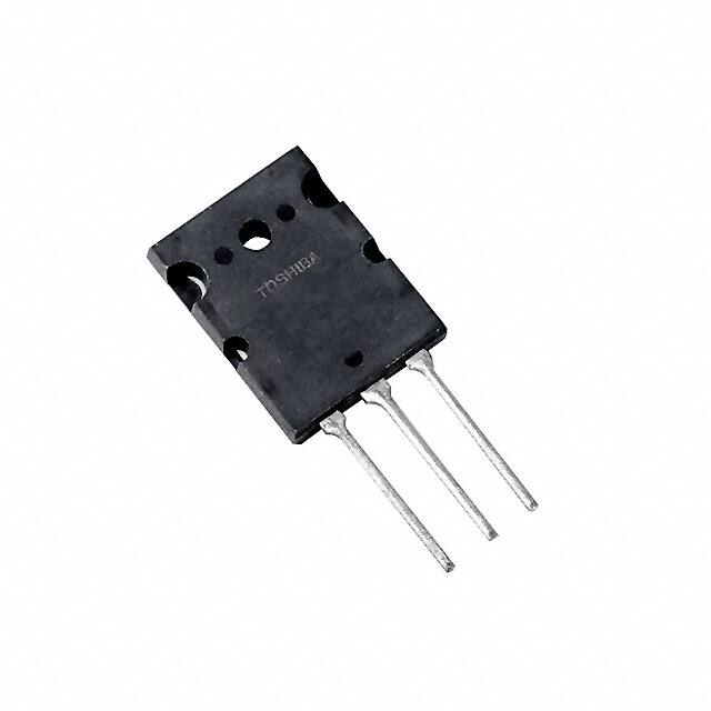

2SC5359 TOSHIBA Transistor Silicon NPN Triple Diffused Type 2SC5359 Power Amplifier Applications Unit: mm • High breakdown voltage: VCEO = 230 V • Complementary to 2SA1987 • Suitable for use in 100-W high fidelity audio amplifier’s output stage. Absolute Maximum Ratings (Ta = 25°C) Characteristics Symbol Rating Unit Collector-base voltage VCBO 230 V Collector-emitter voltage VCEO 230 V Emitter-base voltage VEBO 5 V Collector current IC 15 A Base current IB 1.5 A PC 180 W Tj 150 °C Tstg −55 to 150 °C Collector power dissipation (Tc = 25°C) Junction temperature Storage temperature range JEDEC ― JEITA ― TOSHIBA 2-21F1A Note: Using continuously under heavy loads (e.g. the application of high Weight: 9.75 g (typ.) temperature/current/voltage and the significant change in temperature, etc.) may cause this product to decrease in the reliability significantly even if the operating conditions (i.e. operating temperature/current/voltage, etc.) are within the absolute maximum ratings. Please design the appropriate reliability upon reviewing the Toshiba Semiconductor Reliability Handbook (“Handling Precautions”/Derating Concept and Methods) and individual reliability data (i.e. reliability test report and estimated failure rate, etc). Start of commercial production 1995-12 1 2013-11-01 2SC5359 Electrical Characteristics (Ta = 25°C) Characteristics Symbol Test Condition Min Typ. Max Unit Collector cut-off current ICBO VCB = 230 V, IE = 0 ― ― 5.0 μA Emitter cut-off current IEBO VEB = 5 V, IC = 0 ― ― 5.0 μA V (BR) CEO IC = 50 mA, IB = 0 230 ― ― V VCE = 5 V, IC = 1 A 55 ― 160 hFE (2) VCE = 5 V, IC = 7 A 35 87 ― VCE (sat) IC = 8 A, IB = 0.8 A ― 0.4 3.0 V Base-emitter voltage VBE VCE = 5 V, IC = 7 A ― 1.0 1.5 V Transition frequency fT VCE = 5 V, IC = 1 A ― 30 ― MHz VCB = 10 V, IE = 0, f = 1 MHz ― 200 ― pF Collector-emitter breakdown voltage hFE (1) DC current gain (Note 1) Collector-emitter saturation voltage Collector output capacitance Note 1:hFE (1) classification Cob R: 55 to 110, O: 80 to 160 Marking Part No. (or abbreviation code) TOSHIBA 2SC5359 Lot No. JAPAN Note 2 Note 2: A line under a Lot No. identifies the indication of product Labels. Not underlined : [[Pb]]/INCLUDES > MCV Underlined : [[G]]/RoHS COMPATIBLE or [[G]]/RoHS [[Pb]] Please contact your TOSHIBA sales representative for details as to environmental matters such as the RoHS compatibility of Product. The RoHS is the Directive 2011/65/EU of the European Parliament and of the Council of 8 June 2011 on the restriction of the use of certain hazardous substances in electrical and electronic equipment. 2 2013-11-01 2SC5359 IC – VCE IC – VBE 20 20 Common emitter VCE = 5 V 16 600 400 12 (A) 800 Collector current IC Collector current IC (A) Common emitter Tc = 25°C 300 250 200 150 100 8 IB = 10 mA 50 40 30 4 16 12 Tc = 100°C 8 4 25 20 −25 0 0 2 4 6 8 Collector-emitter voltage 0 0 10 0.4 VCE (V) 0.8 Base-emitter voltage 3 300 1 0.3 Tc = 100°C −25 25 0.03 Common emitter 0.1 2.0 VBE (V) 10 1 Collector current IC Tc = 100°C 100 25 30 −25 10 3 Common emitter VCE = 5 V IC/IB = 10 0.01 0.01 1.6 hFE – IC DC current gain hFE Collector-emitter saturation voltage VCE (sat) (V) VCE (sat) – IC 0.1 1.2 1 0.01 100 (A) 0.1 1 Collector current IC 10 100 (A) Safe Operating Area 100 30 IC max (pulsed)* 1 ms* IC max (continuous) 10 ms* Collector current IC (A) 10 100 ms* 3 DC operation Tc = 25°C 1 0.3 0.1 0.03 0.01 1 *: Single nonrepetitive pulse Tc = 25°C Curves must be derated linearly with increase in temperature. 3 10 30 VCEO max 100 Collector-emitter voltage 300 1000 3000 VCE (V) 3 2013-11-01 2SC5359 RESTRICTIONS ON PRODUCT USE • Toshiba Corporation, and its subsidiaries and affiliates (collectively "TOSHIBA"), reserve the right to make changes to the information in this document, and related hardware, software and systems (collectively "Product") without notice. • This document and any information herein may not be reproduced without prior written permission from TOSHIBA. Even with TOSHIBA's written permission, reproduction is permissible only if reproduction is without alteration/omission. • Though TOSHIBA works continually to improve Product's quality and reliability, Product can malfunction or fail. Customers are responsible for complying with safety standards and for providing adequate designs and safeguards for their hardware, software and systems which minimize risk and avoid situations in which a malfunction or failure of Product could cause loss of human life, bodily injury or damage to property, including data loss or corruption. Before customers use the Product, create designs including the Product, or incorporate the Product into their own applications, customers must also refer to and comply with (a) the latest versions of all relevant TOSHIBA information, including without limitation, this document, the specifications, the data sheets and application notes for Product and the precautions and conditions set forth in the "TOSHIBA Semiconductor Reliability Handbook" and (b) the instructions for the application with which the Product will be used with or for. Customers are solely responsible for all aspects of their own product design or applications, including but not limited to (a) determining the appropriateness of the use of this Product in such design or applications; (b) evaluating and determining the applicability of any information contained in this document, or in charts, diagrams, programs, algorithms, sample application circuits, or any other referenced documents; and (c) validating all operating parameters for such designs and applications. TOSHIBA ASSUMES NO LIABILITY FOR CUSTOMERS' PRODUCT DESIGN OR APPLICATIONS. • PRODUCT IS NEITHER INTENDED NOR WARRANTED FOR USE IN EQUIPMENTS OR SYSTEMS THAT REQUIRE EXTRAORDINARILY HIGH LEVELS OF QUALITY AND/OR RELIABILITY, AND/OR A MALFUNCTION OR FAILURE OF WHICH MAY CAUSE LOSS OF HUMAN LIFE, BODILY INJURY, SERIOUS PROPERTY DAMAGE AND/OR SERIOUS PUBLIC IMPACT ("UNINTENDED USE"). Except for specific applications as expressly stated in this document, Unintended Use includes, without limitation, equipment used in nuclear facilities, equipment used in the aerospace industry, medical equipment, equipment used for automobiles, trains, ships and other transportation, traffic signaling equipment, equipment used to control combustions or explosions, safety devices, elevators and escalators, devices related to electric power, and equipment used in finance-related fields. IF YOU USE PRODUCT FOR UNINTENDED USE, TOSHIBA ASSUMES NO LIABILITY FOR PRODUCT. For details, please contact your TOSHIBA sales representative. • Do not disassemble, analyze, reverse-engineer, alter, modify, translate or copy Product, whether in whole or in part. • Product shall not be used for or incorporated into any products or systems whose manufacture, use, or sale is prohibited under any applicable laws or regulations. • The information contained herein is presented only as guidance for Product use. No responsibility is assumed by TOSHIBA for any infringement of patents or any other intellectual property rights of third parties that may result from the use of Product. No license to any intellectual property right is granted by this document, whether express or implied, by estoppel or otherwise. • ABSENT A WRITTEN SIGNED AGREEMENT, EXCEPT AS PROVIDED IN THE RELEVANT TERMS AND CONDITIONS OF SALE FOR PRODUCT, AND TO THE MAXIMUM EXTENT ALLOWABLE BY LAW, TOSHIBA (1) ASSUMES NO LIABILITY WHATSOEVER, INCLUDING WITHOUT LIMITATION, INDIRECT, CONSEQUENTIAL, SPECIAL, OR INCIDENTAL DAMAGES OR LOSS, INCLUDING WITHOUT LIMITATION, LOSS OF PROFITS, LOSS OF OPPORTUNITIES, BUSINESS INTERRUPTION AND LOSS OF DATA, AND (2) DISCLAIMS ANY AND ALL EXPRESS OR IMPLIED WARRANTIES AND CONDITIONS RELATED TO SALE, USE OF PRODUCT, OR INFORMATION, INCLUDING WARRANTIES OR CONDITIONS OF MERCHANTABILITY, FITNESS FOR A PARTICULAR PURPOSE, ACCURACY OF INFORMATION, OR NONINFRINGEMENT. • Do not use or otherwise make available Product or related software or technology for any military purposes, including without limitation, for the design, development, use, stockpiling or manufacturing of nuclear, chemical, or biological weapons or missile technology products (mass destruction weapons). Product and related software and technology may be controlled under the applicable export laws and regulations including, without limitation, the Japanese Foreign Exchange and Foreign Trade Law and the U.S. Export Administration Regulations. Export and re-export of Product or related software or technology are strictly prohibited except in compliance with all applicable export laws and regulations. • Please contact your TOSHIBA sales representative for details as to environmental matters such as the RoHS compatibility of Product. Please use Product in compliance with all applicable laws and regulations that regulate the inclusion or use of controlled substances, including without limitation, the EU RoHS Directive. TOSHIBA ASSUMES NO LIABILITY FOR DAMAGES OR LOSSES OCCURRING AS A RESULT OF NONCOMPLIANCE WITH APPLICABLE LAWS AND REGULATIONS. 4 2013-11-01
