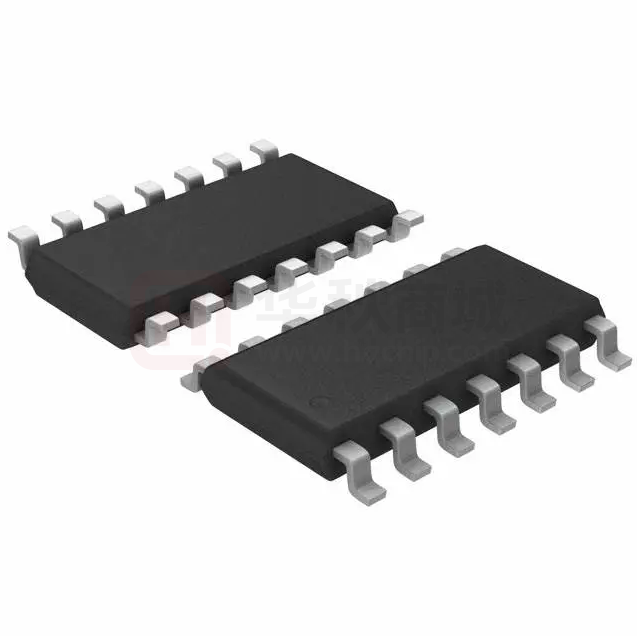

74HC08D CMOS Digital Integrated Circuits Silicon Monolithic 74HC08D 1. Functional Description • Quad 2-Input AND Gate 2. General The 74HC08D is a high speed CMOS 2-INPUT AND GATE fabricated with silicon gate C2MOS technology. It achieves the high speed operation similar to equivalent LSTTL while maintaining the CMOS low power dissipation. The internal circuit is composed of 2-stages including buffer output, which provide high noise immunity and stable output. All inputs are equipped with protection circuits against static discharge or transient excess voltage. 3. Features (1) High speed: tpd = 6 ns (typ.) at VCC = 5 V (2) Low power dissipation: ICC = 1.0 µA (max) at Ta = 25  (3) Balanced propagation delays: tPLH ≈ tPHL (4) Wide operating voltage range: VCC(opr) = 2.0 to 6.0 V 4. Packaging SOIC14 Start of commercial production ©2016 Toshiba Corporation 1 2016-05 2016-08-04 Rev.4.0 74HC08D 5. Pin Assignment 6. Marking 7. IEC Logic Symbol ©2016 Toshiba Corporation 2 2016-08-04 Rev.4.0 74HC08D 8. Truth Table A B Y L L L L H L H L L H H H 9. Absolute Maximum Ratings (Note) Characteristics Symbol Note Rating Unit Supply voltage VCC -0.5 to 7.0 V Input voltage VIN -0.5 to VCC + 0.5 V VOUT -0.5 to VCC + 0.5 V IIK ±20 mA Output diode current IOK ±20 mA Output current IOUT ±25 mA VCC/ground current ICC Power dissipation PD Storage temperature Tstg Output voltage Input diode current (Note 1) ±50 mA 500 mW -65 to 150  Note: Exceeding any of the absolute maximum ratings, even briefly, lead to deterioration in IC performance or even destruction. Using continuously under heavy loads (e.g. the application of high temperature/current/voltage and the significant change in temperature, etc.) may cause this product to decrease in the reliability significantly even if the operating conditions (i.e. operating temperature/current/voltage, etc.) are within the absolute maximum ratings and the operating ranges. Please design the appropriate reliability upon reviewing the Toshiba Semiconductor Reliability Handbook (“Handling Precautions”/“Derating Concept and Methods”) and individual reliability data (i.e. reliability test report and estimated failure rate, etc). Note 1: PD derates linearly with -8 mW/ above 85  10. Operating Ranges (Note) Characteristics Symbol Test Condition Rating Unit Supply voltage VCC  2.0 to 6.0 V Input voltage VIN  0 to VCC V Output voltage VOUT  0 to VCC V Operating temperature Topr  -40 to 125  Input rise and fall times tr,tf  0 to 50 µs Note: The operating ranges must be maintained to ensure the normal operation of the device. Unused inputs and bus inputs must be tied to either VCC or GND. ©2016 Toshiba Corporation 3 2016-08-04 Rev.4.0 74HC08D 11. Electrical Characteristics 11.1. DC Characteristics (Unless otherwise specified, Ta = 25 ) Characteristics High-level input voltage Low-level input voltage High-level output voltage Low-level output voltage Symbol Test Condition VCC (V) Min Typ. Max Unit VIH  2.0 1.50   V 4.5 3.15   6.0 4.20   2.0   0.50 4.5   1.35 VIL VOH VOL  VIN = VIH or VIL VIN = VIH or VIL 6.0   1.80 2.0 1.9 2.0  4.5 4.4 4.5  6.0 5.9 6.0  IOH = -4 mA 4.5 4.18 4.31  IOH = -5.2 mA 6.0 5.68 5.80  IOL = 20 µA 2.0  0.0 0.1 4.5  0.0 0.1 IOH = -20 µA 6.0  0.0 0.1 IOL = 4 mA 4.5  0.17 0.26 IOL = 5.2 mA V V V 6.0  0.18 0.26 Input leakage current IIN VIN = VCC or GND 6.0   ±0.1 µA Quiescent supply current ICC VIN = VCC or GND 6.0   1.0 µA 11.2. DC Characteristics (Unless otherwise specified, Ta = -40 to 85 ) Characteristics High-level input voltage Low-level input voltage High-level output voltage Low-level output voltage Symbol Test Condition VCC (V) Min Max Unit VIH  2.0 1.50  V 4.5 3.15  6.0 4.20  2.0  0.50 4.5  1.35 6.0  1.80 2.0 1.9  4.5 4.4  VIL VOH VOL  VIN = VIH or VIL VIN = VIH or VIL IOH = -20 µA 6.0 5.9  IOH = -4 mA 4.5 4.13  IOH = -5.2 mA 6.0 5.63  IOL = 20 µA 2.0  0.1 4.5  0.1 6.0  0.1 IOL = 4 mA 4.5  0.33 IOL = 5.2 mA 6.0  0.33 V V V Input leakage current IIN VIN = VCC or GND 6.0  ±1.0 µA Quiescent supply current ICC VIN = VCC or GND 6.0  10.0 µA ©2016 Toshiba Corporation 4 2016-08-04 Rev.4.0 74HC08D 11.3. DC Characteristics (Unless otherwise specified, Ta = -40 to 125 ) Characteristics Symbol High-level input voltage Low-level input voltage High-level output voltage Low-level output voltage VIH VIL VOH VOL Test Condition VCC (V) Min Max Unit 2.0 1.50  V 4.5 3.15  6.0 4.20  2.0  0.50 4.5  1.35 6.0  1.80 2.0 1.9  4.5 4.4    VIN = VIH or VIL IOH = -20 µA VIN = VIH or VIL 6.0 5.9  IOH = -4 mA 4.5 3.7  IOH = -5.2 mA 6.0 5.2  IOL = 20 µA 2.0  0.1 4.5  0.1 6.0  0.1 IOL = 4 mA 4.5  0.4 IOL = 5.2 mA 6.0  0.4 V V V Input leakage current IIN VIN = VCC or GND 6.0  ±1.0 µA Quiescent supply current ICC VIN = VCC or GND 6.0  40.0 µA 11.4. AC Characteristics (Unless otherwise specified, CL = 15 pF, VCC = 5 V, Ta = 25 , Input: tr = tf = 6 ns) Characteristics Symbol Test Condition Min Typ. Max Unit Output transition time tTLH,tTHL   Propagation delay time tPLH,tPHL   4 8 ns 6 12 ns 11.5. AC Characteristics (Unless otherwise specified, CL = 50 pF, Ta = 25 , Input: tr = tf = 6 ns) Characteristics Output transition time Propagation delay time Symbol Note tTLH,tTHL tPLH,tPHL Input capacitance CIN Power dissipation capacitance CPD (Note 1) VCC (V) Min Typ. Max Unit 2.0  25 75 ns 4.5  7 15 6.0  6 13 2.0  24 75 4.5  8 15 6.0  7 13   3  pF   7  pF ns Note 1: CPD is defined as the value of the internal equivalent capacitance which is calculated from the operating current consumption without load. Average operating current can be obtained by the equation. ICC(opr) = CPD × VCC × fIN + ICC/4 (per gate) ©2016 Toshiba Corporation 5 2016-08-04 Rev.4.0 74HC08D 11.6. AC Characteristics (Unless otherwise specified, CL = 50 pF, Ta = -40 to 85 , Input: tr = tf = 6 ns) Characteristics Output transition time Propagation delay time Symbol VCC (V) Min Max Unit tTLH,tTHL 2.0  95 ns 4.5  19 6.0  16 2.0  95 4.5  19 6.0  16 tPLH,tPHL ns 11.7. AC Characteristics (Unless otherwise specified, CL = 50 pF, Ta = -40 to 125 , Input: tr = tf = 6 ns) Characteristics Output transition time Propagation delay time ©2016 Toshiba Corporation Symbol VCC (V) Min Max Unit tTLH,tTHL 2.0  110 ns 4.5  22 6.0  19 2.0  135 4.5  27 6.0  23 tPLH,tPHL 6 ns 2016-08-04 Rev.4.0 74HC08D Package Dimensions Unit: mm Weight: 0.13 g (typ.) Package Name(s) Nickname: SOIC14 ©2016 Toshiba Corporation 7 2016-08-04 Rev.4.0 74HC08D RESTRICTIONS ON PRODUCT USE • Toshiba Corporation, and its subsidiaries and affiliates (collectively "TOSHIBA"), reserve the right to make changes to the information in this document, and related hardware, software and systems (collectively "Product") without notice. • This document and any information herein may not be reproduced without prior written permission from TOSHIBA. Even with TOSHIBA's written permission, reproduction is permissible only if reproduction is without alteration/omission. • Though TOSHIBA works continually to improve Product's quality and reliability, Product can malfunction or fail. Customers are responsible for complying with safety standards and for providing adequate designs and safeguards for their hardware, software and systems which minimize risk and avoid situations in which a malfunction or failure of Product could cause loss of human life, bodily injury or damage to property, including data loss or corruption. Before customers use the Product, create designs including the Product, or incorporate the Product into their own applications, customers must also refer to and comply with (a) the latest versions of all relevant TOSHIBA information, including without limitation, this document, the specifications, the data sheets and application notes for Product and the precautions and conditions set forth in the "TOSHIBA Semiconductor Reliability Handbook" and (b) the instructions for the application with which the Product will be used with or for. Customers are solely responsible for all aspects of their own product design or applications, including but not limited to (a) determining the appropriateness of the use of this Product in such design or applications; (b) evaluating and determining the applicability of any information contained in this document, or in charts, diagrams, programs, algorithms, sample application circuits, or any other referenced documents; and (c) validating all operating parameters for such designs and applications. TOSHIBA ASSUMES NO LIABILITY FOR CUSTOMERS' PRODUCT DESIGN OR APPLICATIONS. • PRODUCT IS NEITHER INTENDED NOR WARRANTED FOR USE IN EQUIPMENTS OR SYSTEMS THAT REQUIRE EXTRAORDINARILY HIGH LEVELS OF QUALITY AND/OR RELIABILITY, AND/OR A MALFUNCTION OR FAILURE OF WHICH MAY CAUSE LOSS OF HUMAN LIFE, BODILY INJURY, SERIOUS PROPERTY DAMAGE AND/OR SERIOUS PUBLIC IMPACT ("UNINTENDED USE"). Except for specific applications as expressly stated in this document, Unintended Use includes, without limitation, equipment used in nuclear facilities, equipment used in the aerospace industry, medical equipment, equipment used for automobiles, trains, ships and other transportation, traffic signaling equipment, equipment used to control combustions or explosions, safety devices, elevators and escalators, devices related to electric power, and equipment used in finance-related fields. IF YOU USE PRODUCT FOR UNINTENDED USE, TOSHIBA ASSUMES NO LIABILITY FOR PRODUCT. For details, please contact your TOSHIBA sales representative. • Do not disassemble, analyze, reverse-engineer, alter, modify, translate or copy Product, whether in whole or in part. • Product shall not be used for or incorporated into any products or systems whose manufacture, use, or sale is prohibited under any applicable laws or regulations. • The information contained herein is presented only as guidance for Product use. No responsibility is assumed by TOSHIBA for any infringement of patents or any other intellectual property rights of third parties that may result from the use of Product. No license to any intellectual property right is granted by this document, whether express or implied, by estoppel or otherwise. • ABSENT A WRITTEN SIGNED AGREEMENT, EXCEPT AS PROVIDED IN THE RELEVANT TERMS AND CONDITIONS OF SALE FOR PRODUCT, AND TO THE MAXIMUM EXTENT ALLOWABLE BY LAW, TOSHIBA (1) ASSUMES NO LIABILITY WHATSOEVER, INCLUDING WITHOUT LIMITATION, INDIRECT, CONSEQUENTIAL, SPECIAL, OR INCIDENTAL DAMAGES OR LOSS, INCLUDING WITHOUT LIMITATION, LOSS OF PROFITS, LOSS OF OPPORTUNITIES, BUSINESS INTERRUPTION AND LOSS OF DATA, AND (2) DISCLAIMS ANY AND ALL EXPRESS OR IMPLIED WARRANTIES AND CONDITIONS RELATED TO SALE, USE OF PRODUCT, OR INFORMATION, INCLUDING WARRANTIES OR CONDITIONS OF MERCHANTABILITY, FITNESS FOR A PARTICULAR PURPOSE, ACCURACY OF INFORMATION, OR NONINFRINGEMENT. • Do not use or otherwise make available Product or related software or technology for any military purposes, including without limitation, for the design, development, use, stockpiling or manufacturing of nuclear, chemical, or biological weapons or missile technology products (mass destruction weapons). Product and related software and technology may be controlled under the applicable export laws and regulations including, without limitation, the Japanese Foreign Exchange and Foreign Trade Law and the U.S. Export Administration Regulations. Export and re-export of Product or related software or technology are strictly prohibited except in compliance with all applicable export laws and regulations. • Please contact your TOSHIBA sales representative for details as to environmental matters such as the RoHS compatibility of Product. Please use Product in compliance with all applicable laws and regulations that regulate the inclusion or use of controlled substances, including without limitation, the EU RoHS Directive. TOSHIBA ASSUMES NO LIABILITY FOR DAMAGES OR LOSSES OCCURRING AS A RESULT OF NONCOMPLIANCE WITH APPLICABLE LAWS AND REGULATIONS. ©2016 Toshiba Corporation 8 2016-08-04 Rev.4.0

文档中描述的物料型号为TOSHIBA的74HC08D。
这是一款四2输入AND门逻辑集成电路。
引脚分配如下: 1. 引脚1:GND(地) 2. 引脚2:I0(输入端) 3. 引脚3:I1(输入端) 4. 引脚4:Y(输出端) 5. 引脚5:I2(输入端) 6. 引脚6:I3(输入端) 7. 引脚7:Y(输出端) 8. 引脚8:Vcc(电源) 参数特性包括: - 电源电压范围:2V至6V - 低电平输入电流:-200μA至0μA - 高电平输入电流:0μA至200μA - 输出低电平电流:-400μA - 输出高电平电流:0μA - 最大功耗:160mW - 工作温度范围:-40°C至+85°C 功能详解为四2输入AND门,即当所有输入端接收到的信号均为高电平时,输出端才为高电平,否则输出为低电平。
应用信息包括:广泛应用于数字电路中进行逻辑运算,如与运算、数据选择、数据编码等。
封装信息为SOIC-8封装,具有较小的体积和较高的集成度。
