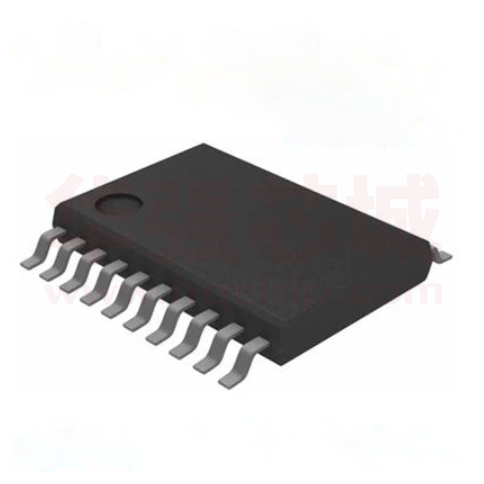

74LCX244FT(AJ)
74LCX244FT(AJ)
    TOSHIBA(东芝)
    TSSOP-20
    缓冲器/驱动器 TSSOP-20
74LCX244FT(AJ) 数据手册
74LCX244FT CMOS Digital Integrated Circuits Silicon Monolithic 74LCX244FT 1. Functional Description • Low-Voltage Octal Bus Buffer with 5-V Tolerant Inputs and Outputs 2. General The 74LCX244FT is a high-performance CMOS octal bus buffer. Designed for use in 3.3-V systems, it achieves high-speed operation while maintaining the CMOS low power dissipation. The device is designed for low-voltage (3.3 V) VCC applications, but it could be used to interface to 5 V supply environment for both inputs and outputs. The 74LCX244FT is a non-inverting 3-state buffer having two active-low output enables. This device is designed to be used with 3-state memory address drivers, etc. All inputs are equipped with protection circuits against static discharge. 3. Features (1) Low-voltage operation: VCC = 1.65 to 3.6 V (2) High-speed operation: tpd = 6.5 ns (max) (VCC = 3.0 to 3.6 V) (3) Output current: |IOH|/IOL = 24 mA (min) (VCC = 3.0 V) (4) Power-down protection provided on all inputs and outputs (5) Pin and function compatible with the 74 series (74LVC/ALVC/ etc.) 244 type 4. Packaging TSSOP20B Start of commercial production 1 2013-10 2014-09-02 Rev.3.0 74LCX244FT 5. Pin Assignment 6. Marking 7. IEC Logic Symbol 2 2014-09-02 Rev.3.0 74LCX244FT 8. Truth Table Inputs OE X: Z: Inputs An Outputs L L L L H H H X Z Don't care High impedance 9. Absolute Maximum Ratings (Note) Characteristics Supply voltage Input voltage Output voltage Input diode current Symbol VCC VIN VOUT IOK Output current IOUT VCC/ground current Storage temperature Rating Unit -0.5 to 6.5 V -0.5 to 6.5 V (Note 1) -0.5 to 6.5 V (Note 2) -0.5 to VCC + 0.5 IIK Output diode current Power dissipation Note (Note 3) -50 mA ±50 mA ±50 mA PD 180 mW ICC/IGND ±100 mA Tstg -65 to 150  Note: Exceeding any of the absolute maximum ratings, even briefly, lead to deterioration in IC performance or even destruction. Using continuously under heavy loads (e.g. the application of high temperature/current/voltage and the significant change in temperature, etc.) may cause this product to decrease in the reliability significantly even if the operating conditions (i.e. operating temperature/current/voltage, etc.) are within the absolute maximum ratings and the operating ranges. Please design the appropriate reliability upon reviewing the Toshiba Semiconductor Reliability Handbook (“Handling Precautions”/“Derating Concept and Methods”) and individual reliability data (i.e. reliability test report and estimated failure rate, etc). Note 1: Output in OFF state. Note 2: High (H) or Low (L) state. IOUT absolute maximum rating must be observed. Note 3: VOUT < GND, VOUT > VCC 3 2014-09-02 Rev.3.0 74LCX244FT 10. Operating Ranges (Note) Characteristics Symbol Supply voltage Note VCC Rating Unit 1.65 to 3.6 V (Note 1) Input voltage 1.5 to 3.6 VIN Output voltage VOUT Output current IOH,IOL 0 to 5.5 V (Note 2) 0 to 5.5 V (Note 3) 0 to VCC (Note 4) ±24 (Note 5) Operating temperature Topr Input rise and fall times dt/dv mA ±12 -40 to 85  0 to 10 ns/V (Note 6) Note: The operating ranges must be maintained to ensure the normal operation of the device. Unused inputs must be tied to either VCC or GND. Note 1: Data retention only. Note 2: Output in OFF state. Note 3: High or low state Note 4: VCC = 3.0 to 3.6 V Note 5: VCC = 2.7 to 3.0 V Note 6: VIN =0.8 to 2.0 V , VCC = 3.0 V 11. Electrical Characteristics ) 85 11.1. DC Characteristics (Unless otherwise specified, Ta = -40 to 85 Characteristics High-level input voltage Low-level input voltage High-level output voltage Low-level output voltage Symbol Test Condition VIH  VIL VOH VOL VCC (V)  VIN = VIH or VIL Max Unit 1.65 to 2.3 VCC × 0.9  V 2.3 to 2.7 1.7  2.7 to 3.6 2.0  1.65 to 2.3  VCC × 0.1 2.3 to 2.7  0.7 2.7 to 3.6  0.8 1.65 to 3.6 VCC - 0.2  IOH = -4 mA 1.65 1.05  IOH = -8 mA 2.3 1.7  IOH = -12 mA 2.7 2.2  IOH = -18 mA 3.0 2.4  IOH = -24 mA 3.0 2.2  IOL = 100 µA 1.65 to 3.6  0.2 IOL = 4 mA 1.65  0.45 IOL = 8 mA 2.3  0.7 IOL = 12 mA 2.7  0.4 IOL = 16 mA 3.0  0.4 IOH = -100 µA VIN = VIH or VIL Min IOL = 24 mA V V V 3.0  0.55 Input leakage current IIN VIN = 0 to 5.5 V 1.65 to 3.6  ±5.0 µA 3-state output OFF-state leakage current IOZ VIN = VIH or VIL VOUT = 0 to 5.5 V 1.65 to 3.6  ±5.0 µA Power-OFF leakage current IOFF VIN/VOUT = 5.5 V 0  10.0 µA Quiescent supply current ICC VIN = VCC or GND 1.65 to 3.6  10.0 µA VIN/VOUT = 3.6 to 5.5 V 1.65 to 3.6  ±10.0 Quiescent supply current ∆ICC VIH = VCC - 0.6 V (per input) 2.7 to 3.6  500 4 µA 2014-09-02 Rev.3.0 74LCX244FT ) 11.2. AC Characteristics (Unless otherwise specified, Ta = -40 to 85 85 Characteristics Propagation delay time 3-state output enable time 3-state output disable time Output skew Symbol Note tPLH,tPHL Test Condition See 11.5 AC Test Circuit, Table 11.5.1, Fig. 11.6.1, Table 11.6.1 tPZL,tPZH See 11.5 AC Test Circuit, Table 11.5.1, Fig. 11.6.2, Table 11.6.1 tPLZ,tPHZ See 11.5 AC Test Circuit, Table 11.5.1, Fig. 11.6.2, Table 11.6.1 tosLH,tosHL (Note 1)  VCC (V) Min Max Unit 1.8 ± 0.15  25.0 ns 2.5 ± 0.2  8.5 2.7  7.5 3.3 ± 0.3 1.5 6.5 1.8 ± 0.15  32.0 2.5 ± 0.2  16.0 2.7  9.0 3.3 ± 0.3 1.5 8.0 1.8 ± 0.15  30.0 2.5 ± 0.2  15.0 2.7  8.0 3.3 ± 0.3 1.5 7.0 2.7   3.3 ± 0.3  1.0 ns ns ns Note 1: Parameter guaranteed by design. (tosLH = |tPLHm - tPLHn|, tosHL = |tPHLm - tPHLn|) , Input: tr 11.3. Dynamic Switching Characteristics (Unless otherwise specified, Ta = 25 25 = tf = 2.5 ns, CL = 50 pF, RL = 500 Ω) Characteristics Symbol Test Condition VCC (V) Typ. Unit Quiet output maximum dynamic VOL VOLP VIH = 3.3 V, VIL = 0 V 3.3 0.8 V Quiet output minimum dynamic VOL |VOLV| VIH = 3.3 V, VIL = 0 V 3.3 0.8 V VCC (V) Typ. Unit 3.3 7 pF 3.3 8 pF 3.3 25 pF ) 25 11.4. Capacitive Characteristics (Unless otherwise specified, Ta = 25 Characteristics Input capacitance Symbol Note Test Condition CIN Output capacitance COUT Power dissipation capacitance CPD (Note 1) fIN = 10 MHz Note 1: CPD is defined as the value of the internal equivalent capacitance which is calculated from the operating current consumption without load. Average operating current can be obtained by the equation. ICC(opr) = CPD × VCC × fIN + ICC/8 (per bit) 5 2014-09-02 Rev.3.0 74LCX244FT 11.5. AC Test Ciruict Table 11.5.1 Parameter for AC Test Circuit Parameter Switch Test Condition tPLH, tPHL OPEN  tPLZ, tPZL 6.0 V VCC = 3.3 ± 0.3 V VCC = 2.7 V VCC × 2 VCC = 2.5 ± 0.2 V VCC = 1.8 ± 0.15 V tPHZ, tPZH GND 6  2014-09-02 Rev.3.0 74LCX244FT 11.6. AC Waveform Fig. 11.6.1 tPLH, tPHL Fig. 11.6.2 tPLZ, tPHZ, tPZL, tPZH Table 11.6.1 AC Waveform Symbols Input Output Load Symbol VCC = 3.3 ± 0.3 V VCC = 2.7 V VCC = 2.5 ± 0.2 V VCC = 1.8 ± 0.15 V VIH 2.7 V VCC VCC VIM 1.5 V VCC/2 VCC/2 tr, tf 2.5 ns 2.0 ns 2.0 ns VOM 1.5 V VOH/2 VOH/2 VX VOL + 0.3 V VOL + 0.15 V VOL + 0.15 V VY VOH - 0.3 V VOH - 0.15 V VOH - 0.15 V CL 50 pF 30 pF 30 pF RL 500 Ω 500 Ω 1 kΩ 7 2014-09-02 Rev.3.0 74LCX244FT Package Dimensions Unit: mm Weight: 0.071 g (typ.) Package Name(s) Nickname: TSSOP20B 8 2014-09-02 Rev.3.0 74LCX244FT RESTRICTIONS ON PRODUCT USE • Toshiba Corporation, and its subsidiaries and affiliates (collectively "TOSHIBA"), reserve the right to make changes to the information in this document, and related hardware, software and systems (collectively "Product") without notice. • This document and any information herein may not be reproduced without prior written permission from TOSHIBA. Even with TOSHIBA's written permission, reproduction is permissible only if reproduction is without alteration/omission. • Though TOSHIBA works continually to improve Product's quality and reliability, Product can malfunction or fail. Customers are responsible for complying with safety standards and for providing adequate designs and safeguards for their hardware, software and systems which minimize risk and avoid situations in which a malfunction or failure of Product could cause loss of human life, bodily injury or damage to property, including data loss or corruption. Before customers use the Product, create designs including the Product, or incorporate the Product into their own applications, customers must also refer to and comply with (a) the latest versions of all relevant TOSHIBA information, including without limitation, this document, the specifications, the data sheets and application notes for Product and the precautions and conditions set forth in the "TOSHIBA Semiconductor Reliability Handbook" and (b) the instructions for the application with which the Product will be used with or for. Customers are solely responsible for all aspects of their own product design or applications, including but not limited to (a) determining the appropriateness of the use of this Product in such design or applications; (b) evaluating and determining the applicability of any information contained in this document, or in charts, diagrams, programs, algorithms, sample application circuits, or any other referenced documents; and (c) validating all operating parameters for such designs and applications. TOSHIBA ASSUMES NO LIABILITY FOR CUSTOMERS' PRODUCT DESIGN OR APPLICATIONS. • PRODUCT IS NEITHER INTENDED NOR WARRANTED FOR USE IN EQUIPMENTS OR SYSTEMS THAT REQUIRE EXTRAORDINARILY HIGH LEVELS OF QUALITY AND/OR RELIABILITY, AND/OR A MALFUNCTION OR FAILURE OF WHICH MAY CAUSE LOSS OF HUMAN LIFE, BODILY INJURY, SERIOUS PROPERTY DAMAGE AND/OR SERIOUS PUBLIC IMPACT ("UNINTENDED USE"). Except for specific applications as expressly stated in this document, Unintended Use includes, without limitation, equipment used in nuclear facilities, equipment used in the aerospace industry, medical equipment, equipment used for automobiles, trains, ships and other transportation, traffic signaling equipment, equipment used to control combustions or explosions, safety devices, elevators and escalators, devices related to electric power, and equipment used in finance-related fields. IF YOU USE PRODUCT FOR UNINTENDED USE, TOSHIBA ASSUMES NO LIABILITY FOR PRODUCT. For details, please contact your TOSHIBA sales representative. • Do not disassemble, analyze, reverse-engineer, alter, modify, translate or copy Product, whether in whole or in part. • Product shall not be used for or incorporated into any products or systems whose manufacture, use, or sale is prohibited under any applicable laws or regulations. • The information contained herein is presented only as guidance for Product use. No responsibility is assumed by TOSHIBA for any infringement of patents or any other intellectual property rights of third parties that may result from the use of Product. No license to any intellectual property right is granted by this document, whether express or implied, by estoppel or otherwise. • ABSENT A WRITTEN SIGNED AGREEMENT, EXCEPT AS PROVIDED IN THE RELEVANT TERMS AND CONDITIONS OF SALE FOR PRODUCT, AND TO THE MAXIMUM EXTENT ALLOWABLE BY LAW, TOSHIBA (1) ASSUMES NO LIABILITY WHATSOEVER, INCLUDING WITHOUT LIMITATION, INDIRECT, CONSEQUENTIAL, SPECIAL, OR INCIDENTAL DAMAGES OR LOSS, INCLUDING WITHOUT LIMITATION, LOSS OF PROFITS, LOSS OF OPPORTUNITIES, BUSINESS INTERRUPTION AND LOSS OF DATA, AND (2) DISCLAIMS ANY AND ALL EXPRESS OR IMPLIED WARRANTIES AND CONDITIONS RELATED TO SALE, USE OF PRODUCT, OR INFORMATION, INCLUDING WARRANTIES OR CONDITIONS OF MERCHANTABILITY, FITNESS FOR A PARTICULAR PURPOSE, ACCURACY OF INFORMATION, OR NONINFRINGEMENT. • Do not use or otherwise make available Product or related software or technology for any military purposes, including without limitation, for the design, development, use, stockpiling or manufacturing of nuclear, chemical, or biological weapons or missile technology products (mass destruction weapons). Product and related software and technology may be controlled under the applicable export laws and regulations including, without limitation, the Japanese Foreign Exchange and Foreign Trade Law and the U.S. Export Administration Regulations. Export and re-export of Product or related software or technology are strictly prohibited except in compliance with all applicable export laws and regulations. • Please contact your TOSHIBA sales representative for details as to environmental matters such as the RoHS compatibility of Product. Please use Product in compliance with all applicable laws and regulations that regulate the inclusion or use of controlled substances, including without limitation, the EU RoHS Directive. TOSHIBA ASSUMES NO LIABILITY FOR DAMAGES OR LOSSES OCCURRING AS A RESULT OF NONCOMPLIANCE WITH APPLICABLE LAWS AND REGULATIONS. 9 2014-09-02 Rev.3.0
