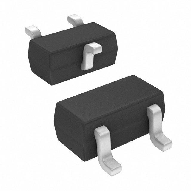

RN1114 to RN1118 Bipolar Transistors Silicon NPN Epitaxial Type (PCT Process)(Bias Resistor built-in Transistor) RN1114/15/16/17/18 1. Applications • Switching • Inverter Circuits • Interfacing • Driver Circuits 2. Features (1) AEC-Q101 qualified (Please see the orderable part number list) (2) The integrated bias resistor reduces the number of external parts required, making it possible to reduce system size and assembly time. (3) Toshiba offers transistors with a wide range of resistance to accommodate various circuit designs. (4) Complementary to RN2114 to RN2118 3. Equivalent Circuit 4. Bias Resistor Values R1 (kΩ) R2 (kΩ) RN1114 1 10 RN1115 2.2 10 RN1116 4.7 10 RN1117 10 4.7 RN1118 47 10 Part No. Start of commercial production 1994-08 ©2021 Toshiba Electronic Devices & Storage Corporation 1 2021-08-30 Rev.1.0 RN1114 to RN1118 5. Packaging and Pin Assignment 1: Base 2: Emitter 3: Collector SSM 6. Orderable part number Orderable part number RN1114 AEC-Q101 RN1114,LF � RN1114,LXGF RN1115 RN1116 RN1117 YES RN1115,LF RN1115,LXGF YES RN1115,LXHF YES RN1116,LF (Note 1) YES RN1116,LXHF YES RN1117(TE85L,F) (Note 1) YES YES Unintended Use (Note 1) General Use (Note 1) Unintended Use (Note 1) Automotive Use General Use (Note 1) � � (Note 1) Automotive Use � RN1118(TE85L,F) Unintended Use General Use � RN1116,LXGF Note General Use � � RN1118 Note Unintended Use (Note 1) General Use (Note 1) Unintended Use (Note 1) Note 1: For more information, please contact our sales or use the inquiry form on our website. ©2021 Toshiba Electronic Devices & Storage Corporation 2 2021-08-30 Rev.1.0 RN1114 to RN1118 7. Absolute Maximum Ratings (Note) (Unless otherwise specified, T a = 25 �) Characteristics Collector-base voltage RN1114~RN1118 Collector-emitter voltage Emitter-base voltage RN1114 Symbol Rating Unit VCBO 50 V VCEO 50 VEBO 5 RN1115 RN1116 7 RN1117 15 RN1118 Collector current 25 IC 100 mA Collector power dissipation PC 100 mW Junction temperature Tj 150 � Storage temperature Tstg -55 to 150 Note: RN1114~RN1118 V 6 Using continuously under heavy loads (e.g. the application of high temperature/current/voltage and the significant change in temperature, etc.) may cause this product to decrease in the reliability significantly even if the operating conditions (i.e. operating temperature/current/voltage, etc.) are within the absolute maximum ratings. Please design the appropriate reliability upon reviewing the Toshiba Semiconductor Reliability Handbook ("Handling Precautions"/"Derating Concept and Methods") and individual reliability data (i.e. reliability test report and estimated failure rate, etc). ©2021 Toshiba Electronic Devices & Storage Corporation 3 2021-08-30 Rev.1.0 RN1114 to RN1118 8. Electrical Characteristics (Unless otherwise specified, T a = 25 �) Characteristics Collector cut-off current Emitter cut-off current Symbol Input voltage (ON) nA � � 100 VCE = 50 V, IB = 0 mA � � 500 RN1114 IEBO VEB = 5 V, IC = 0 mA 0.35 � 0.65 RN1115 VEB = 6 V, IC = 0 mA 0.37 � 0.71 RN1116 VEB = 7 V, IC = 0 mA 0.36 � 0.68 RN1117 VEB = 15 V, IC = 0 mA 0.78 � 1.46 VEB = 25 V, IC = 0 mA 0.33 � 0.63 VCE = 5 V, IC = 10 mA 50 � � 30 � � RN1114�RN1116, RN1118 hFE mA � RN1114~ RN1118 VCE(sat) IC = 5 mA, IB = 0.25 mA � 0.1 0.3 V RN1114 VI(ON) VCE = 0.2 V, IC = 5 mA V 0.6 � 2.0 RN1115 0.7 � 2.5 RN1116 0.8 � 2.5 RN1117 1.5 � 3.5 2.5 � 10.0 0.3 � 0.9 RN1115 0.3 � 1.0 RN1116 0.3 � 1.1 RN1117 0.3 � 2.3 RN1118 0.5 � 5.7 VCE = 10 V, IC = 5 mA � 250 � MHz VCB = 10 V, IE = 0 mA, f = 1 MHz � 3.0 6.0 pF kΩ RN1114 VI(OFF) RN1114~ RN1118 fT Collector output capacitance RN1114~ RN1118 Cob RN1114 R1 VCE = 5 V, IC = 0.1 mA 0.7 1.0 1.3 RN1115 � 1.54 2.2 2.86 RN1116 3.29 4.7 6.11 RN1117 7.0 10.0 13.0 32.9 47.0 61.1 � 0.1 � RN1115 � 0.22 � RN1116 � 0.47 � RN1117 � 2.13 � RN1118 � 4.7 � RN1118 Resistor ratio Unit VCB = 50 V, IE = 0 mA Transition frequency Input resistance Max ICEO RN1118 Input voltage (OFF) Typ. ICBO RN1117 Collector-emitter saturation voltage Min RN1114~ RN1118 RN1118 DC current gain Test Condition RN1114 ©2021 Toshiba Electronic Devices & Storage Corporation R1/R2 � 4 V � 2021-08-30 Rev.1.0 RN1114 to RN1118 9. Marking Fig. 9.1 Marking RN1114 Fig. 9.2 Marking RN1115 Fig. 9.3 Marking RN1116 Fig. 9.4 Marking RN1117 Fig. 9.5 Marking RN1118 ©2021 Toshiba Electronic Devices & Storage Corporation 5 2021-08-30 Rev.1.0 RN1114 to RN1118 10. Characteristics Curves (Note) Fig. 10.1 RN1114 I C -V I(ON) Fig. 10.2 RN1115 I C -V I(ON) Fig. 10.3 RN1116 I C -V I(ON) Fig. 10.4 RN1117 I C -V I(ON) Fig. 10.5 RN1118 I C -V I(ON) ©2021 Toshiba Electronic Devices & Storage Corporation 6 2021-08-30 Rev.1.0 RN1114 to RN1118 Fig. 10.6 RN1114 I C -V I(OFF) Fig. 10.7 RN1115 I C -V I(OFF) Fig. 10.8 RN1116 I C -V I(OFF) Fig. 10.9 RN1117 I C -V I(OFF) Fig. 10.10 RN1118 I C -V I(OFF) ©2021 Toshiba Electronic Devices & Storage Corporation 7 2021-08-30 Rev.1.0 RN1114 to RN1118 Fig. 10.11 RN1114 h FE -I C Fig. 10.12 RN1115 h FE -I C Fig. 10.13 RN1116 h FE -I C Fig. 10.14 RN1117 h FE -I C Fig. 10.15 RN1118 h FE -I C ©2021 Toshiba Electronic Devices & Storage Corporation 8 2021-08-30 Rev.1.0 RN1114 to RN1118 Note: Fig. 10.16 RN1114 V CE(sat) -I C Fig. 10.17 RN1115 V CE(sat) -I C Fig. 10.18 RN1116 V CE(sat) -I C Fig. 10.19 RN1117 V CE(sat) -I C Fig. 10.20 RN1118 V CE(sat) -I C The above characteristics curves are presented for reference only and not guaranteed by production test, unless otherwise noted. ©2021 Toshiba Electronic Devices & Storage Corporation 9 2021-08-30 Rev.1.0 RN1114 to RN1118 Package Dimensions Unit: mm Weight: 2.4 mg (typ.) Package Name(s) TOSHIBA: 2-2H1S Nickname: SSM ©2021 Toshiba Electronic Devices & Storage Corporation 10 2021-08-30 Rev.1.0 RN1114 to RN1118 RESTRICTIONS ON PRODUCT USE Toshiba Corporation and its subsidiaries and affiliates are collectively referred to as "TOSHIBA". Hardware, software and systems described in this document are collectively referred to as "Product". • TOSHIBA reserves the right to make changes to the information in this document and related Product without notice. • This document and any information herein may not be reproduced without prior written permission from TOSHIBA. Even with TOSHIBA's written permission, reproduction is permissible only if reproduction is without alteration/omission. • Though TOSHIBA works continually to improve Product's quality and reliability, Product can malfunction or fail. Customers are responsible for complying with safety standards and for providing adequate designs and safeguards for their hardware, software and systems which minimize risk and avoid situations in which a malfunction or failure of Product could cause loss of human life, bodily injury or damage to property, including data loss or corruption. Before customers use the Product, create designs including the Product, or incorporate the Product into their own applications, customers must also refer to and comply with (a) the latest versions of all relevant TOSHIBA information, including without limitation, this document, the specifications, the data sheets and application notes for Product and the precautions and conditions set forth in the "TOSHIBA Semiconductor Reliability Handbook" and (b) the instructions for the application with which the Product will be used with or for. Customers are solely responsible for all aspects of their own product design or applications, including but not limited to (a) determining the appropriateness of the use of this Product in such design or applications; (b) evaluating and determining the applicability of any information contained in this document, or in charts, diagrams, programs, algorithms, sample application circuits, or any other referenced documents; and (c) validating all operating parameters for such designs and applications. TOSHIBA ASSUMES NO LIABILITY FOR CUSTOMERS' PRODUCT DESIGN OR APPLICATIONS. • PRODUCT IS NEITHER INTENDED NOR WARRANTED FOR USE IN EQUIPMENTS OR SYSTEMS THAT REQUIRE EXTRAORDINARILY HIGH LEVELS OF QUALITY AND/OR RELIABILITY, AND/OR A MALFUNCTION OR FAILURE OF WHICH MAY CAUSE LOSS OF HUMAN LIFE, BODILY INJURY, SERIOUS PROPERTY DAMAGE AND/OR SERIOUS PUBLIC IMPACT ("UNINTENDED USE"). Except for specific applications as expressly stated in this document, Unintended Use includes, without limitation, equipment used in nuclear facilities, equipment used in the aerospace industry, lifesaving and/or life supporting medical equipment, equipment used for automobiles, trains, ships and other transportation, traffic signaling equipment, equipment used to control combustions or explosions, safety devices, elevators and escalators, and devices related to power plant. IF YOU USE PRODUCT FOR UNINTENDED USE, TOSHIBA ASSUMES NO LIABILITY FOR PRODUCT. For details, please contact your TOSHIBA sales representative or contact us via our website. • Do not disassemble, analyze, reverse-engineer, alter, modify, translate or copy Product, whether in whole or in part. • Product shall not be used for or incorporated into any products or systems whose manufacture, use, or sale is prohibited under any applicable laws or regulations. • The information contained herein is presented only as guidance for Product use. No responsibility is assumed by TOSHIBA for any infringement of patents or any other intellectual property rights of third parties that may result from the use of Product. No license to any intellectual property right is granted by this document, whether express or implied, by estoppel or otherwise. • ABSENT A WRITTEN SIGNED AGREEMENT, EXCEPT AS PROVIDED IN THE RELEVANT TERMS AND CONDITIONS OF SALE FOR PRODUCT, AND TO THE MAXIMUM EXTENT ALLOWABLE BY LAW, TOSHIBA (1) ASSUMES NO LIABILITY WHATSOEVER, INCLUDING WITHOUT LIMITATION, INDIRECT, CONSEQUENTIAL, SPECIAL, OR INCIDENTAL DAMAGES OR LOSS, INCLUDING WITHOUT LIMITATION, LOSS OF PROFITS, LOSS OF OPPORTUNITIES, BUSINESS INTERRUPTION AND LOSS OF DATA, AND (2) DISCLAIMS ANY AND ALL EXPRESS OR IMPLIED WARRANTIES AND CONDITIONS RELATED TO SALE, USE OF PRODUCT, OR INFORMATION, INCLUDING WARRANTIES OR CONDITIONS OF MERCHANTABILITY, FITNESS FOR A PARTICULAR PURPOSE, ACCURACY OF INFORMATION, OR NONINFRINGEMENT. • Do not use or otherwise make available Product or related software or technology for any military purposes, including without limitation, for the design, development, use, stockpiling or manufacturing of nuclear, chemical, or biological weapons or missile technology products (mass destruction weapons). Product and related software and technology may be controlled under the applicable export laws and regulations including, without limitation, the Japanese Foreign Exchange and Foreign Trade Law and the U.S. Export Administration Regulations. Export and re-export of Product or related software or technology are strictly prohibited except in compliance with all applicable export laws and regulations. • Please contact your TOSHIBA sales representative for details as to environmental matters such as the RoHS compatibility of Product. Please use Product in compliance with all applicable laws and regulations that regulate the inclusion or use of controlled substances, including without limitation, the EU RoHS Directive. TOSHIBA ASSUMES NO LIABILITY FOR DAMAGES OR LOSSES OCCURRING AS A RESULT OF NONCOMPLIANCE WITH APPLICABLE LAWS AND REGULATIONS. https://toshiba.semicon-storage.com/ ©2021 Toshiba Electronic Devices & Storage Corporation 11 2021-08-30 Rev.1.0

1. 物料型号:RN1116 2. 器件简介:RN1116是一款内置偏置电阻的硅NPN外延型双极晶体管,适用于开关、反相器电路、接口和驱动电路。 3. 引脚分配:1号引脚为基极(Base),2号引脚为发射极(Emitter),3号引脚为集电极(Collector)。 4. 参数特性: - 集电极-基极电压(VCBO):50V - 集电极-发射极电压(VCEO):50V - 发射极-基极电压(VEBO):7V - 集电极电流(Ic):100mA - 集电极功耗(Pc):100mW - 结温(Tj):150℃ - 存储温度(Tstg):-55℃至150℃ 5. 功能详解:RN1116具有内置偏置电阻,减少了外部元件数量,有助于减小系统尺寸和组装时间。东芝提供具有不同电阻范围的晶体管,以适应各种电路设计。 6. 应用信息:RN1116适用于需要开关和驱动功能的电路设计,如开关电源、电机控制等。 7. 封装信息:RN1116采用SSM封装,尺寸为1.6mm x 3mm x 0.67mm,重量约为2.4毫克。
