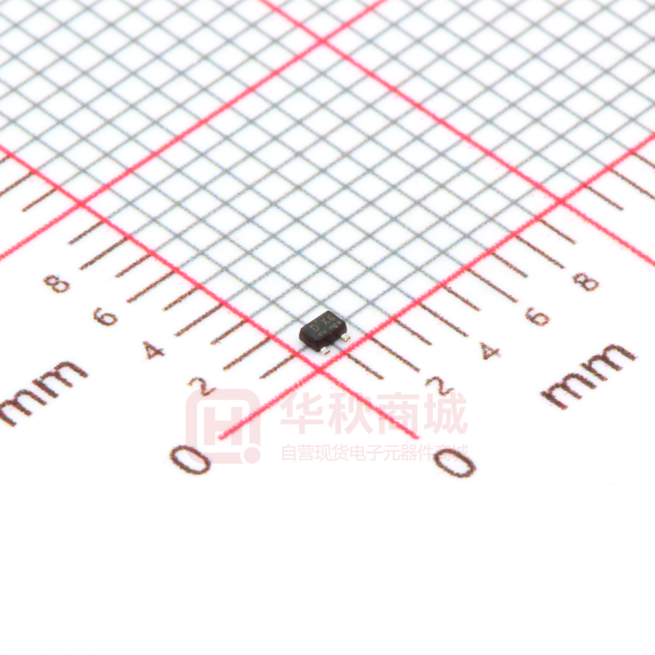

SSM3K35AMFV,L3F
SSM3K35AMFV,L3F
    TOSHIBA(东芝)
    SOT-723-3
    类型:N沟道 漏源电压(Vdss):20V 连续漏极电流(Id):250mA 功率(Pd):500mW 导通电阻(RDS(on)@Vgs,Id):1.1Ω@4.5V,150mA 阈值电压(Vgs(th...
SSM3K35AMFV,L3F 数据手册
SSM3K35AMFV MOSFETs Silicon N-Channel MOS SSM3K35AMFV 1. Applications • High-Speed Switching • Analog Switches 2. Features (1) 1.2 V drive (2) Low drain-source on-resistance : RDS(ON) = 9.0 Ω (max) (@VGS = 1.2 V, ID = 10 mA) RDS(ON) = 3.1 Ω (max) (@VGS = 1.5 V, ID = 20 mA) RDS(ON) = 2.4 Ω (max) (@VGS = 1.8 V, ID = 150 mA) RDS(ON) = 1.6 Ω (max) (@VGS = 2.5 V, ID = 150 mA) RDS(ON) = 1.1 Ω (max) (@VGS = 4.5 V, ID = 150 mA) 3. Packaging and Pin Assignment 1: Gate 2: Source 3: Drain VESM Start of commercial production ©2016 Toshiba Corporation 1 2016-10 2017-02-17 Rev.3.0 SSM3K35AMFV 4. Absolute Maximum Ratings (Note) (Unless otherwise specified, Ta = 25 ) Characteristics Symbol Rating Unit V Drain-source voltage VDSS 20 Gate-source voltage VGSS ±10 Drain current (Note 1) ID 250 Drain current (pulsed) (Note 1) IDP 600 Power dissipation (Note 2) PD 150 Power dissipation (Note 3) mA mW 500 Channel temperature Tch 150  Storage temperature Tstg -55 to 150  Note: Using continuously under heavy loads (e.g. the application of high temperature/current/voltage and the significant change in temperature, etc.) may cause this product to decrease in the reliability significantly even if the operating conditions (i.e. operating temperature/current/voltage, etc.) are within the absolute maximum ratings. Please design the appropriate reliability upon reviewing the Toshiba Semiconductor Reliability Handbook ("Handling Precautions"/"Derating Concept and Methods") and individual reliability data (i.e. reliability test report and estimated failure rate, etc). Note 1: Ensure that the channel temperature does not exceed 150 . Note 2: Mounted on an FR4 board (25.4 mm × 25.4 mm × 1.6 mm, Cu pad: 0.585 mm2) Note 3: Mounted on an FR4 board (25.4 mm × 25.4 mm × 1.6 mm, Cu pad: 645 mm2) Note: Note: The MOSFETs in this device are sensitive to electrostatic discharge. When handling this device, the worktables, operators, soldering irons and other objects should be protected against anti-static discharge. The channel-to-ambient thermal resistance, Rth(ch-a), and the drain power dissipation, PD, vary according to the board material, board area, board thickness and pad area. When using this device, be sure to take heat dissipation fully into account. ©2016 Toshiba Corporation 2 2017-02-17 Rev.3.0 SSM3K35AMFV 5. Electrical Characteristics 5.1. Static Characteristics (Unless otherwise specified, Ta = 25 ) Characteristics Symbol Gate leakage current Drain cut-off current Drain-source breakdown voltage Test Condition IGSS VGS = ±10 V, VDS = 0 V IDSS VDS = 20 V, VGS = 0 V V(BR)DSS ID = 1 mA, VGS = 0 V Gate threshold voltage (Note 1) Drain-source on-resistance (Note 2) Vth VDS = 10 V, ID = 100 µA Min Typ. Max Unit   ±1 µA   1 20   V 0.35  1.0 V RDS(ON) ID = 150 mA, VGS = 4.5 V  0.75 1.1 Ω ID = 150 mA, VGS = 2.5 V  1.1 1.6 ID = 150 mA, VGS = 1.8 V  1.4 2.4 ID = 20 mA, VGS = 1.5 V  1.7 3.1 ID = 10 mA, VGS = 1.2 V  2.4 9.0 ID = 150 mA, VGS = 4.5 V, Tj = 125   1.25 2.5 Forward transfer admittance (Note 2) |Yfs| VDS = 10 V, ID = 150 mA  0.5  S Reverse drain current (pulsed) (Note 2) IDRP    600 mA Note 1: Let Vth be the voltage applied between gate and source that causes the drain current (ID) to below (100 µA for this device). Then, for normal switching operation, VGS(ON) must be higher than Vth, and VGS(OFF) must be lower than Vth. This relationship can be expressed as: VGS(OFF) < Vth < VGS(ON). Take this into consideration when using the device. Note 2: Pulse measurement. 5.2. Dynamic Characteristics (Unless otherwise specified, Ta = 25 ) Characteristics Input capacitance Symbol Min Typ. Max Unit  18 36 pF  5 10  6 12  2   2  td(off)  6.5  tf  5.5  Ciss Reverse transfer capacitance Crss Output capacitance Coss Switching time (turn-on delay time) td(on) Switching time (rise time) Switching time (turn-off delay time) Switching time (fall time) tr Test Condition VDS = 10 V, VGS = 0 V, f = 1 MHz VDD = 10 V, ID = 75 mA, VGS = 0 to 4.5 V, RG = 10 Ω ns 5.3. Switching Time Test Circuit Fig. 5.3.1 Switching Time Test Circuit ©2016 Toshiba Corporation Fig. 5.3.2 Input Waveform/Output Waveform 3 2017-02-17 Rev.3.0 SSM3K35AMFV 5.4. Gate Charge Characteristics (Unless otherwise specified, Ta = 25 ) Characteristics Symbol Total gate charge (gate-source plus gate-drain) Qg Gate-source charge 1 Qgs1 Gate-drain charge Qgd Test Condition VDD = 10 V, ID = 200 mA, VGS = 4.5 V Min Typ. Max Unit  0.34  nC  0.09   0.16  5.5. Source-Drain Characteristics (Unless otherwise specified, Ta = 25 ) Characteristics Diode forward voltage Symbol (Note 1) VDSF Test Condition ID = -150 mA, VGS = 0 V Min Typ. Max Unit  -0.8 -1.2 V Note 1: Pulse measurement. 6. Marking Fig. 6.1 Marking ©2016 Toshiba Corporation 4 2017-02-17 Rev.3.0 SSM3K35AMFV 7. Characteristics Curves (Note) Fig. 7.1 ID - VDS Fig. 7.2 ID - VGS Fig. 7.3 RDS(ON) - VGS Fig. 7.4 RDS(ON) - VGS Fig. 7.5 RDS(ON) - ID Fig. 7.6 RDS(ON) - Ta ©2016 Toshiba Corporation 5 2017-02-17 Rev.3.0 SSM3K35AMFV Fig. 7.7 Vth - Ta Fig. 7.8 |Yfs| - ID Fig. 7.9 IDR - VDS Fig. 7.10 C - VDS Fig. 7.11 t - ID Fig. 7.12 Dynamic Input Characteristics ©2016 Toshiba Corporation 6 2017-02-17 Rev.3.0 SSM3K35AMFV Fig. 7.13 PD - Ta Note: The above characteristics curves are presented for reference only and not guaranteed by production test, unless otherwise noted. ©2016 Toshiba Corporation 7 2017-02-17 Rev.3.0 SSM3K35AMFV Package Dimensions Unit: mm Weight: 1.5 mg (typ.) Package Name(s) JEDEC: SOT-723 Nickname: VESM ©2016 Toshiba Corporation 8 2017-02-17 Rev.3.0 SSM3K35AMFV RESTRICTIONS ON PRODUCT USE • Toshiba Corporation, and its subsidiaries and affiliates (collectively "TOSHIBA"), reserve the right to make changes to the information in this document, and related hardware, software and systems (collectively "Product") without notice. • This document and any information herein may not be reproduced without prior written permission from TOSHIBA. Even with TOSHIBA's written permission, reproduction is permissible only if reproduction is without alteration/omission. • Though TOSHIBA works continually to improve Product's quality and reliability, Product can malfunction or fail. Customers are responsible for complying with safety standards and for providing adequate designs and safeguards for their hardware, software and systems which minimize risk and avoid situations in which a malfunction or failure of Product could cause loss of human life, bodily injury or damage to property, including data loss or corruption. Before customers use the Product, create designs including the Product, or incorporate the Product into their own applications, customers must also refer to and comply with (a) the latest versions of all relevant TOSHIBA information, including without limitation, this document, the specifications, the data sheets and application notes for Product and the precautions and conditions set forth in the "TOSHIBA Semiconductor Reliability Handbook" and (b) the instructions for the application with which the Product will be used with or for. Customers are solely responsible for all aspects of their own product design or applications, including but not limited to (a) determining the appropriateness of the use of this Product in such design or applications; (b) evaluating and determining the applicability of any information contained in this document, or in charts, diagrams, programs, algorithms, sample application circuits, or any other referenced documents; and (c) validating all operating parameters for such designs and applications. TOSHIBA ASSUMES NO LIABILITY FOR CUSTOMERS' PRODUCT DESIGN OR APPLICATIONS. • PRODUCT IS NEITHER INTENDED NOR WARRANTED FOR USE IN EQUIPMENTS OR SYSTEMS THAT REQUIRE EXTRAORDINARILY HIGH LEVELS OF QUALITY AND/OR RELIABILITY, AND/OR A MALFUNCTION OR FAILURE OF WHICH MAY CAUSE LOSS OF HUMAN LIFE, BODILY INJURY, SERIOUS PROPERTY DAMAGE AND/OR SERIOUS PUBLIC IMPACT ("UNINTENDED USE"). Except for specific applications as expressly stated in this document, Unintended Use includes, without limitation, equipment used in nuclear facilities, equipment used in the aerospace industry, medical equipment, equipment used for automobiles, trains, ships and other transportation, traffic signaling equipment, equipment used to control combustions or explosions, safety devices, elevators and escalators, devices related to electric power, and equipment used in finance-related fields. IF YOU USE PRODUCT FOR UNINTENDED USE, TOSHIBA ASSUMES NO LIABILITY FOR PRODUCT. For details, please contact your TOSHIBA sales representative. • Do not disassemble, analyze, reverse-engineer, alter, modify, translate or copy Product, whether in whole or in part. • Product shall not be used for or incorporated into any products or systems whose manufacture, use, or sale is prohibited under any applicable laws or regulations. • The information contained herein is presented only as guidance for Product use. No responsibility is assumed by TOSHIBA for any infringement of patents or any other intellectual property rights of third parties that may result from the use of Product. No license to any intellectual property right is granted by this document, whether express or implied, by estoppel or otherwise. • ABSENT A WRITTEN SIGNED AGREEMENT, EXCEPT AS PROVIDED IN THE RELEVANT TERMS AND CONDITIONS OF SALE FOR PRODUCT, AND TO THE MAXIMUM EXTENT ALLOWABLE BY LAW, TOSHIBA (1) ASSUMES NO LIABILITY WHATSOEVER, INCLUDING WITHOUT LIMITATION, INDIRECT, CONSEQUENTIAL, SPECIAL, OR INCIDENTAL DAMAGES OR LOSS, INCLUDING WITHOUT LIMITATION, LOSS OF PROFITS, LOSS OF OPPORTUNITIES, BUSINESS INTERRUPTION AND LOSS OF DATA, AND (2) DISCLAIMS ANY AND ALL EXPRESS OR IMPLIED WARRANTIES AND CONDITIONS RELATED TO SALE, USE OF PRODUCT, OR INFORMATION, INCLUDING WARRANTIES OR CONDITIONS OF MERCHANTABILITY, FITNESS FOR A PARTICULAR PURPOSE, ACCURACY OF INFORMATION, OR NONINFRINGEMENT. • Do not use or otherwise make available Product or related software or technology for any military purposes, including without limitation, for the design, development, use, stockpiling or manufacturing of nuclear, chemical, or biological weapons or missile technology products (mass destruction weapons). Product and related software and technology may be controlled under the applicable export laws and regulations including, without limitation, the Japanese Foreign Exchange and Foreign Trade Law and the U.S. Export Administration Regulations. Export and re-export of Product or related software or technology are strictly prohibited except in compliance with all applicable export laws and regulations. • Please contact your TOSHIBA sales representative for details as to environmental matters such as the RoHS compatibility of Product. Please use Product in compliance with all applicable laws and regulations that regulate the inclusion or use of controlled substances, including without limitation, the EU RoHS Directive. TOSHIBA ASSUMES NO LIABILITY FOR DAMAGES OR LOSSES OCCURRING AS A RESULT OF NONCOMPLIANCE WITH APPLICABLE LAWS AND REGULATIONS. ©2016 Toshiba Corporation 9 2017-02-17 Rev.3.0
