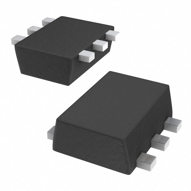

SSM6J402TU,LF 数据手册
SSM6J402TU TOSHIBA Field-Effect Transistor Silicon P-Channel MOS Type SSM6J402TU ○ DC/DC Converter Application ○ High-Speed Switching Applications unit: mm 2.1±0.1 • 4.0 V drive • Low ON-resistance : RDS(ON) = 225mΩ max (@VGS = −4 V) Symbol Rating Unit Drain–source voltage VDSS −30 V Gate–source voltage VGSS ±20 V DC ID −2.0 Pulse IDP −4.0 PD(注 1) 500 mW Channel temperature Tch 150 °C Storage temperature Tstg −55 to 150 °C Drain current Drain power dissipation 2 5 3 4 A Note 1: Mounted on an FR4 board 2 (25.4 mm × 25.4 mm × 1.6 t, Cu Pad: 645 mm ) UF6 JEDEC ― JEITA ― TOSHIBA 2-2T1D Weight: 7.0 mg (typ.) Electrical Characteristics (Ta = 25°C) Characteristic +0.1 0.3-0.05 6 0.166±0.05 Characteristic 1.3±0.1 Absolute Maximum Ratings (Ta = 25˚C) 1 0.7±0.05 2.0±0.1 : RDS(ON) = 117mΩ max (@VGS = −10 V) 0.65 0.65 1.7±0.1 Symbol Test Condition Min Typ. Max Unit V (BR) DSS ID = −1 mA, VGS = 0 V −30 ⎯ ⎯ V (BR) DSX ID = −1 mA, VGS = 20 V −15 ⎯ ⎯ Drain cutoff current IDSS VDS = −30 V, VGS = 0 V ⎯ ⎯ −1 μA Gate leakage current IGSS VGS = ±16 V, VDS = 0 V ⎯ ⎯ ±1 μA Gate threshold voltage Vth VDS = −5 V, ID = −1 mA −1.2 ⎯ −2.6 V Forward transfer admittance |Yfs| VDS = −5 V, ID = −1 A (Note2) 1.6 3.1 ⎯ S Drain–source ON-resistance RDS (ON) ID = −1 A, VGS = −10 V (Note2) ⎯ 80 117 ID = −0.5 A, VGS = −4 V (Note2) ⎯ 160 225 ⎯ 280 ⎯ ⎯ 80 ⎯ Drain–source breakdown voltage Input capacitance Ciss Output capacitance Coss Reverse transfer capacitance Crss ⎯ 45 ⎯ Total Gate Charge Qg ⎯ 5.3 ⎯ Gate-Source Charge Qgs ⎯ 4.1 ⎯ Gate-Drain Charge Qgd ⎯ 1.2 ⎯ Switching time VDS = −15 V, VGS = 0 V, f = 1 MHz VDS = −15V, ID = −2.0 A VGS = −10 V Turn-on time ton VDD = −15 V, ID = −1 A ⎯ 16 ⎯ Turn-off time toff VGS = 0 to −4 V, RG = 10 Ω ⎯ 35 ⎯ ⎯ 0.8 1.2 Drain–source forward voltage VDSF ID = 2 A, VGS = 0 V Note 2: Pulse test (Note2) V mΩ pF nC ns V Start of commercial production 2008-01 1 2014-03-01 SSM6J402TU Switching Time Test Circuit (a) Test Circuit 0 OUT IN RG −4 V (b) VIN 10 μs VDD = −15 V RG = 10 Ω Duty ≤ 1% VIN: tr, tf < 5 ns Common Source Ta = 25°C 0V 10% 90% −4 V VDS (ON) 90% (c) VOUT VDD 10% VDD tr ton Marking 6 tf toff Equivalent Circuit (top view) 5 4 6 5 4 3 1 2 3 KPE 1 2 Notice on Usage Vth can be expressed as the voltage between gate and source when the low operating current value is ID = 1 mA for this product. For normal switching operation, VGS (on) requires a higher voltage than Vth and VGS (off) requires a lower voltage than Vth. (The relationship can be established as follows: VGS (off) < Vth < VGS (on).) Take this into consideration when using the device. Handling Precaution When handling individual devices that are not yet mounted on a circuit board, make sure that the environment is protected against electrostatic discharge. Operators should wear antistatic clothing, and containers and other objects that come into direct contact with devices should be made of antistatic materials. 2 2014-03-01 SSM6J402TU ID – VDS ID – VGS -5 -10 -6V -10 V Common Source VDS = -5 V ID -3.6V -3 VGS = -3.3V -2 -1 0 -1 (A) -4 -0.1 Drain current Drain current ID (A) -4 V Ta = 100 °C 25 °C -0.01 −25 °C -0.001 Common Source Ta = 25 °C 0 -0.2 -0.4 -0.6 Drain–source voltage VDS -0.0001 0 -1 -0.8 (V) -0.5 -1.0 -2.0 -1.5 -2.5 Gate–source voltage VGS -3.5 -4.0 (V) RDS (ON) – ID RDS (ON) – VGS 500 500 ID = -1 A Common Source Ta = 25°C Drain–source ON-resistance RDS (ON) (mΩ) Common Source Drain–source ON-resistance RDS (ON) (mΩ) -3.0 400 300 25 °C 200 Ta =100 °C 100 400 300 200 VGS = -4.0V 100 -10V −25 °C 0 0 -4 -2 -6 Gate–source voltage -8 VGS 0 -10 0 (V) -2 -1 Drain current RDS (ON) – Ta (A) -2.0 Common Source Vth (V) Common Source 400 Gate threshold voltage Drain–source ON-resistance RDS (ON) (mΩ) ID -5 Vth – Ta 500 300 ID = -0.5A / VGS = -4.0 V 200 100 0 −50 -4 -3 -1.0A / -10V VDS = -5 V ID = -1 mA -1.5 -1.0 -0.5 0 0 50 Ambient temperature Ta −50 150 100 (°C) 0 50 Ambient temperature 3 100 Ta 150 (°C) 2014-03-01 SSM6J402TU IDR – VDS |Yfs| – ID 10 (S) 10 IDR Ta = 25 °C 3 1 0.3 0.1 -0.01 Common Source VGS = 0 V (A) VDS = -5 V Drain reverse current Forward transfer admittance ⎪Yfs⎪ Common Source -1 -0.1 Drain current ID D 1 IDR G 0.1 S Ta = 100 °C 0.01 25 °C 0.001 −25 °C 0.0001 0 -10 0.2 (A) 0.4 0.6 Drain–source voltage 0.8 600 Common Source VDD = -15 V VGS = 0 ∼ -4 V Ta = 25 °C RG = 10 Ω toff (ns) 500 300 Switching time 100 Coss 50 Crss Common Source 30 100 10 ton tr Ta = 25°C f = 1 MHz VGS = 0 V 10 -0.1 tf t Ciss C (pF) 1.2 (V) t – ID C – VDS 1000 Capacitance 1.0 VDS -1 -10 Drain–source voltage 1 0.01 -100 VDS (V) 0.1 Drain current 1 ID 10 (A) Dynamic Input Characteristic 10 ID = -2.0 A 8 Ta = 25°C Gate–source voltage VGS (V) Common Source 6 VDD=-24V VDD=-15V 4 2 0 0 2 4 Total Gate Charge 8 6 Qg 10 (nC) 4 2014-03-01 SSM6J402TU Transient thermal impedance rth (°C/W) – tw PD – Ta Drain power dissipation PD (mW) rth 100 Single Pulse Mounted on FR4 board (25.4mm × 25.4mm × 1.6t , Cu Pad : 645 mm2) 100 10 1 0.001 0.01 0.1 1 Pulse width 100 10 tw 1000 Mounted on FR4 board (25.4mm × 25.4mm × 1.6t , Cu Pad : 645 mm2) t = 10 s 800 600 DC 400 200 0 -40 1000 -20 0 20 40 60 80 Ambient temperature (s) 5 100 120 140 160 Ta (°C) 2014-03-01 SSM6J402TU RESTRICTIONS ON PRODUCT USE • Toshiba Corporation, and its subsidiaries and affiliates (collectively "TOSHIBA"), reserve the right to make changes to the information in this document, and related hardware, software and systems (collectively "Product") without notice. • This document and any information herein may not be reproduced without prior written permission from TOSHIBA. Even with TOSHIBA's written permission, reproduction is permissible only if reproduction is without alteration/omission. • Though TOSHIBA works continually to improve Product's quality and reliability, Product can malfunction or fail. Customers are responsible for complying with safety standards and for providing adequate designs and safeguards for their hardware, software and systems which minimize risk and avoid situations in which a malfunction or failure of Product could cause loss of human life, bodily injury or damage to property, including data loss or corruption. Before customers use the Product, create designs including the Product, or incorporate the Product into their own applications, customers must also refer to and comply with (a) the latest versions of all relevant TOSHIBA information, including without limitation, this document, the specifications, the data sheets and application notes for Product and the precautions and conditions set forth in the "TOSHIBA Semiconductor Reliability Handbook" and (b) the instructions for the application with which the Product will be used with or for. Customers are solely responsible for all aspects of their own product design or applications, including but not limited to (a) determining the appropriateness of the use of this Product in such design or applications; (b) evaluating and determining the applicability of any information contained in this document, or in charts, diagrams, programs, algorithms, sample application circuits, or any other referenced documents; and (c) validating all operating parameters for such designs and applications. TOSHIBA ASSUMES NO LIABILITY FOR CUSTOMERS' PRODUCT DESIGN OR APPLICATIONS. • PRODUCT IS NEITHER INTENDED NOR WARRANTED FOR USE IN EQUIPMENTS OR SYSTEMS THAT REQUIRE EXTRAORDINARILY HIGH LEVELS OF QUALITY AND/OR RELIABILITY, AND/OR A MALFUNCTION OR FAILURE OF WHICH MAY CAUSE LOSS OF HUMAN LIFE, BODILY INJURY, SERIOUS PROPERTY DAMAGE AND/OR SERIOUS PUBLIC IMPACT ("UNINTENDED USE"). Except for specific applications as expressly stated in this document, Unintended Use includes, without limitation, equipment used in nuclear facilities, equipment used in the aerospace industry, medical equipment, equipment used for automobiles, trains, ships and other transportation, traffic signaling equipment, equipment used to control combustions or explosions, safety devices, elevators and escalators, devices related to electric power, and equipment used in finance-related fields. IF YOU USE PRODUCT FOR UNINTENDED USE, TOSHIBA ASSUMES NO LIABILITY FOR PRODUCT. For details, please contact your TOSHIBA sales representative. • Do not disassemble, analyze, reverse-engineer, alter, modify, translate or copy Product, whether in whole or in part. • Product shall not be used for or incorporated into any products or systems whose manufacture, use, or sale is prohibited under any applicable laws or regulations. • The information contained herein is presented only as guidance for Product use. No responsibility is assumed by TOSHIBA for any infringement of patents or any other intellectual property rights of third parties that may result from the use of Product. No license to any intellectual property right is granted by this document, whether express or implied, by estoppel or otherwise. • ABSENT A WRITTEN SIGNED AGREEMENT, EXCEPT AS PROVIDED IN THE RELEVANT TERMS AND CONDITIONS OF SALE FOR PRODUCT, AND TO THE MAXIMUM EXTENT ALLOWABLE BY LAW, TOSHIBA (1) ASSUMES NO LIABILITY WHATSOEVER, INCLUDING WITHOUT LIMITATION, INDIRECT, CONSEQUENTIAL, SPECIAL, OR INCIDENTAL DAMAGES OR LOSS, INCLUDING WITHOUT LIMITATION, LOSS OF PROFITS, LOSS OF OPPORTUNITIES, BUSINESS INTERRUPTION AND LOSS OF DATA, AND (2) DISCLAIMS ANY AND ALL EXPRESS OR IMPLIED WARRANTIES AND CONDITIONS RELATED TO SALE, USE OF PRODUCT, OR INFORMATION, INCLUDING WARRANTIES OR CONDITIONS OF MERCHANTABILITY, FITNESS FOR A PARTICULAR PURPOSE, ACCURACY OF INFORMATION, OR NONINFRINGEMENT. • Do not use or otherwise make available Product or related software or technology for any military purposes, including without limitation, for the design, development, use, stockpiling or manufacturing of nuclear, chemical, or biological weapons or missile technology products (mass destruction weapons). Product and related software and technology may be controlled under the applicable export laws and regulations including, without limitation, the Japanese Foreign Exchange and Foreign Trade Law and the U.S. Export Administration Regulations. Export and re-export of Product or related software or technology are strictly prohibited except in compliance with all applicable export laws and regulations. • Please contact your TOSHIBA sales representative for details as to environmental matters such as the RoHS compatibility of Product. Please use Product in compliance with all applicable laws and regulations that regulate the inclusion or use of controlled substances, including without limitation, the EU RoHS Directive. TOSHIBA ASSUMES NO LIABILITY FOR DAMAGES OR LOSSES OCCURRING AS A RESULT OF NONCOMPLIANCE WITH APPLICABLE LAWS AND REGULATIONS. 6 2014-03-01
