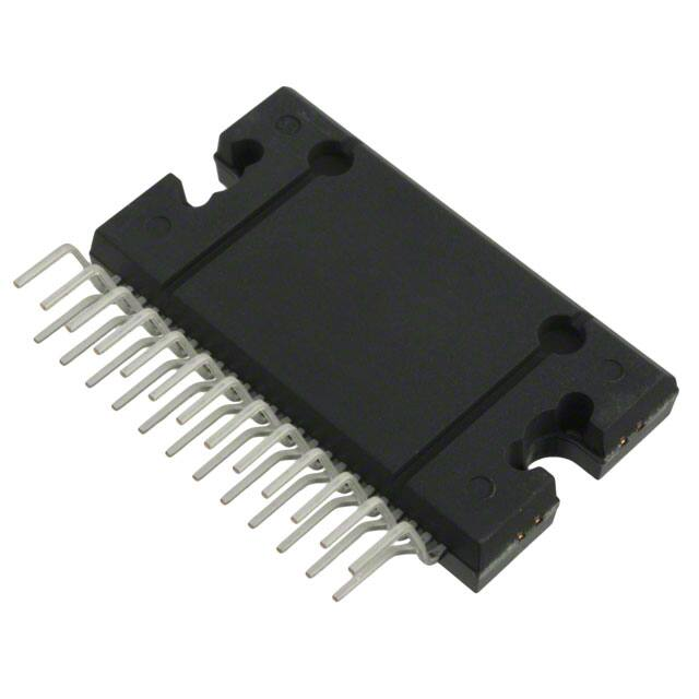

TB67S149HG Toshiba BiCD Process Integrated Circuit Silicon Monolithic TB67S149HG Clock controlled Unipolar stepping motor driver The TB67S149 is a Clock controlled PWM chopping type 2 phase unipolar stepping motor driver. Using the BiCD process, the TB67 S149HG can be operated with VM voltage of 45V, output voltage of 84V, and output current of 3.0A at max (absolute maximum ratings). HG Features HZIP25-P-1.00F Weight 7.6(g)(typ.) ・BiCD processed monolithic integrated circuit. ・Capable of operating one unipolar stepping motor. ・PWM controlled constant current drive. ・Full, half(a), half(b), quarter, 1/8, 1/16, 1/32 step resolution. ・Low on resistance(0.25Ω(typ.) output MOSFET. ・High voltage and current (For specification, please refer to the absolute maximum ratings and operation ranges). ・Standby (low power) mode function ・Error detect feedback signal output function (Over current/Thermal shutdown). ・Error detect function (Thermal shutdown(TSD), Over current(ISD), and Low voltage(POR). ・Built-in VCC regulator for internal circuit use. ・Fixed off time can be adjusted by external components. Note) Please be careful about the thermal conditions during use. 1 2014-04-15 2 ERR MO DMODE1 RESET 15 17 19 21 23 25 VM VREF 13 OUTB+ 11 OUTB- 9 OUTA- 7 OUTA+ 5 GND 3 ENABLE 1 NC VCC OSCM ALM DMODE0 DMODE2 CLK CW/CCW NC RSGNDA VCOM RSGNDB GND TB67S149HG Pin assign (TB67S149HG) (Top View) 2 4 6 8 10 12 14 16 18 20 22 24 2014-04-15 TB67S149HG TB67S149 block diagram RESET ENABLE Polarity and Angle control CW/CCW MO VREF Ach Ach Pre drv Nch×2 OUT OUT A+ OUT ARSGNDA RS Comp VREF STANDBY OSCM Control Internal OSC Error detect VCC Pre TSD VCC regulator RS Comp CLK DMODE0 DMODE1 (TSD/ISD) POR VM Step Resolution Control DMODE2 ERR ALM VCOM Bch Bch Pre OUT drv Nch×2 OUT B+ OUT BRSGNDB Functional blocks/circuits/constants in the block chart etc. may be omitted or simplified for explanatory purposes. 3 2014-04-15 TB67S149HG Application Notes All the grounding wires of the device must run on the solder mask on the PCB and be externally terminated at only one point. Also, a grounding method should be considered for efficient heat dissipation. Careful attention should be paid to the layout of the output, VDD(VM) and GND traces, to avoid short circuits across output pins or to the power supply or ground. If such a short circuit occurs, the device may be permanently damaged. Also, the utmost care should be taken for pattern designing and implementation of the device since it has power supply pins (VM, RSGND, OUT, GND) through which a particularly large current may run. If these pins are wired incorrectly, an operation error may occur or the device may be destroyed. The logic input pins must also be wired correctly. Otherwise, the device may be damaged owing to a current running through the IC that is larger than the specified current. 4 2014-04-15 TB67S149HG Pin explanations TB67S149HG (HZIP25) Pin No.1 to 25 Pin No. Pin Name Function 1 NC 2 VCC Internal VCC regulator monitor pin 3 VREF Constant current threshold set pin 4 OSCM Fixed off time set pin 5 ERR Error detect feedback signal output pin 6 ALM Thermal alarm output pin 7 MO Electrical angle monitor pin 8 DMODE0 Step setting pin 0 9 DMODE1 Step setting pin 1 10 DMODE2 Step setting pin 2 11 RESET Electrical angle reset pin 12 CLK External Clock input pin 13 ENABLE Motor output ON/OFF pin 14 CW/CCW Clock-wise/Counter Clock-wise setting pin 15 GND 16 NC 17 OUTA+ 18 RSGNDA 19 OUTA- Motor output 20 VCOM Common pin 21 OUTB- Motor output 22 RSGNDB 23 OUTB+ 24 GND 25 VM Non connection Ground pin Non connection Motor output A+ pin Ach current sense ground pin A-pin B-pin Bch current sense ground pin Motor output B+ pin Ground pin VM power supply pin Please do not run patterns under NC pins. 5 2014-04-15 TB67S149HG INPUT/OUTPUT Equivalent circuit Pin name Input / Output Equivalent circuit DMODE0 Input DMODE2 Logic input (VIH/VIL) CLK VIH: 2.0V(min) to 5.5V(max) CW/CCW RESET ENABLE 1kΩ Logic 100kΩ DMODE1 VIL : 0V(min) to 0.8V(max) GND Logic Output ERR ALM MO Logic output (VOH/VOL) (Pullup resistance :10k to 100kΩ) GND VCC VCC VREF VCC voltage range 4.75V(min) to 5.0V(typ.) to 5.25V(max) 1kΩ VREF VREF input voltage range 0V to 4.0V (Constant current control) VCC short(Constant current control : off) GND 0.82MHz(min) 8.2MHz(max) to 3.2MHz(typ.) 500Ω OSCM 1kΩ OSCM OSCM frequency setup (reference) to (R_OSCM=3.9kΩ to 10kΩ to 39kΩ) GND VCOM OUT A+ OUT A- 10V(min) to 40V(max) RSGNDA OUT pin voltage range RSGNDB VCOM (-) pin (+) pin VM voltage range OUT B+ OUT B- OUTPUT OUTPUT 10V(min) to 80V(max) RSGND The equivalent circuit diagrams may be simplified or some parts of them may be omitted for explanatory purposes. 6 2014-04-15 TB67S149HG TB67S149 function explanation CLK function The CLK pin controls the rotation speed of the motor. Each CLK signal will shift the motor’s electrical angle per step, due to each up-edge of the CLK signal. CLK Function ↑ (Low to High) Shifts the electrical angle per step. ↓ (High to Low) - (State of the electrical angle does not change.) ENABLE function The ENABLE pin controls the ON and OFF of the corresponding output stage. (For accurate operation, please set the ENABLE to ‘Low( during VM power-on and power-off sequence.)) ENABLE Function High Output stage=’ON’ (Normal operation mode) Low Output stage=’OFF’ (High impedance mode) CW/CCW function The CW/CCW pin controls the rotation direction of the motor. CW/CCW Function High Clock-wise (CW) Low Counter Clock-wise (CCW) When set to ‘CW’, the Ach current phase leads the Bch current phase by 90°. When set to ‘CCW’, the Bch current phase leads the Ach current phase by 90°. 7 2014-04-15 TB67S149HG RESET function The RESET pin controls the resetting of the internal electrical angle. (For accurate operation, please set the RESET pin to ‘High’ during VM power-on. Switch the RESET to ‘Low’, once the VM voltage has reached the operation range.) RESET Function High Sets the electrical angle to the initial position. Low Normal operation The current setting for each channel (while RESET is applied) is shown in the table below. MO pin level will show ‘Low’ level at this time. Step resolution setting Ach current Bch current Electrical angle Full step 100% 100% 45° Half step (a) 100% 100% 45° Quarter step 71% 71% 45° Half step (b) 71% 71% 45° 1/8 step 71% 71% 45° 1/16 step 71% 71% 45° 1/32 step 71% 71% 45° 8 2014-04-15 TB67S149HG DMODE (Step resolution setting) function The DMODE pin controls the Standby mode and the step resolution setting. DMODE0 DMODE1 DMODE2 Function Low Low Low Standby mode (The internal oscillator is disabled and the output stage is set to ‘OFF’ status. The internal status is Full step, Torque100% (*)) Low Low High Full step Low High Low Half step(a) Low High High Quarter step High Low Low Half step(b) High Low High 1/8 step High High Low 1/16 step High High High 1/32 step (*) [Full step, Torque 100%] written above shows the initial status of the logic. During Standby mode, the internal oscillator and output stage is set to OFF, therefore does not mean that the device will operate at [Full step, Torque 100%]. Standby mode function Setting all of the DMODE pins(DMODE0,DMODE1,DMODE2) to Low will set the device to Standby mode. During Standby mode, the internal bias current is cut so that the device be set to low power mode. Also, setting the device to Standby mode will release the error detection such as TSD and ISD. Standby mode Function ON (DMODE0,1,2=L,L,L) Standby mode : ON (Low power mode) OFF (other than DMODE0,1,2=L,L,L) Standby mode: OFF (Normal operation) After the device detects an error such as TSD or ISD, setting the device to Standby mode to OFF and then ON again will release the error detect latch signal. (Reasserting the VM power will also release the error detect latch signal.) Note) After setting the Standby mode: OFF, the internal circuit will restart from low power mode. During the startup period (10μs after setting the Standby mode : OFF), please do not send any control signals. (If the signal is sent to the device during the startup period, the device may not be able to accept the signal correctly.) 9 2014-04-15 TB67S149HG Step resolution and current ratio Step resolution Characteristics Step Typ. ○ θ32 100 - ○ θ31 100 ○ ○ θ30 100 - ○ θ29 99 ○ ○ θ28 98 - ○ θ27 97 ○ ○ θ26 96 - ○ θ25 94 ○ ○ θ24 92 - ○ θ23 90 ○ ○ θ22 88 - ○ θ21 86 ○ ○ θ20 83 - ○ θ19 80 ○ ○ θ18 77 - ○ θ17 74 ○ ○ θ16 71 - ○ θ15 67 ○ ○ θ14 63 - ○ θ13 60 ○ ○ θ12 56 - ○ θ11 52 ○ ○ θ10 47 - ○ θ9 43 ○ ○ θ8 38 - ○ θ7 34 ○ ○ θ6 29 - ○ θ5 25 ○ ○ θ4 20 - ○ θ3 15 ○ ○ θ2 10 - ○ θ1 5 ○ ○ θ0 0 Full Half (a) Half (b) Quarter 1/8 1/16 1/32 ○ ○ ○ ○ ○ ○ - - ○ - - - (*2) ○ - - ○ - Unit Current (*1) Ratio ○ ○ ○ % - - ○ - - - ○ ○ - - ○ -- ○ ○ ○ ○ (*1) At Half (a) setting, the current ratio will be 100%. (*2) At Quarter setting, the current ratio will be 100%. 10 2014-04-15 TB67S149HG Monitor pin functions (MO feedback) MO Function Hi-Z (*) - (Other than the initial angle) Low Initial electrical angle (*) The MO pin is an open drain logic output. To use the function correctly, please make sure the MO pin is connected to 3.3V or 5.0V with a pull-up resistance. If the internal electrical angle is at the initial angle, the pin level will be Low (internal MOSFET: ON). If the internal electrical angle is not at the initial angle, the pin level will be Hi-Z (internal MOSFET:OFF) (it will show High level when pulled up correctly). Please refer to the ‘RESET function’ for the initial angle. MO pin should be left open; when not using the MO feedback function. 3.3V or 5V Pull-up resistance (10kΩ to 100kΩ) MO pin MO logic [MO MOSFET] ON:Initial angle OFF:Other than the initial angle Equivalent circuit(s) may be omitted for explanatory purpose. 11 2014-04-15 TB67S149HG Monitor pin functions (ERR feedback) ERR Function Hi-Z (*) Normal operation Low Error detected (TSD or ISD) (*) The ERR pin is an open drain logic output. To use the function correctly, please make sure the ERR pin is connected to 3.3V or 5.0V with a pull-up resistance. During normal operation, the pin level will be Hi-Z (internal MOSFET:OFF) (it will show High level when pulled up), and once an error (TSD or ISD) has been detected, the pin level will be Low (internal MOSFET: ON). Reasserting the VM power supply or using the STBY function, the ERR pin will return to the initial status (internal MOSFET: OFF). ERR pin should be left open; when not using the ERR feedback function. 3.3V or 5V Pull-up resistance (10kΩ to 100kΩ) ERR pin ERR logic [ERR MOSFET] ON: TSD or ISD detected OFF: Normal operation Equivalent circuit(s) may be omitted for explanatory purpose. 12 2014-04-15 TB67S149HG Monitor pin functions (Thermal ALM feedback) ALM Function Hi-Z (*) Normal operation Low Thermal Alarm detected (*) The ALM pin is an open drain logic output. To use the function correctly, please make sure the ALM pin is connected to 3.3V or 5.0V with a pull-up resistance. During normal operation, the pin level will be Hi-Z (internal MOSFET:OFF) (it will show High level when pulled up), and once the device detects a temperature rise, the pin level will be Low (internal MOSFET: ON). The ALM is an auto recovery type output. Once the device reaches the ALM detect threshold(120°C±15°C), the pin level will show Low (internal MOSFET:ON), and after the device reaches the ALM release threshold (‘detect threshold’-30°C), the pin level will show Hi-Z (internal MOSFET:OFF) (it will show High level when pulled up) ALM pin should be left open; when not using the thermal ALM feedback function. Pull-up voltage (3.3V or 5V) ALM pin GND 90°C(±15°C) 120°C(±15°C) 3.3V or 5V Pull-up resistance (10kΩ to 100kΩ) ALM pin ALM logic [ALM MOSFET] ON: ALM detect threshold OFF: Normal operation or ALM release threshold Timing charts may be simplified for explanatory purpose. Equivalent circuit(s) may be omitted for explanatory purpose. 13 2014-04-15 TB67S149HG TB67S149 setup Constant-current threshold setting The constant-current threshold can be set by VREF voltage. IOUT(max)=VREF × 3/4 Example: Current setting 100%, VREF=2.0V: The constant current thredhold(peak current) will be as shown below. IOUT = 2.0×3/4=1.5A To set the constant-current function ‘off’, connect the VCC and VREF pin directly (do not use any external power supply). Also, please be careful about the thermal conditions during use. Fixed off time setting To set the fixed off time for constant-current PWM control, please connect a pull-down resistance to the OSCM pin. The relation between the pull-down resistance(ROSCM) and fixed off time is as shown below. (For reference) Pull-down resistance (ROSCM) Fixed off time (toff) 3.9kΩ 4.7kΩ 5.6kΩ 6.8kΩ 8.2kΩ 10kΩ 15kΩ 18kΩ 22kΩ 27kΩ 39kΩ 4.1μs 4.9μs 5.8μs 7.0μs 8.3μs 10μs 15μs 18μs 21μs 26μs 37μs Note) The value shown in the graph above does not include any dispersion of the device / external components. 14 2014-04-15 TB67S149HG Absolute maximum ratings(Ta=25°C) Characteristics Symbol Rating Unit VM(max) 45 V VM-VCOM voltage differential VDIFF(max) 45 V Motor output voltage VOUT(max) 84 V Motor output current (per channel) IOUT(max) 3.0 A Internal logic power supply VCC(max) 6.0 V VIN(H)(max) 6.0 V VIN(L)(min) -0.4 V VREF input voltage VREF(max) 6.0 V Open drain output pin (ERR,ALM,MO) voltage VOD(max) 6.0 V Open drain output pin (ERR,ALM,MO) inflow current IOD(max) 20 mA Power dissipation (HZIP25; device alone) PD 3.2 W Operating temperature Topr -20 to 85 °C Storage temperature Tstr -55 to 150 °C Junction temperature Tj(max) 150 °C Motor power supply Logic input voltage Caution)Absolute maximum ratings The absolute maximum ratings of a semiconductor device are a set of ratings that must not be exceeded, even for a moment. Do not exceed any of these ratings. Exceeding the rating (s) may cause device breakdown, damage or deterioration, and may result in injury by explosion or combustion. The value of even one parameter of the absolute maximum ratings should not be exceeded under any circumstances. The device does not have overvoltage detection circuit. Therefore, the device is damaged if a voltage exceeding its rated maximum is applied. All voltage ratings, including supply voltages, must always be followed. The other notes and considerations described later should also be referred to. 15 2014-04-15 TB67S149HG Operation ranges Characteristics Symbol Test condition Min Typ. Max Unit Motor power supply VM - 10 - 40 V Motor output voltage VOUT - 10 - 80 V Motor output current (per channel) IOUT Ta=25°C - 1.5 3.0 A Internal logic power supply VCC - 4.75 5.0 5.25 V VIN(H) Logic input high level 2.0 - 5.5 V VIN(L) Logic input low level 0 - 0.8 V VREF input voltage range VREF(range) - GND - 5.5 V Open drain pin voltage range VOD(range) ERR,ALM,MO pin 3.0 - 5.5 V Open drain pin inflow current range IOD(range) ERR,ALM,MO pin - - 10 mA Internal oscillator frequency range fOSCM(range) - 820 3200 8200 kHz tOFF(range) - 5 10 40 μs Logic input voltage Fixed off time range Note) Maximum current for actual usage may be limited by the operating circumstances such as operating conditions (exciting mode, operating time, and so on), ambient temperature, and heat conditions (board condition and so on). 16 2014-04-15 TB67S149HG Electrical Specifications 1 (Ta = 25°C, VM = 24 V, unless specified otherwise) Characteristics Symbol Min Typ. Max Unit VIH Logic input pin High level (*) 2.0 - 5.5 V VIL Logic input pin Low level (*) GND - 0.8 V VIN(HYS) Logic input pin (*) 100 - 300 mV High IIN(H) Logic input voltage High level (VIN=VIH) - 33 55 μA Low IIN(L) Logic input voltage Low level (VIN=VIL) - - 1 μA IM1 Output pins=open, Standby mode - - 1.0 mA - 3.0 5.0 mA 0 - 0.5 V -5 0 +5 % Logic input voltage Logic input hysteresis voltage Logic input current Test condition Power consumption Open drain output pin voltage Motor current channel differential Motor current setting accuracy Source-drain diode forward voltage Motor output off leak current IM2 VOD(L) ⊿IOUT1 Output pins=open, Normal operation Full step resolution IOD=10mA Current differential between channels (IOUT=1.0A) ⊿IOUT2 IOUT=1.0A -6 0 +6 % VFN IOUT=2.0A 0.85 - 1.45 V Ileak VOUT=80V, Output MOSFET:OFF - - 1 μA IOUT=2.0A - 0.25 0.35 Ω Motor output ON-resistance RON (Low side) (D-S) (*) VIN (H) is defined as the VIN voltage that causes the outputs (OUTA, OUTB) to change when a pin under test is gradually raised from 0 V. VIN (L) is defined as the VIN voltage that causes the outputs (OUTA, OUTB) to change when the pin is then gradually lowered. The difference between VIN (L) and VIN (H) is defined as the VIN(HYS). 17 2014-04-15 TB67S149HG Electrical Specifications 2 (Ta =25°C, VM = 24 V, unless specified otherwise) Characteristics Symbol Test condition Min Typ. Max Unit 4.75 5 5.25 V VCC regulator voltage VCC ICC=5.0mA VCC regulator current ICC 4.75V≤VCC≤5.25V - 2.5 5.0 mA VREF input current IREF VREF=2.0V - 0 1.0 μA Thermal shutdown(TSD) threshold (*) TjTSD - 140 155 170 °C VCC recovery voltage VCCR - 3.5 4.0 4.5 V VM recovery voltage VMR - 7.0 8.0 9.0 V Over-current detection(ISD) threshold (*) ISD - 3.1 4.0 5.0 A (*) About Thermal shutdown (TSD) When the junction temperature of the device reached the TSD threshold, the TSD circuit is triggered; the internal reset circuit then turns off the output transistors. Noise rejection blanking time is built-in to avoid misdetection. Once the TSD circuit is triggered; the detect latch signal can be cleared by reasserting the VM power source, or setting the device to standby mode. The TSD circuit is a backup function to detect a thermal error, therefore is not recommended to be used aggressively. (*) About Over-current detection (ISD) When the output current reaches the threshold, the ISD circuit is triggered; the internal reset circuit then turns off the output transistors. Once the ISD circuit is triggered, the detect latch signal can be cleared by reasserting the VM power source, or setting the device to standby mode. For fail-safe, please insert a fuse to avoid secondary trouble. Back-EMF While a motor is rotating, there is a timing at which power is fed back to the power supply. At that timing, the motor current recirculates back to the power supply due to the effect of the motor back-EMF. If the power supply does not have enough sink capability, the power supply and output pins of the device might rise above the rated voltages. The magnitude of the motor back-EMF varies with usage conditions and motor characteristics. It must be fully verified that there is no risk that the device or other components will be damaged or fail due to the motor back-EMF. Cautions on Overcurrent Shutdown (ISD) and Thermal Shutdown (TSD) The ISD and TSD circuits are only intended to provide temporary protection against irregular conditions such as an output short-circuit; they do not necessarily guarantee the complete IC safety. If the device is used beyond the specified operating ranges, these circuits may not operate properly: then the device may be damaged due to an output short-circuit. The ISD circuit is only intended to provide a temporary protection against an output short-circuit. If such condition persists for a long time, the device may be damaged due to overstress. Overcurrent conditions must be removed immediately by external hardware. IC Mounting Do not insert devices incorrectly or in the wrong orientation. Otherwise, it may cause breakdown, damage and/or deterioration of the device. 18 2014-04-15 TB67S149HG AC Electrical Specification (Ta =25°C, VM = 24 V, unless specified otherwise) Characteristics Symbol CLK input frequency Test condition Min Typ. Max Unit - - 100 kHz fCLK fOSCM=3200kHz tCLK(twp) - 50 - - ns tCLK(twn) - 50 - - ns Output MOSFET switching specific tr - 50 100 150 ns (rise time, fall time) tf - 50 100 150 ns Output MOSFET switching specific tpLH(CLK) CLK→OUT 200 700 1200 ns (CLK-OUT response time) tpHL(CLK) CLK→OUT 200 700 1200 ns Analog noise blanking time AtBLK Analog tblank 250 400 550 ns OSCM frequency fOSCM ROSC=10kΩ 2720 3200 3680 kHz OSCS frequency fOSCS - 5120 6400 7680 kHz Fixed off time tOFF fOSCM=3.2MHz 8.5 10 11.5 μs Over current (ISD) detect tISD(mask) fOSCS(=6.4MHz)*8clk 1.0 1.25 1.5 μs tTSD(mask) fOSCS(=6.4MHz)*32clk 4.0 5.0 6.0 μs tALM(mask) fOSCS(=6.4MHz)*16clk 2.0 2.5 3.0 μs Minimum CLK pulse width masking time Thermal shutdown (TSD) detect masking time Thermal Alarm(ALM) detect masking time AC specification timing chart tCLK(twn) [CLK] 50% 50% 50% tCLK(twp) fCLK [OUT] 90% tpLH(CLK) 50% 50% 10% 10% 90% tr tf 90% [OUT] 50% tpHL(CLK) 10% Timing charts may be simplified for explanatory purpose. 19 2014-04-15 TB67S149HG Application circuit example 2 1 6 4 3 5 8 7 12 10 9 11 14 13 16 15 18 17 20 19 22 21 100μF 0.1μF ZD 10kΩ 0.1μF 10kΩ 3.3V 24 23 25 2.0V 3.3V 10kΩ M (24V) 10kΩ The application circuit above is an example; therefore, mass-production design is not guaranteed. 20 2014-04-15 TB67S149HG Package dimensions (Unit:mm) : HZIP25-P-1.00F Weight: 7.6(g)(typ.) Note) The tightening torque for the mounting bracket should be controlled between 0.4N・m to 0.6N・m. 21 2014-04-15 TB67S149HG Notes on Contents Block Diagrams Some of the functional blocks, circuits, or constants in the block diagram may be omitted or simplified for explanatory purposes. Equivalent Circuits The equivalent circuit diagrams may be simplified or some parts of them may be omitted for explanatory purposes. Timing Charts Timing charts may be simplified for explanatory purposes. Application Circuits The application circuits shown in this document are provided for reference purposes only. Thorough evaluation is required, especially at the mass-production design stage. Toshiba does not grant any license to any industrial property rights by providing these examples of application circuits. Test Circuits Components in the test circuits are used only to obtain and confirm the device characteristics. These components and circuits are not guaranteed to prevent malfunction or failure from occurring in the application equipment. IC Usage Considerations Notes on handling of ICs (1) The absolute maximum ratings of a semiconductor device are a set of ratings that must not be exceeded, even for a moment. Do not exceed any of these ratings.Exceeding the rating(s) may cause device breakdown, damage or deterioration, and may result in injury by explosion or combustion. (2) Use an appropriate power supply fuse to ensure that a large current does not continuously flow in the case of overcurrent and/or IC failure. The IC will fully break down when used under conditions that exceed its absolute maximum ratings, when the wiring is routed improperly or when an abnormal pulse noise occurs from the wiring or load, causing a large current to continuously flow and the breakdown can lead to smoke or ignition. To minimize the effects of the flow of a large current in the case of breakdown, appropriate settings, such as fuse capacity, fusing time and insertion circuit location, are required. (3) If your design includes an inductive load such as a motor coil, incorporate a protection circuit into the design to prevent device malfunction or breakdown caused by the current resulting from the inrush current at power ON or the negative current resulting from the back electromotive force at power OFF. IC breakdown may cause injury, smoke or ignition. Use a stable power supply with ICs with built-in protection functions. If the power supply is unstable, the protection function may not operate, causing IC breakdown. IC breakdown may cause injury, smoke or ignition. (4) Do not insert devices in the wrong orientation or incorrectly. Make sure that the positive and negative terminals of power supplies are connected properly. Otherwise, the current or power consumption may exceed the absolute maximum rating, and exceeding the rating(s) may cause device breakdown, damage or deterioration, and may result in injury by explosion or combustion. In addition, do not use any device inserted in the wrong orientation or incorrectly to which current is applied even just once. (5) Carefully select external components (such as inputs and negative feedback capacitors) and load components (such as speakers), for example, power amp and regulator. If there is a large amount of leakage current such as from input or negative feedback condenser, the IC output DC voltage will increase. If this output voltage is connected to a speaker with low input withstand voltage, overcurrent or IC failure may cause smoke or ignition. (The overcurrent may cause smoke or ignition from the IC itself.) In particular, please pay attention when using a Bridge Tied Load (BTL) connection-type IC that inputs output DC voltage to a speaker directly. 22 2014-04-15 TB67S149HG Points to remember on handling of ICs Overcurrent detection Circuit Overcurrent detection circuits (referred to as current limiter circuits) do not necessarily protect ICs under all circumstances. If the overcurrent detection circuits operate against the overcurrent, clear the overcurrent status immediately. Depending on the method of use and usage conditions, exceeding absolute maximum ratings may cause the overcurrent detection circuit to operate improperly or IC breakdown may occur before operation. In addition, depending on the method of use and usage conditions, if overcurrent continues to flow for a long time after operation, the IC may generate heat resulting in breakdown. Thermal Shutdown Circuit Thermal shutdown circuits do not necessarily protect ICs under all circumstances. If the thermal shutdown circuits operate against the over-temperature, clear the heat generation status immediately. Depending on the method of use and usage conditions, exceeding absolute maximum ratings may cause the thermal shutdown circuit to operate improperly or IC breakdown to occur before operation. Heat Radiation Design When using an IC with large current flow such as power amp, regulator or driver, design the device so that heat is appropriately radiated, in order not to exceed the specified junction temperature (TJ) at any time or under any condition. These ICs generate heat even during normal use. An inadequate IC heat radiation design can lead to decrease in IC life, deterioration of IC characteristics or IC breakdown. In addition, when designing the device, take into consideration the effect of IC heat radiation with peripheral components. Back-EMF When a motor rotates in the reverse direction, stops or slows abruptly, current flows back to the motor’s power supply owing to the effect of back-EMF. If the current sink capability of the power supply is small, the device’s motor power supply and output pins might be exposed to conditions beyond the absolute maximum ratings. To avoid this problem, take the effect of back-EMF into consideration in system design. 23 2014-04-15 TB67S149HG RESTRICTIONS ON PRODUCT USE • Toshiba Corporation, and its subsidiaries and affiliates (collectively "TOSHIBA"), reserve the right to make changes to the information in this document, and related hardware, software and systems (collectively "Product") without notice. • This document and any information herein may not be reproduced without prior written permission from TOSHIBA. Even with TOSHIBA's written permission, reproduction is permissible only if reproduction is without alteration/omission. • Though TOSHIBA works continually to improve Product's quality and reliability, Product can malfunction or fail. Customers are responsible for complying with safety standards and for providing adequate designs and safeguards for their hardware, software and systems which minimize risk and avoid situations in which a malfunction or failure of Product could cause loss of human life, bodily injury or damage to property, including data loss or corruption. Before customers use the Product, create designs including the Product, or incorporate the Product into their own applications, customers must also refer to and comply with (a) the latest versions of all relevant TOSHIBA information, including without limitation, this document, the specifications, the data sheets and application notes for Product and the precautions and conditions set forth in the "TOSHIBA Semiconductor Reliability Handbook" and (b) the instructions for the application with which the Product will be used with or for. Customers are solely responsible for all aspects of their own product design or applications, including but not limited to (a) determining the appropriateness of the use of this Product in such design or applications; (b) evaluating and determining the applicability of any information contained in this document, or in charts, diagrams, programs, algorithms, sample application circuits, or any other referenced documents; and (c) validating all operating parameters for such designs and applications. TOSHIBA ASSUMES NO LIABILITY FOR CUSTOMERS' PRODUCT DESIGN OR APPLICATIONS. • PRODUCT IS NEITHER INTENDED NOR WARRANTED FOR USE IN EQUIPMENTS OR SYSTEMS THAT REQUIRE EXTRAORDINARILY HIGH LEVELS OF QUALITY AND/OR RELIABILITY, AND/OR A MALFUNCTION OR FAILURE OF WHICH MAY CAUSE LOSS OF HUMAN LIFE, BODILY INJURY, SERIOUS PROPERTY DAMAGE AND/OR SERIOUS PUBLIC IMPACT ("UNINTENDED USE"). Except for specific applications as expressly stated in this document, Unintended Use includes, without limitation, equipment used in nuclear facilities, equipment used in the aerospace industry, medical equipment, equipment used for automobiles, trains, ships and other transportation, traffic signaling equipment, equipment used to control combustions or explosions, safety devices, elevators and escalators, devices related to electric power, and equipment used in finance-related fields. IF YOU USE PRODUCT FOR UNINTENDED USE, TOSHIBA ASSUMES NO LIABILITY FOR PRODUCT. For details, please contact your TOSHIBA sales representative. • Do not disassemble, analyze, reverse-engineer, alter, modify, translate or copy Product, whether in whole or in part. • Product shall not be used for or incorporated into any products or systems whose manufacture, use, or sale is prohibited under any applicable laws or regulations. • The information contained herein is presented only as guidance for Product use. No responsibility is assumed by TOSHIBA for any infringement of patents or any other intellectual property rights of third parties that may result from the use of Product. No license to any intellectual property right is granted by this document, whether express or implied, by estoppel or otherwise. • ABSENT A WRITTEN SIGNED AGREEMENT, EXCEPT AS PROVIDED IN THE RELEVANT TERMS AND CONDITIONS OF SALE FOR PRODUCT, AND TO THE MAXIMUM EXTENT ALLOWABLE BY LAW, TOSHIBA (1) ASSUMES NO LIABILITY WHATSOEVER, INCLUDING WITHOUT LIMITATION, INDIRECT, CONSEQUENTIAL, SPECIAL, OR INCIDENTAL DAMAGES OR LOSS, INCLUDING WITHOUT LIMITATION, LOSS OF PROFITS, LOSS OF OPPORTUNITIES, BUSINESS INTERRUPTION AND LOSS OF DATA, AND (2) DISCLAIMS ANY AND ALL EXPRESS OR IMPLIED WARRANTIES AND CONDITIONS RELATED TO SALE, USE OF PRODUCT, OR INFORMATION, INCLUDING WARRANTIES OR CONDITIONS OF MERCHANTABILITY, FITNESS FOR A PARTICULAR PURPOSE, ACCURACY OF INFORMATION, OR NONINFRINGEMENT. • Do not use or otherwise make available Product or related software or technology for any military purposes, including without limitation, for the design, development, use, stockpiling or manufacturing of nuclear, chemical, or biological weapons or missile technology products (mass destruction weapons). Product and related software and technology may be controlled under the applicable export laws and regulations including, without limitation, the Japanese Foreign Exchange and Foreign Trade Law and the U.S. Export Administration Regulations. Export and re-export of Product or related software or technology are strictly prohibited except in compliance with all applicable export laws and regulations. • Please contact your TOSHIBA sales representative for details as to environmental matters such as the RoHS compatibility of Product. Please use Product in compliance with all applicable laws and regulations that regulate the inclusion or use of controlled substances, including without limitation, the EU RoHS Directive. TOSHIBA ASSUMES NO LIABILITY FOR DAMAGES OR LOSSES OCCURRING AS A RESULT OF NONCOMPLIANCE WITH APPLICABLE LAWS AND REGULATIONS. 24 2014-04-15
