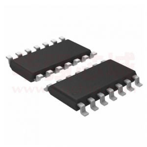

TC74VHC05F/FN/FT/FK TOSHIBA CMOS Digital Integrated Circuit Silicon Monolithic TC74VHC05F,TC74VHC05FN,TC74VHC05FT,TC74VHC05FK Hex Inverter (open drain) The TC74VHC05 is an advanced high speed CMOS INVERTER fabricated with silicon gate C2MOS technology. It achieves the high speed operation similar to equivalent Bipolar Schottky TTL while maintaining the CMOS low power dissipation. Pin configuration and function are the same as the TC74VHC04, but the TC74VHC05 has high performance MOS N-channel transistor. (OPEN-DRAIN outputs) This device can, therefore, with a suitable pull-up resistors, be used in wired-AND, LED drive and other applications. An input protection circuit ensures that 0 to 5.5 V can be applied to the input pins without regard to the supply voltage. This device can be used to interface 5 V to 3 V systems and two supply systems such as battery back up. This circuit prevents device destruction due to mismatched supply and input voltages. Note: xxxFN (JEDEC SOP) is not available in Japan. TC74VHC05F TC74VHC05FN Features • • • • • • • High speed: tpZ = 3.8 ns (typ.) at VCC = 5 V Low power dissipation: ICC = 2 μA (max) at Ta = 25°C High noise immunity: VNIH = VNIL = 28% VCC (min) Power down protection is provided on all inputs. Wide operating voltage range: VCC (opr) = 2 to 5.5 V Low noise: VOLP = 0.8 V (max) Pin and function compatible with 74ALS05 TC74VHC05FT TC74VHC05FK Weight SOP14-P-300-1.27A SOL14-P-150-1.27 TSSOP14-P-0044-0.65A VSSOP14-P-0030-0.50 : 0.18 g (typ.) : 0.12 g (typ.) : 0.06 g (typ.) : 0.02 g (typ.) 1 2007-10-01 TC74VHC05F/FN/FT/FK Pin Assignment IEC Logic Symbol 1A 1A 1Y 2A 2Y 3A 3Y GND 1 2 3 4 5 6 7 (top view) 14 13 12 11 10 9 8 VCC 6A 6Y 5A 5Y 4A 4Y 2A 3A 4A (1) (3) (5) (9) 1 (2) (4) (6) (8) 1Y 2Y 3Y (11) 5A (13) 6A 4Y (10) 5Y (12) 6Y Truth Table A L H Y Z L System Diagram (per gate) VCC Y A Absolute Maximum Ratings (Note) Characteristics Supply voltage range DC input voltage DC output voltage Input diode current Output diode current DC output current DC VCC/ground current Power dissipation Storage temperature Symbol VCC VIN VOUT IIK IOK IOUT ICC PD Tstg Rating −0.5 to 7.0 −0.5 to 7.0 −0.5 to VCC + 0.5 −20 ±20 ±25 ±50 180 −65 to 150 Unit V V V mA mA mA mA mW °C Note: Exceeding any of the absolute maximum ratings, even briefly, lead to deterioration in IC performance or even destruction. Using continuously under heavy loads (e.g. the application of high temperature/current/voltage and the significant change in temperature, etc.) may cause this product to decrease in the reliability significantly even if the operating conditions (i.e. operating temperature/current/voltage, etc.) are within the absolute maximum ratings and the operating ranges. Please design the appropriate reliability upon reviewing the Toshiba Semiconductor Reliability Handbook (“Handling Precautions”/“Derating Concept and Methods”) and individual reliability data (i.e. reliability test report and estimated failure rate, etc). 2 2007-10-01 TC74VHC05F/FN/FT/FK Operating Ranges (Note) Characteristics Supply voltage Input voltage Output voltage Operating temperature Input rise and fall time Symbol VCC VIN VOUT Topr dt/dv Rating 2.0 to 5.5 0 to 5.5 0 to VCC −40 to 85 0 to 100 (VCC = 3.3 ± 0.3 V) 0 to 20 (VCC = 5 ± 0.5 V) Unit V V V °C ns/V Note: The operating ranges must be maintained to ensure the normal operation of the device. Unused inputs must be tied to either VCC or GND. Electrical Characteristics DC Characteristics Test Condition Characteristics Symbol VCC (V) 2.0 High-level input voltage VIH ― 3.0 to 5.5 2.0 Low-level input voltage VIL ― 3.0 to 5.5 2.0 IOL = 50 μA Low-level output voltage VOL VIN = VIH IOL = 4 mA IOL = 8 mA Output off-state current Input leakage current Quiescent supply current IOZ IIN ICC VIN = VIL VOUT = VCC or GND VIN = 5.5 V or GND VIN = VCC or GND 3.0 4.5 3.0 4.5 5.5 0 to 5.5 5.5 ― ― ― ― ― ― ― ― ― ― ― ― 0.0 0.0 0.0 ― ― ― ― ― Min 1.50 VCC × 0.7 Ta = 25°C Typ. ― ― Max ― ― Ta = −40 to 85°C Min 1.50 VCC × 0.7 Max ― ― Unit V 0.50 VCC × 0.3 0.1 0.1 0.1 0.36 0.36 ±0.25 ±0.1 2.0 ― ― ― ― ― ― ― ― ― ― 0.50 VCC × 0.3 0.1 0.1 0.1 0.44 0.44 ±2.50 ±1.0 20.0 μA μA μA V V 3 2007-10-01 TC74VHC05F/FN/FT/FK AC Characteristics (input: tr = tf = 3 ns) Characteristics Symbol Test Condition VCC (V) 3.3 ± 0.3 Propagation delay time tpZL RL = 1 kΩ 5.0 ± 0.5 Propagation delay time Input capacitance Output capacitance Power dissipation capacitance 3.3 ± 0.3 5.0 ± 0.5 ― ― (Note) CL (pF) 15 50 15 50 50 50 Min ― ― ― ― ― ― ― ― ― Ta = 25°C Typ. 5.0 7.5 3.8 5.3 7.5 5.3 4 5 6 Max 7.1 10.6 5.5 7.5 10.6 7.5 10 ― ― Ta = −40 to 85°C Min 1.0 1.0 1.0 1.0 1.0 1.0 ― ― ― Max 8.5 12.0 6.5 8.5 12.0 8.5 10 ― ― ns pF pF pF ns Unit tpLZ CIN COUT CPD RL = 1 kΩ Note: CPD is defined as the value of the internal equivalent capacitance which is calculated from the operating current consumption without load. Average operating current can be obtained by the equation: ICC (opr) = CPD·VCC·fIN + ICC/6 (per gate) Noise Characteristics (input: tr = tf = 3 ns) Characteristics Quiet output maximum dynamic Quiet output minimum dynamic VOL VOL Symbol VOLP VOLV VIHD VILD CL = 50 pF CL = 50 pF CL = 50 pF CL = 50 pF Test Condition VCC (V) 5.0 5.0 5.0 5.0 Ta = 25°C Typ. 0.4 −0.4 ― ― Limit 0.8 −0.8 3.5 1.5 Unit V V V V Minimum high level dynamic input voltage Maximum low level dynamic input voltage Input Equivalent Circuit INPUT 4 2007-10-01 TC74VHC05F/FN/FT/FK Package Dimensions Weight: 0.18 g (typ.) 5 2007-10-01 TC74VHC05F/FN/FT/FK Package Dimensions (Note) Note: This package is not available in Japan. Weight: 0.12 g (typ.) 6 2007-10-01 TC74VHC05F/FN/FT/FK Package Dimensions Weight: 0.06 g (typ.) 7 2007-10-01 TC74VHC05F/FN/FT/FK Package Dimensions Weight: 0.02 g (typ.) 8 2007-10-01 TC74VHC05F/FN/FT/FK RESTRICTIONS ON PRODUCT USE • The information contained herein is subject to change without notice. 20070701-EN GENERAL • TOSHIBA is continually working to improve the quality and reliability of its products. Nevertheless, semiconductor devices in general can malfunction or fail due to their inherent electrical sensitivity and vulnerability to physical stress. It is the responsibility of the buyer, when utilizing TOSHIBA products, to comply with the standards of safety in making a safe design for the entire system, and to avoid situations in which a malfunction or failure of such TOSHIBA products could cause loss of human life, bodily injury or damage to property. In developing your designs, please ensure that TOSHIBA products are used within specified operating ranges as set forth in the most recent TOSHIBA products specifications. Also, please keep in mind the precautions and conditions set forth in the “Handling Guide for Semiconductor Devices,” or “TOSHIBA Semiconductor Reliability Handbook” etc. • The TOSHIBA products listed in this document are intended for usage in general electronics applications (computer, personal equipment, office equipment, measuring equipment, industrial robotics, domestic appliances, etc.).These TOSHIBA products are neither intended nor warranted for usage in equipment that requires extraordinarily high quality and/or reliability or a malfunction or failure of which may cause loss of human life or bodily injury (“Unintended Usage”). Unintended Usage include atomic energy control instruments, airplane or spaceship instruments, transportation instruments, traffic signal instruments, combustion control instruments, medical instruments, all types of safety devices, etc.. Unintended Usage of TOSHIBA products listed in his document shall be made at the customer’s own risk. • The products described in this document shall not be used or embedded to any downstream products of which manufacture, use and/or sale are prohibited under any applicable laws and regulations. • The information contained herein is presented only as a guide for the applications of our products. No responsibility is assumed by TOSHIBA for any infringements of patents or other rights of the third parties which may result from its use. No license is granted by implication or otherwise under any patents or other rights of TOSHIBA or the third parties. • Please contact your sales representative for product-by-product details in this document regarding RoHS compatibility. Please use these products in this document in compliance with all applicable laws and regulations that regulate the inclusion or use of controlled substances. Toshiba assumes no liability for damage or losses occurring as a result of noncompliance with applicable laws and regulations. 9 2007-10-01
