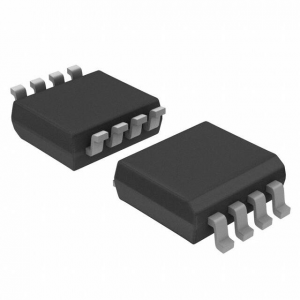

TC75W59FU/FK TOSHIBA CMOS Linear Integrated Circuit Silicon Monolithic TC75W59FU,TC75W59FK Dual Comparator TC75W59 is a CMOS type general-purpose dual comparator capable of single power supply operation and using lower supply currents than the conventional bipolar comparators. Its open drain output forms wired OR with other open drain outputs. Features Low supply current: IDD = 200μA (typ.) Single power supply operation Wide common mode input voltage range: VSS~VDD−0.9V Open drain output circuit Low input bias current Small package Weight SSOP8-P-0.65: 0.021g (typ.) SSOP8-P-0.50A: 0.01g (typ.) Marking (Top View) Pin Connection (Top View) 1 2007-11-01 TC75W59FU/FK Absolute Maximum Ratings (Ta = 25°C) Characteristic Supply voltage Differential input voltage Input voltage Output current Symbol VDD, VSS DVIN VIN IO Rating ±3.5 or 7 ±7 VSS~VDD ±35 250 (TC75W59FU) 200 (TC75W59FK) −40~85 −55~125 N V V V mA Power dissipation PD mW Operating temperature Storage temperature Topr Tstg °C °C Note: Using continuously under heavy loads (e.g. the application of high temperature/current/voltage and the significant change in temperature, etc.) may cause this product to decrease in the reliability significantly even if the operating conditions (i.e. operating temperature/current/voltage, etc.) are within the absolute maximum ratings and the operating ranges. Please design the appropriate reliability upon reviewing the Toshiba Semiconductor Reliability Handbook (“Handling Precautions”/“Derating Concept and Methods”) and individual reliability data (i.e. reliability test report and estimated failure rate, etc). Note: Since this product sometimes brings about latchcap, which is peculiar to CMOS devices, note the following points: • Don’t raise the voltage level of I/O pins beyond VDD, nor lower it below VSS. Consider the timing for power supply, too. • Don’t let any abnormal noise enter the device. 2 2007-11-01 TC75W59FU/FK Electrical Characteristics (VDD = 5V, VSS = GND, Ta = 25°C) Characteristic Input offset voltage Input offset current Input bias current Common mode input voltage Supply current Voltage gain Sink current Output leak current Output voltage Operating supply voltage Propagation delay time (turn on) Symbol VIO IIO II CMVIN IDD (Note) GV Isink ILEAK VOL VDD tPLH (1) tPLH (2) tPHL (1) tPHL (2) tTLH tTHL Test Circuit ― ― ― ― ― ― ― ― ― ― ― ― ― ― ― ― VOL = 0.5V V O = 5V Isink = 5.0mA ― Over drive = 100mV TTL step input Over drive = 100mV TTL step input Over drive = 100mV Over drive = 100mV Test Condition ― ― ― ― ― ― Min ― ― ― 0 ― ― 13 ― ― 1.8 ― ― ― ― ― ― Typ. ±1 1 1 ― 220 94 25 5 0.1 ― 200 140 80 60 160 3 Max ±7 ― ― 4.1 440 ― ― ― 0.3 7.0 ― ― ― ― ― ― ns Unit mV pA pA V μA dB mA nA V V ns Propagation delay time (turn off) ns Response time Electrical Characteristics (VDD = 3V, VSS = GND, Ta = 25°C) Characteristic Input offset voltage Input offset current Input bias current Common mode input voltage Supply current Sink current Output leak current Output voltage Propagation delay time (turn on) Symbol VIO IIO II CMVIN IDD (Note) Isink ILEAK VOL tPLH Test Circuit ― ― ― ― ― ― ― ― ― VOL = 0.5V V O = 3V Isink = 5.0mA Over drive = 100mV Test Condition ― ― ― ― ― Min ― ― ― 0 ― 6 ― ― ― Typ. ±1 1 1 ― 200 18 5 0.15 160 Max ±7 ― ― 2.1 400 ― ― 0.35 ― Unit mV pA pA V μA mA nA V ns Propagation delay time (turn off) tPHL tTLH tTHL ― ― ― Over drive = 100mV Over drive = 100mV Over drive = 100mV ― ― ― 70 170 3 ― ― ― ns Response time ns Note: Since this product causes an increase in current consumption with a rise in operational frequency, make sure that power consumption does not exceed the allowable dissipation. 3 2007-11-01 TC75W59FU/FK Package Dimensions SSOP8-P-0.65 Unit: mm Weight: 0.021g(typ.) 4 2007-11-01 TC75W59FU/FK Package Dimensions SSOP8-P-0.50A Unit: mm Weight: 0.01g(typ.) 5 2007-11-01 TC75W59FU/FK RESTRICTIONS ON PRODUCT USE • The information contained herein is subject to change without notice. 20070701-EN GENERAL • TOSHIBA is continually working to improve the quality and reliability of its products. Nevertheless, semiconductor devices in general can malfunction or fail due to their inherent electrical sensitivity and vulnerability to physical stress. It is the responsibility of the buyer, when utilizing TOSHIBA products, to comply with the standards of safety in making a safe design for the entire system, and to avoid situations in which a malfunction or failure of such TOSHIBA products could cause loss of human life, bodily injury or damage to property. In developing your designs, please ensure that TOSHIBA products are used within specified operating ranges as set forth in the most recent TOSHIBA products specifications. Also, please keep in mind the precautions and conditions set forth in the “Handling Guide for Semiconductor Devices,” or “TOSHIBA Semiconductor Reliability Handbook” etc. • The TOSHIBA products listed in this document are intended for usage in general electronics applications (computer, personal equipment, office equipment, measuring equipment, industrial robotics, domestic appliances, etc.).These TOSHIBA products are neither intended nor warranted for usage in equipment that requires extraordinarily high quality and/or reliability or a malfunction or failure of which may cause loss of human life or bodily injury (“Unintended Usage”). Unintended Usage include atomic energy control instruments, airplane or spaceship instruments, transportation instruments, traffic signal instruments, combustion control instruments, medical instruments, all types of safety devices, etc.. Unintended Usage of TOSHIBA products listed in his document shall be made at the customer’s own risk. • The products described in this document shall not be used or embedded to any downstream products of which manufacture, use and/or sale are prohibited under any applicable laws and regulations. • The information contained herein is presented only as a guide for the applications of our products. No responsibility is assumed by TOSHIBA for any infringements of patents or other rights of the third parties which may result from its use. No license is granted by implication or otherwise under any patents or other rights of TOSHIBA or the third parties. • Please contact your sales representative for product-by-product details in this document regarding RoHS compatibility. Please use these products in this document in compliance with all applicable laws and regulations that regulate the inclusion or use of controlled substances. Toshiba assumes no liability for damage or losses occurring as a result of noncompliance with applicable laws and regulations. 6 2007-11-01
