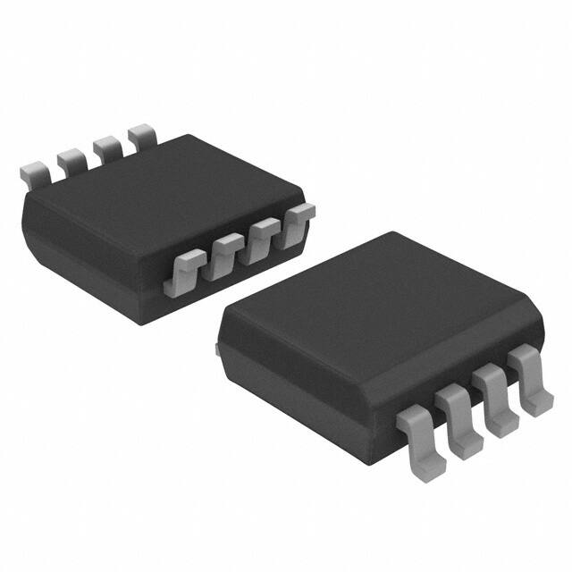

    SOT-765
    特性:高速:fMAX = 170 MHz(典型值),VCC = 5V。低功耗:ICC = 2 μA(最大值),TA = 25℃。高抗噪性:VNI N = VNHL = 28%VCC(最小值)。5.5V...
TC7WH74FK,LJ(CT 数据手册
TC7WH74FU/FK TOSHIBA CMOS Digital Integrated Circuit Silicon Monolithic TC7WH74FU,TC7WH74FK D-Type flip flop with preset and clear Features • High speed: fMAX = 170 MHz (typ.) at VCC = 5V • Low power dissipation: ICC = 2μA (max) at Ta = 25°C • High noise immunity: VNIH = VNIL = 28% VCC (min) • 5.5-V tolerant inputs • Balanced propagation delays: tpLH ∼ − tpHL • Wide operating voltage range: VCC = 2 to 5.5V TC7WH74FU (SM8) TC7WH74FK Marking SM8 US8 Product Name H74 Lot No. WH 74 (US8) Weight SSOP8-P-0.65: 0.02 g (typ.) SSOP8-P-0.50A: 0.01 g (typ.) Absolute Maximum Ratings (Ta = 25°C) Characteristics Symbol Rating Unit Supply voltage VCC −0.5 to 7.0 V DC input voltage VIN −0.5 to 7.0 V DC output voltage VOUT −0.5 to VCC + 0.5 V Input diode current IIK −20 mA Output diode current IOK ±20 ( Note 1) mA DC output current IOUT ±25 mA DC VCC/ground current ICC ±50 mA Power dissipation PD Storage temperature Tstg Lead temperature (10 s) TL 300 (SM8) 200 (US8) −65 to 150 260 Pin Assignment (top view) VCC PR CLR Q 8 7 6 5 °C CK D Q GND °C 1 2 3 4 mW Note: Using continuously under heavy loads (e.g. the application of high temperature/current/voltage and the significant change in temperature, etc.) may cause this product to decrease in the reliability significantly even if the operating conditions (i.e. operating temperature/current/voltage, etc.) are within the absolute maximum ratings and the operating ranges. Please design the appropriate reliability upon reviewing the Toshiba Semiconductor Reliability Handbook (“Handling Precautions”/“Derating Concept and Methods”) and individual reliability data (i.e. reliability test report and estimated failure rate, etc). Note 1: VOUT < GND、VOUT > VCC 1 2009-09-28 TC7WH74FU/FK IEC Logic Symbol Truth Table Inputs PR S CK C D D CLR R Q Q Outputs Function CLR PR D CK Q Q L H X X L H Clear H L X X H L Preset X L L X H H ⎯ H H L L H ⎯ H H H H L ⎯ H H X Qn Qn No Change X: Don’t care Operating Range Characteristics Symbol Rating Unit Supply voltage VCC 2.0 to 5.5 V Input voltage VIN 0 to 5.5 V VOUT 0 to VCC V Operating temperature Topr −40 to 85 °C Input rise and fall time dt/dv Output voltage 0 to 100 (VCC = 3.3 ± 0.3 V) 0 to 20 (VCC = 5.0 ± 0.5 V) 2 ns/V 2009-09-28 TC7WH74FU/FK Electrical Characteristics DC Characteristics Characteristics Symbol Test Condition High-level input voltage VIH ⎯ Low-level input voltage VIL ⎯ Ta = 25°C VCC (V) Min Typ. Max Min Max 2.0 1.5 ⎯ ⎯ 1.5 ⎯ 3.0 to 5.5 VCC × 0.7 ⎯ ⎯ VCC × 0.7 ⎯ 2.0 ⎯ ⎯ 0.5 ⎯ 0.5 3.0 to 5.5 ⎯ ⎯ VCC × 0.3 ⎯ VCC × 0.3 2.0 1.9 2.0 ⎯ 1.9 ⎯ 3.0 2.9 3.0 ⎯ 2.9 ⎯ 4.5 4.4 4.5 ⎯ 4.4 ⎯ IOH = −4 mA 3.0 2.58 ⎯ ⎯ 2.48 ⎯ IOH = −8 mA 4.5 3.94 ⎯ ⎯ 3.80 ⎯ 2.0 ⎯ 0.0 0.1 ⎯ 0.1 3.0 ⎯ 0.0 0.1 ⎯ 0.1 4.5 ⎯ 0.0 0.1 ⎯ 0.1 IOL = 4 mA 3.0 ⎯ ⎯ 0.36 ⎯ 0.44 IOL = 8 mA 4.5 ⎯ ⎯ 0.36 ⎯ 0.44 IOH = −50 μA High-level output voltage VOH VIN = VIH or VIL IOL = 50 μA Low-level output voltage VOL Ta = −40 to 85°C VIN = VIH or VIL Unit V V V V Input leakage current IIN VIN = 5.5 V or GND 0 to 5.5 ⎯ ⎯ ±0.1 ⎯ ±1.0 μA Quiescent supply current ICC VIN = VCC or GND 5.5 ⎯ ⎯ 2.0 ⎯ 20.0 μA TIMING REQUIREMENTS (unless otherwise specified, Input: tr = tf = 3 ns ) Characteristics Minimum pulse width (CK) Minimum pulse width ( CLR , PR ) Ta = 25°C Ta = −40 to 85°C VCC (V) Limit Limit tW (L) 3.3 ± 0.3 6.0 7.0 tW (H) 5.0 ± 0.5 5.0 5.0 3.3 ± 0.3 6.0 7.0 5.0 ± 0.5 5.0 5.0 3.3 ± 0.3 6.0 7.0 5.0 ± 0.5 5.0 5.0 3.3 ± 0.3 0.5 0.5 5.0 ± 0.5 0.5 0.5 3.3 ± 0.3 5.0 5.0 5.0 ± 0.5 3.0 3.0 Symbol tW (L) Minimum setup time ts Minimum hold time th Minimum removal time ( CLR , PR ) Test Condition trem 3 Unit ns 2009-09-28 TC7WH74FU/FK AC Characteristics (unless otherwise specified, Input: tr = tf = 3 ns) Characteristics Symbol Ta = 25°C Test Condition VCC (V) Propagation delay time (CK-Q, Q ) tpLH tpHL Propagation delay time tpLH ( CLR , PR -Q, Q ) tpHL 3.3 ± 0.3 5.0 ± 0.5 3.3 ± 0.3 5.0 ± 0.5 3.3 ± 0.3 Maximum clock frequency fMAX 5.0 ± 0.5 Input capacitance CIN Power dissipation capacitance CPD CL (pF) Min Typ. Max Min Max 15 ⎯ 6.7 11.9 1.0 14.0 50 ⎯ 9.2 15.4 1.0 17.5 15 ⎯ 4.6 7.3 1.0 8.5 50 ⎯ 6.1 9.3 1.0 10.5 15 ⎯ 7.6 12.3 1.0 14.5 50 ⎯ 10.1 15.8 1.0 18.0 15 ⎯ 4.8 7.7 1.0 9.0 50 ⎯ 6.3 9.7 1.0 11.0 15 80 125 ⎯ 70 ⎯ 50 50 75 ⎯ 45 ⎯ 15 130 170 ⎯ 110 ⎯ 50 90 115 ⎯ 75 ⎯ ⎯ 4 10 ⎯ 10 ⎯ ⎯ ⎯ ⎯ (Note 2) Ta = −40~85°C 22 Unit ns ns MHz pF pF Note 2: CPD is defined as the value of the internal equivalent capacitance which is calculated from the operating current consumption without load. Average operating current can be obtained by the equation: ICC (opr) = CPD•VCC•fIN + ICC Input Equivalent Circuit 4 2009-09-28 TC7WH74FU/FK Package Dimensions Mass: 0.02 g (typ.) 5 2009-09-28 TC7WH74FU/FK Package Dimensions Mass: 0.01 g (typ.) 6 2009-09-28 TC7WH74FU/FK RESTRICTIONS ON PRODUCT USE • Toshiba Corporation, and its subsidiaries and affiliates (collectively “TOSHIBA”), reserve the right to make changes to the information in this document, and related hardware, software and systems (collectively “Product”) without notice. • This document and any information herein may not be reproduced without prior written permission from TOSHIBA. Even with TOSHIBA’s written permission, reproduction is permissible only if reproduction is without alteration/omission. • Though TOSHIBA works continually to improve Product’s quality and reliability, Product can malfunction or fail. Customers are responsible for complying with safety standards and for providing adequate designs and safeguards for their hardware, software and systems which minimize risk and avoid situations in which a malfunction or failure of Product could cause loss of human life, bodily injury or damage to property, including data loss or corruption. Before customers use the Product, create designs including the Product, or incorporate the Product into their own applications, customers must also refer to and comply with (a) the latest versions of all relevant TOSHIBA information, including without limitation, this document, the specifications, the data sheets and application notes for Product and the precautions and conditions set forth in the “TOSHIBA Semiconductor Reliability Handbook” and (b) the instructions for the application with which the Product will be used with or for. Customers are solely responsible for all aspects of their own product design or applications, including but not limited to (a) determining the appropriateness of the use of this Product in such design or applications; (b) evaluating and determining the applicability of any information contained in this document, or in charts, diagrams, programs, algorithms, sample application circuits, or any other referenced documents; and (c) validating all operating parameters for such designs and applications. TOSHIBA ASSUMES NO LIABILITY FOR CUSTOMERS’ PRODUCT DESIGN OR APPLICATIONS. • Product is intended for use in general electronics applications (e.g., computers, personal equipment, office equipment, measuring equipment, industrial robots and home electronics appliances) or for specific applications as expressly stated in this document. Product is neither intended nor warranted for use in equipment or systems that require extraordinarily high levels of quality and/or reliability and/or a malfunction or failure of which may cause loss of human life, bodily injury, serious property damage or serious public impact (“Unintended Use”). Unintended Use includes, without limitation, equipment used in nuclear facilities, equipment used in the aerospace industry, medical equipment, equipment used for automobiles, trains, ships and other transportation, traffic signaling equipment, equipment used to control combustions or explosions, safety devices, elevators and escalators, devices related to electric power, and equipment used in finance-related fields. Do not use Product for Unintended Use unless specifically permitted in this document. • Do not disassemble, analyze, reverse-engineer, alter, modify, translate or copy Product, whether in whole or in part. • Product shall not be used for or incorporated into any products or systems whose manufacture, use, or sale is prohibited under any applicable laws or regulations. • The information contained herein is presented only as guidance for Product use. No responsibility is assumed by TOSHIBA for any infringement of patents or any other intellectual property rights of third parties that may result from the use of Product. No license to any intellectual property right is granted by this document, whether express or implied, by estoppel or otherwise. • ABSENT A WRITTEN SIGNED AGREEMENT, EXCEPT AS PROVIDED IN THE RELEVANT TERMS AND CONDITIONS OF SALE FOR PRODUCT, AND TO THE MAXIMUM EXTENT ALLOWABLE BY LAW, TOSHIBA (1) ASSUMES NO LIABILITY WHATSOEVER, INCLUDING WITHOUT LIMITATION, INDIRECT, CONSEQUENTIAL, SPECIAL, OR INCIDENTAL DAMAGES OR LOSS, INCLUDING WITHOUT LIMITATION, LOSS OF PROFITS, LOSS OF OPPORTUNITIES, BUSINESS INTERRUPTION AND LOSS OF DATA, AND (2) DISCLAIMS ANY AND ALL EXPRESS OR IMPLIED WARRANTIES AND CONDITIONS RELATED TO SALE, USE OF PRODUCT, OR INFORMATION, INCLUDING WARRANTIES OR CONDITIONS OF MERCHANTABILITY, FITNESS FOR A PARTICULAR PURPOSE, ACCURACY OF INFORMATION, OR NONINFRINGEMENT. • Do not use or otherwise make available Product or related software or technology for any military purposes, including without limitation, for the design, development, use, stockpiling or manufacturing of nuclear, chemical, or biological weapons or missile technology products (mass destruction weapons). Product and related software and technology may be controlled under the Japanese Foreign Exchange and Foreign Trade Law and the U.S. Export Administration Regulations. Export and re-export of Product or related software or technology are strictly prohibited except in compliance with all applicable export laws and regulations. • Please contact your TOSHIBA sales representative for details as to environmental matters such as the RoHS compatibility of Product. Please use Product in compliance with all applicable laws and regulations that regulate the inclusion or use of controlled substances, including without limitation, the EU RoHS Directive. TOSHIBA assumes no liability for damages or losses occurring as a result of noncompliance with applicable laws and regulations. 7 2009-09-28
