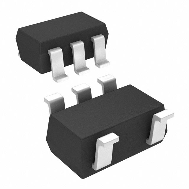

TCR2LF series, TCR2LE series TOSHIBA CMOS Linear Integrated Circuit Silicon Monolithic TCR2LF series TCR2LE series Ultra low quiescent current 200 mA CMOS Low Drop-Out Regulator in ultra small package The TCR2LF and TCR2LE series are CMOS general-purpose single-output voltage regulators with an on/off control input, featuring ultra low quiescent bias current and low dropout voltage. These voltage regulators are available in fixed output voltages between 0.8 V and 3.6 V and capable of driving up to 200 mA. They feature overcurrent protection and Auto-discharge function. The package is general SMV(SOT-25) (2.8 mm x 2.9 mm x 1.1 mm ) and ESV(SOT-553) (1.6 mm x 1.6 mm x 0.55 mm ), and has a low dropout voltage of 270 mV ( 2.5 V output, IOUT = 150 mA). As small ceramic input and output capacitors 0.1μF can be used with the TCR2LF and TCR2LE series, these devices are ideal for portable applications that require high-density board assembly such as cellular phones. SMV ESV Weight : SMV (SOT-25)(SC-74A) : 16.0 mg ( typ.) ESV (SOT-553) : 3.0 mg ( typ.) Features • Low quiescent bias current ( IB = 2 μA (max) at IOUT = 0 mA, Tj = -40 to 85°C) • Low Drop-Out voltage VIN-VOUT = 270 mV (typ.) at 2.5 V-output, IOUT = 150 mA • Wide range output voltage line up ( VOUT = 0.8 to 3.6 V ) • High VOUT accuracy ±1.0% ( 1.8V ≤ VOUT ) • Overcurrent protection • Auto-discharge • Pull down connection between CONTROL and GND • Ceramic capacitors can be used ( CIN = 0.1 μF, COUT =0.1 μF ) • General package SMV(SOT-25) (2.8 mm x 2.9 mm x 1.1 mm ) and ESV(SOT-553) (1.6 mm x 1.6 mm x 0.55 mm ) 1 2014-11-06 TCR2LF series, TCR2LE series Absolute Maximum Ratings (Ta = 25°C) Characteristics Symbol Rating Unit Input voltage VIN 6.0 V Control voltage VCT -0.3 to 6.0 V Output voltage VOUT -0.3 to VIN + 0.3 V Output current IOUT 200 mA SMV Power dissipation PD ESV Operation temperature range Junction temperature Storage temperature range Note: 200 (Note1) 580 (Note 2) 150 (Note 1) 320 (Note 3) mW Topr −40 to 85 °C Tj 150 °C Tstg −55 to 150 °C Using continuously under heavy loads (e.g. the application of high temperature/current/voltage and the significant change in temperature, etc.) may cause this product to decrease in the reliability significantly even if the operating conditions (i.e. operating temperature/current/voltage, etc.) are within the absolute maximum ratings and the operating ranges. Please design the appropriate reliability upon reviewing the Toshiba Semiconductor Reliability Handbook (“Handling Precautions”/“Derating Concept and Methods”) and individual reliability data (i.e. reliability test report and estimated failure rate, etc). Note 1: Unit Rating Note 2: Rating at mounting on a board (FR4 board: 25.4 mm × 25.4 mm × 1.6 mm) Note 3: Rating at mounting on a board (FR4 board dimension: 30 mm × 30 mm × 0.8 mm) Pin Assignment (top view) SMV(SOT-25)(SC-74A) VOUT NC 5 4 ESV(SOT-553) 1 1 VIN 2 GND 3 CONTROL VOUT NC 5 CONTROL 2 4 2 3 GND VIN 2014-11-06 TCR2LF series, TCR2LE series List of Products Number, Output voltage and Marking TCR2LF and TCR2LE series Product No. VOUT(V) (typ.) Marking SMV(SOT-25) ESV(SOT-553) TCR2LF08 TCR2LE08 0.8 TCR2LF085 TCR2LE085 TCR2LF09 Product No. VOUT(V) (typ.) Marking SMV(SOT-25) ESV(SOT-553) 0L8 TCR2LF19 TCR2LE19 1.9 1L9 0.85 0LD TCR2LF20 TCR2LE20 2.0 2L0 TCR2LE09 0.9 0L9 TCR2LF21 TCR2LE21 2.1 2L1 TCR2LF095 TCR2LE095 0.95 0LE TCR2LF25 TCR2LE25 2.5 2L5 TCR2LF10 TCR2LE10 1.0 1L0 TCR2LF27 TCR2LE27 2.7 2L7 TCR2LF105 TCR2LE105 1.05 1LA TCR2LF28 TCR2LE28 2.8 2L8 TCR2LF11 TCR2LE11 1.1 1L1 TCR2LF285 TCR2LE285 2.85 2LD TCR2LF115 TCR2LE115 1.15 1LB TCR2LF30 TCR2LE30 3.0 3L0 TCR2LF12 TCR2LE12 1.2 1L2 TCR2LF31 TCR2LE31 3.1 3L1 TCR2LF13 TCR2LE13 1.3 1L3 TCR2LF32 TCR2LE32 3.2 3L2 TCR2LF15 TCR2LE15 1.5 1L5 TCR2LF33 TCR2LE33 3.3 3L3 TCR2LF18 TCR2LE18 1.8 1L8 TCR2LF36 TCR2LE36 3.6 3L6 * Please contact local Toshiba representative if you are interested in product that output voltage is not in the list. Marking (top view) Example: TCR2LF33 (3.3 V output) Example: TCR2LE33 (3.3 V output) 3L3 3L3 3 2014-11-06 TCR2LF series, TCR2LE series Electrical Characteristics (Unless otherwise specified, VIN = VOUT+1 V (VOUT>1.5V), VIN=2.5V (VOUT≤1.5V), IOUT = 50 mA, CIN = 0.1 μF, COUT = 0.1 μF) Tj = 25°C Characteristics Symbol Unit Min Output voltage accuracy VOUT Input voltage VIN Tj = -40 to 85°C Test Condition Typ. Max Min Max IOUT = 50 mA VOUT

物料型号:TCR2LF系列和TCR2LE系列
器件简介: - 这些电压调节器采用CMOS工艺制造,具有超低的静态偏置电流和低降额电压。 - 它们非常适合用于需要高密度板组装的便携式应用,如手机。
引脚分配: - SMV(SOT-25)和ESV(SOT-553)两种封装类型,具有不同的尺寸和重量。
参数特性: - 静态偏置电流低(最大2μA,当IOUT=0mA,Tj=-40至85°C) - 降额电压低(典型值270mV,2.5V输出,IOUT=150mA) - 输出电压精度高(±1.0%,1.8V ≤ VOUT) - 具有过流保护和自动放电功能
功能详解: - 设备支持使用小尺寸陶瓷输入和输出电容(0.1μF),适合高密度板组装。 - 控制引脚可以进行开关控制,高电平开启,低电平关闭。
应用信息: - 适用于便携式设备,尤其是那些需要高密度板组装的应用。
封装信息: - 提供SMV(SOT-25)和ESV(SOT-553)两种封装选项,具有不同的尺寸和重量。
