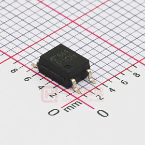

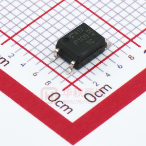

TLP109 TOSHIBA Photocoupler GaAℓAs Ired & Photo−IC TLP109 Digital Logic Isolation Line Receivers Power Supply Feedback Control Switching Power Supplies Transistor Inverters The Toshiba TLP109 mini-flat coupler is a small-outline coupler suitable for surface-mount assembly. The TLP109 consists of a high-output-power GaAℓAs light emitting diode optically coupled to a high-speed photodiode-transistor chip. The TLP109 is housed in the 6-pin SO package and guarantees a creepage distance of ≥ 5.0 mm, a clearance of ≥ 5.0 mm and an insulation thickness of ≥ 0.4 mm. Therefore, the TLP109 meets the reinforced insulation class requirements of international safety standards. Unit: mm 6 5 4 1 3 3.7 -0.15 +0.25 4.55 +0.25 -0.15 7.0 ± 0.4 0.1 2.1 ± 0.1 0.15 0.4 1.27 2.54 0.5 min • • • • • • Isolation voltage: 3750 Vrms (min) Switching speed: tpHL = 0.8 μs, tpLH = 0.8 μs (max) (@RL = 1.9 kΩ) TTL-compatible UL recognized :UL1577, File No.E67349 TOSHIBA 11-4L1 Weight: 0.08 g (Typ.) c-UL recognized :CSA Component Acceptance Service No. 5A, File No.E67349 VDE under application : DIN EN60747-5-2 Pin Configuration (Top View) Schematic IF ICC IO 6 5 SHIELD 4 VCC VO GND 1 VF 3 1: ANODE 3: CATHODE 4: EMITTER (GN D) 5: COLLECTOR (OUTPUT) 6: V CC Construction Mechanical Ratings Creepage distance: 5.0 mm (min) Clearance: 5.0 mm (min) Insulation thickness: 0.4 mm (min) 1 2009-04-01 TLP109 Absolute Maximum Ratings (Ta = 25°C) Characteristic Forward current LED Pulse forward current Peak transient forward current Reverse voltage Output current Detector Peak output current Supply voltage Output voltage Output power dissipation Operating temperature range Storage temperature range Lead solder temperature (10 sec.) Isolation Voltage (AC,1 min., R.H.≤ 60°%) (Note 5) (Note 4) (Note 1) (Note 2) (Note 3) Symbol IF IFP IFPT VR IO IOP VCC VO PO Topr Tstg Tsol BVS Rating 20 40 1 5 8 16 −0.5 to 30 −0.5 to 20 100 −55 to 100 −55 to 125 260 3750 Unit mA mA A V mA mA V V mW °C °C °C Vrms Note: Using continuously under heavy loads (e.g. the application of high temperature/current/voltage and the significant change in temperature, etc.) may cause this product to decrease in the reliability significantly even if the operating conditions (i.e. operating temperature/current/voltage, etc.) are within the absolute maximum ratings. Please design the appropriate reliability upon reviewing the Toshiba Semiconductor Reliability Handbook (“Handling Precautions”/“Derating Concept and Methods”) and individual reliability data (i.e. reliability test report and estimated failure rate, etc). (Note 1) Derate 0.36 mA / °C above 70°C. (Note 2) 50% duty cycle, 1 ms pulse width. Derate 0.72 mA / °C above 70°C. (Note 3) Pulse width ≤ 1 μs, 300 pps. (Note 4) Derate 1.8 mW / °C above 70°C. (Note 5) Device considered a two−terminal device: Pins 1 and 3 shorted together, and pins 4, 5 and 6 shorted together. 2 2009-04-01 TLP109 Electrical Characteristics (Ta = 25°C) Characteristic Forward voltage LED Forward voltage temperature coefficient Reverse current Capacitance between terminals Symbol VF ΔVF / ΔTa IR CT IOH (1) Detector High level output current IOH (2) IOH High level supply current Current transfer ratio ICCH IO / IF Test Condition IF = 16 mA IF = 16 mA VR = 3 V VF = 0 V, f = 1 MHz IF = 0 mA, VCC = VO = 5.5 V IF = 0 mA, VCC = 30 V V O = 20 V IF = 0 mA, VCC = 30 V VO = 20V, Ta = 70°C IF = 0 mA, VCC = 30 V IF = 16 mA, VCC = 4.5 V VO = 0.4 V IF = 16 mA, VCC = 4.5 V IO = 2.4 mA Min 1.50 Typ. 1.64 −2 Max 1.85 Unit V mV /°C μA pF nA ― ― ― ― ― ― ― 20 ― 10 ― 60 3 ― 500 5 ― ― 0.01 μA 50 1 μA % ― ― ― 0.4 Low level output voltage VOL ― V Isolation Characteristics (Ta = 25°C) Characteristic Capacitance input to output Isolation resistance Symbol CS RS Test Conditions V = 0 V, f = 1 MHz R.H. ≤ 60%, VS = 500 V AC,1 minute Isolation voltage BVS AC,1 second, in oil DC,1 minute, in oil (Note 5) Min ― 5×10 10 Typ. 0.8 10 14 Max ― ― ― ― ― Unit pF Ω Vrms Vdc (Note 5) 3750 ― ― ― 10000 10000 Switching Characteristics (Ta = 25°C, VCC = 5 V) Characteristic Symbol Test Cir− cuit 1 Test Condition IF = 0→ 16 mA RL = 1.9 kΩ IF = 1 6 → 0 m A RL = 1.9 kΩ IF = 0 mA, VCM = 400 Vp−p RL = 4.1 kΩ IF = 16 mA, VCM = 400 Vp−p RL = 4.1 kΩ Min Typ. Max Unit Propagation delay time (H→ L) tpHL ― ― 5000 ― ― 10000 0.8 μs Propagation delay time (L→ H) Common mode transient immunity at high output level (Note 6) Common mode transient Immunity at low output level (Note 6) tpLH 1 0.8 μs CMH CML 2 ― ― V / μs 2 −5000 −10000 V / μs (Note 6) CML is the maximum rate of fall of the common mode voltage that can be sustained with the output voltage in the logic low state (VO < 0.8 V). CMH is the maximum rate of rise of the common mode voltage that can be sustained with the output voltage in the logic high state (VO > 2.0 V) (Note 7) Maximum electrostatic discharge voltage for any pins: 100 V (C = 200 pF, R=0) 3 2009-04-01 TLP109 Test Circuit 1: Switching Time Test Circuit PULSE INPUT PW = 100 μs DUTY RATIO = 1/10 IF MONITOR 100 Ω 3 IF 1 6 5 4 RL VO OUTPUT MONITOR VCC = 5 V IF 0 VO 1.5V tpHL tpLH 5V 1.5 VOL Test Circuit 2: Common Mode Transient Immunity Test Circuit IF 1 6 5 3 VCM PULSE GENERATOR ZO = 50 Ω VO (IF = 16 mA) 4 RL VO OUTPUT MONITOR VO (IF = 0 mA) VCC = 5 V VCM tr 90% 10% tf 5V 2V 0.8 V VOL 400 V 0V CMH = 320(V) 320(V) CML = t r (μs) , t r (μs) 4 2009-04-01 TLP109 Specification for Embossed–Tape Packing (TPL)(TPR) for SO6 Coupler 1. Applicable Package Package SO6 Product Type Mini-flat coupler 2. Product Naming System Type of package used for shipment is denoted by a symbol suffix after a product number. The method of classification is as below. (Example) TLP109 (TPL) Tape type Device name 3. Tape Dimensions 3.1 Specification Classification Are as Shown in Table 1 Table 1 Tape Type Classification Tape type TPL TPR Classification L direction R direction Quantity (pcs / reel) 3000 3000 3.2 Orientation of Device in Relation to Direction of Tape Movement Device orientation in the recesses is as shown in Figure 1. Direction of Tape L direction R direction Figure 1 Device Orientation 5 2009-04-01 TLP109 3.3 Empty Device Recesses Are as Shown in Table 2. Table 2 Empty Device Recesses Standard Occurrences of 2 or more successive empty device recesses Single empty device recesses Remarks Within any given 40-mm section of tape, not including leader and trailer Not including leader and trailer 0 6 devices (max) per reel 3.4 Start and End of Tape The start of the tape has 50 or more empty holes. The end of tape has 50 or more empty holes and two empty turns only for a cover tape. 3.5 Tape Specification (1) Tape material: Plastic (protection against electrostatics) (2) Dimensions: The tape dimensions are as shown in Figure 2 and Table 3. 0.3 ± 0.05 +0.1 φ1.5 −0 G A E K0 φ1.6 ± 0.1 3.15 ± 0.2 F Figure 2 Tape Forms Table 3 Tape Dimensions Unit: mm Unless otherwise specified: ±0.1 Symbol A B D E F G K0 Dimension 4.2 7.6 5.5 1.75 8.0 4.0 2.8 Remark ― ― Center line of indented square hole and sprocket hole Distance between tape edge and hole center +0.1 Cumulative error -0.3 (max) per 10 feed holes Cumulative error +0.1 (max) per 10 feed holes -0.3 Internal space 12.0 ± 0.3 B D 6 2009-04-01 TLP109 3.6 Reel (1) Material: Plastic (2) Dimensions: The reel dimensions are as shown in Figure 3 and Table 4. C U E B W1 W2 Figure 3 Reel Form Table 4 Reel Dimensions Unit: mm Symbol A B C E U W1 W2 Dimension Φ380 ±2 Φ80 ±1 Φ13 ±0.5 2.0 ±0.5 4.0 ±0.5 13.5 ±0.5 17.5 ±1.0 4. Packing Either one reel or five reels of photocoupler are packed in a shipping carton. 5. Label Indication The carton bears a label indicating the product number, the symbol representing classification of standard, the quantity, the lot number and the Toshiba company name. 6. Ordering Method When placing an order, please specify the product number, the tape type and the quantity as shown in the following example. (Example) TLP109 (TPL) 3000 pcs Quantity (must be a multiple of 3000) Tape type Device name A 7 2009-04-01 TLP109 RESTRICTIONS ON PRODUCT USE • Toshiba Corporation, and its subsidiaries and affiliates (collectively “TOSHIBA”), reserve the right to make changes to the information in this document, and related hardware, software and systems (collectively “Product”) without notice. • This document and any information herein may not be reproduced without prior written permission from TOSHIBA. Even with TOSHIBA’s written permission, reproduction is permissible only if reproduction is without alteration/omission. • Though TOSHIBA works continually to improve Product’s quality and reliability, Product can malfunction or fail. Customers are responsible for complying with safety standards and for providing adequate designs and safeguards for their hardware, software and systems which minimize risk and avoid situations in which a malfunction or failure of Product could cause loss of human life, bodily injury or damage to property, including data loss or corruption. Before creating and producing designs and using, customers must also refer to and comply with (a) the latest versions of all relevant TOSHIBA information, including without limitation, this document, the specifications, the data sheets and application notes for Product and the precautions and conditions set forth in the “TOSHIBA Semiconductor Reliability Handbook” and (b) the instructions for the application that Product will be used with or for. Customers are solely responsible for all aspects of their own product design or applications, including but not limited to (a) determining the appropriateness of the use of this Product in such design or applications; (b) evaluating and determining the applicability of any information contained in this document, or in charts, diagrams, programs, algorithms, sample application circuits, or any other referenced documents; and (c) validating all operating parameters for such designs and applications. TOSHIBA ASSUMES NO LIABILITY FOR CUSTOMERS’ PRODUCT DESIGN OR APPLICATIONS. • Product is intended for use in general electronics applications (e.g., computers, personal equipment, office equipment, measuring equipment, industrial robots and home electronics appliances) or for specific applications as expressly stated in this document. Product is neither intended nor warranted for use in equipment or systems that require extraordinarily high levels of quality and/or reliability and/or a malfunction or failure of which may cause loss of human life, bodily injury, serious property damage or serious public impact (“Unintended Use”). Unintended Use includes, without limitation, equipment used in nuclear facilities, equipment used in the aerospace industry, medical equipment, equipment used for automobiles, trains, ships and other transportation, traffic signaling equipment, equipment used to control combustions or explosions, safety devices, elevators and escalators, devices related to electric power, and equipment used in finance-related fields. Do not use Product for Unintended Use unless specifically permitted in this document. • Do not disassemble, analyze, reverse-engineer, alter, modify, translate or copy Product, whether in whole or in part. • Product shall not be used for or incorporated into any products or systems whose manufacture, use, or sale is prohibited under any applicable laws or regulations. • The information contained herein is presented only as guidance for Product use. No responsibility is assumed by TOSHIBA for any infringement of patents or any other intellectual property rights of third parties that may result from the use of Product. No license to any intellectual property right is granted by this document, whether express or implied, by estoppel or otherwise. • ABSENT A WRITTEN SIGNED AGREEMENT, EXCEPT AS PROVIDED IN THE RELEVANT TERMS AND CONDITIONS OF SALE FOR PRODUCT, AND TO THE MAXIMUM EXTENT ALLOWABLE BY LAW, TOSHIBA (1) ASSUMES NO LIABILITY WHATSOEVER, INCLUDING WITHOUT LIMITATION, INDIRECT, CONSEQUENTIAL, SPECIAL, OR INCIDENTAL DAMAGES OR LOSS, INCLUDING WITHOUT LIMITATION, LOSS OF PROFITS, LOSS OF OPPORTUNITIES, BUSINESS INTERRUPTION AND LOSS OF DATA, AND (2) DISCLAIMS ANY AND ALL EXPRESS OR IMPLIED WARRANTIES AND CONDITIONS RELATED TO SALE, USE OF PRODUCT, OR INFORMATION, INCLUDING WARRANTIES OR CONDITIONS OF MERCHANTABILITY, FITNESS FOR A PARTICULAR PURPOSE, ACCURACY OF INFORMATION, OR NONINFRINGEMENT. • GaAs (Gallium Arsenide) is used in Product. GaAs is harmful to humans if consumed or absorbed, whether in the form of dust or vapor. Handle with care and do not break, cut, crush, grind, dissolve chemically or otherwise expose GaAs in Product. • Do not use or otherwise make available Product or related software or technology for any military purposes, including without limitation, for the design, development, use, stockpiling or manufacturing of nuclear, chemical, or biological weapons or missile technology products (mass destruction weapons). Product and related software and technology may be controlled under the Japanese Foreign Exchange and Foreign Trade Law and the U.S. Export Administration Regulations. Export and re-export of Product or related software or technology are strictly prohibited except in compliance with all applicable export laws and regulations. • Please contact your TOSHIBA sales representative for details as to environmental matters such as the RoHS compatibility of Product. Please use Product in compliance with all applicable laws and regulations that regulate the inclusion or use of controlled substances, including without limitation, the EU RoHS Directive. TOSHIBA assumes no liability for damages or losses occurring as a result of noncompliance with applicable laws and regulations. 8 2009-04-01

1. 物料型号: - 型号为TLP109,由东芝公司(TOSHIBA)生产。
2. 器件简介: - TLP109是一款小型化的表面贴装光耦合器,包含一个高输出功率的GaAlAs发光二极管与一个高速光敏晶体管芯片。该器件采用6引脚SO封装,保证爬电距离≥5.0mm,间隙≥5.0mm,绝缘厚度≥0.4mm,满足国际安全标准的加强绝缘等级要求。
3. 引脚分配: - 1: 阳极(ANODE) - 3: 阴极(CATHODE) - 4: 发射极(EMITTER,接地GND) - 5: 集电极(COLLECTOR,输出) - 6: 电源电压(VCC)
4. 参数特性: - 隔离电压:3750Vrms(最小值) - 切换速度:tpHL=0.8μs(最大值),tpLH=0.8μs(最大值) - TTL兼容 - UL、c-UL和VDE认证
5. 功能详解: - TLP109适用于数字逻辑隔离、电源反馈控制、开关电源、晶体管逆变器等应用。它通过光电耦合实现信号传输,具有高速响应和高隔离电压的特性。
