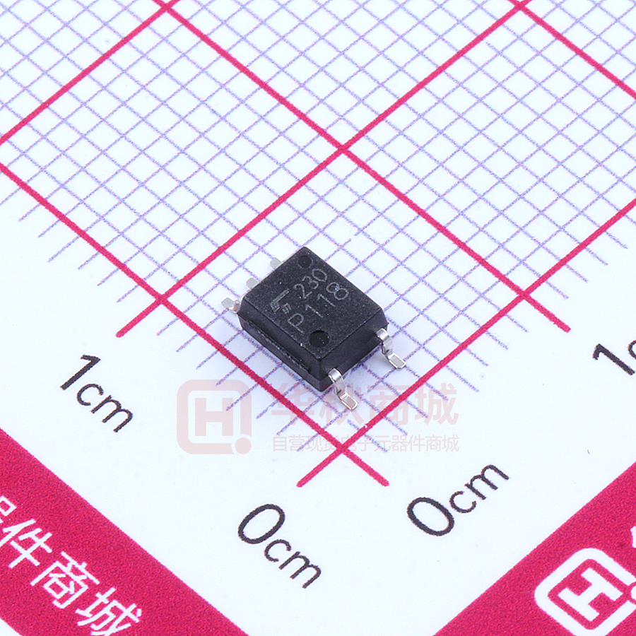

TLP118 TOSHIBA PHOTOCOUPLER GaAℓAs IRED & PHOTO-IC TLP118 PDP (Plasma Display Panel) Unit: mm FA (Factory Automation) Interfaces of measuring and control instruments Operate at high ambient temperatures up to 125°C The Toshiba TLP118 consists of GaAℓAs infrared light emitting diodes and integrated high-gain, high-speed photodetectors. The TLP118 is housed in the SO6 package. The output stage is an open collector type. The photodetector has an internal Faraday shield that provides a guaranteed common-mode transient immunity of ±15 kV/μs.  Inverter logic type (Open collector output)  Package: SO6 pin  Guaranteed performance over: -40 to 125°C  Power supply voltage: 4.5 to 5.5 V  Input threshold current: IFH = 5.0 mA (max)  Propagation delay time tpHL/tpLH: 60 ns (max)  Common-mode transient immunity: ±15 kV/μs (min)  Isolation voltage: 3750 Vrms (min)  UL approved : UL1577, File No.E67349  cUL approved: CSA Component Acceptance Service No. 5A, File No.E67349  VDE-approved: EN60747-5-5, EN60065 or EN60950-1 (Note 1) EN62368-1(pending)  CQC-approved: GB4943.1, GB8898 Thailand Factory ― ― 11−4L1 JEDEC JEITA TOSHIBA Weight: 0.08 g (typ.) Pin Configuration (Top View) 1 VCC 6 5 Note 1 : When VDE approved type is needed, please designate “Option(V4)” GND 3 SHIELD 4 1:ANODE 3:CATHODE 4:GND 5:VO (Output) 6:VCC Truth Table Input H L LED ON OFF Output L H Schematic IF IO 6 VCC 5 VO 1+ Construction Mechanical Ratings ICC 3- Creepage distance 5.0 mm (min) Clearance distance 5.0 mm (min) Insulation thickness 0.4 mm (min) SHIELD 4 GND Start of commercial production 1 2009-10 2017-05-25 TLP118 Absolute Maximum Ratings (Ta=25°C) CHARACTERISTIC SYMBOL Forward Current LED UNIT IF 25 mA ΔIF /°C -0.67 mA/°C IFP 50 mA ΔIFP /°C -1.34 mA/°C PD 40 mW ΔPD/°C -1.0 mW/°C VR 5 V IO 25 mA Output Voltage VO 6 V Supply Voltage VCC 6 V PO 80 mW Forward Current Derating (Ta ≥ 110°C) Pulse Forward Current (Note 1) Pulse Forward Current Derating (Ta ≥ 110°C) Input Power Dissipation Input power Dissipation Derating (Ta > 85°C) Reverse Voltage Output Current 1 DETECTOR RATING (Ta ≤ 125°C) Output Power Dissipation ΔPO /°C -2.0 mW/°C Operating Temperature Range Output Power Dissipation Derating (Ta ≥ 110°C) Topr -40 to 125 °C Storage Temperature Range Tstg -55 to 125 °C Tsol 260 °C BVS 3750 Vrms Lead Soldering Temperature (10 s) Isolation Voltage (AC,60 s, R.H.≤ 60%, Ta= 25°C) (Note 2) Note: Using continuously under heavy loads (e.g. the application of high temperature/current/voltage and the significant change in temperature, etc.) may cause this product to decrease in the reliability significantly even if the operating conditions (i.e. operating temperature/current/voltage, etc.) are within the absolute maximum ratings. Please design the appropriate reliability upon reviewing the Toshiba Semiconductor Reliability Handbook (“Handling Precautions”/“Derating Concept and Methods”) and individual reliability data (i.e. reliability test report and estimated failure rate, etc). Note 1: Pulse width ≤ 1ms, duty = 50%. Note 2: This device is regarded as a two terminal device: pins 1 and 3 are shorted together, as are pins 4, 5 and 6. Recommended Operating Conditions CHARACTERISTIC SYMBOL MIN TYP. MAX UNIT Input Current , High Level IFH 7.5 Input Voltage , Low Level VFL 0 ― 15 mA ― 0.8 V Supply Voltage* VCC 4.5 ― 5.5 V Operating Temperature Topr -40 ― 125 °C * This item denotes operating range, not meaning of recommended operating conditions. Note: Recommended operating conditions are given as a design guideline to obtain expected performance of the device. Additionally, each item is an independent guideline respectively. In developing designs using this product, please confirm specified characteristics shown in this document. 2 2017-05-25 TLP118 Electrical Characteristics (Unless otherwise specified, Ta=-40 to 125°C, VCC=4.5 to 5.5 V) CHARACTERISTIC Input Forward Voltage Temperature Coefficient of Forward Voltage Input Reverse Current Capacitance between Input SYMBOL TEST CIRCUIT CONDITION MIN TYP. MAX UNIT 1.45 1.61 1.85 V VF ― IF = 10 mA , Ta = 25°C ΔVF/ΔTa ― IF = 10 mA ― -1.6 ― mV/°C IR ― VR = 5 V , Ta = 25°C ― ― 10 μA ― 60 ― pF ― ― 250 Ta = 25°C ― 0.5 10 V = 0 V, f = 1 MHz, Ta = 25°C CT ― Logic High Output Current IOH 1 Logic Low Output Voltage VOL 2 IF = 10 mA, IO = 13 mA (Sinking) ― 0.2 0.6 V Logic Low Supply Current ICCL 3 IF = 10 mA ― 1.5 5 mA Logic High Supply Current ICCH 4 IF = 0 mA ― 1.5 5 mA IFHL ― IO = 13 mA (Sinking), VO < 0.6 V ― 1.0 5.0 mA terminals “H Level Output to L Level Output” Input Current VF=0.8 V ,VO=5.5 V μA *All typical values are at Ta=25°C, VCC=5 V unless otherwise specified Isolation Characteristics (Ta = 25°C) Characteristic Capacitance input to output Isolation resistance Symbol Test Condition TYP. MAX UNIT ― 0.8 ― pF ― Ω CS VS = 0 V,f = 1 MHz (Note 1) RS R.H. ≤ 60%,VS = 500 V (Note 1) 1×10 BVS 12 10 14 3750 ― ― AC,1 s, in oil ― 10000 ― DC,60 s, in oil ― 10000 ― AC,60 s Isolation voltage MIN Vrms Vdc Note 1: This device is regarded as a two terminal device: pins 1 and 3 are shorted together, as are pins 4, 5 and 6. 3 2017-05-25 TLP118 Switching Characteristics (Unless otherwise specified, Ta=-40 to 125 °C、VCC=4.5 to 5.5V) CHARACTERISTIC SYMBOL Propagation delay time (H→L) tpHL Propagation delay time (L→H) tpLH Switching Time Dispersion |tpHL- between ON and OFF tpLH| Propagation Delay Skew (Note 2) tpsk TEST CIRCUIT CONDITION MIN TYP. MAX UNIT IF=0→7.5 mA RL=350Ω CL=15pF IF=7.5→0 mA (Note 1) ― 30 60 ns ― 30 60 ns ― ― 30 ns RL=350Ω, IF=0↔7.5 mA CL=15pF 5 -40 ― 40 ns Fall Time (90 – 10 %) tf IF=0→7.5 mA RL=350Ω CL=15pF ― 30 ― ns Rise Time (10 – 90 %) tr IF=7.5→0 mA ― 30 ― ns VCM=1000 Vp-p , IF=0 mA, VCC=5 V , Ta= 25°C 15 ― ― kV/μs VCM=1000 Vp-p , IF=10 mA, VCC=5 V , Ta= 25°C -15 ― ― kV/μs Common Mode transient Immunity at High Level Output Common Mode transient Immunity at Low Level Output (Note 1) CMH 6 CML (Note 1) *All typical values are at Ta=25°C Note : A ceramic capacitor (0.1 μF) should be connected from pin 6 (VCC) to pin 4 (GND) to stabilize the operation of the high gain linear amplifier. Failure to provide the bypass may impair the switching property. The total lead length between capacitor and coupler should not exceed 1 cm. Note 1: f=5MHz, duty=50%, input current tr=tf=5ns, CL is approximately 15pF which includes probe and Jig/stray wiring capacitance. Note 2: Propagation delay skew is defined as the difference between the largest and smallest propagation delay times (i.e. tpHL or tpLH) of multiple samples. Evaluations of these samples are conducted under identical test conditions (supply voltage, input current, temperature, etc). TEST CIRCUIT 1: IOH Test Circuit TEST CIRCUIT 2: VOL Test Circuit 0.1μF 0.1μF IOH VF A VCC VO SHIELD VOL IO ↑ V VCC SHIELD TEST CIRCUIT 3: ICCL Test Circuit IF IF TEST CIRCUIT 4: ICCH Test Circuit ICCL ICCH A A 0.1 μF 0.1 μF VCC SHIELD VCC SHIELD 4 2017-05-25 TLP118 TEST CIRCUIT 5: Switching Time Test Circuit IF=7.5mA(P.G) (f=5MHz , duty=50%, tr=tf= Less than 5ns) IF 50% P.G. RL=350Ω 0.1μF IF monitor VO *CL=15pF tpLH 90% VCC *CL=15pF SHIELD tpHL VO VOL RIN=100Ω 1.5 V 10% tf tr *CL: includes probe and stray capacitance. P.G.: Pulse generator TEST CIRCUIT 6: Common-Mode Transient Immunity Test Circuit 90% IF SW A RL=350Ω → VCM 10% 0.1 μF B VCC SHIELD tf tr VO ・SW B : IF=0 mA CMH 2V VO 0.8 V CML ・SW A : IF=10 mA + VCM 1000 V - CM 5 H = 800(V ) t r ( µs ) CM L = 800(V ) t f ( µs ) 2017-05-25 TLP118 IF- VF ∆ V F / ∆ Ta - I F 10 Temperature Coefficient of Forward Voltage ∆VF/ ∆Ta (mV/˚C) Forward Current IF (mA) 100 125˚C 25˚C -40˚C 1 1 1.2 1.4 1.6 1.8 2 2.2 -3 -2.5 -2 -1.5 -1 0.1 Forward Voltage VF (V) 1 Forward Current 6 Output Voltage VO (V) 5 4 3 RL=350Ω 4kΩ 1 0 0 1 2 3 4.0 VCC=5V IO=13mA 3.0 2.0 1.0 0.0 -40 -20 0 Logic High Supply Current ICCH (mA) Logic Low Supply Current ICCL (mA) 1.8 1.5 1.3 1.0 0.8 VCC=5V IF=10mA 0.0 0 20 40 60 80 100 120 140 Ambient Temperature 60 80 100 120 140 Ta (°C) I C C H - Ta 2.0 -40 -20 20 40 Ambient Temperature I C C L - Ta 0.3 IF (mA) 5.0 Forward Current IF (mA) 0.5 100 I F H L - Ta “H Level Output to L Level Output” Input Current IFHL (mA) VO-IF 2 10 Ta (°C) 2.0 1.8 1.5 1.3 1.0 0.8 0.5 VCC=5V IF=0mA 0.3 0.0 -40 -20 0 20 40 60 80 100 120 140 Ambient Temperature Ta (°C) *The above graphs show typical characteristics. 6 2017-05-25 TLP118 t p H L / t p L H - Ta V O L - Ta Propagation Delay Time tpHL / tpLH (ns) Low Level Output Voltage VOL (V) 0.6 0.5 0.4 0.3 0.2 VCC=5V IF=10mA IO=13mA(Sinking) 0.1 0.0 -40 -20 0 20 40 60 80 100 120 140 Ambient Temperature Ta (˚C) 60 50 40 30 tpHL tpLH 20 10 VCC=5V RL=350Ω IF=7.5mA 0 -40 -20 0 20 40 60 80 100 120 140 Ambient Temperature Ta (˚C) *The above graphs show typical characteristics. 7 2017-05-25 TLP118 Soldering and Storage (1) Precautions for Soldering The soldering temperature should be controlled as closely as possible to the conditions shown below, irrespective of whether a soldering iron or a reflow soldering method is used. 1) When Using Soldering Reflow An example of a temperature profile when lead(Pb)-free solder is used  The soldering temperature profile is based on the package surface temperature (See the figure shown above.)  Reflow soldering must be performed once or twice.  The mounting should be completed with the interval from the first to the last mountings being 2 weeks. 2) When using soldering Flow  Preheat the device at a temperature of 150 °C (package surface temperature) for 60 to 120 seconds.  Mounting condition of 260 °C within 10 seconds is recommended  Flow soldering must be performed once. 3) When using soldering Iron  Complete soldering within 10 seconds for lead temperature not exceeding 260 °C or within 3 seconds not exceeding 350 °C  Heating by soldering iron must be done only once per lead 8 2017-05-25 TLP118 (2) Precautions for General Storage 1) Do not store devices at any place where they will be exposed to moisture or direct sunlight. 2) When transportation or storage of devices, follow the cautions indicated on the carton box. 3) The storage area temperature should be kept within a temperature range of 5 °C to 35 °C, and relative humidity should be maintained at between 45% and 75%. 4) Do not store devices in the presence of harmful (especially corrosive) gases, or in dusty conditions. 5) Use storage areas where there is minimal temperature fluctuation. Because rapid temperature changes can cause condensation to occur on stored devices, resulting in lead oxidation or corrosion, as a result, the solderability of the leads will be degraded. 6) When repacking devices, use anti-static containers. 7) Do not apply any external force or load directly to devices while they are in storage. 8) If devices have been stored for more than two years, even though the above conditions have been followed, it is recommended that solderability of them should be tested before they are used. 9 2017-05-25 TLP118 Specification for Embossed–Tape Packing (TPL)(TPR) for SO6 Coupler 1. Applicable Package Package Product Type SO6 Mini-flat coupler 2. Product Naming System Type of package used for shipment is denoted by a symbol suffix after a product number. The method of classification is as below. (Example) TLP118 (TPL, E [[G]]/RoHS COMPATIBLE (Note 1) Tape-type Device-name Note 1: Please contact your Toshiba sales representative for details on environmental information such as the product's RoHS compatibility. RoHS is the Directive 2011/65/EU of the European Parliament and of the Council of 8 June 2011 on the restriction of the use of certain hazardous substances in electrical and electronic equipment. 3. Tape Dimensions 3.1 Specification Classification Are as Shown in Table 1 Table 1 Tape Type Classification Tape type Classification Quantity (pcs / reel) TPL L direction 3000 TPR R direction 3000 3.2 Orientation of Device in Relation to Direction of Tape Movement Device orientation in the recesses is as shown in Figure 1. Direction of Tape L direction R direction Figure 1 Device Orientation 10 2017-05-25 TLP118 3.3 Empty Device Recesses Are as Shown in Table 2. Table 2 Empty Device Recesses Standard Occurrences of 2 or more successive empty device recesses Remarks Within any given 40-mm section of tape, not including leader and trailer 0 device Single empty device recesses 6 devices (max) per reel Not including leader and trailer 3.4 Start and End of Tape The start of the tape has 50 or more empty holes. The end of tape has 50 or more empty holes and two empty turns only for a cover tape. 3.5 Tape Specification (1) Tape material: Plastic (protection against electrostatics) (2) Dimensions: The tape dimensions are as shown in Figure 2 and Table 3. +0.1 φ1.5 −0 G Unit: mm A K0 12.0 ± 0.3 B D E 0.3 ± 0.05 F φ1.6 ± 0.1 2.95 ± 0.2 Figure 2 Tape Forms Table 3 Tape Dimensions Unit: mm Unless otherwise specified: ±0.1 Symbol Dimension Remark A 4.0 ― B 7.6 ― D 5.5 Center line of indented square hole and sprocket hole E 1.75 F 8.0 G 4.0 K0 2.6 Distance between tape edge and hole center +0.1 Cumulative error -0.3 (max) per 10 feed holes Cumulative error +0.1 (max) per 10 feed holes -0.3 Internal space 11 2017-05-25 TLP118 3.6 Reel A C U B (1) Material: Plastic (2) Dimensions: The reel dimensions are as shown in Figure 3 and Table 4. E W1 W2 Figure 3 Reel Form Table 4 Reel Dimensions Unit: mm Symbol Dimension A Φ330 ±2 B Φ80 ±1 C Φ13 ±0.5 E 2.0 ±0.5 U 4.0 ±0.5 W1 13.5 ±0.5 W2 17.5 ±1.0 4. Packing Either one reel or five reels of photocoupler are packed in a shipping carton. 5. Label Indication The carton bears a label indicating the product number, the symbol representing classification of standard, the quantity, the lot number and the Toshiba company name. 12 2017-05-25 TLP118 6. Ordering Method When placing an order, please specify the product number, the tape type and the quantity as shown in the following example. (Example) TLP118 (TPL,E 3000 pcs Quantity (must be a multiple of 3000) [[G]]/RoHS COMPATIBLE (Note 1) Tape type Device name Note 1: Please contact your Toshiba sales representative for details on environmental information such as the product's RoHS compatibility. RoHS is the Directive 2011/65/EU of the European Parliament and of the Council of 8 June 2011 on the restriction of the use of certain hazardous substances in electrical and electronic equipment. 13 2017-05-25 TLP118 RESTRICTIONS ON PRODUCT USE • Toshiba Corporation, and its subsidiaries and affiliates (collectively "TOSHIBA"), reserve the right to make changes to the information in this document, and related hardware, software and systems (collectively "Product") without notice. • This document and any information herein may not be reproduced without prior written permission from TOSHIBA. Even with TOSHIBA's written permission, reproduction is permissible only if reproduction is without alteration/omission. • Though TOSHIBA works continually to improve Product's quality and reliability, Product can malfunction or fail. Customers are responsible for complying with safety standards and for providing adequate designs and safeguards for their hardware, software and systems which minimize risk and avoid situations in which a malfunction or failure of Product could cause loss of human life, bodily injury or damage to property, including data loss or corruption. Before customers use the Product, create designs including the Product, or incorporate the Product into their own applications, customers must also refer to and comply with (a) the latest versions of all relevant TOSHIBA information, including without limitation, this document, the specifications, the data sheets and application notes for Product and the precautions and conditions set forth in the "TOSHIBA Semiconductor Reliability Handbook" and (b) the instructions for the application with which the Product will be used with or for. Customers are solely responsible for all aspects of their own product design or applications, including but not limited to (a) determining the appropriateness of the use of this Product in such design or applications; (b) evaluating and determining the applicability of any information contained in this document, or in charts, diagrams, programs, algorithms, sample application circuits, or any other referenced documents; and (c) validating all operating parameters for such designs and applications. TOSHIBA ASSUMES NO LIABILITY FOR CUSTOMERS' PRODUCT DESIGN OR APPLICATIONS. • PRODUCT IS NEITHER INTENDED NOR WARRANTED FOR USE IN EQUIPMENTS OR SYSTEMS THAT REQUIRE EXTRAORDINARILY HIGH LEVELS OF QUALITY AND/OR RELIABILITY, AND/OR A MALFUNCTION OR FAILURE OF WHICH MAY CAUSE LOSS OF HUMAN LIFE, BODILY INJURY, SERIOUS PROPERTY DAMAGE AND/OR SERIOUS PUBLIC IMPACT ("UNINTENDED USE"). Except for specific applications as expressly stated in this document, Unintended Use includes, without limitation, equipment used in nuclear facilities, equipment used in the aerospace industry, medical equipment, equipment used for automobiles, trains, ships and other transportation, traffic signaling equipment, equipment used to control combustions or explosions, safety devices, elevators and escalators, devices related to electric power, and equipment used in finance-related fields. IF YOU USE PRODUCT FOR UNINTENDED USE, TOSHIBA ASSUMES NO LIABILITY FOR PRODUCT. For details, please contact your TOSHIBA sales representative. • Do not disassemble, analyze, reverse-engineer, alter, modify, translate or copy Product, whether in whole or in part. • Product shall not be used for or incorporated into any products or systems whose manufacture, use, or sale is prohibited under any applicable laws or regulations. • The information contained herein is presented only as guidance for Product use. No responsibility is assumed by TOSHIBA for any infringement of patents or any other intellectual property rights of third parties that may result from the use of Product. No license to any intellectual property right is granted by this document, whether express or implied, by estoppel or otherwise. • ABSENT A WRITTEN SIGNED AGREEMENT, EXCEPT AS PROVIDED IN THE RELEVANT TERMS AND CONDITIONS OF SALE FOR PRODUCT, AND TO THE MAXIMUM EXTENT ALLOWABLE BY LAW, TOSHIBA (1) ASSUMES NO LIABILITY WHATSOEVER, INCLUDING WITHOUT LIMITATION, INDIRECT, CONSEQUENTIAL, SPECIAL, OR INCIDENTAL DAMAGES OR LOSS, INCLUDING WITHOUT LIMITATION, LOSS OF PROFITS, LOSS OF OPPORTUNITIES, BUSINESS INTERRUPTION AND LOSS OF DATA, AND (2) DISCLAIMS ANY AND ALL EXPRESS OR IMPLIED WARRANTIES AND CONDITIONS RELATED TO SALE, USE OF PRODUCT, OR INFORMATION, INCLUDING WARRANTIES OR CONDITIONS OF MERCHANTABILITY, FITNESS FOR A PARTICULAR PURPOSE, ACCURACY OF INFORMATION, OR NONINFRINGEMENT. • GaAs (Gallium Arsenide) is used in Product. GaAs is harmful to humans if consumed or absorbed, whether in the form of dust or vapor. Handle with care and do not break, cut, crush, grind, dissolve chemically or otherwise expose GaAs in Product. • Do not use or otherwise make available Product or related software or technology for any military purposes, including without limitation, for the design, development, use, stockpiling or manufacturing of nuclear, chemical, or biological weapons or missile technology products (mass destruction weapons). Product and related software and technology may be controlled under the applicable export laws and regulations including, without limitation, the Japanese Foreign Exchange and Foreign Trade Law and the U.S. Export Administration Regulations. Export and re-export of Product or related software or technology are strictly prohibited except in compliance with all applicable export laws and regulations. • Please contact your TOSHIBA sales representative for details as to environmental matters such as the RoHS compatibility of Product. Please use Product in compliance with all applicable laws and regulations that regulate the inclusion or use of controlled substances, including without limitation, the EU RoHS Directive. TOSHIBA ASSUMES NO LIABILITY FOR DAMAGES OR LOSSES OCCURRING AS A RESULT OF NONCOMPLIANCE WITH APPLICABLE LAWS AND REGULATIONS. 14 2017-05-25
