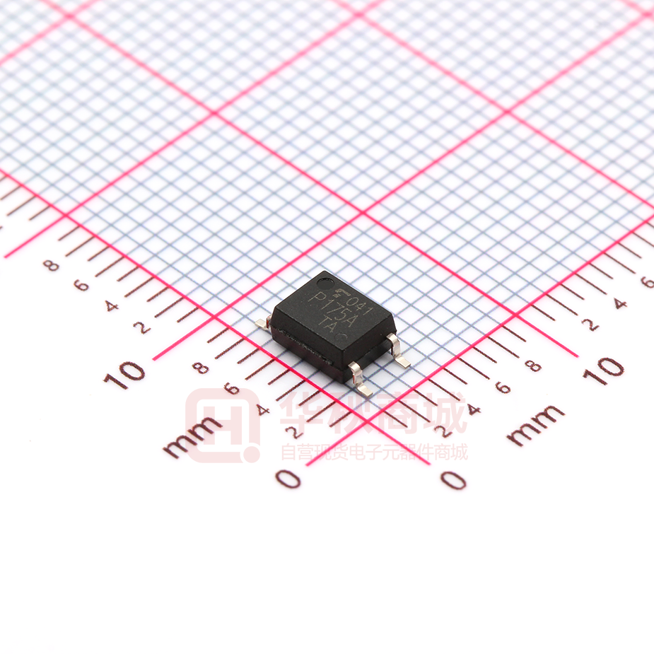

TLP175A Photocouplers Photorelay TLP175A 1. Applications • Mechanical relay replacements • Security Systems • Measuring Instruments • Factory Automation (FA) • Amusement Equipment • Smart Meters • Electricity Meters 2. General The TLP175A photorelay consists of a photo MOSFET optically coupled to an infrared light emitting diode. It is housed in a 4-pin SO6 package. This photorelay requires 1mA of LED current to turn it on. It is suitable for applications that need electrical power savings. 3. Features (1) Normally opened (1-Form-A) (2) OFF-state output terminal voltage: 60 V (min) (3) Trigger LED current: 1 mA (max) (4) ON-state current: 100 mA (max) (5) ON-state resistance: 50 Ω (max) (6) Isolation voltage: 3750 Vrms (min) (7) Safety Standards UL-approved: UL1577, File No.E67349 cUL-approved: CSA Component Acceptance Service No.5A File No.E67349 VDE-approved: EN60747-5-5, EN60065 or EN60950-1 (Note 1) : EN62368-1 (Pending) (Note 1) CQC-approved: GB4943.1, GB8898 Thailand Factory Note 1: When a VDE approved type is needed, please designate the Option (V4) (V4). Start of commercial production ©2017 Toshiba Electronic Devices & Storage Corporation 1 2012-08 2017-08-21 Rev.3.0 TLP175A 4. Packaging and Pin Assignment 1: Anode 3: Cathode 4: Drain 6: Drain 11-4M1S 5. Internal Circuit 6. Mechanical Parameters Characteristics TLP175A Unit Creepage distances 5.0 (min) mm Clearance distances 5.0 (min) Internal isolation thickness 0.4 (min) ©2017 Toshiba Electronic Devices & Storage Corporation 2 2017-08-21 Rev.3.0 TLP175A 7. Absolute Maximum Ratings (Note) (Unless otherwise specified, Ta = 25 ) Characteristics LED Symbol Input forward current Note Rating Unit IF 30 mA Input forward current derating (Ta ≥ 25 ) ∆IF/∆Ta -0.3 mA/ Input forward current (pulsed) (100 µs pulse, 100 pps) IFP 1 A VR 5 V Input reverse voltage Input power dissipation Input power dissipation derating (Ta ≥ 25 ) PD 50 mW ∆PD/∆Ta -0.5 mW/ Tj 125  VOFF 60 V Junction temperature Detector OFF-state output terminal voltage ON-state current ION 100 mA ON-state current derating (Ta ≥ 25 ) ∆ION/∆Ta -1.0 mA/ ON-state current (pulsed) (t = 100 ms, duty = 1/10) IONP 300 mA PO 200 mW ∆PO/∆Ta -2.0 mW/ Tj 125  Tstg -55 to 125  Topr -40 to 85  Output power dissipation Output power dissipation derating (Ta ≥ 25 ) Junction temperature Common Storage temperature Operating temperature Lead soldering temperature Isolation voltage (10 s) Tsol (AC, 60 s, R.H. ≤ 60 %) BVS (Note 1) 260  3750 Vrms Note: Using continuously under heavy loads (e.g. the application of high temperature/current/voltage and the significant change in temperature, etc.) may cause this product to decrease in the reliability significantly even if the operating conditions (i.e. operating temperature/current/voltage, etc.) are within the absolute maximum ratings. Please design the appropriate reliability upon reviewing the Toshiba Semiconductor Reliability Handbook ("Handling Precautions"/"Derating Concept and Methods") and individual reliability data (i.e. reliability test report and estimated failure rate, etc). Note 1: This device is considered as a two-terminal device: Pins 1 and 3 are shorted together, and pins 4 and 6 are shorted together. Note: This device is sensitive to electrostatic discharge (ESD). Extreme ESD conditions should be guarded against by using proper antistatic precautions for the worktable, operator, solder iron, soldering equipment and so on. 8. Recommended Operating Conditions (Note) Characteristics Symbol Supply voltage Note VDD Input forward current Min Typ. Max Unit   48 V mA IF 2 5 15 ON-state current ION   80 Operating temperature Topr -20  65 Note:  The recommended operating conditions are given as a design guide necessary to obtain the intended performance of the device. Each parameter is an independent value. When creating a system design using this device, the electrical characteristics specified in this data sheet should also be considered. ) 9. Electrical Characteristics (Unless otherwise specified, Ta = 25 25 Characteristics LED Symbol Note Test Condition Min Typ. Max Unit Input forward voltage VF IF = 10 mA 1.1 1.27 1.4 V Input reverse current IR VR = 5 V   10 µA Ct Input capacitance Detector OFF-state current Output capacitance V = 0 V, f = 1 MHz  50  pF IOFF VOFF = 60 V   1 µA COFF V = 0 V, f = 1 MHz  10  pF ©2017 Toshiba Electronic Devices & Storage Corporation 3 2017-08-21 Rev.3.0 TLP175A ) 10. Coupled Electrical Characteristics (Unless otherwise specified, Ta = 25 25 Characteristics Symbol Note Test Condition Trigger LED current IFT ION = 100 mA, t < 1 s Return LED current IFC IOFF = 100 µA ON-state resistance RON ION = 100 mA, IF = 2 mA, t < 1 s Min Typ. Max Unit  0.2 1 mA 0.01   mA  25 50 Ω Min Typ. Max Unit  0.8  pF 1×1012 1014  Ω 3750   Vrms AC, 1 s in oil  10000  DC, 60 s, in oil  10000  ) 11. Isolation Characteristics (Unless otherwise specified, Ta = 25 25 Characteristics Symbol Total capacitance (input to output) Isolation resistance Isolation voltage CS RS BVS Note Test Condition (Note 1) VS = 0 V, f = 1 MHz (Note 1) VS = 500 V, R.H. ≤ 60 % (Note 1) AC, 60 s Vdc Note 1: This device is considered as a two-terminal device: Pins 1 and 3 are shorted together, and pins 4 and 6 are shorted together. ) 12. Switching Characteristics (Unless otherwise specified, Ta = 25 25 Characteristics Symbol Turn-on time tON Turn-off time tOFF Note Test Condition See Fig. 12.1. RL = 200 Ω, VDD = 10 V, IF = 2 mA Min Typ. Max Unit  1 5 ms  1 5 Fig. 12.1 Switching Time Test Circuit and Waveform ©2017 Toshiba Electronic Devices & Storage Corporation 4 2017-08-21 Rev.3.0 TLP175A 13. Characteristics Curves and Circuit Connections 13.1. Characteristics Curves (Note) Fig. 13.1.1 IF - Ta Fig. 13.1.2 ION - Ta Fig. 13.1.3 IF - VF Fig. 13.1.4 ION - VON Fig. 13.1.5 RON - Ta Fig. 13.1.6 IFT - Ta ©2017 Toshiba Electronic Devices & Storage Corporation 5 2017-08-21 Rev.3.0 TLP175A Note: Fig. 13.1.7 tON, tOFF - IF Fig. 13.1.8 tON, tOFF - Ta Fig. 13.1.9 IOFF - VOFF Fig. 13.1.10 IOFF - Ta The above characteristics curves are presented for reference only and not guaranteed by production test, unless otherwise noted. ©2017 Toshiba Electronic Devices & Storage Corporation 6 2017-08-21 Rev.3.0 TLP175A Package Dimensions Unit: mm Weight: 0.08 g (typ.) Package Name(s) TOSHIBA: 11-4M1S ©2017 Toshiba Electronic Devices & Storage Corporation 7 2017-08-21 Rev.3.0 TLP175A RESTRICTIONS ON PRODUCT USE Toshiba Corporation and its subsidiaries and affiliates are collectively referred to as "TOSHIBA". Hardware, software and systems described in this document are collectively referred to as "Product". • TOSHIBA reserves the right to make changes to the information in this document and related Product without notice. • This document and any information herein may not be reproduced without prior written permission from TOSHIBA. Even with TOSHIBA's written permission, reproduction is permissible only if reproduction is without alteration/omission. • Though TOSHIBA works continually to improve Product's quality and reliability, Product can malfunction or fail. Customers are responsible for complying with safety standards and for providing adequate designs and safeguards for their hardware, software and systems which minimize risk and avoid situations in which a malfunction or failure of Product could cause loss of human life, bodily injury or damage to property, including data loss or corruption. Before customers use the Product, create designs including the Product, or incorporate the Product into their own applications, customers must also refer to and comply with (a) the latest versions of all relevant TOSHIBA information, including without limitation, this document, the specifications, the data sheets and application notes for Product and the precautions and conditions set forth in the "TOSHIBA Semiconductor Reliability Handbook" and (b) the instructions for the application with which the Product will be used with or for. Customers are solely responsible for all aspects of their own product design or applications, including but not limited to (a) determining the appropriateness of the use of this Product in such design or applications; (b) evaluating and determining the applicability of any information contained in this document, or in charts, diagrams, programs, algorithms, sample application circuits, or any other referenced documents; and (c) validating all operating parameters for such designs and applications. TOSHIBA ASSUMES NO LIABILITY FOR CUSTOMERS' PRODUCT DESIGN OR APPLICATIONS. • PRODUCT IS NEITHER INTENDED NOR WARRANTED FOR USE IN EQUIPMENTS OR SYSTEMS THAT REQUIRE EXTRAORDINARILY HIGH LEVELS OF QUALITY AND/OR RELIABILITY, AND/OR A MALFUNCTION OR FAILURE OF WHICH MAY CAUSE LOSS OF HUMAN LIFE, BODILY INJURY, SERIOUS PROPERTY DAMAGE AND/OR SERIOUS PUBLIC IMPACT ("UNINTENDED USE"). Except for specific applications as expressly stated in this document, Unintended Use includes, without limitation, equipment used in nuclear facilities, equipment used in the aerospace industry, medical equipment, equipment used for automobiles, trains, ships and other transportation, traffic signaling equipment, equipment used to control combustions or explosions, safety devices, elevators and escalators, devices related to electric power, and equipment used in finance-related fields. IF YOU USE PRODUCT FOR UNINTENDED USE, TOSHIBA ASSUMES NO LIABILITY FOR PRODUCT. For details, please contact your TOSHIBA sales representative. • Do not disassemble, analyze, reverse-engineer, alter, modify, translate or copy Product, whether in whole or in part. • Product shall not be used for or incorporated into any products or systems whose manufacture, use, or sale is prohibited under any applicable laws or regulations. • The information contained herein is presented only as guidance for Product use. No responsibility is assumed by TOSHIBA for any infringement of patents or any other intellectual property rights of third parties that may result from the use of Product. No license to any intellectual property right is granted by this document, whether express or implied, by estoppel or otherwise. • ABSENT A WRITTEN SIGNED AGREEMENT, EXCEPT AS PROVIDED IN THE RELEVANT TERMS AND CONDITIONS OF SALE FOR PRODUCT, AND TO THE MAXIMUM EXTENT ALLOWABLE BY LAW, TOSHIBA (1) ASSUMES NO LIABILITY WHATSOEVER, INCLUDING WITHOUT LIMITATION, INDIRECT, CONSEQUENTIAL, SPECIAL, OR INCIDENTAL DAMAGES OR LOSS, INCLUDING WITHOUT LIMITATION, LOSS OF PROFITS, LOSS OF OPPORTUNITIES, BUSINESS INTERRUPTION AND LOSS OF DATA, AND (2) DISCLAIMS ANY AND ALL EXPRESS OR IMPLIED WARRANTIES AND CONDITIONS RELATED TO SALE, USE OF PRODUCT, OR INFORMATION, INCLUDING WARRANTIES OR CONDITIONS OF MERCHANTABILITY, FITNESS FOR A PARTICULAR PURPOSE, ACCURACY OF INFORMATION, OR NONINFRINGEMENT. • GaAs (Gallium Arsenide) is used in Product. GaAs is harmful to humans if consumed or absorbed, whether in the form of dust or vapor. Handle with care and do not break, cut, crush, grind, dissolve chemically or otherwise expose GaAs in Product. • Do not use or otherwise make available Product or related software or technology for any military purposes, including without limitation, for the design, development, use, stockpiling or manufacturing of nuclear, chemical, or biological weapons or missile technology products (mass destruction weapons). Product and related software and technology may be controlled under the applicable export laws and regulations including, without limitation, the Japanese Foreign Exchange and Foreign Trade Law and the U.S. Export Administration Regulations. Export and re-export of Product or related software or technology are strictly prohibited except in compliance with all applicable export laws and regulations. • Please contact your TOSHIBA sales representative for details as to environmental matters such as the RoHS compatibility of Product. Please use Product in compliance with all applicable laws and regulations that regulate the inclusion or use of controlled substances, including without limitation, the EU RoHS Directive. TOSHIBA ASSUMES NO LIABILITY FOR DAMAGES OR LOSSES OCCURRING AS A RESULT OF NONCOMPLIANCE WITH APPLICABLE LAWS AND REGULATIONS. ©2017 Toshiba Electronic Devices & Storage Corporation 8 2017-08-21 Rev.3.0
