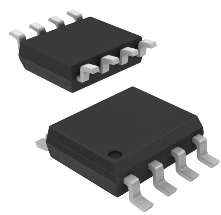

TLP2270 Photocouplers Infrared LED & Photo IC TLP2270 1. Applications • Factory Networking • High-Speed Digital Interfacing for Instrumentation and Control Devices • I/O Interface Boards 2. General The Toshiba TLP2270 consists of a high-output infrared LED coupled with a high-speed photo-diode-transistor chip. It is housed in the SO8L package. It is housed in a thin SO8L package of 2.35 mm (max). The TLP2270 guarantees isolation voltage 5000 Vrms and compliant with international safety standards for reinforced insulation. It has two circuits built into a single SO8L package, which can reduce the mounting area. This photocoupler guarantees operation at up to 125  and on supplies from 2.7 V to 5.5 V. Since TLP2270 guarantees 0.8 mA low supply current (IDDL/IDDH), and 1 mA (Ta = 125 ) low threshold input current (IFLH), it contributes to energy saving of devices. It can be driven directly from a microcomputer by a low input current. The TLP2270 has an internal Faraday shield that provides a guaranteed common-mode transient immunity of ±20 kV/µs. 3. Features (1) Buffer logic type (totem pole output) (2) Package: SO8L (3) Operating temperature: -40 to 125  (4) Supply voltage: 2.7 to 5.5 V (5) Data transfer rate: 20 MBd (typ.) (NRZ) (6) Threshold input current: 1 mA (max) (7) Supply current: 0.8 mA (max) (8) Common-mode transient immunity: ±20 kV/µs (min) (9) Isolation voltage: 5000 Vrms (min) (10) Safety standards UL-recognized: UL 1577, File No.E67349 cUL-recognized: CSA Component Acceptance Service No.5A File No.E67349 VDE-approved: EN 60747-5-5, EN 62368-1 (Note 1) CQC-approved: GB4943.1, GB8898 Japan Factory Note 1: When a VDE approved type is needed, please designate the Option (D4) (D4). Start of commercial production ©2016-2019 Toshiba Electronic Devices & Storage Corporation 1 2016-10 2019-11-26 Rev.5.0 TLP2270 4. Packaging and Pin Assignment 1: Anode 1 2: Cathode 1 3: Cathode 2 4: Anode 2 5: GND 6: VO 2 (output 2) 7: VO 1 (output 1) 8: VDD 11-6B1A 5. Internal Circuit (Note) Note: A 0.1-µF bypass capacitor must be connected between pin 8 and pin 5. 6. Principle of Operation 6.1. Truth Table Input LED1 (2) M1 (3) M2 (4) Output 1 (2) H ON ON OFF H L OFF OFF ON L 6.2. Mechanical Parameters Characteristics Min Unit Creepage distances 8.0 mm Clearance 8.0 Internal isolation thickness 0.4 ©2016-2019 Toshiba Electronic Devices & Storage Corporation 2 2019-11-26 Rev.5.0 TLP2270 7. Absolute Maximum Ratings (Note) (Unless otherwise specified, Ta = 25 ) Characteristics LED Input forward current Symbol Note Rating Unit IF (Note 1) 8 mA ∆IF/∆Ta (Note 1) -0.32 mA/ IFP (Note 1), (Note 2) 16 mA ∆IFP/∆Ta (Note 1) -0.64 mA/ IFPT (Note 1), (Note 3) 1 A (Ta ≥ 110 ) ∆IFPT/∆Ta (Note 1) -40 mA/ PD (Note 1) 20 mW (Ta ≥ 110 ) ∆PD/∆Ta (Note 1) -0.8 mW/ VR (Note 1) 5 V Detector Output current IO (Note 1) 10 mA Output voltage VO (Note 1) 6 V Supply voltage VDD Output power dissipation PO (Note 1) 40 mW ∆PO/∆Ta (Note 1) -1.6 mW/ Topr -40 to 125  Input forward current derating (Ta ≥ 110 ) Input forward current (pulsed) Input forward current derating (pulsed) (Ta ≥ 110 ) Peak transient input forward current Peak transient input forward current derating Input power dissipation Input power dissipation derating Input reverse voltage Output power dissipation derating (Ta ≥ 110 ) Common Operating temperature Storage temperature Tstg -55 to 125 (10 s) Tsol 260 (AC, 60 s, R.H. ≤ 60 %) BVS Lead soldering temperature Isolation voltage 6 (Note 4) 5000 Vrms Note: Using continuously under heavy loads (e.g. the application of high temperature/current/voltage and the significant change in temperature, etc.) may cause this product to decrease in the reliability significantly even if the operating conditions (i.e. operating temperature/current/voltage, etc.) are within the absolute maximum ratings. Please design the appropriate reliability upon reviewing the Toshiba Semiconductor Reliability Handbook ("Handling Precautions"/"Derating Concept and Methods") and individual reliability data (i.e. reliability test report and estimated failure rate, etc). Note 1: Each channel Note 2: Pulse width (PW) ≤ 1 ms, duty = 50 % Note 3: Pulse width (PW) ≤ 1 µs, 300 pps Note 4: This device is considered as a two-terminal device: Pins 1, 2, 3 and 4 are shorted together, and pins 5, 6, 7 and 8 are shorted together. 8. Recommended Operating Conditions (Note) Characteristics Symbol Note Min Typ. Max Unit Input on-state current IF(ON) (Note 1), (Note 2) 1.3  6 mA Input off-state voltage V VF(OFF) (Note 1) 0  0.8 Supply voltage VDD (Note 3) 2.7 3.3 / 5.0 5.5 Operating temperature Topr (Note 3) -40  125  Note: The recommended operating conditions are given as a design guide necessary to obtain the intended performance of the device. Each parameter is an independent value. When creating a system design using this device, the electrical characteristics specified in this data sheet should also be considered. Note: A ceramic capacitor (0.1 µF) should be connected between pin 8 and pin 5 to stabilize the operation of a highgain linear amplifier. Otherwise, this photocoupler may not switch properly. The bypass capacitor should be placed within 1 cm of each pin. Note 1: Each channel Note 2: The rise and fall times of the input on-current should be less than 0.5 µs. Note 3: Denotes the operating range, not the recommended operating condition. ©2016-2019 Toshiba Electronic Devices & Storage Corporation 3 2019-11-26 Rev.5.0 TLP2270 9. Electrical Characteristics (Note) (Unless otherwise specified, Ta = -40 to 125 , VDD = 2.7 to 5.5 V) Characteristics Symbol Note Input forward voltage Input forward voltage temperature coefficient Test Circuit Test Condition Min Typ. Max Unit VF (Note 1) IF = 1.3 mA, Ta = 25  1.35 1.50 1.65 V ∆VF/∆Ta (Note 1) IF = 1.3 mA  -1.58  mV/ IR (Note 1) VR = 5 V, Ta = 25    10 µA Ct (Note 1) V = 0 V, f = 1 MHz , Ta = 25   26  pF VOL (Note 1)  0.0007 0.1 V VF = 0.8 V, IO = 3.2 mA, VDD = 5 V  0.1 0.35 Fig. IF = 1.3 mA, IO = -20 µA, 12.1.2 VDD = 3.3 V 3.2 3.29  IF = 1.3 mA, IO = -20 µA, VDD = 5 V 4.9 4.99  IF = 1.3 mA, IO = -3.2 mA, VDD = 3.3 V 2.3 3.05  IF = 1.3 mA, IO = -3.2 mA, VDD = 5 V 4.0 4.75  Input reverse current Input capacitance Low-level output voltage High-level output voltage VOH (Note 1) Fig. VF = 0.8 V, IO = 20 µA, 12.1.1 VDD = 5 V Low-level supply current IDDL Fig. IF1 = IF2 = 0 mA 12.1.3  0.60 0.8 High-level supply current IDDH Fig. IF1 = IF2 = 1.3 mA 12.1.4  0.56 0.8 Threshold input current (L/H) IFLH  0.43 1 (Note 1) IO = -3.2 mA, VO > 1.7 V mA Note: All typical values are at VDD = 5 V, Ta = 25 , unless otherwise noted. Note 1: Each channel 10. Isolation Characteristics (Unless otherwise specified, Ta = 25 ) Characteristics Symbol Note Test Condition Min Typ. Max Unit Total capacitance (input to output) CS (Note 1) V = 0 V, f = 1 MHz  0.8  pF Isolation resistance RS (Note 1) V = 500 V, R.H. ≤ 60 % 1012 1014  Ω (Note 1) AC, 60 s 5000   Vrms Isolation voltage BVS Note 1: This device is considered as a two-terminal device: Pins 1, 2, 3 and 4 are shorted together, and pins 5, 6, 7 and 8 are shorted together. ©2016-2019 Toshiba Electronic Devices & Storage Corporation 4 2019-11-26 Rev.5.0 TLP2270 11. Switching Characteristics (Note) (Unless otherwise specified, Ta = -40 to 125 , VDD = 2.7 to 5.5 V) Characteristics Symbol Note Propagation delay time (L/H) tpLH (Note 1) Propagation delay time (H/L) tpHL Pulse width distortion |tpHL-tpLH| Propagation delay skew (device to device) tpsk (Note 1), (Note 2) Propagation delay time (L/H) tpLH (Note 1) Propagation delay time (H/L) Pulse width distortion Propagation delay skew (device to device) Test Circuit Fig. VIN = 3.3 V, VDD = 3.3 V, 12.1.5 RIN = 1.3 kΩ, CIN = 22 pF tpHL (Note 1), (Note 2) Rise time tr (Note 1) Fall time tf Min Typ. Max Unit  36 60 ns  30 60  6 25 -30  30  31 60  30 60  1 25 -30  30 VIN = 0 → 5 V, RT = 2.7 kΩ, CIN = 12 pF  1.3  VIN = 5 → 0 V, RT = 2.7 kΩ, CIN = 12 pF  1  VIN = 5 V, VDD = 5 V, RIN = 2.7 kΩ, CIN = 12 pF |tpHL-tpLH| tpsk Test Condition High-level common-mode transient immunity CMH Fig. VIN = 3.3 V, 5 V, 12.1.6 VDD = 3.3 V, 5 V, VCM = 1000 Vp-p, Ta = 25  ±20 ±35  Low-level common-mode transient immunity CML VIN = 3.3 V, 5 V, VDD = 3.3 V, 5 V, VCM = 1000 Vp-p, Ta = 25  ±20 ±35  kV/µs Note: All typical values are at VDD = 5 V, Ta = 25 , unless otherwise noted. Note: Each channel Note 1: f = 5 MHz, duty = 50 %, input current tr = tf = 5 ns or less, CL is less than 15 pF which includes probe and stray wiring capacitance. Note 2: The propagation delay skew, tpsk, is equal to the magnitude of the worst-case difference in tpHL and/or tpLH that will be seen between units at the same given conditions (supply voltage, input current, temperature, etc.). ©2016-2019 Toshiba Electronic Devices & Storage Corporation 5 2019-11-26 Rev.5.0 TLP2270 12. Test Circuits and Characteristics Curves 12.1. Test Circuits Fig. 12.1.1 VOL Test Circuit Fig. 12.1.2 VOH Test Circuit Fig. 12.1.3 IDDL Test Circuit Fig. 12.1.4 IDDH Test Circuit Fig. 12.1.5 Switching Time Test Circuit and Waveform Fig. 12.1.6 Common-Mode Transient Immunity Test Circuit and Waveform ©2016-2019 Toshiba Electronic Devices & Storage Corporation 6 2019-11-26 Rev.5.0 TLP2270 12.2. Characteristics Curves (Note) Fig. 12.2.1 IF - VF Fig. 12.2.2 IF - Ta Fig. 12.2.3 VOL - Ta Fig. 12.2.4 VOL - Ta Fig. 12.2.5 VOH - Ta Fig. 12.2.6 VOH - Ta ©2016-2019 Toshiba Electronic Devices & Storage Corporation 7 2019-11-26 Rev.5.0 TLP2270 Fig. 12.2.7 IDDH - Ta Fig. 12.2.8 IDDL - Ta Fig. 12.2.9 IFLH - Ta Fig. 12.2.10 tpLH, tpHL, |tpHL - tpLH| - Ta Fig. 12.2.11 tpLH, tpHL, |tpHL - tpLH| - Ta Fig. 12.2.12 tpLH, tpHL, |tpHL - tpLH| - IF ©2016-2019 Toshiba Electronic Devices & Storage Corporation 8 2019-11-26 Rev.5.0 TLP2270 Fig. 12.2.13 tpLH, tpHL, |tpHL - tpLH| - IF Note: The above characteristics curves are presented for reference only and not guaranteed by production test, unless otherwise noted. ©2016-2019 Toshiba Electronic Devices & Storage Corporation 9 2019-11-26 Rev.5.0 TLP2270 13. Soldering and Storage 13.1. Precautions for Soldering The soldering temperature should be controlled as closely as possible to the conditions shown below, irrespective of whether a soldering iron or a reflow soldering method is used. • When using soldering reflow. The soldering temperature profile is based on the package surface temperature. (See the figure shown below, which is based on the package surface temperature.) Reflow soldering must be performed once or twice. The mounting should be completed with the interval from the first to the last mountings being 2 weeks. An Example of a Temperature Profile When Lead(Pb)-Free Solder Is Used • When using soldering flow Preheat the device at a temperature of 150  (package surface temperature) for 60 to 120 seconds. Mounting condition of 260  within 10 seconds is recommended. Flow soldering must be performed once. • When using soldering Iron Complete soldering within 10 seconds for lead temperature not exceeding 260  or within 3 seconds not exceeding 350  Heating by soldering iron must be done only once per lead. 13.2. Precautions for General Storage • Avoid storage locations where devices may be exposed to moisture or direct sunlight. • Follow the precautions printed on the packing label of the device for transportation and storage. • Keep the storage location temperature and humidity within a range of 5  to 35  and 45 % to 75 %, respectively. • Do not store the products in locations with poisonous gases (especially corrosive gases) or in dusty conditions. • Store the products in locations with minimal temperature fluctuations. Rapid temperature changes during storage can cause condensation, resulting in lead oxidation or corrosion, which will deteriorate the solderability of the leads. • When restoring devices after removal from their packing, use anti-static containers. • Do not allow loads to be applied directly to devices while they are in storage. • If devices have been stored for more than two years under normal storage conditions, it is recommended that you check the leads for ease of soldering prior to use. ©2016-2019 Toshiba Electronic Devices & Storage Corporation 10 2019-11-26 Rev.5.0 TLP2270 14. Land Pattern Dimensions (for reference only) Unit: mm 15. Marking ©2016-2019 Toshiba Electronic Devices & Storage Corporation 11 2019-11-26 Rev.5.0 TLP2270 16. EN 60747-5-5 Option (D4) Specification • Part number: TLP2270 (Note 1) • The following part naming conventions are used for the devices that have been qualified according to option (D4) of EN 60747. Example: TLP2270(D4-TP4,E D4: EN 60747 option TP4: Tape type E: [[G]]/RoHS COMPATIBLE (Note 2) Note 1: Use TOSHIBA standard type number for safety standard application. e.g., TLP2270(D4-TP4,E → TLP2270 Note 2: Please contact your Toshiba sales representative for details on environmental information such as the product's RoHS compatibility. RoHS is the Directive 2011/65/EU of the European Parliament and of the Council of 8 June 2011 on the restriction of the use of certain hazardous substances in electrical and electronic equipment. Fig. 16.1 EN 60747 Isolation Characteristics ©2016-2019 Toshiba Electronic Devices & Storage Corporation 12 2019-11-26 Rev.5.0 TLP2270 Fig. 16.2 Insulation Related Specifications (Note) Note: This photocoupler is suitable for safe electrical isolation only within the safety limit data. Maintenance of the safety data shall be ensured by means of protective circuits. Fig. 16.3 Marking on Packing Fig. 16.4 Marking Example (Note) Note: The above marking is applied to the photocouplers that have been qualified according to option (D4) of EN 60747. ©2016-2019 Toshiba Electronic Devices & Storage Corporation 13 2019-11-26 Rev.5.0 TLP2270 Fig. 16.5 Measurement Procedure ©2016-2019 Toshiba Electronic Devices & Storage Corporation 14 2019-11-26 Rev.5.0 TLP2270 17. Ordering Information When placing an order, please specify the part number, tape type and quantity as shown in the following example. Example) TLP2270(TP4,E 1500 pcs Part number: TLP2270 Tape type: TP4 [[G]]/RoHS COMPATIBLE: E (Note 1) Quantity (must be a multiple of 1500): 1500 pcs Note 1: Please contact your Toshiba sales representative for details on environmental information such as the product's RoHS compatibility. RoHS is the Directive 2011/65/EU of the European Parliament and of the Council of 8 June 2011 on the restriction of the use of certain hazardous substances in electrical and electronic equipment. ©2016-2019 Toshiba Electronic Devices & Storage Corporation 15 2019-11-26 Rev.5.0 TLP2270 Package Dimensions Unit: mm Weight: 0.203 g (typ.) Package Name(s) TOSHIBA: 11-6B1A ©2016-2019 Toshiba Electronic Devices & Storage Corporation 16 2019-11-26 Rev.5.0 TLP2270 RESTRICTIONS ON PRODUCT USE Toshiba Corporation and its subsidiaries and affiliates are collectively referred to as "TOSHIBA". Hardware, software and systems described in this document are collectively referred to as "Product". • TOSHIBA reserves the right to make changes to the information in this document and related Product without notice. • This document and any information herein may not be reproduced without prior written permission from TOSHIBA. Even with TOSHIBA's written permission, reproduction is permissible only if reproduction is without alteration/omission. • Though TOSHIBA works continually to improve Product's quality and reliability, Product can malfunction or fail. Customers are responsible for complying with safety standards and for providing adequate designs and safeguards for their hardware, software and systems which minimize risk and avoid situations in which a malfunction or failure of Product could cause loss of human life, bodily injury or damage to property, including data loss or corruption. Before customers use the Product, create designs including the Product, or incorporate the Product into their own applications, customers must also refer to and comply with (a) the latest versions of all relevant TOSHIBA information, including without limitation, this document, the specifications, the data sheets and application notes for Product and the precautions and conditions set forth in the "TOSHIBA Semiconductor Reliability Handbook" and (b) the instructions for the application with which the Product will be used with or for. Customers are solely responsible for all aspects of their own product design or applications, including but not limited to (a) determining the appropriateness of the use of this Product in such design or applications; (b) evaluating and determining the applicability of any information contained in this document, or in charts, diagrams, programs, algorithms, sample application circuits, or any other referenced documents; and (c) validating all operating parameters for such designs and applications. TOSHIBA ASSUMES NO LIABILITY FOR CUSTOMERS' PRODUCT DESIGN OR APPLICATIONS. • PRODUCT IS NEITHER INTENDED NOR WARRANTED FOR USE IN EQUIPMENTS OR SYSTEMS THAT REQUIRE EXTRAORDINARILY HIGH LEVELS OF QUALITY AND/OR RELIABILITY, AND/OR A MALFUNCTION OR FAILURE OF WHICH MAY CAUSE LOSS OF HUMAN LIFE, BODILY INJURY, SERIOUS PROPERTY DAMAGE AND/OR SERIOUS PUBLIC IMPACT ("UNINTENDED USE"). Except for specific applications as expressly stated in this document, Unintended Use includes, without limitation, equipment used in nuclear facilities, equipment used in the aerospace industry, lifesaving and/or life supporting medical equipment, equipment used for automobiles, trains, ships and other transportation, traffic signaling equipment, equipment used to control combustions or explosions, safety devices, elevators and escalators, and devices related to power plant. IF YOU USE PRODUCT FOR UNINTENDED USE, TOSHIBA ASSUMES NO LIABILITY FOR PRODUCT. For details, please contact your TOSHIBA sales representative or contact us via our website. • Do not disassemble, analyze, reverse-engineer, alter, modify, translate or copy Product, whether in whole or in part. • Product shall not be used for or incorporated into any products or systems whose manufacture, use, or sale is prohibited under any applicable laws or regulations. • The information contained herein is presented only as guidance for Product use. No responsibility is assumed by TOSHIBA for any infringement of patents or any other intellectual property rights of third parties that may result from the use of Product. No license to any intellectual property right is granted by this document, whether express or implied, by estoppel or otherwise. • ABSENT A WRITTEN SIGNED AGREEMENT, EXCEPT AS PROVIDED IN THE RELEVANT TERMS AND CONDITIONS OF SALE FOR PRODUCT, AND TO THE MAXIMUM EXTENT ALLOWABLE BY LAW, TOSHIBA (1) ASSUMES NO LIABILITY WHATSOEVER, INCLUDING WITHOUT LIMITATION, INDIRECT, CONSEQUENTIAL, SPECIAL, OR INCIDENTAL DAMAGES OR LOSS, INCLUDING WITHOUT LIMITATION, LOSS OF PROFITS, LOSS OF OPPORTUNITIES, BUSINESS INTERRUPTION AND LOSS OF DATA, AND (2) DISCLAIMS ANY AND ALL EXPRESS OR IMPLIED WARRANTIES AND CONDITIONS RELATED TO SALE, USE OF PRODUCT, OR INFORMATION, INCLUDING WARRANTIES OR CONDITIONS OF MERCHANTABILITY, FITNESS FOR A PARTICULAR PURPOSE, ACCURACY OF INFORMATION, OR NONINFRINGEMENT. • GaAs (Gallium Arsenide) is used in Product. GaAs is harmful to humans if consumed or absorbed, whether in the form of dust or vapor. Handle with care and do not break, cut, crush, grind, dissolve chemically or otherwise expose GaAs in Product. • Do not use or otherwise make available Product or related software or technology for any military purposes, including without limitation, for the design, development, use, stockpiling or manufacturing of nuclear, chemical, or biological weapons or missile technology products (mass destruction weapons). Product and related software and technology may be controlled under the applicable export laws and regulations including, without limitation, the Japanese Foreign Exchange and Foreign Trade Law and the U.S. Export Administration Regulations. Export and re-export of Product or related software or technology are strictly prohibited except in compliance with all applicable export laws and regulations. • Please contact your TOSHIBA sales representative for details as to environmental matters such as the RoHS compatibility of Product. Please use Product in compliance with all applicable laws and regulations that regulate the inclusion or use of controlled substances, including without limitation, the EU RoHS Directive. TOSHIBA ASSUMES NO LIABILITY FOR DAMAGES OR LOSSES OCCURRING AS A RESULT OF NONCOMPLIANCE WITH APPLICABLE LAWS AND REGULATIONS. https://toshiba.semicon-storage.com/ ©2016-2019 Toshiba Electronic Devices & Storage Corporation 17 2019-11-26 Rev.5.0

物料型号:东芝TLP2270
器件简介: - TLP2270由一个高输出红外LED与高速光二极管-晶体管芯片耦合而成。 - 封装在薄型SO8L封装中,最大高度为2.35毫米。 - 保证隔离电压为5000 Vrms,符合国际安全标准,具有增强绝缘特性。 - 工作温度范围宽,可达125摄氏度,供电电压从2.7 V到5.5 V。 - 低功耗,低阈值输入电流,适合从微机直接驱动。
引脚分配: - 1: 阳极1 (Anode 1) - 2: 阴极1 (Cathode 1) - 3: 阴极2 (Cathode 2) - 4: 阳极2 (Anode 2) - 5: 地 (GND) - 6: 输出2 (VO 2) - 7: 输出1 (VO 1) - 8: 电源正 (VDD)
参数特性: - 工作温度:-40至125摄氏度 - 供电电压:2.7至5.5伏 - 数据传输速率:20兆比特每秒(典型值,NRZ) - 阈值输入电流:最大1毫安 - 供电电流:最大0.8毫安 - 共模瞬态抗扰度:至少±20千伏/微秒 - 隔离电压:至少5000 Vrms
功能详解: - 内部具有法拉第屏蔽,提供共模瞬态抗扰度保证。 - 具有缓冲逻辑类型(图腾柱输出)。 - 保证在125摄氏度下操作,并在2.7 V至5.5 V的电源下工作。
应用信息: - 适用于工厂网络、高速数字接口、仪器和控制设备的接口板。
封装信息: - 采用SO8L封装,具有薄型封装选项。
