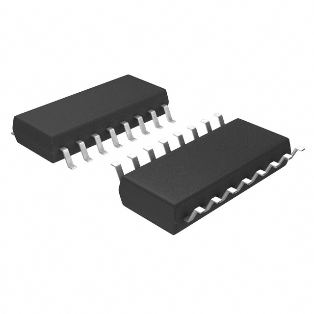

TLP283,TLP283-4 TENTATIVE TOSHIBA PHOTOCOUPLER GaAs IRED & PHOTO-TRANSISTOR TLP283,TLP283-4 PROGRAMMABLE CONTROLLERS AC adapters for PDAs/ on-board power supplies I/O interface boards TLP283 and TLP283-4 is a very small and thin coupler,suitable for surface mount assembly in applications such as on-board power supplies,programmable controllers. TLP283 and TLP283-4 consist of photo transistor,optically coupled to a gallium arsenide infrared emitting diode. l Collector-Emitter Voltage l Current Transfer Ratio l Isolation Voltage l UL Recognized : 100 V (MIN) : 100% (MIN)@IF=1mA : 2500 Vrms (MIN) : UL1577 , File No. E67349 TOSHIBA Weight: 0.05 g 11-3A1 Unit in mm TLP283 l 1 Pulse delay time(Note 1) : 100us(MAX)@IF=1mA,RL=10kΩ Note 1 : 1 Pulse delay time = tON+tOFF PIN CONFIGURATION(Top view) Unit in mm TLP283 1 2 4 3 1:ANODE 2:CATHODE 3:EMITTER 4:COLLECTOR 1 2 3 4 5 6 7 8 TLP283-4 16 15 14 13 12 11 10 9 TOSHIBA Weight: 0.19 g TLP283-4 11-10F1 1,3,5,7 :ANODE 2,4,6,8 :CATHODE 9,11,13,15 :EMITTER 10,12,14,16 :COLLECTOR 1 2002-09-04 TLP283,TLP283-4 MAXIMUM RATINGS (Ta = 25℃) CHARACTERISTIC Forward Current Forward Current Derating LED Pulse Forward Current Reverse Voltage Junction Temperature Collector-Emitter Voltage Emitter-Collector Voltage DETECTOR Collector Current Collector Power Dissipation (1 Circuit) Collector Power Dissipation Derating(Ta≥25°C) (1 Circuit) Junction Temperature Operating Temperature Range Storage Temperature Range Lead Soldering Temperature Total Package Power Dissipation (1 Circuit) Total Package Power Dissipation Derating (Ta≥25°C) (1 Circuit) Isolation Voltage (Note2) SYMBOL IF ∆IF /°C IFP VR Tj VCEO VECO IC PC ∆PC /°C Tj Topr Tstg Tsol PT ∆PT /°C BVS 200 −2.0 150 −1.5 125 −55~100 −55~125 260 (10s) 170 −1.7 −0.7 (Ta≥53°C) 1 5 125 100 7 50 100 −1.0 RATING TLP283 50 −0.5 (Ta≥25°C) TLP283−4 UNIT mA mA /°C A V °C V V mA mW mW /°C °C °C °C °C mW mW /°C Vrms 2500(AC,1min,R.H.≤60%) (Note2)Device considered a two terminal device : LED side pins shorted together and DETECTOR side pins shorted together. INDIVIDUAL ELECTRICAL CHARACTERISTICS (Ta = 25℃) CHARACTERISTIC Forward Voltage LED Reverse Current Capacitance Collector-Emitter Breakdown Voltage Emitter-Collector DETECTOR Breakdown Voltage SYMBOL VF IR CT V(BR) CEO TEST CONDITION IF = 10 mA VR = 5 V V = 0, f = 1 MHz IC = 0.5 mA MIN. 1.0 — — 100 TYP. 1.15 — 30 — MAX. 1.3 10 — — UNIT V µA pF V V(BR) ECO IE = 0.1 mA VCE = 48 V, Ambient Light Below (100 ℓx) VCE = 48 V, Ta = 85°C Ambient Light Below (100 ℓx) V = 0, f = 1 MHz 7 — 0.01 (2) 2 (4) 10 — 0.1 (10) 50 (50) — V Collector Dark Current (Note3) Capacitance (Collector to Emitter) — — — µA µA pF ICEO CCE (Note3) Because of the construction,leak current might be increased by ambient light. Please use photocoupler with less ambient light. 2 2002-09-04 TLP283,TLP283-4 COUPLED ELECTRICAL CHARACTERISTICS (Ta = 25℃) CHARACTERISTIC Current Transfer Ratio Saturated CTR Collector-Emitter Saturation Voltage Off-State Collector Current SYMBOL I C / IF IC / IF (sat) VCE (sat) IC (off) TEST CONDITION IF = 1 mA, VCE = 5 V IF = 1 mA, VCE = 0.4 V IC = 0.2 mA, IF = 1 mA VF = 0.7 V, VCE = 48 V MIN. 100 50 — — TYP. — — 0.2 — MAX. 400 — 0.4 10 UNIT % % V µA ISOLATION CHARACTERISTICS (Ta = 25℃) CHARACTERISTIC Capacitance (Input to Output) Isolation Resistance SYMBOL CS RS TEST CONDITION VS = 0 V, f = 1 MHz VS = 500 V, R.H.≤60% AC , 1 minute Isolation Voltage BVS AC , 1 second,in OIL DC , 1 minute, in OIL MIN. — 5×10 10 TYP. 0.8 10 14 MAX. — — — — — UNIT pF Ω Vrms Vdc 2500 — — — 5000 5000 SWITCHING CHARACTERISTICS (Ta = 25℃) CHARACTERISTIC Turn-On Time Turn-Off Time 1 Pulse delay time SYMBOL tON tOFF tON+ tOFF VCC = 5 V, IF = 1 mA RL = 10kΩ TEST CONDITION MIN. — — — TYP. 7.5 70 80 MAX. 20 90 100 µs UNIT (Fig.1)SWITCHING TIME TEST CIRCUIT 3 2002-09-04 TLP283,TLP283-4 RESTRICTIONS ON PRODUCT USE 000707EBC · TOSHIBA is continually working to improve the quality and reliability of its products. Nevertheless, semiconductor devices in general can malfunction or fail due to their inherent electrical sensitivity and vulnerability to physical stress. It is the responsibility of the buyer, when utilizing TOSHIBA products, to comply with the standards of safety in making a safe design for the entire system, and to avoid situations in which a malfunction or failure of such TOSHIBA products could cause loss of human life, bodily injury or damage to property. In developing your designs, please ensure that TOSHIBA products are used within specified operating ranges as set forth in the most recent TOSHIBA products specifications. Also, please keep in mind the precautions and conditions set forth in the “Handling Guide for Semiconductor Devices,” or “TOSHIBA Semiconductor Reliability Handbook” etc.. · The TOSHIBA products listed in this document are intended for usage in general electronics applications (computer, personal equipment, office equipment, measuring equipment, industrial robotics, domestic appliances, etc.). These TOSHIBA products are neither intended nor warranted for usage in equipment that requires extraordinarily high quality and/or reliability or a malfunction or failure of which may cause loss of human life or bodily injury (“Unintended Usage”). Unintended Usage include atomic energy control instruments, airplane or spaceship instruments, transportation instruments, traffic signal instruments, combustion control instruments, medical instruments, all types of safety devices, etc.. Unintended Usage of TOSHIBA products listed in this document shall be made at the customer’s own risk. · Gallium arsenide (GaAs) is a substance used in the products described in this document. GaAs dust and fumes are toxic. Do not break, cut or pulverize the product, or use chemicals to dissolve them. When disposing of the products, follow the appropriate regulations. Do not dispose of the products with other industrial waste or with domestic garbage. · The products described in this document are subject to the foreign exchange and foreign trade laws. · The information contained herein is presented only as a guide for the applications of our products. No responsibility is assumed by TOSHIBA CORPORATION for any infringements of intellectual property or other rights of the third parties which may result from its use. No license is granted by implication or otherwise under any intellectual property or other rights of TOSHIBA CORPORATION or others. · The information contained herein is subject to change without notice. 4 2002-09-04
