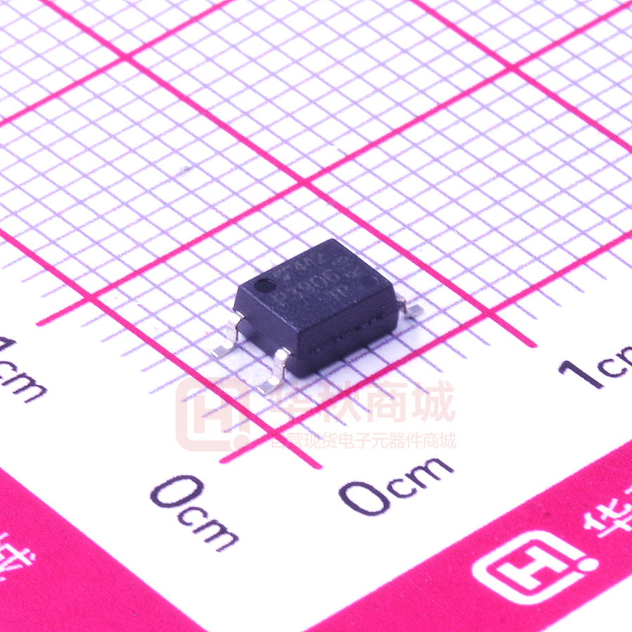

TLP3906 Photocouplers GaAℓAs Infrared LED & Photo Diode TLP3906 1. Applications • Measuring Instruments • MOSFET Gate Drivers 2. General The TLP3906 is a photocoupler in the SO6 package that consists of an infrared light emitting diode optically coupled to a photodiode array. The photodiodes are connected in series, making the TLP3906 suitable for MOS gate drive applications. 3. Features (1) Open voltage: 7 V (min) (2) Short current: 12 µA (min) (3) Isolation voltage: 3750 Vrms (min) (4) Safety standards UL-approved: UL1577, File No.E67349 cUL-approved: CSA Component Acceptance Service No.5A File No.E67349 VDE-approved: EN60747-5-5, EN60065 or EN60950-1 (Note 1) Note 1: When a VDE approved type is needed, please designate the Option (V4) (V4). Table Note: Short-Circuit Current (Note) (Unless otherwise specified, Ta = 25 ) Rank ISC Rank Marking Test Condition Short-Circuit Current ISC (min) Unit C20 C IF = 10 mA 20 µA None C, Blank IF = 10 mA 12 Specify both the part number and a rank in this format when ordering. Example: TLP3906(C20) For safety standard certification, however, specify the part number alone. Example: TLP3906(C20,E(O → TLP3906 4. Packaging and Pin Assignment 1: Anode (Input) 3: Cathode (Input) 4: Cathode (Output) 6: Anode (Output) 11-4M1S Start of commercial production ©2016 Toshiba Corporation 1 2014-02 2017-04-14 Rev.2.0 TLP3906 5. Mechanical Parameters Characteristics Min Unit Creepage distances 5.0 mm Clearance 5.0 Internal isolation thickness 0.4 6. Absolute Maximum Ratings (Note) (Unless otherwise specified, Ta = 25 ) Characteristics LED Symbol Input forward current Note Rating Unit IF 30 mA -0.8 Input forward current (Ta = 125 ) Input forward current derating (Ta ≥ 100 ) ∆IF/∆Ta 10 PD 50 mW (Ta ≥ 100 ) ∆PD/∆Ta -1.3 mW/ Input power dissipation Input power dissipation derating Input reverse voltage Detector Output forward current Output reverse voltage Output power dissipation (-40 ≤Ta ≤ 125 ) Common Operating temperature Storage temperature Lead soldering temperature Isolation voltage mA/ VR 3 V IFD 50 µA VRD 10 V PO 0.5 mW Topr -40 to 125  Tstg -55 to 125  (10 s) Tsol AC, 60 s, R.H. ≤ 60 % BVS (Note 1) 260  3750 Vrms Note: Using continuously under heavy loads (e.g. the application of high temperature/current/voltage and the significant change in temperature, etc.) may cause this product to decrease in the reliability significantly even if the operating conditions (i.e. operating temperature/current/voltage, etc.) are within the absolute maximum ratings. Please design the appropriate reliability upon reviewing the Toshiba Semiconductor Reliability Handbook ("Handling Precautions"/"Derating Concept and Methods") and individual reliability data (i.e. reliability test report and estimated failure rate, etc). Note 1: This device is considered as a two-terminal device: Pins 1 and 3 are shorted together, and pins 4 and 6 are shorted together. 7. Recommended Operating Conditions (Note) Characteristics Symbol Min Typ. Max Unit IF  12 15 mA Topr -25  100  Input forward current Operating temperature Note: Note The recommended operating conditions are given as a design guide necessary to obtain the intended performance of the device. Each parameter is an independent value. When creating a system design using this device, the electrical characteristics specified in this data sheet should also be considered. 8. Electrical Characteristics (Unless otherwise specified, Ta = 25 ) Characteristics LED Symbol Note Test Condition Min Typ. Max Unit Input forward voltage VF IF = 10 mA 1.5 1.65 1.8 V Input reverse current IR VR = 3 V   10 µA Input capacitance Ct V = 0 V, f = 1 MHz  45  pF ©2016 Toshiba Corporation 2 2017-04-14 Rev.2.0 TLP3906 9. Coupled Electrical Characteristics (Unless otherwise specified, Ta = 25 ) Characteristics Symbol Note Test Condition Min Typ. Max Unit Trigger LED current IFT VOC ≥ 5 V   3 mA Open voltage VOC IF = 10 mA 7 9  V Short-circuit current ISC IF = 10 mA, Ta = 125  5  IF = 10 mA 12 30  IF = 10 mA, Ta = 125  12  Min Typ. Max Unit  0.8  pF (Note 1) VS = 500 V, R.H. ≤ 60 % 1012 1014  Ω (Note 1) AC, 60 s 3750   Vrms AC, 1 s in oil  10000  DC, 60 s in oil  10000  µA 10. Isolation Characteristics (Unless otherwise specified, Ta = 25 ) Characteristics Symbol Total capacitance (input to output) CS Isolation resistance RS Isolation voltage BVS Note Test Condition (Note 1) VS = 0 V, f = 1 MHz Vdc Note 1: This device is considered as a two-terminal device: Pins 1 and 3 are shorted together, and pins 4 and 6 are shorted together. 11. Switching Characteristics (Unless otherwise specified, Ta = 25 ) Characteristics Symbol Turn-on time ton Turn-off time toff Note Test Condition IF = 10 mA, CL = 1000 pF See Fig. 11.1. Min Typ. Max Unit  0.2 1 ms  0.3 1 Fig. 11.1 Switching Time Test Circuit, Waveform ©2016 Toshiba Corporation 3 2017-04-14 Rev.2.0 TLP3906 12. Characteristics Curves (Note) Fig. 12.1 IF - Ta Fig. 12.2 IF - VF Fig. 12.3 IFT - Ta Fig. 12.4 VOC - IF Fig. 12.5 ISC - IF Fig. 12.6 VOC - Ta ©2016 Toshiba Corporation 4 2017-04-14 Rev.2.0 TLP3906 Fig. 12.7 ISC - Ta Note: Fig. 12.8 ton, toff - CL The above characteristics curves are presented for reference only and not guaranteed by production test, unless otherwise noted. ©2016 Toshiba Corporation 5 2017-04-14 Rev.2.0 TLP3906 13. Soldering and Storage 13.1. Precautions for Soldering The soldering temperature should be controlled as closely as possible to the conditions shown below, irrespective of whether a soldering iron or a reflow soldering method is used. • When using soldering reflow. The soldering temperature profile is based on the package surface temperature. (See the figure shown below, which is based on the package surface temperature.) Reflow soldering must be performed once or twice. The mounting should be completed with the interval from the first to the last mountings being 2 weeks. Fig. 13.1.1 An example of a temperature profile when lead(Pb)-free solder is used • When using soldering flow Preheat the device at a temperature of 150  (package surface temperature) for 60 to 120 seconds. Mounting condition of 260  within 10 seconds is recommended. Flow soldering must be performed once. • When using soldering Iron Complete soldering within 10 seconds for lead temperature not exceeding 260  or within 3 seconds not exceeding 350  Heating by soldering iron must be done only once per lead. 13.2. Precautions for General Storage • Avoid storage locations where devices may be exposed to moisture or direct sunlight • Follow the precautions printed on the packing label of the device for transportation and storage. • Keep the storage location temperature and humidity within a range of 5  to 35  and 45 % to 75 %, respectively. • Do not store the products in locations with poisonous gases (especially corrosive gases) or in dusty conditions. • Store the products in locations with minimal temperature fluctuations. Rapid temperature changes during storage can cause condensation, resulting in lead oxidation or corrosion, which will deteriorate the solderability of the leads. • When restoring devices after removal from their packing, use anti-static containers. • Do not allow loads to be applied directly to devices while they are in storage. • If devices have been stored for more than two years under normal storage conditions, it is recommended that you check the leads for ease of soldering prior to use. ©2016 Toshiba Corporation 6 2017-04-14 Rev.2.0 TLP3906 14. Land Pattern Dimensions (for reference only) Unit: mm 15. Marking ©2016 Toshiba Corporation 7 2017-04-14 Rev.2.0 TLP3906 16. EN60747-5-5 Option (V4) Specification • Part number: TLP3906 (Note 1) • The following part naming conventions are used for the devices that have been qualified according to option (V4) of EN60747. Example: TLP3906(V4-TPL,E(O V4: EN60747 option TPL: Tape type E: [[G]]/RoHS COMPATIBLE (Note 2) (O: Domestic ID (Country / Region of origin: Japan) Note 1: Use TOSHIBA standard type number for safety standard application. e.g., TLP3906(V4) → TLP3906 Note 2: Please contact your Toshiba sales representative for details on environmental information such as the product's RoHS compatibility. RoHS is the Directive 2011/65/EU of the European Parliament and of the Council of 8 June 2011 on the restriction of the use of certain hazardous substances in electrical and electronic equipment. Fig. 16.1 EN60747 Insulation Characteristics ©2016 Toshiba Corporation 8 2017-04-14 Rev.2.0 TLP3906 Fig. 16.2 Insulation Related Specifications (Note) Note: Note: If a printed circuit is incorporated, the creepage distance and clearance may be reduced below this value. (e.g., at a standard distance between soldering eye centers of 3.5 mm). If this is not permissible, the user shall take suitable measures. This photocoupler is suitable for safe electrical isolation only within the safety limit data. Maintenance of the safety data shall be ensured by means of protective circuits. Fig. 16.3 Marking on packing for EN60747 Fig. 16.4 Marking Example (Note) Note: The above marking is applied to the photocouplers that have been qualified according to option (V4) of EN60747. ©2016 Toshiba Corporation 9 2017-04-14 Rev.2.0 TLP3906 Fig. 16.5 Measurement Procedure ©2016 Toshiba Corporation 10 2017-04-14 Rev.2.0 TLP3906 17. Embossed-Tape Packing (TP) Specification for Mini-Flat Photocouplers 17.1. Applicable Package Package Name Product Type SO6 Photocoupler 17.2. Product Naming Conventions Type of package used for shipment is denoted by a symbol suffix after a part number. The method of classification is as below. Example) TLP3906(TPL,E(O Part number: TLP3906 Tape type: TPL [[G]]/RoHS COMPATIBLE: E (Note 1) Domestic ID (Country / Region of origin: Japan): (O Note 1: Please contact your Toshiba sales representative for details on environmental information such as the product's RoHS compatibility. RoHS is the Directive 2011/65/EU of the European Parliament and of the Council of 8 June 2011 on the restriction of the use of certain hazardous substances in electrical and electronic equipment. 17.3. Tape Dimensions Specification Division Packing Amount (A unit per reel) TPL, TL L direction 3000 TPR, TR R direction 3000 Tape Type 17.3.1. Orientation of Device in Relation to Direction of Feed Device orientation in the carrier cavities as shown in Fig. 17.3.1.1. Fig. 17.3.1.1 Device Orientation ©2016 Toshiba Corporation 11 2017-04-14 Rev.2.0 TLP3906 17.3.2. Empty Cavities Characteristics Criterion Occurrences of 2 or more successive empty cavities Remarks 0 device Single empty cavity Within any given 40-mm section of tape, not including leader and trailer 6 devices (max) per reel Not including leader and trailer 17.3.3. Tape Leader and Trailer The start end of the tape has 50 or more empty cavities. The hub end of the tape has 50 or more empty cavities and two empty turns only for a cover tape. 17.3.4. Tape Dimensions Tape material: Plastic (for protection against static electricity) Table Tape Dimensions (unit: mm, tolerance: ±0.1) Symbol Dimension Remark A 4.0  B 7.6  D 5.5 Center line of embossed cavity and sprocket hole E 1.75 Distance between tape edge and sprocket hole center F 8.0 Cumulative error +0.1/-0.3 (max) per 10 empty cavities holes G 4.0 Cumulative error +0.1/-0.3 (max) per 10 sprocket holes K0 2.6 Internal space ©2016 Toshiba Corporation 12 2017-04-14 Rev.2.0 TLP3906 17.3.5. Reel Specification Material: Plastic Table Reel Dimensions (unit: mm) Symbol ©2016 Toshiba Corporation Dimension A φ330 ± 2 B φ80 ± 1 or φ100 ± 1 C φ13 ± 0.5 E 2.0 ± 0.5 U 4.0 ± 0.5 W1 13.5 ± 0.5 W2 17.5 ± 1.0 13 2017-04-14 Rev.2.0 TLP3906 17.4. Packing (Note) 1 reel/carton (unit: mm) Note: Taping reel diameter: φ330 mm 17.5. Label Format The carton bears a label indicating the product number, the symbol representing classification of standard, the quantity, the lot number and the Toshiba company name. 17.6. Ordering Information When placing an order, please specify the part number, ISC rank, tape type and quantity as shown in the following example. Example) TLP3906(TPL,E(O 3000pcs Part number: TLP3906 Tape type: TPL [[G]]/RoHS COMPATIBLE: E (Note) Domestic ID (Country / Region of origin: Japan): (O Quantity (must be a multiple of 3000): 3000pcs Note : Please contact your Toshiba sales representative for details on environmental information such as the product's RoHS compatibility. RoHS is the Directive 2011/65/EU of the European Parliament and of the Council of 8 June 2011 on the restriction of the use of certain hazardous substances in electrical and electronic equipment. ©2016 Toshiba Corporation 14 2017-04-14 Rev.2.0 TLP3906 Package Dimensions Unit: mm Weight: 0.08 g (typ.) Package Name(s) TOSHIBA: 11-4M1S ©2016 Toshiba Corporation 15 2017-04-14 Rev.2.0 TLP3906 RESTRICTIONS ON PRODUCT USE • Toshiba Corporation, and its subsidiaries and affiliates (collectively "TOSHIBA"), reserve the right to make changes to the information in this document, and related hardware, software and systems (collectively "Product") without notice. • This document and any information herein may not be reproduced without prior written permission from TOSHIBA. Even with TOSHIBA's written permission, reproduction is permissible only if reproduction is without alteration/omission. • Though TOSHIBA works continually to improve Product's quality and reliability, Product can malfunction or fail. Customers are responsible for complying with safety standards and for providing adequate designs and safeguards for their hardware, software and systems which minimize risk and avoid situations in which a malfunction or failure of Product could cause loss of human life, bodily injury or damage to property, including data loss or corruption. Before customers use the Product, create designs including the Product, or incorporate the Product into their own applications, customers must also refer to and comply with (a) the latest versions of all relevant TOSHIBA information, including without limitation, this document, the specifications, the data sheets and application notes for Product and the precautions and conditions set forth in the "TOSHIBA Semiconductor Reliability Handbook" and (b) the instructions for the application with which the Product will be used with or for. Customers are solely responsible for all aspects of their own product design or applications, including but not limited to (a) determining the appropriateness of the use of this Product in such design or applications; (b) evaluating and determining the applicability of any information contained in this document, or in charts, diagrams, programs, algorithms, sample application circuits, or any other referenced documents; and (c) validating all operating parameters for such designs and applications. TOSHIBA ASSUMES NO LIABILITY FOR CUSTOMERS' PRODUCT DESIGN OR APPLICATIONS. • PRODUCT IS NEITHER INTENDED NOR WARRANTED FOR USE IN EQUIPMENTS OR SYSTEMS THAT REQUIRE EXTRAORDINARILY HIGH LEVELS OF QUALITY AND/OR RELIABILITY, AND/OR A MALFUNCTION OR FAILURE OF WHICH MAY CAUSE LOSS OF HUMAN LIFE, BODILY INJURY, SERIOUS PROPERTY DAMAGE AND/OR SERIOUS PUBLIC IMPACT ("UNINTENDED USE"). Except for specific applications as expressly stated in this document, Unintended Use includes, without limitation, equipment used in nuclear facilities, equipment used in the aerospace industry, medical equipment, equipment used for automobiles, trains, ships and other transportation, traffic signaling equipment, equipment used to control combustions or explosions, safety devices, elevators and escalators, devices related to electric power, and equipment used in finance-related fields. IF YOU USE PRODUCT FOR UNINTENDED USE, TOSHIBA ASSUMES NO LIABILITY FOR PRODUCT. For details, please contact your TOSHIBA sales representative. • Do not disassemble, analyze, reverse-engineer, alter, modify, translate or copy Product, whether in whole or in part. • Product shall not be used for or incorporated into any products or systems whose manufacture, use, or sale is prohibited under any applicable laws or regulations. • The information contained herein is presented only as guidance for Product use. No responsibility is assumed by TOSHIBA for any infringement of patents or any other intellectual property rights of third parties that may result from the use of Product. No license to any intellectual property right is granted by this document, whether express or implied, by estoppel or otherwise. • ABSENT A WRITTEN SIGNED AGREEMENT, EXCEPT AS PROVIDED IN THE RELEVANT TERMS AND CONDITIONS OF SALE FOR PRODUCT, AND TO THE MAXIMUM EXTENT ALLOWABLE BY LAW, TOSHIBA (1) ASSUMES NO LIABILITY WHATSOEVER, INCLUDING WITHOUT LIMITATION, INDIRECT, CONSEQUENTIAL, SPECIAL, OR INCIDENTAL DAMAGES OR LOSS, INCLUDING WITHOUT LIMITATION, LOSS OF PROFITS, LOSS OF OPPORTUNITIES, BUSINESS INTERRUPTION AND LOSS OF DATA, AND (2) DISCLAIMS ANY AND ALL EXPRESS OR IMPLIED WARRANTIES AND CONDITIONS RELATED TO SALE, USE OF PRODUCT, OR INFORMATION, INCLUDING WARRANTIES OR CONDITIONS OF MERCHANTABILITY, FITNESS FOR A PARTICULAR PURPOSE, ACCURACY OF INFORMATION, OR NONINFRINGEMENT. • GaAs (Gallium Arsenide) is used in Product. GaAs is harmful to humans if consumed or absorbed, whether in the form of dust or vapor. Handle with care and do not break, cut, crush, grind, dissolve chemically or otherwise expose GaAs in Product. • Do not use or otherwise make available Product or related software or technology for any military purposes, including without limitation, for the design, development, use, stockpiling or manufacturing of nuclear, chemical, or biological weapons or missile technology products (mass destruction weapons). Product and related software and technology may be controlled under the applicable export laws and regulations including, without limitation, the Japanese Foreign Exchange and Foreign Trade Law and the U.S. Export Administration Regulations. Export and re-export of Product or related software or technology are strictly prohibited except in compliance with all applicable export laws and regulations. • Please contact your TOSHIBA sales representative for details as to environmental matters such as the RoHS compatibility of Product. Please use Product in compliance with all applicable laws and regulations that regulate the inclusion or use of controlled substances, including without limitation, the EU RoHS Directive. TOSHIBA ASSUMES NO LIABILITY FOR DAMAGES OR LOSSES OCCURRING AS A RESULT OF NONCOMPLIANCE WITH APPLICABLE LAWS AND REGULATIONS. ©2016 Toshiba Corporation 16 2017-04-14 Rev.2.0
