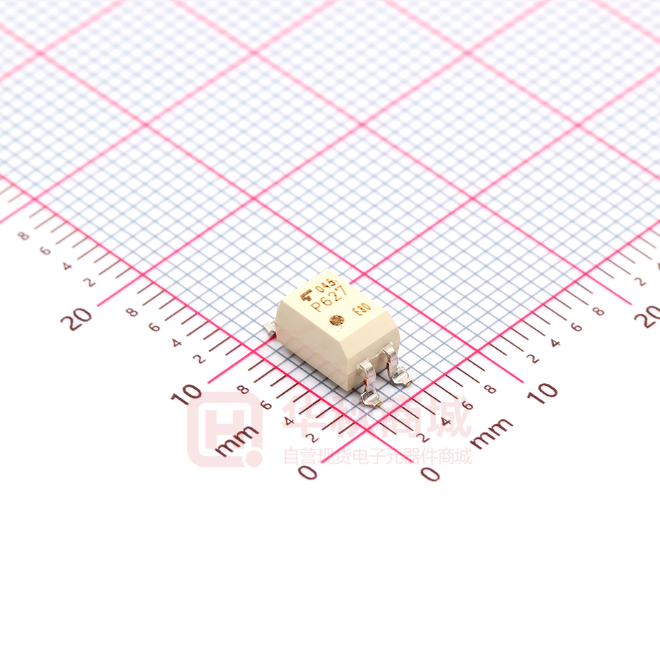

    光隔离器 达林顿晶体管 输出 5000Vrms 1 通道 SOP4_4.58X6.4MM
TLP627(TP1,F) 数据手册
TLP627,TLP627-2,TLP627-4 TOSHIBA Photocoupler GaAs IRED & Photo-Transistor TLP627,TLP627-2,TLP627-4 Programmable Controllers DC-output Module Telecommunication Unit in mm The TOSHIBA TLP627,-2 and -4 consists of a gallium arsenide infrared emitting diode optically coupled to a darlington connected phototransistor which has an integral base-emitter resistor to optimize switching speed and elevated temperature characteristics. The TLP627-2 offers two isolated channels in a eight lead plastic DIP, while the TLP627-4 provide four isolated channels per package. Collector-Emitter Voltage Current Transfer Ratio Isolation Voltage UL Recognized z z z z Made in Japan UL Recognized BSI Approved TOSHIBA : 300V(Min) : 1000%(Min) : 5000Vrms(Min) : UL1577,File No.E67349 11−5B2 Weight: 0.26 g (typ.) Made in Thailand E67349 *1 E152349 *1 7426, 7427 *2 7426, 7427 *2 *1 UL1577 *2 BS EN60065: 2002, BS EN60950-1: 2002 Pin Configuration (top view) TOSHIBA TLP627-2 TLP627 TLP627-4 1 4 1 8 1 16 2 3 2 7 2 15 3 6 3 14 4 5 4 13 5 12 6 11 7 10 8 9 1: ANODE 2: CATHODE 3: EMITTER 4:COLLECTOR 1,3: ANODE 2,4: CATHODE 5,7: EMITTER 6,8:COLLECTOR 1,3,5,7 : ANODE 2,4,6,8 : CATHODE 9,11,13,15 : EMITTER 10,12,14,16 :COLLECTOR 1 11−10C4 Weight: 0.54 g (typ.) TOSHIBA 11−20A3 Weight: 1.1 g (typ.) 2007-10-01 TLP627,TLP627-2,TLP627-4 Absolute Maximum Ratings (Ta=25°C) Rating Characteristics Symbol Forward Current Forward Current Derating LED Pulse Forward Current Power Dissipation (1 Circuit) Detector Power Dissipation Derating (Ta≥25°C,1 Circuit) TLP627-2 TLP627-4 Unit TLP627 IF 60 50 mA ∆IF /°C −0.7(Ta≥39°C) −0.5(Ta≥25°C) mA /°C IFP 1(100μs pulse,100pps) A PD 100 70 mW ∆ PD /°C -1.0 -0.7 mW /°C Reverse Voltage VR 5 V Junction Temperature Tj 125 °C Collector-Emitter Voltage VCEO 300 V Emitter -Collector Voltage VECO 0.3 V IC 150 mA Collector Current Collector Power Dissipation (1 Circuit) Collector Power Dissipation Derating (Ta≥25°C,1 Circuit) PC 150(*300) 100 mW ∆ Pc /°C -1.5(*-3.5) -1.0 mW /°C Junction Temperature Tj 125 °C Operating Temperature Range Topr −55~100 °C Storage Temperature Range Tstg −55~125 °C Lead Soldering Temperature (10s) Tsold 260(10sec) °C Total Package Power Dissipation Total Package Power Dissipation Derating Isolation Voltage (Ta≥25°C,1 Circuit) (AC,1min. , R.H.≤60%) (Note1) PT 250(*320) ∆ PT/°C -2.5(*-3.2) BVS 5000 150 mW -1.5 mW /°C Vrms *IF=20mA Max Note: Using continuously under heavy loads (e.g. the application of high temperature/current/voltage and the significant change in temperature, etc.) may cause this product to decrease in the reliability significantly even if the operating conditions (i.e. operating temperature/current/voltage, etc.) are within the absolute maximum ratings. Please design the appropriate reliability upon reviewing the Toshiba Semiconductor Reliability Handbook (“Handling Precautions”/“Derating Concept and Methods”) and individual reliability data (i.e. reliability test report and estimated failure rate, etc). (Note1)Device considered a two terminal device : LED side pins Shorted together and DETECTOR side pins shorted together. Recommended Operating Conditions Characteristics Symbol Min. Typ. Max. Unit Supply Voltage VCC — — 200 V Forward Current IF — 16 25 mA Collector Current IC — — 120 mA Topr −25 — 85 °C Operating Temperature Note: Recommended operating conditions are given as a design guideline to obtain expected performance of the device. Additionally, each item is an independent guideline respectively. In developing designs using this product, please confirm specified characteristics shown in this document. 2 2007-10-01 TLP627,TLP627-2,TLP627-4 Individual Electrical Characteristics (Ta=25°C) LED Characteristics Test Condition Min. Typ. Max. Unit Forward Voltage VF IF = 10 mA 1.0 1.15 1.3 V Reverse Current IR VR = 5 V — — 10 μA Capacitance CT V=0, — 30 — pF Collector-Emitter Breakdown Voltage Emitter-Collector Detector Symbol Breakdown Voltage Collector Dark Current Capacitance Collector to Emitter f=1MHz V(BR)CEO IC = 0.1mA 300 — — V V(BR)ECO IE = 0.1mA 0.3 — — V VCE = 200V — 10 200 nA VCE = 200V , Ta = 85°C — — 20 μA V=0 , f=1MHz — 10 — pF Min. Typ. Max. Unit ICEO CCE Coupled Electrical Characteristics (Ta=25°C) Characteristics Current Transfer Ratio Saturated CTR Collector-Emitter Saturation Voltage Symbol Test Condition IC/IF IF=1mA , VCE=1V 1000 4000 — % IC/IF(sat) IF=10mA , VCE=1V 500 — — % IC=10mA , IF=1mA — — 1.0 IC=100mA , IF=10mA 0.3 — 1.2 Min. Typ. Max. Unit — 0.8 — pF — Ω VCE(sat) V Isolation Electrical Characteristics (Ta=25°C) Characteristics Capacitance Input to Output Isolation Resistance Symbol CS RS Test Condition VS=0 , f=1MHz VS=500V , R.H.≤60% AC, 1minute Isolation Voltage BVs 5×10 10 10 14 5000 — — AC, 1second, in oil — 10000 — DC, 1 minute, in oil — 10000 — 3 Vrms Vdc 2007-10-01 TLP627,TLP627-2,TLP627-4 Switching Characteristics (Ta=25°C) Characteristics Symbol Rise Time tr Fall Time tf Test Condition Min. Typ. Max. — 40 — — 15 — — 50 — — 15 — — 5 — — 40 — — 80 — VCC=10V IC=10mA Turn-on Time ton Turn-off Time toff Turn-on Time tON Strage Time ts Turn-off Time tOFF RL=100Ω RL=180Ω (Fig.1) VCC=10V , IF=16mA Unit μs Fig.1 Switching Time Test Circuit VCC IF RL VCE IF VCE 9V ts VCC 1V tON tOFF 4 2007-10-01 TLP627,TLP627-2,TLP627-4 5 2007-10-01 TLP627,TLP627-2,TLP627-4 6 2007-10-01 TLP627,TLP627-2,TLP627-4 7 2007-10-01 TLP627,TLP627-2,TLP627-4 RESTRICTIONS ON PRODUCT USE • Toshiba Corporation, and its subsidiaries and affiliates (collectively “TOSHIBA”), reserve the right to make changes to the information in this document, and related hardware, software and systems (collectively “Product”) without notice. • This document and any information herein may not be reproduced without prior written permission from TOSHIBA. Even with TOSHIBA’s written permission, reproduction is permissible only if reproduction is without alteration/omission. • Though TOSHIBA works continually to improve Product’s quality and reliability, Product can malfunction or fail. Customers are responsible for complying with safety standards and for providing adequate designs and safeguards for their hardware, software and systems which minimize risk and avoid situations in which a malfunction or failure of Product could cause loss of human life, bodily injury or damage to property, including data loss or corruption. Before creating and producing designs and using, customers must also refer to and comply with (a) the latest versions of all relevant TOSHIBA information, including without limitation, this document, the specifications, the data sheets and application notes for Product and the precautions and conditions set forth in the “TOSHIBA Semiconductor Reliability Handbook” and (b) the instructions for the application that Product will be used with or for. Customers are solely responsible for all aspects of their own product design or applications, including but not limited to (a) determining the appropriateness of the use of this Product in such design or applications; (b) evaluating and determining the applicability of any information contained in this document, or in charts, diagrams, programs, algorithms, sample application circuits, or any other referenced documents; and (c) validating all operating parameters for such designs and applications. TOSHIBA ASSUMES NO LIABILITY FOR CUSTOMERS’ PRODUCT DESIGN OR APPLICATIONS. • Product is intended for use in general electronics applications (e.g., computers, personal equipment, office equipment, measuring equipment, industrial robots and home electronics appliances) or for specific applications as expressly stated in this document. Product is neither intended nor warranted for use in equipment or systems that require extraordinarily high levels of quality and/or reliability and/or a malfunction or failure of which may cause loss of human life, bodily injury, serious property damage or serious public impact (“Unintended Use”). Unintended Use includes, without limitation, equipment used in nuclear facilities, equipment used in the aerospace industry, medical equipment, equipment used for automobiles, trains, ships and other transportation, traffic signaling equipment, equipment used to control combustions or explosions, safety devices, elevators and escalators, devices related to electric power, and equipment used in finance-related fields. Do not use Product for Unintended Use unless specifically permitted in this document. • Do not disassemble, analyze, reverse-engineer, alter, modify, translate or copy Product, whether in whole or in part. • Product shall not be used for or incorporated into any products or systems whose manufacture, use, or sale is prohibited under any applicable laws or regulations. • The information contained herein is presented only as guidance for Product use. No responsibility is assumed by TOSHIBA for any infringement of patents or any other intellectual property rights of third parties that may result from the use of Product. No license to any intellectual property right is granted by this document, whether express or implied, by estoppel or otherwise. • ABSENT A WRITTEN SIGNED AGREEMENT, EXCEPT AS PROVIDED IN THE RELEVANT TERMS AND CONDITIONS OF SALE FOR PRODUCT, AND TO THE MAXIMUM EXTENT ALLOWABLE BY LAW, TOSHIBA (1) ASSUMES NO LIABILITY WHATSOEVER, INCLUDING WITHOUT LIMITATION, INDIRECT, CONSEQUENTIAL, SPECIAL, OR INCIDENTAL DAMAGES OR LOSS, INCLUDING WITHOUT LIMITATION, LOSS OF PROFITS, LOSS OF OPPORTUNITIES, BUSINESS INTERRUPTION AND LOSS OF DATA, AND (2) DISCLAIMS ANY AND ALL EXPRESS OR IMPLIED WARRANTIES AND CONDITIONS RELATED TO SALE, USE OF PRODUCT, OR INFORMATION, INCLUDING WARRANTIES OR CONDITIONS OF MERCHANTABILITY, FITNESS FOR A PARTICULAR PURPOSE, ACCURACY OF INFORMATION, OR NONINFRINGEMENT. • GaAs (Gallium Arsenide) is used in Product. GaAs is harmful to humans if consumed or absorbed, whether in the form of dust or vapor. Handle with care and do not break, cut, crush, grind, dissolve chemically or otherwise expose GaAs in Product. • Do not use or otherwise make available Product or related software or technology for any military purposes, including without limitation, for the design, development, use, stockpiling or manufacturing of nuclear, chemical, or biological weapons or missile technology products (mass destruction weapons). Product and related software and technology may be controlled under the Japanese Foreign Exchange and Foreign Trade Law and the U.S. Export Administration Regulations. Export and re-export of Product or related software or technology are strictly prohibited except in compliance with all applicable export laws and regulations. • Please contact your TOSHIBA sales representative for details as to environmental matters such as the RoHS compatibility of Product. Please use Product in compliance with all applicable laws and regulations that regulate the inclusion or use of controlled substances, including without limitation, the EU RoHS Directive. TOSHIBA assumes no liability for damages or losses occurring as a result of noncompliance with applicable laws and regulations. 8 2007-10-01
