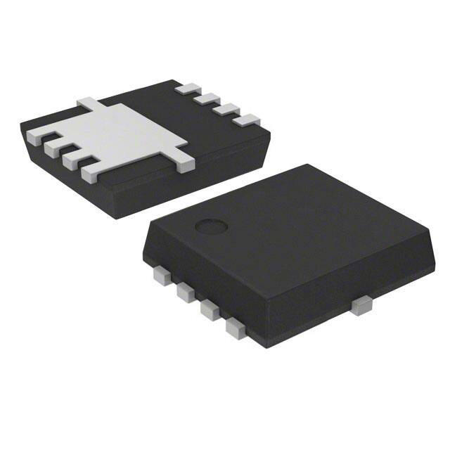

TPCA8052-H TOSHIBA Field Effect Transistor Silicon N-Channel MOS Type (U-MOSⅥ-H) TPCA8052-H Switching Regulator Applications Motor Drive Applications DC-DC Converter Applications Unit: mm 1.27 0.4 ± 0.1 High-speed switching • Small gate charge: QSW = 6.8 nC (typ.) • Low drain-source ON-resistance: RDS (ON) = 7.2 mΩ (typ.) • High forward transfer admittance: |Yfs| = 58 S (typ.) • Low leakage current: IDSS = 10 μA (max) (VDS = 40 V) • Enhancement mode: Vth = 1.3 to 2.3 V (VDS = 10 V, ID = 0.2 mA) 0.95 ± 0.05 Absolute Maximum Ratings (Ta = 25°C) 0.595 5.0 ± 0.2 0.05 S S 4 Symbol Rating Unit Drain-source voltage VDSS 40 V Drain-gate voltage (RGS = 20 kΩ) VDGR 40 V Gate-source voltage VGSS ±20 V (Note 1) ID 20 Pulsed (Note 1) IDP 60 PD 30 W JEDEC ⎯ 2.8 W JEITA ⎯ Drain current DC Drain power dissipation (Tc = 25℃) A Drain power dissipation (t = 10 s) (Note 2a) PD Drain power dissipation (t = 10 s) (Note 2b) PD 1.6 W Single-pulse avalanche energy (Note 3) EAS 37 mJ Avalanche current IAR 20 A Repetitive avalanche energy (Tc = 25℃) (Note 4) EAR 2.24 mJ Channel temperature Tch 150 °C Storage temperature range Tstg −55 to 150 °C 4.25 ± 0.2 8 5 1,2,3:SOURCE 5,6,7,8:DRAIN TOSHIBA A 3.5 ± 0.2 1 0.6 ± 0.1 Characteristic 4 1 0.166 ± 0.05 • 0.15 ± 0.05 1.1 ± 0.2 Small footprint due to a small and thin package 0.8 ± 0.1 • 0.05 M A 5 5.0 ± 0.2 6.0 ± 0.3 8 4:GATE 2-5Q1A Weight: 0.069 g (typ.) Circuit Configuration 8 7 6 5 Note: For Notes 1 to 4, refer to the next page. Using continuously under heavy loads (e.g. the application of high temperature/current/voltage and the significant change in 4 1 2 3 temperature, etc.) may cause this product to decrease in the reliability significantly even if the operating conditions (i.e. operating temperature/current/voltage, etc.) are within the absolute maximum ratings. Please design the appropriate reliability upon reviewing the Toshiba Semiconductor Reliability Handbook (“Handling Precautions”/“Derating Concept and Methods”) and individual reliability data (i.e. reliability test report and estimated failure rate, etc). This transistor is an electrostatic-sensitive device. Handle with care. Start of commercial production 2009-03 1 2013-11-01 TPCA8052-H Thermal Characteristics Characteristic Thermal resistance, channel to case (Tc = 25℃) Thermal resistance, channel to ambient (t = 10 s) (Note 2a) Thermal resistance, channel to ambient (t = 10 s) (Note 2b) Symbol Max Unit Rth (ch-c) 4.17 °C/W Rth (ch-a) 44.6 °C/W Rth (ch-a) 78.1 °C/W Marking (Note 5) TPCA 8052-H ※ Part number Lot No. Note 1: Ensure that the channel temperature does not exceed 150°C. Note 2: (a) Device mounted on a glass-epoxy board (a) (b) Device mounted on a glass-epoxy board (b) FR-4 25.4 × 25.4 × 0.8 (Unit: mm) FR-4 25.4 × 25.4 × 0.8 (Unit: mm) (b) (a) Note 3: VDD = 24 V, Tch = 25 °C (initial), L = 100 μH, RG = 25 Ω, IAR = 20 A Note 4: Repetitive rating: pulse width limited by maximum channel temperature Note 5: * Weekly code: (Three digits) Week of manufacture (01 for the first week of the year, continuing up to 52 or 53) Year of manufacture (The last digit of the year) 2 2013-11-01 TPCA8052-H Electrical Characteristics (Ta = 25°C) Characteristic Symbol Test Condition Min Typ. Max Unit Gate leakage current IGSS VGS = ±20 V, VDS = 0 V ⎯ ⎯ ±100 nA Drain cutoff current IDSS VDS = 40 V, VGS = 0 V ⎯ ⎯ 10 μA V (BR) DSS ID = 10 mA, VGS = 0 V 40 ⎯ ⎯ V (BR) DSX ID = 10 mA, VGS = −20 V 23 ⎯ ⎯ Vth VDS = 10 V, ID = 0.2 mA 1.3 ⎯ 2.3 VGS = 4.5 V, ID = 10 A ⎯ 9.1 13.1 VGS = 10 V, ID = 10 A ⎯ 7.2 11.3 VDS = 10 V, ID = 10 A 29 58 ⎯ ⎯ 1620 2110 ⎯ 85 130 ⎯ 280 ⎯ ⎯ 2.3 3.5 ⎯ 2.4 ⎯ ⎯ 8.4 ⎯ ⎯ 8.0 ⎯ ⎯ 35 ⎯ VDD ≈ 32 V, VGS = 10 V, ID = 20 A ⎯ 25 ⎯ VDD ≈ 32 V, VGS = 5 V, ID = 20 A ⎯ 13 ⎯ ⎯ 5.6 ⎯ ⎯ 3.8 ⎯ ⎯ 6.8 ⎯ Drain-source breakdown voltage Gate threshold voltage Drain-source ON-resistance RDS (ON) Forward transfer admittance |Yfs| Input capacitance Ciss Reverse transfer capacitance Crss Output capacitance Coss Gate resistance rg VDS = 10 V, VGS = 0 V, f = 5 MHz tr VGS Turn-on time ton Fall time tf Turn-off time toff Total gate charge (gate-source plus gate-drain) Qg Gate-source charge 1 Qgs1 Gate-drain (“Miller”) charge Qgd Gate switch charge QSW 0V 4.7 Ω Switching time ID = 10 A VOUT 10 V RL = 2.0 Ω Rise time VDS = 10 V, VGS = 0 V, f = 1 MHz VDD ≈ 20 V Duty ≤ 1%, tw = 10 μs VDD ≈ 32 V, VGS = 10 V, ID = 20 A V V mΩ S pF Ω ns nC Source-Drain Ratings and Characteristics (Ta = 25°C) Characteristic Drain reverse current Forward voltage (diode) Pulse (Note 1) Symbol Test Condition Min Typ. Max Unit IDRP ⎯ ⎯ ⎯ 60 A ⎯ ⎯ −1.2 V VDSF IDR = 20 A, VGS = 0 V 3 2013-11-01 TPCA8052-H ID – VDS ID – VDS 20 10 4 40 3 ID 3.6 4.5 3.3 3.4 12 Drain current Drain current ID (A) 16 3.1 2.9 8 2.8 4 3.6 3.8 3.4 4.5 (A) 3.2 10 50 Common source Ta = 25°C Pulse test Common source Ta = 25°C Pulse test 6 3.3 30 3.2 3.1 20 3 2.9 10 2.7 2.8 VGS = 2.6 V 0 0 0.2 0.4 0.8 0.6 Drain-source voltage VDS VGS = 2.7 V 0 0 1 (V) 0.4 0.8 ID – VGS (V) Common source Ta = 25°C Pulse test 0.4 VDS Drain-source voltage Drain current ID (A) 30 20 Ta = −55°C 10 100 25 0 1 2 3 Gate-source voltage 4 VGS 0.3 0.2 10 0.1 0 5 ID = 20 A 5 0 (V) 2 4 Drain-source ON-resistance RDS (ON) (mΩ) (S) |Yfs| 100 Ta = −55°C 100 25 1 0.1 0.1 10 1 Drain current ID 8 VGS 10 (V) RDS (ON) – ID 100 Common source VDS = 10 V Pulse test 10 6 Gate-source voltage ⎪Yfs⎪ – ID Forward transfer admittance 2 (V) VDS – VGS Common source VDS = 10 V Pulse test 1000 VDS 0.5 40 0 1.6 1.2 Drain-source voltage (A) VGS = 4.5 V 10 10 1 0.1 100 Common source Ta = 25°C Pulse test 4 10 1 Drain current ID 100 (A) 2013-11-01 TPCA8052-H RDS (ON) – Ta IDR – VDS 20 100 (A) IDR 16 ID = 5, 10, 20 A Drain reverse current Drain-source ON-resistance RDS (ON) (mΩ) Common source Pulse test 12 ID = 5, 10, 20 A VGS = 4.5 V 8 VGS = 10 V 4 0 −80 −40 0 40 80 Ambient temperature 120 Ta 10 4.5 10 2 1 1 VGS = 0 V Common source Ta = 25°C Pulse test 0.1 0 160 3 (°C) −0.2 −0.4 Drain-source voltage Capacitance – VDS −1 VDS (V) 80 120 −1.2 Vth (V) 2.5 Ciss Gate threshold voltage 1000 C (pF) −0.8 Vth – Ta 10000 Capacitance −0.6 Coss 100 Common source VGS = 0 V f = 1 MHz Ta = 25°C 10 0.1 Crss 1 10 Drain-source voltage 100 VDS (V) 2 1.5 1 Common source 0.5 V DS = 10 V ID = 0.2 mA Pulse test 0 −80 −40 0 40 Ambient temperature Ta 160 (°C) 20 40 16 VGS VDS = 32 V 30 16 VDD = 32 V 20 16 10 0 12 8 Common source ID = 20 A Ta = 25°C Pulse test 8 0 10 20 Total gate charge 30 Qg 8 4 Gate-source voltage Drain-source voltage VDS (V) 50 (V) Dynamic input/output characteristics 0 40 (nC) 5 2013-11-01 TPCA8052-H rth – tw Transient thermal impedance rth (°C/W) 1000 (1) Device mounted on a glass-epoxy board (a) (Note 2a) (2) Device mounted on a glass-epoxy board (b) (Note 2b) (3) Tc = 25℃ (2) 100 (1) 10 (3) 1 Single - pulse 0.1 0.001 0.01 0.1 1 Pulse width 10 tw 100 (s) PD – Ta (W) 2.0 Drain power dissipation Drain power dissipation PD (1) 2.5 PD – Tc 40 (1) Device mounted on a glass-epoxy board (a) (Note 2a) (2) Device mounted on a glass-epoxy board (b) (Note 2b) t = 10 s PD (W) 3.0 (2) 1.5 1.0 0.5 0 0 40 1000 80 120 Ambient temperature Ta 30 20 10 0 0 160 (°C) 40 80 Case temperature 120 TC 160 (°C) Safe operating area 1000 100 ID max (Pulse) * Drain current ID (A) t = 1 ms* 10 t = 10 ms* 1 * Single-pulse Ta = 25℃ 0.1 Curves must be derated linearly with increase in temperature. 0.01 0.1 1 Drain-source voltage VDSS max 10 VDS 100 (V) 6 2013-11-01 TPCA8052-H RESTRICTIONS ON PRODUCT USE • Toshiba Corporation, and its subsidiaries and affiliates (collectively "TOSHIBA"), reserve the right to make changes to the information in this document, and related hardware, software and systems (collectively "Product") without notice. • This document and any information herein may not be reproduced without prior written permission from TOSHIBA. Even with TOSHIBA's written permission, reproduction is permissible only if reproduction is without alteration/omission. • Though TOSHIBA works continually to improve Product's quality and reliability, Product can malfunction or fail. Customers are responsible for complying with safety standards and for providing adequate designs and safeguards for their hardware, software and systems which minimize risk and avoid situations in which a malfunction or failure of Product could cause loss of human life, bodily injury or damage to property, including data loss or corruption. Before customers use the Product, create designs including the Product, or incorporate the Product into their own applications, customers must also refer to and comply with (a) the latest versions of all relevant TOSHIBA information, including without limitation, this document, the specifications, the data sheets and application notes for Product and the precautions and conditions set forth in the "TOSHIBA Semiconductor Reliability Handbook" and (b) the instructions for the application with which the Product will be used with or for. Customers are solely responsible for all aspects of their own product design or applications, including but not limited to (a) determining the appropriateness of the use of this Product in such design or applications; (b) evaluating and determining the applicability of any information contained in this document, or in charts, diagrams, programs, algorithms, sample application circuits, or any other referenced documents; and (c) validating all operating parameters for such designs and applications. TOSHIBA ASSUMES NO LIABILITY FOR CUSTOMERS' PRODUCT DESIGN OR APPLICATIONS. • PRODUCT IS NEITHER INTENDED NOR WARRANTED FOR USE IN EQUIPMENTS OR SYSTEMS THAT REQUIRE EXTRAORDINARILY HIGH LEVELS OF QUALITY AND/OR RELIABILITY, AND/OR A MALFUNCTION OR FAILURE OF WHICH MAY CAUSE LOSS OF HUMAN LIFE, BODILY INJURY, SERIOUS PROPERTY DAMAGE AND/OR SERIOUS PUBLIC IMPACT ("UNINTENDED USE"). Except for specific applications as expressly stated in this document, Unintended Use includes, without limitation, equipment used in nuclear facilities, equipment used in the aerospace industry, medical equipment, equipment used for automobiles, trains, ships and other transportation, traffic signaling equipment, equipment used to control combustions or explosions, safety devices, elevators and escalators, devices related to electric power, and equipment used in finance-related fields. IF YOU USE PRODUCT FOR UNINTENDED USE, TOSHIBA ASSUMES NO LIABILITY FOR PRODUCT. For details, please contact your TOSHIBA sales representative. • Do not disassemble, analyze, reverse-engineer, alter, modify, translate or copy Product, whether in whole or in part. • Product shall not be used for or incorporated into any products or systems whose manufacture, use, or sale is prohibited under any applicable laws or regulations. • The information contained herein is presented only as guidance for Product use. No responsibility is assumed by TOSHIBA for any infringement of patents or any other intellectual property rights of third parties that may result from the use of Product. No license to any intellectual property right is granted by this document, whether express or implied, by estoppel or otherwise. • ABSENT A WRITTEN SIGNED AGREEMENT, EXCEPT AS PROVIDED IN THE RELEVANT TERMS AND CONDITIONS OF SALE FOR PRODUCT, AND TO THE MAXIMUM EXTENT ALLOWABLE BY LAW, TOSHIBA (1) ASSUMES NO LIABILITY WHATSOEVER, INCLUDING WITHOUT LIMITATION, INDIRECT, CONSEQUENTIAL, SPECIAL, OR INCIDENTAL DAMAGES OR LOSS, INCLUDING WITHOUT LIMITATION, LOSS OF PROFITS, LOSS OF OPPORTUNITIES, BUSINESS INTERRUPTION AND LOSS OF DATA, AND (2) DISCLAIMS ANY AND ALL EXPRESS OR IMPLIED WARRANTIES AND CONDITIONS RELATED TO SALE, USE OF PRODUCT, OR INFORMATION, INCLUDING WARRANTIES OR CONDITIONS OF MERCHANTABILITY, FITNESS FOR A PARTICULAR PURPOSE, ACCURACY OF INFORMATION, OR NONINFRINGEMENT. • Do not use or otherwise make available Product or related software or technology for any military purposes, including without limitation, for the design, development, use, stockpiling or manufacturing of nuclear, chemical, or biological weapons or missile technology products (mass destruction weapons). Product and related software and technology may be controlled under the applicable export laws and regulations including, without limitation, the Japanese Foreign Exchange and Foreign Trade Law and the U.S. Export Administration Regulations. Export and re-export of Product or related software or technology are strictly prohibited except in compliance with all applicable export laws and regulations. • Please contact your TOSHIBA sales representative for details as to environmental matters such as the RoHS compatibility of Product. Please use Product in compliance with all applicable laws and regulations that regulate the inclusion or use of controlled substances, including without limitation, the EU RoHS Directive. TOSHIBA ASSUMES NO LIABILITY FOR DAMAGES OR LOSSES OCCURRING AS A RESULT OF NONCOMPLIANCE WITH APPLICABLE LAWS AND REGULATIONS. 7 2013-11-01
