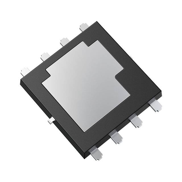

XPW4R10ANB MOSFETs Silicon N-channel MOS (U-MOS-H) XPW4R10ANB 1. Applications • Automotive • Motor Drivers • Switching Voltage Regulators 2. Features (1) AEC-Q101 qualified (2) Small, thin package (3) Low drain-source on-resistance: RDS(ON) = 3.4 mΩ (typ.) (VGS = 10 V) (4) Low leakage current: IDSS = 10 µA (max) (VDS = 100 V) (5) Enhancement mode: Vth = 2.5 to 3.5 V (VDS = 10 V, ID = 1.0 mA) 3. Packaging and Internal Circuit 1, 2, 3: Source 4: Gate 5, 6, 7, 8: Drain DSOP Advance(WF)L Start of commercial production ©2019-2020 Toshiba Electronic Devices & Storage Corporation 1 2020-09 2020-10-09 Rev.1.0 XPW4R10ANB 4. Absolute Maximum Ratings (Note) (Ta = 25  unless otherwise specified) Characteristics Symbol Rating Unit Drain-source voltage VDSS 100 V Gate-source voltage VGSS ±20 Drain current (DC) (Note 1) ID 70 Drain current (pulsed) (Note 1) IDP 210 PD 170 Power dissipation (Tc = 25 ) (Note 6) Power dissipation (t = 10 s) (Note 2) Power dissipation (t = 10 s) (Note 3) Single-pulse avalanche energy A W 3.0 0.96 (Note 4) EAS IAS 70 A Channel temperature (Note 5) Tch 175  Storage temperature (Note 5) Tstg -55 to 175 Single-pulse avalanche current 241 mJ Note: Using continuously under heavy loads (e.g. the application of high temperature/current/voltage and the significant change in temperature, etc.) may cause this product to decrease in the reliability significantly even if the operating conditions (i.e. operating temperature/current/voltage, etc.) are within the absolute maximum ratings. Please design the appropriate reliability upon reviewing the Toshiba Semiconductor Reliability Handbook ("Handling Precautions"/"Derating Concept and Methods") and individual reliability data (i.e. reliability test report and estimated failure rate, etc). Note: When the body or a connecting part of a semiconductor product is subjected to vibration, impact or stress in actual equipment, bonding fault or device destruction may result. Therefore, be sure to keep this in mind at the time of structural design. If a semiconductor product is subject to especially strong vibration, impact or stress, the package or chip may crack. If stress is applied to a semiconductor chip through the package, changes in the resistance of the chip may result due to piezoelectric effects, resulting in fluctuation in element characteristics. Furthermore, if a stress that does not instantly result in damage is applied continually for a long period of time, product deformation may result, causing defects such as disconnection or element failure. Thus, at the time of structural design, carefully consider vibration, impact and stress. ©2019-2020 Toshiba Electronic Devices & Storage Corporation 2 2020-10-09 Rev.1.0 XPW4R10ANB 5. Thermal Characteristics Characteristics Channel-to-case thermal impedance (Tc = 25 ) Channel-to-top-plate thermal impedance Symbol Max Unit zth(ch-c) 0.88 /W (Note 7) zth(ch-tp) 0.93 /W Channel-to-ambient thermal impedance (t = 10 s) (Note 2) zth(ch-a) 50 /W Channel-to-ambient thermal impedance (t = 10 s) (Note 3) zth(ch-a) 156 /W Note 1: Ensure that the channel temperature does not exceed 175 . Note 2: Device mounted on a glass-epoxy board (a), Figure 5.1 Note 3: Device mounted on a glass-epoxy board (b), Figure 5.2 Note 4: VDD = 80 V, Tch = 25  (initial), L = 37.9 µH, RG = 25 Ω, IAS = 70 A Note 5: The definitions of the absolute maximum channel and storage temperatures are qualified per AEC-Q101. Note 6: Tc is defined as a temperature of the drain electrode. Note 7: A maximum of the zth(ch-tp) measured at Toshiba's test environment is only used for reference. An area of the top-plate is shown in Figure 5.3. Be aware that the top-plate has the same electric potential as the sources; however, not intended for an electrode. Fig. 5.1 Device Mounted on a Glass-Epoxy Board (a) Fig. 5.2 Device Mounted on a Glass-Epoxy Board (b) Top view Note: This transistor is sensitive to electrostatic discharge and should be handled with care. ©2019-2020 Toshiba Electronic Devices & Storage Corporation 3 2020-10-09 Rev.1.0 XPW4R10ANB 6. Electrical Characteristics 6.1. Static Characteristics (Ta = 25  unless otherwise specified) Characteristics Symbol Gate leakage current IGSS VGS = ±20 V, VDS = 0 V IDSS VDS = 100 V, VGS = 0 V Drain cut-off current Drain-source breakdown voltage Typ. Max Unit   ±1 µA   10   ID = 10 mA, VGS = -20 V 80   VDS = 10 V, ID = 1.0 mA 2.5  3.5 VGS = 6 V, ID = 35 A  4.1 6.2 VGS = 10 V, ID = 35 A  3.4 4.1 Min Typ. Max Unit  4970  pF ID = 10 mA, VGS = 0 V V(BR)DSX Vth RDS(ON) Min 100 V(BR)DSS Gate threshold voltage Drain-source on-resistance Test Condition V mΩ 6.2. Dynamic Characteristics (Ta = 25  unless otherwise specified) Characteristics Symbol Input capacitance Ciss Test Condition VDS = 10 V, VGS = 0 V, f = 300 kHz Reverse transfer capacitance Crss  300  Output capacitance Coss  1940   2.1 4.2 Ω  21  ns Gate resistance rg Switching time (rise time) tr Switching time (turn-on time) ton  52  tf  22  toff  89  ns Switching time (fall time) Switching time (turn-off time) See Fig. 6.2.1 VDD ≈ 50 V VGS = 0 V/ 10 V ID = 35 A RL = 1.4 Ω RGG = 4.7 Ω RGS = 4.7 Ω Duty ≤ 1 %, tw = 10 µs Fig. 6.2.1 Switching Time Test Circuit 6.3. Gate Charge Characteristics (Ta = 25  unless otherwise specified) Characteristics Symbol Total gate charge (gate-source plus gate-drain) Test Condition VDD ≈ 80 V, VGS = 10 V, ID = 70 A Qg Min Typ. Max Unit  75  nC Gate-source charge 1 Qgs1  22  Gate-drain charge Qgd  16  6.4. Source-Drain Characteristics (Ta = 25  unless otherwise specified) Characteristics Reverse drain current (pulsed) (Note 8) Diode forward voltage Symbol Test Condition Min Typ. Max Unit IDRP    210 A   -1.2 V VDSF IDR = 70 A, VGS = 0 V Note 8: Ensure that the channel temperature does not exceed 175 . ©2019-2020 Toshiba Electronic Devices & Storage Corporation 4 2020-10-09 Rev.1.0 XPW4R10ANB 7. Marking Fig. 7.1 Marking ©2019-2020 Toshiba Electronic Devices & Storage Corporation 5 2020-10-09 Rev.1.0 XPW4R10ANB 8. Characteristics Curves (Note) Fig. 8.1 ID - VDS Fig. 8.2 ID - VDS Fig. 8.3 VDS - VGS Fig. 8.4 VDS - VGS Fig. 8.5 VDS - VGS Fig. 8.6 VDS - VGS ©2019-2020 Toshiba Electronic Devices & Storage Corporation 6 2020-10-09 Rev.1.0 XPW4R10ANB Fig. 8.7 ID - VGS Fig. 8.8 RDS(ON) - ID Fig. 8.9 RDS(ON) - Ta Fig. 8.10 IDR - VDS Fig. 8.11 V(BR)DSS - Ta Fig. 8.12 Vth - Ta ©2019-2020 Toshiba Electronic Devices & Storage Corporation 7 2020-10-09 Rev.1.0 XPW4R10ANB Fig. 8.13 Capacitance - VDS Fig. 8.14 Dynamic Input/Output Characteristics Fig. 8.15 EAS - Tch(Guaranteed Maximum) Fig. 8.16 Test Circuit/Waveform ©2019-2020 Toshiba Electronic Devices & Storage Corporation 8 2020-10-09 Rev.1.0 XPW4R10ANB Fig. 8.17 zth(ch-c) - tw (Guaranteed Maximum) Fig. 8.18 PD - Tc (Guaranteed Maximum) ©2019-2020 Toshiba Electronic Devices & Storage Corporation Fig. 8.19 Safe Operating Area (Guaranteed Maximum) 9 2020-10-09 Rev.1.0 XPW4R10ANB Fig. 8.20 zth(ch-a) - tw (Reference Values) Note: The above characteristics curves are presented for reference only and not guaranteed by production test, unless otherwise noted. ©2019-2020 Toshiba Electronic Devices & Storage Corporation 10 2020-10-09 Rev.1.0 XPW4R10ANB Package Dimensions Unit: mm Weight: 0.097 g (typ.) Package Name(s) TOSHIBA: 2-5V1A Nickname: DSOP Advance(WF)L ©2019-2020 Toshiba Electronic Devices & Storage Corporation 11 2020-10-09 Rev.1.0 XPW4R10ANB RESTRICTIONS ON PRODUCT USE Toshiba Corporation and its subsidiaries and affiliates are collectively referred to as "TOSHIBA". Hardware, software and systems described in this document are collectively referred to as "Product". • TOSHIBA reserves the right to make changes to the information in this document and related Product without notice. • This document and any information herein may not be reproduced without prior written permission from TOSHIBA. Even with TOSHIBA's written permission, reproduction is permissible only if reproduction is without alteration/omission. • Though TOSHIBA works continually to improve Product's quality and reliability, Product can malfunction or fail. Customers are responsible for complying with safety standards and for providing adequate designs and safeguards for their hardware, software and systems which minimize risk and avoid situations in which a malfunction or failure of Product could cause loss of human life, bodily injury or damage to property, including data loss or corruption. Before customers use the Product, create designs including the Product, or incorporate the Product into their own applications, customers must also refer to and comply with (a) the latest versions of all relevant TOSHIBA information, including without limitation, this document, the specifications, the data sheets and application notes for Product and the precautions and conditions set forth in the "TOSHIBA Semiconductor Reliability Handbook" and (b) the instructions for the application with which the Product will be used with or for. Customers are solely responsible for all aspects of their own product design or applications, including but not limited to (a) determining the appropriateness of the use of this Product in such design or applications; (b) evaluating and determining the applicability of any information contained in this document, or in charts, diagrams, programs, algorithms, sample application circuits, or any other referenced documents; and (c) validating all operating parameters for such designs and applications. TOSHIBA ASSUMES NO LIABILITY FOR CUSTOMERS' PRODUCT DESIGN OR APPLICATIONS. • PRODUCT IS NEITHER INTENDED NOR WARRANTED FOR USE IN EQUIPMENTS OR SYSTEMS THAT REQUIRE EXTRAORDINARILY HIGH LEVELS OF QUALITY AND/OR RELIABILITY, AND/OR A MALFUNCTION OR FAILURE OF WHICH MAY CAUSE LOSS OF HUMAN LIFE, BODILY INJURY, SERIOUS PROPERTY DAMAGE AND/OR SERIOUS PUBLIC IMPACT ("UNINTENDED USE"). Except for specific applications as expressly stated in this document, Unintended Use includes, without limitation, equipment used in nuclear facilities, equipment used in the aerospace industry, and lifesaving and/or life supporting medical equipment. IF YOU USE PRODUCT FOR UNINTENDED USE, TOSHIBA ASSUMES NO LIABILITY FOR PRODUCT. For details, please contact your TOSHIBA sales representative or contact us via our website. • Do not disassemble, analyze, reverse-engineer, alter, modify, translate or copy Product, whether in whole or in part. • Product shall not be used for or incorporated into any products or systems whose manufacture, use, or sale is prohibited under any applicable laws or regulations. • The information contained herein is presented only as guidance for Product use. No responsibility is assumed by TOSHIBA for any infringement of patents or any other intellectual property rights of third parties that may result from the use of Product. No license to any intellectual property right is granted by this document, whether express or implied, by estoppel or otherwise. • ABSENT A WRITTEN SIGNED AGREEMENT, EXCEPT AS PROVIDED IN THE RELEVANT TERMS AND CONDITIONS OF SALE FOR PRODUCT, AND TO THE MAXIMUM EXTENT ALLOWABLE BY LAW, TOSHIBA (1) ASSUMES NO LIABILITY WHATSOEVER, INCLUDING WITHOUT LIMITATION, INDIRECT, CONSEQUENTIAL, SPECIAL, OR INCIDENTAL DAMAGES OR LOSS, INCLUDING WITHOUT LIMITATION, LOSS OF PROFITS, LOSS OF OPPORTUNITIES, BUSINESS INTERRUPTION AND LOSS OF DATA, AND (2) DISCLAIMS ANY AND ALL EXPRESS OR IMPLIED WARRANTIES AND CONDITIONS RELATED TO SALE, USE OF PRODUCT, OR INFORMATION, INCLUDING WARRANTIES OR CONDITIONS OF MERCHANTABILITY, FITNESS FOR A PARTICULAR PURPOSE, ACCURACY OF INFORMATION, OR NONINFRINGEMENT. • Do not use or otherwise make available Product or related software or technology for any military purposes, including without limitation, for the design, development, use, stockpiling or manufacturing of nuclear, chemical, or biological weapons or missile technology products (mass destruction weapons). Product and related software and technology may be controlled under the applicable export laws and regulations including, without limitation, the Japanese Foreign Exchange and Foreign Trade Law and the U.S. Export Administration Regulations. Export and re-export of Product or related software or technology are strictly prohibited except in compliance with all applicable export laws and regulations. • Please contact your TOSHIBA sales representative for details as to environmental matters such as the RoHS compatibility of Product. Please use Product in compliance with all applicable laws and regulations that regulate the inclusion or use of controlled substances, including without limitation, the EU RoHS Directive. TOSHIBA ASSUMES NO LIABILITY FOR DAMAGES OR LOSSES OCCURRING AS A RESULT OF NONCOMPLIANCE WITH APPLICABLE LAWS AND REGULATIONS. https://toshiba.semicon-storage.com/ ©2019-2020 Toshiba Electronic Devices & Storage Corporation 12 2020-10-09 Rev.1.0
