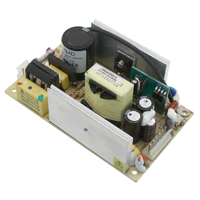

    AC/DC CONVERTER 12V 75W
ALS75-12 数据手册
Switch Mode Power Supplies Single Output AC/DC Power Supply ALS75-12 Description: The ALS75-12 is a single output power supply. It provides a DC output power in a cost-effective open frame package. Excellent performance specifications are provided, together with compliance to European EMC (EN55022, Class A). Specifications (@25C) Input Characteristics: Input Voltage (5): Input Frequency Range: Max Input Current: Max Inrush Current: Hold-Up Time: 110/220Vac (90-260Vac, 120-370Vdc) 47-63Hz 1.8A @ 110Vac; 0.9A @ 220Vac 30A @ 220VAc 17ms typ @ 110Vac, 100% Load Output Characteristics: Output Voltage: Output Current (1): Output Power (1): Ripple & Noise (20MHz BW): Line Regulation (4): Load Regulation (3): Temperature Drift: Rise-UP Time: Over Current Protection: Over Voltage Protection: Short Circuit Protection: Adj. O/P Voltage Range (1,2): 12.0Vdc 6.2A 75W 100mV 1.0% 2.0% 0.02%/°C 500ms max, 110Vac, 100% Load Shutdown, O.C.P Point>120%, recycle AC supply to recover >105% Zener across output Unit shutdown, recycle AC supply to recover ±10% Environmental Specifications: EMI (Conducted RFI): EFT: ESD: Surge: Operating Temperature: Operating Humidity: Storage Temperature: Storage Humidity: Cooling: Vibration: Shock: Built to comply with EN55022-B Built to comply with IEC61000-4-4 Built to comply with IEC61000-4-2 Built to comply with IEC61000-4-5 Convection cooling 0 to 50°C:100%; 60°C;70% 30% to 90% RH -25 to 85°C 10% to 95% RH Convection cooling 1min sweep 10-55Hz, 2G Amplitude, X,Y,Z axis 1hr each
ALS75-12
物料型号为ALS75-12,是一款单输出AC/DC电源供应器。
器件简介显示它提供了成本效益高的开放式框架封装,并符合欧洲EMC标准。
引脚分配包括+5V、GND、+V和OV,具体引脚位置和尺寸在文档中有详细描述。
参数特性包括输入电压范围、最大输入电流、输入频率范围、保持时间、输出电压和电流、线路调整率、负载调整率、温度漂移、上升时间、输出功率、纹波和噪声、过电流保护、过电压保护、短路保护以及可调输出电压范围。
功能详解涉及EMI、EFT、ESD、浪涌等环境规格,以及操作温度、湿度、存储温度和湿度。
封装信息包括尺寸、重量、保修期和符合RoHS标准的声明。
更多详细信息和应用信息可参考TRIAD MAGNETICS官方网站。
