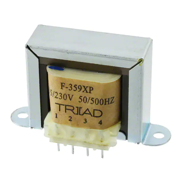

    POWERTRANSFORMERPCBMOUNT
F-359XP 数据手册
P OWE R T RAN S FO R M E R PC Mount: Dual Primary F-359XP Electrical Specifications (@25C) 1. Maximum Power: 10.0 VA 2. Primary: Series:230V@50/60 Hz Parallel: 115V@50/60Hz 3. Secondary: Series: 24.0V CT @ 0.450 Amps Parallel: 12.0V CT @ 0.900 Amps Description: The F-359XP is part of a wide selection of plug-in types that meet the needs of PC boards and solid state power supply design. This transformer can satisfy power as well as control and instrumentation applications. Construction: Wound on a single channel nylon bobbin. Materials are UL recognized, Class B (130º C) rated. D Safety: These products are 100% hipot tested with an insulation of 1500V between primary and secondary windings. A 1 2 3 4 Dimensions: Units: In inches A B C D E F G 1.625 2.812 1.437 1.875 .250 1.312 2.375 Mounting holes: 0.187 in. Pin length: 0.187 in. Pin size: 0.20 x .041 in. Weight: 11.0 oz C Schematic: 1 G 5 B 2 6 3 7 E 8 4 Primary: Secondary: E 7 5 F 8 Series - 1 to 4, Jumper 2 to 3 Parallel - 1 to 4, Jumper 1 to 3 and 2 to 4 Series - 5 to 8, Jumper 6 to 7 Parallel - 5 to 8, Jumper 5 to 7 and 6 to 8 1 2 RoHS Compliance: As of manufacturing date February 2016, all standard products meet the requirements of 2015/863/EU, known as the RoHS 3 initiative. *Upon printing, this document is considered “uncontrolled”. Please contact Triad Magnetics website for the most current version. For soldering and washing information please see http://www.triadmagnetics.com/faq.html Web: www.TriadMagnetics.com Phone 951-277-0757 Fax 951-277-2757 E 6 460 Harley Knox Blvd. Perris, California 92571 Publish Date: May 29, 2019 3 4
