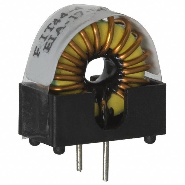

    固定电感器 Radial, Vertical 12.3µH 4A 23.4mΩ
FIT44-3-B 数据手册
Switchmode/High Frequency Toroidal Inductor FIT44-3 Description: The FIT44-3 toroidal inductor is specifically designed to minimize transients. It stores energy and therefore, conditions the output signal by leveling the current waveform providing a more stable current supply. Generally used in high frequency circuits, its standard design provides an economical solution in differential mode applications or as an output inductor. Electrical Specifications (@25C): Min. Inductance (µH) Rated Max No Bias At Bias DC Amps DCR (mΩ) 12.30 7.75 4.0 23.4 Note: No Bias inductance measured at .25V, 10KHZ. C F G (DIA.) Dimensions: A B C D E F G .625 .350 .700 .250 .350 .125 .025±.003 A Units: In inches B Weight: .008 lbs. E Technical Notes: 1. Nominal inductance values are typically 10% higher than minimal rating. 2. Biased inductance measured at rated DC amps. 3. Operation at rated current yields approximately 40°C temperature rise over 20°C ambient. LEADS TINNED TO MTG SURFACE MIN. D RoHS Compliance: As of manufacturing date February 2005, all standard products meet the requirements of 2011/65/EU, known as the RoHS initiative.. *Upon printing, this document is considered “uncontrolled”. Please contact Triad Magnetics website for the most current version. For soldering and washing information please see http://www.triadmagnetics.com/faq.html Web: www.TriadMagnetics.com Phone 951-277-0757 Fax 951-277-2757 460 Harley Knox Blvd. Perris, California 92571 Publish Date: June 7, 2016
