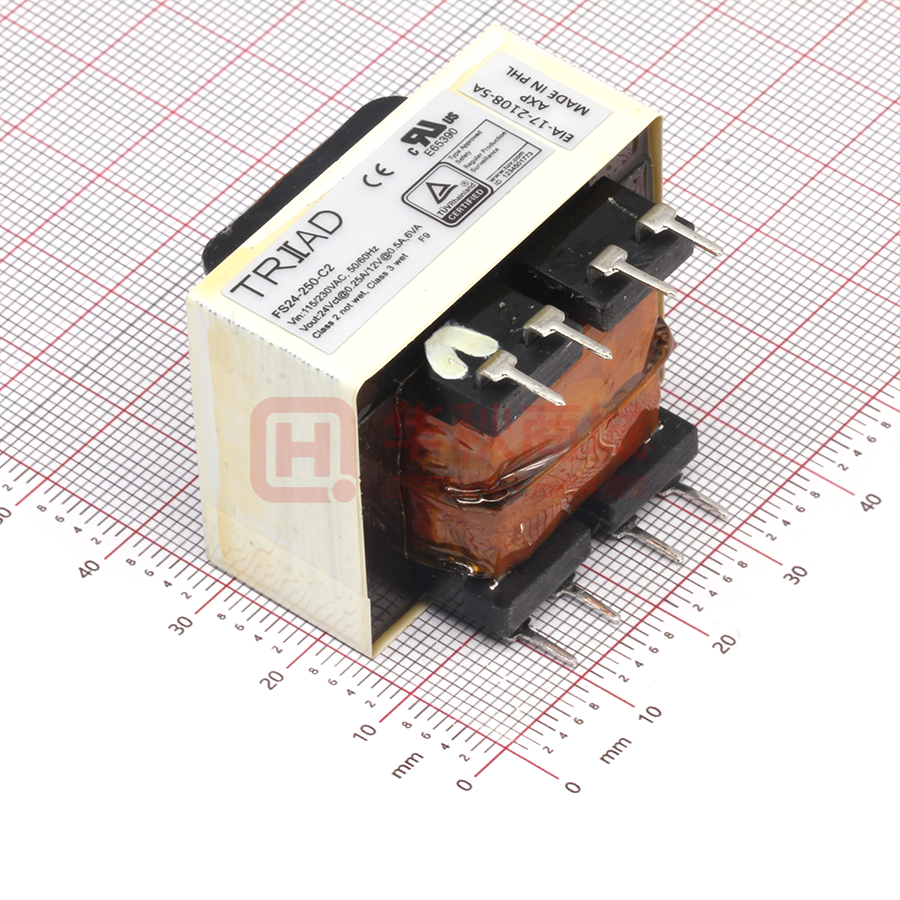

CLASS 2/3 TRANSFORMER FS24-250-C2 Description: The FS24-250-C2 is a series/parallel primary and dual secondary, split bobbin design which operates with either a parallel input of 115V or a series input of 230V. The secondaries are 12V @ 0.25A each. They can be used independently (up to 300V difference between them) or in series for double the voltage or in parallel for double the current. The split bobbin design eliminates the need for costly electrostatic shielding. Electrical Specifications (@25C) 1. Maximum Power: 6.0VA 2. Primary: Series: 230V; Parallel: 115V 3. Secondaries: 12.0V @ 0.25A each 4. Voltage Regulation: 25% TYP @ full load to no load 5. Operating Temperature: -40C to 100C 6. Storage Temperature: -55C to 150C 7. Hipot tested 100% at 4200 VRMS pri to sec 8. Hipot tested 100% at 2160 VRMS sec to sec 9. Recommended fuse (fuse on primary): For 115V - Cooper/Bussman, Type MDL, rated 500mA, 250V. For 230V – Littlefuse, Type 313, rated 250mA, 250V W Construction: E Three flange bobbin construction with primaries and secondaries wound side by side for low capacitive coupling. UL Class F Insulation System (155°C). L Agency File: UL: File E65390, UL 5085-1 & 3 (1585), Class 2 not wet / Class 3 wet Transformer cUL: File E65390, UL 5085-1 & 3 (1585) For Canadian Use (CSA 22.2, No.66.3-06) TUV Certificate No.: R72120839, EN61558, Safety Isolating xfmr, general use H 1 Dimensions: 3 2 4 Units in inches. H W L A B C D E F 1.398 MAX 1.331 MAX 1.650 MAX 0.250±0.02 0.350±0.02 1.280±0.02 0.041 0.020 0.217±0.02 D F Weight: 0.44 lbs A Schematic: PARALLEL SERIES 1 1 5 1 12V @ 0.25A 115V 50/60Hz 2 230V 50/60Hz 3 4 2 2 3 3 7 4 C 8 RoHS Compliance: As of manufacturing date February 2016, all standard products meet the requirements of 2015/863/EU, known as the RoHS 3 initiative. Note: Order and shipping documentation may have a “-B” suffix; this indicates Bulk packaging but does not show on the actual part number marked on the transformer. *Upon printing, this document is considered “uncontrolled”. Please contact Triad Magnetics website for the most current version. For soldering and washing information please see http://www.triadmagnetics.com/faq.html www.TriadMagnetics.com Phone: (951) 277-0757 Fax: (951) 277-2757 460 Harley Knox Blvd. Perris, CA 92571 8 B 6 12V @ 0.25A 4 A 5 1 4 0.06" DIAMETER HOLE Board Layout Publish Date: May 30, 2019

器件简介: - 该变压器具有串联/并联的初级和双次级,采用分线圈设计。 - 可以与115V并联输入或230V串联输入一起使用。 - 次级电压为12V,电流为0.25A。 - 可以独立使用(它们之间的电压差可达300V),也可以串联使用以获得双倍电压或并联使用以获得双倍电流。 - 分线圈设计消除了昂贵的防静电屏蔽的需要。
引脚分配: - 初级和次级绕组并排绕制,以减少电容耦合。 - 引脚分配在文档中以电路图的形式展示,但未提供具体的引脚编号。
参数特性: - 最大功率:6.0VA - 初级电压:串联230V;并联115V - 次级电压:12.0V @ 0.25A 每个 - 电压调节:在满载到空载时典型值为25% - 工作温度:-40°C 至 100°C - 存储温度:-55°C 至 150°C - 初级到次级和次级到次级都经过100%的耐压测试,分别为4200VRMS和2160VRMS - 推荐保险丝:对于115V - Cooper/Bussman,型号MDL,额定500mA,250V。对于230V - Littlefuse,型号313,额定250mA,250V
功能详解: - 三法兰线圈结构,具有低电容耦合。 - UL F级绝缘系统(155°C)。 - 符合UL 5085-1 & 3(1585)标准,适用于Class 2干燥环境和Class 3潮湿环境。
