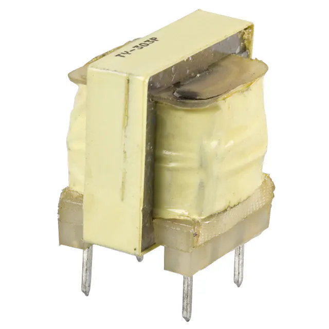

TY-303P-B 数据手册
A u d i o Tr a n s f o r m e r D a t a / Vo i c e C o u p l i n g T Y- 3 0 3 P Description: The TY series transformers are used for a variety of applications including impedance matching, isolation, repeat coil, line balancing, bridging and hybrid circuits. Electrical Specifications at 25º C: Impedance Max. DC Typ. Typ. Typ. Freq. DCR (Ohms) Current Insertion Return Response (Ohms) Pri Sec (mA) 4000 600 0 Loss (dB) Loss (dB) 1.0 26 (dB) Pri Sec ±.5 260 52 Designed to meet FCC Part 68 D O T ABOVE # 1 PIN ON BOBBIN FL AN GE .81 2 MAX .74 0 MAX .15 0 MIN P C P IN S .016 X .041 1 Longitudinal Balance: (FCC 68.310) – 60 dB min. 200 – 1000 Hz 45 dB min. 1000 – 4000 Hz 3 .71 5 MAX Dielectric Strength: (FCC 68.304) – 1500VAC Power Level: -45 dBm to +7 dBm Frequency Range: Data/Voice = 300 to 3500 Hz Data = 800 to 3500 Hz .37 5 Operating Temperature: -20°C ~ 85°C 6 4 1 3 .06 0 D IA H OL ES .42 0 Schematic: Z = 4000 OHM 3 U N IT MOU N TIN G PATTER N 4 1 PRIMARY SECONDARY Z = 600 OHM 6 RoHS Compliance: As of manufacturing date February 2016, all standard products meet the requirements of 2015/863/EU, known as the RoHS 3 initiative. *Upon printing, this document is considered “uncontrolled”. Please contact Triad Magnetics website for the most current version. For soldering and washing information please see http://www.triadmagnetics.com/faq.html web:www.TriadMagnetics.com Phone 951-277-0757 Fax 951-277-2757 460 Harley Knox Blvd. Perris, California 92571 Publish Date: May 31, 2019
